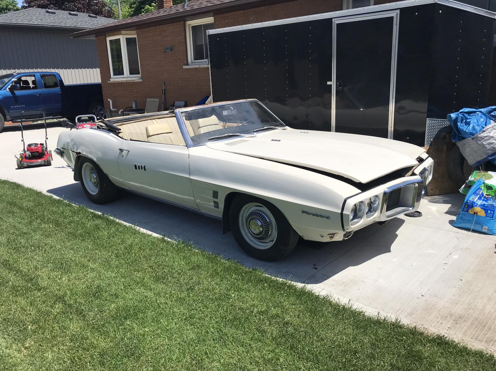

      Just a bit on the car, I found it locally knowing full well these type of projects take time and money. My plan is to build a pro turning type car while keeping the stock Firebird appearance. Minor body mods. Factory Pontiac block (455). Mini tub, wide tires and well you get it. Luckily I have a dad that’s a licensed retired body man and me being in the business for about 10 years before changing careers. So not worried about the cost of bodywork. I get to save a ton on this part. Here’s a few pics of the work after two years.

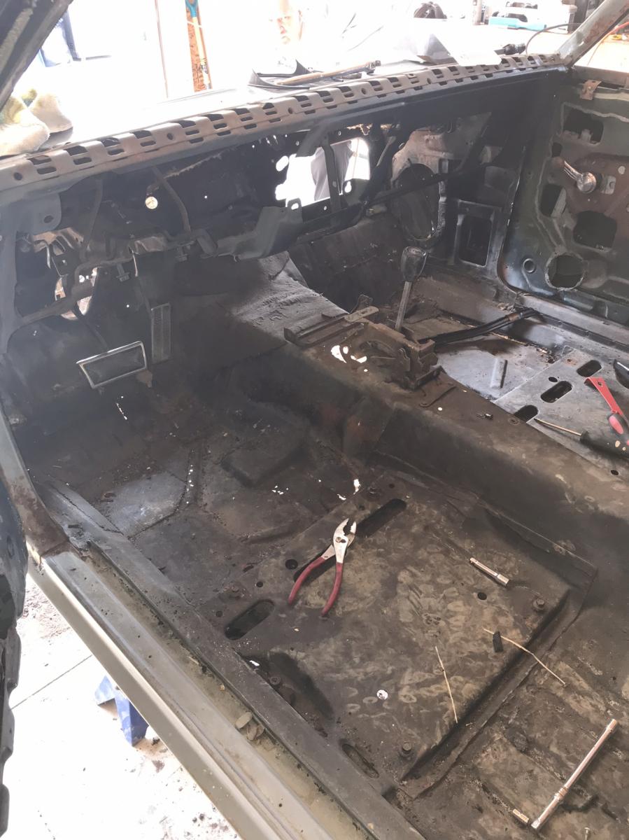

      So that was disassembly. Fun times!!

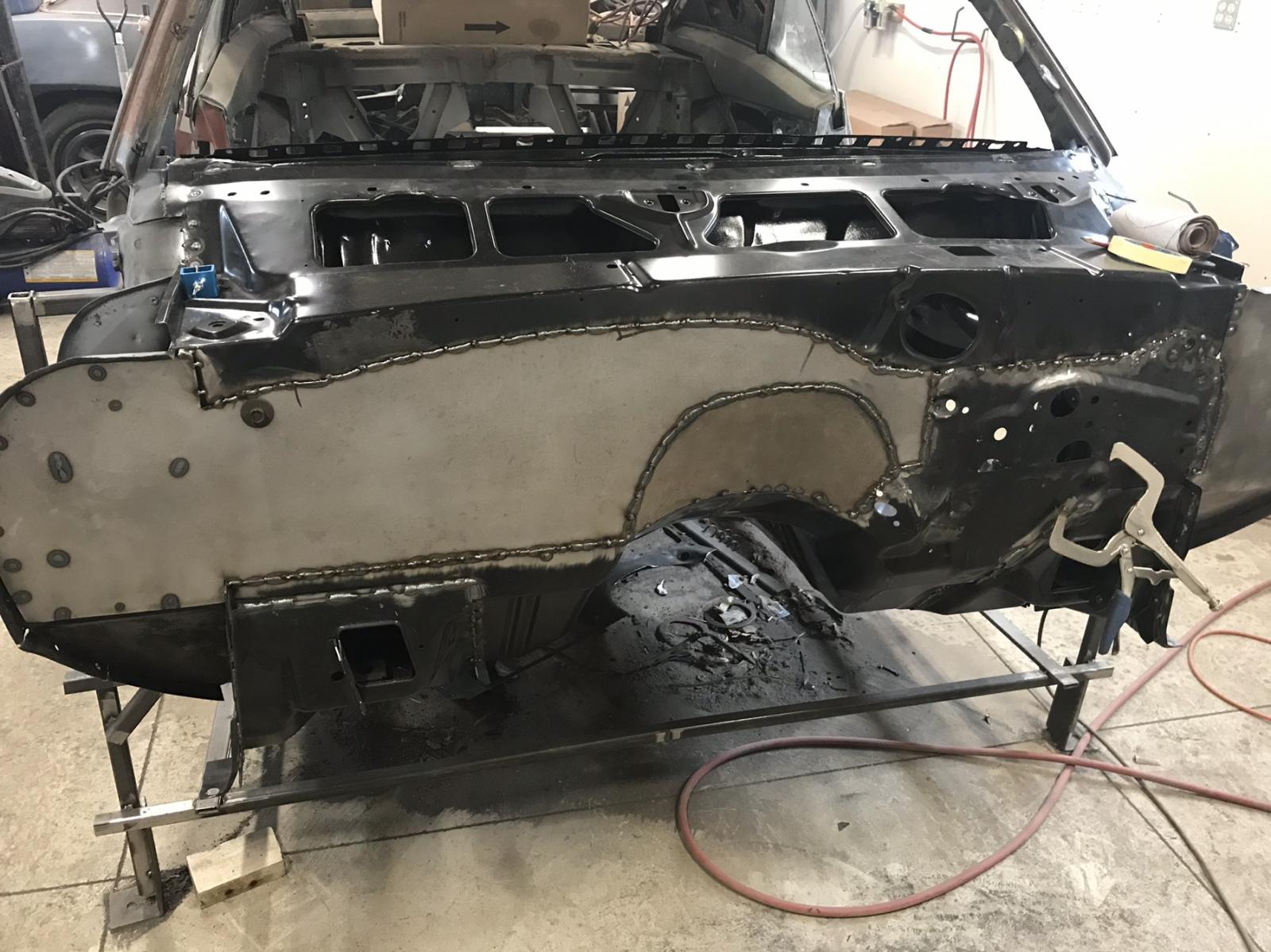

      Here’s some cut and repair and weld back in.
Size:  113.4 KBName:  IMG_0663.jpg

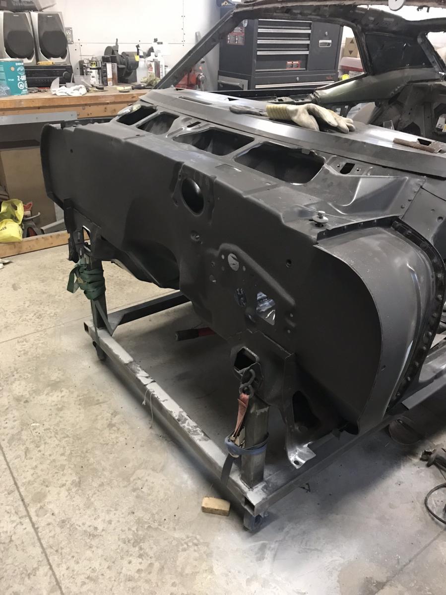

      Here’s the firewall smoothing.
Size:  276.0 KBName:  IMG_0701.jpg
Size:  240.9 KBName:  IMG_0720.jpg
Size:  232.3 KBName:  IMG_0721.jpg
Size:  233.1 KBName:  IMG_0750.jpg

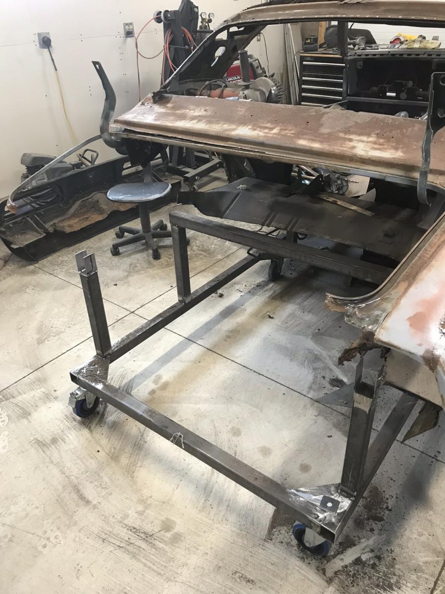

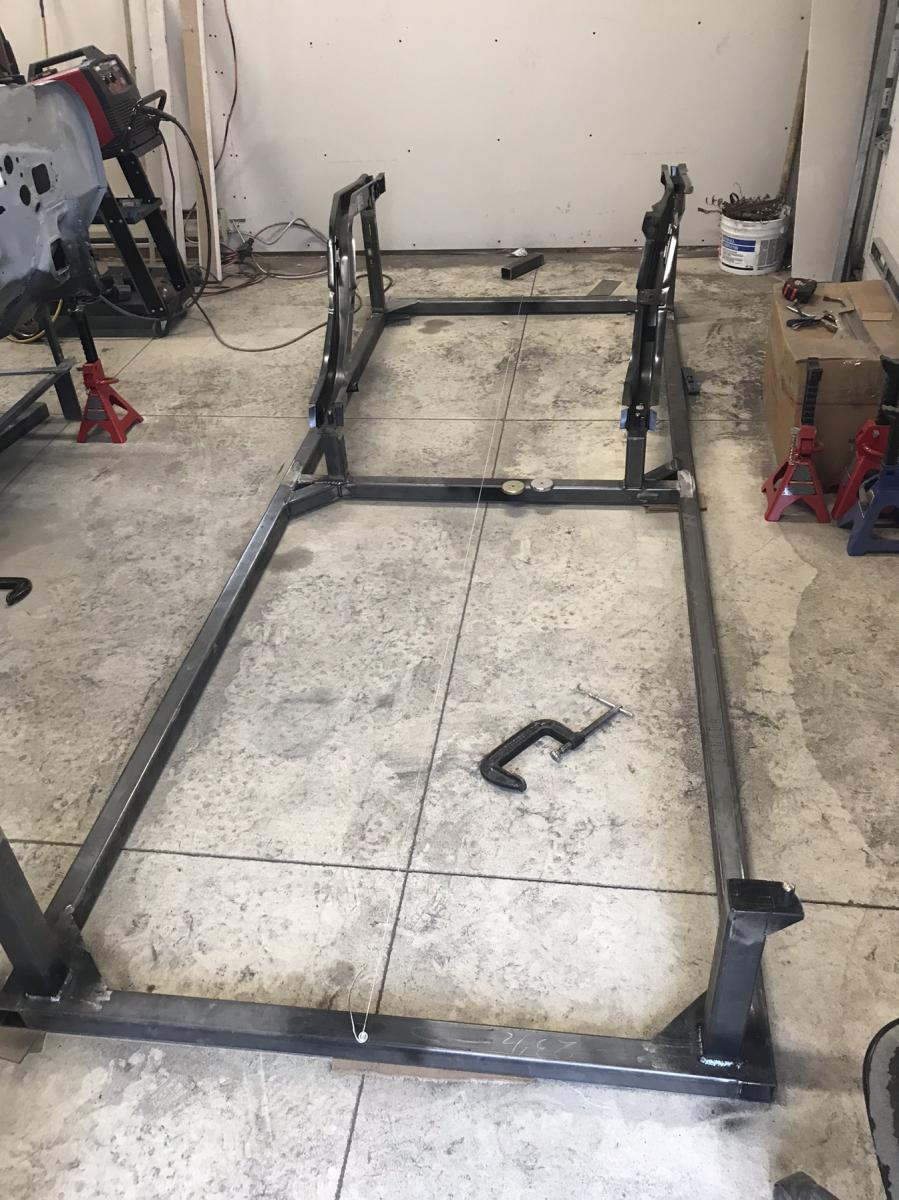

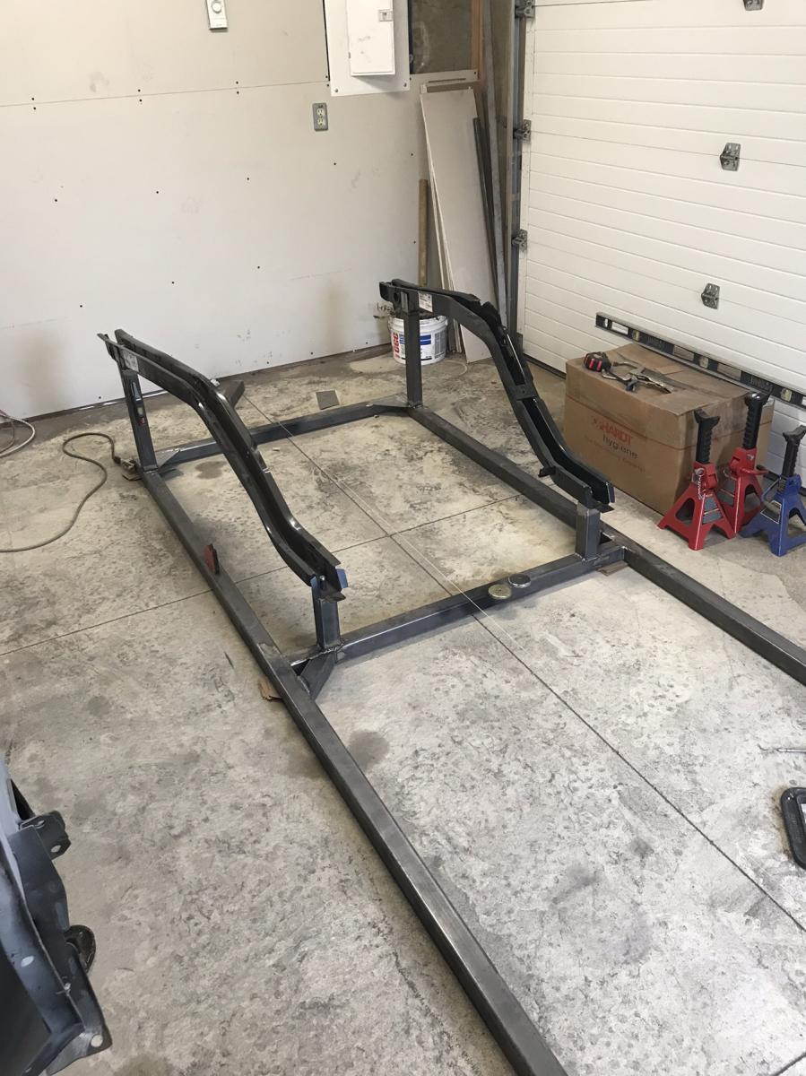

      Now I made a body jig. Needed to replace my frame rails and trunk floor.
Size:  163.0 KBName:  IMG_0727.jpg

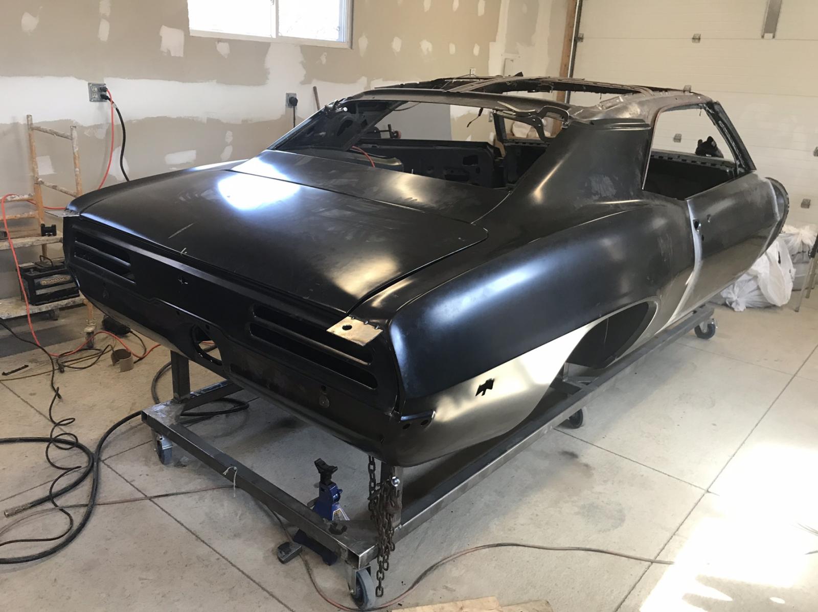

      Car is on the jig. Just skinned the doors.
Size:  205.3 KBName:  IMG_0736.jpg

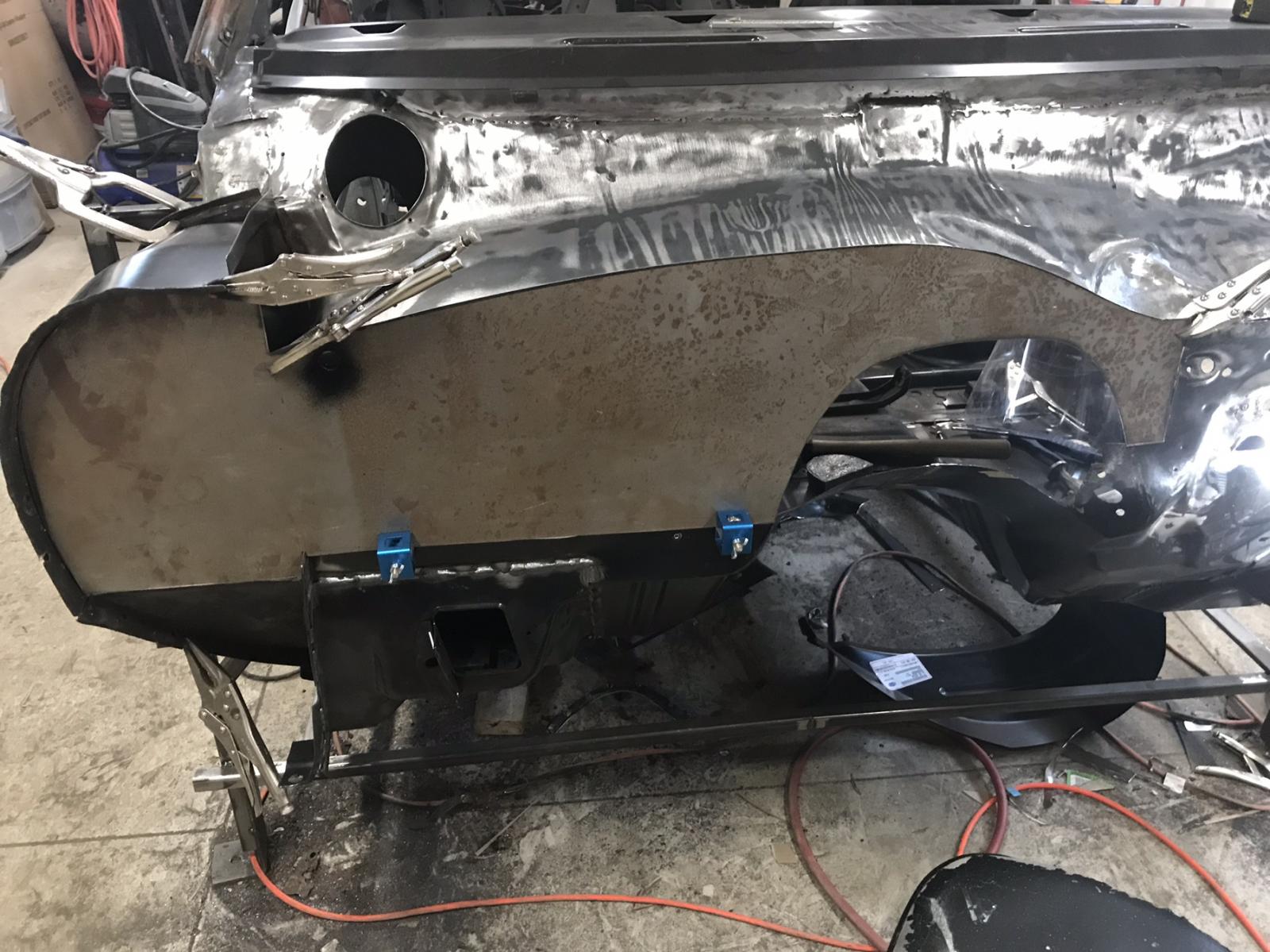

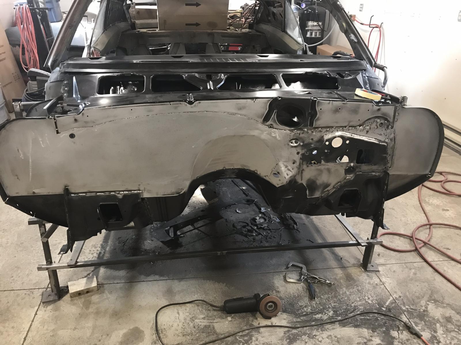

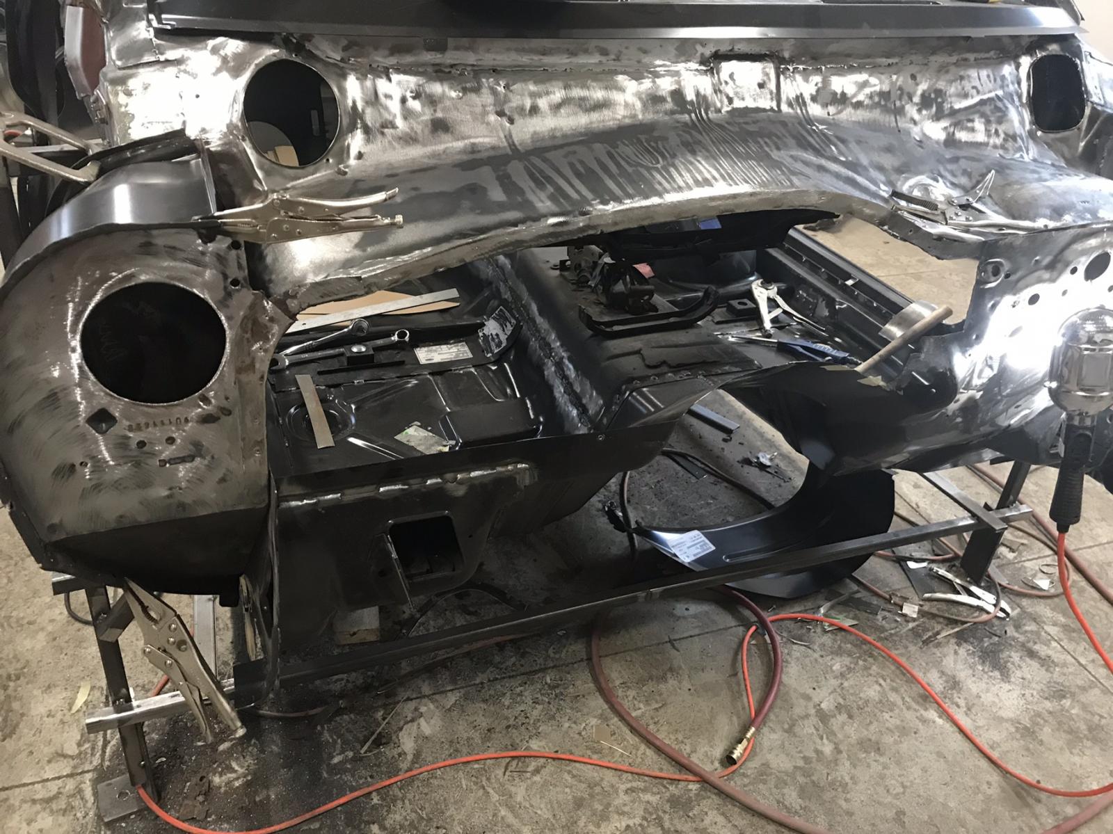

      Started cutting out the old rusty crap in the back.

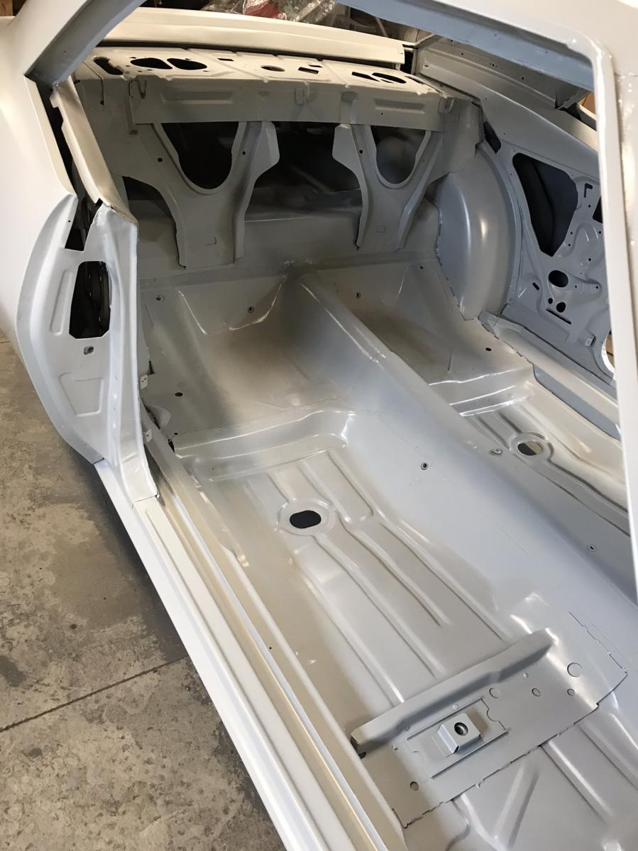

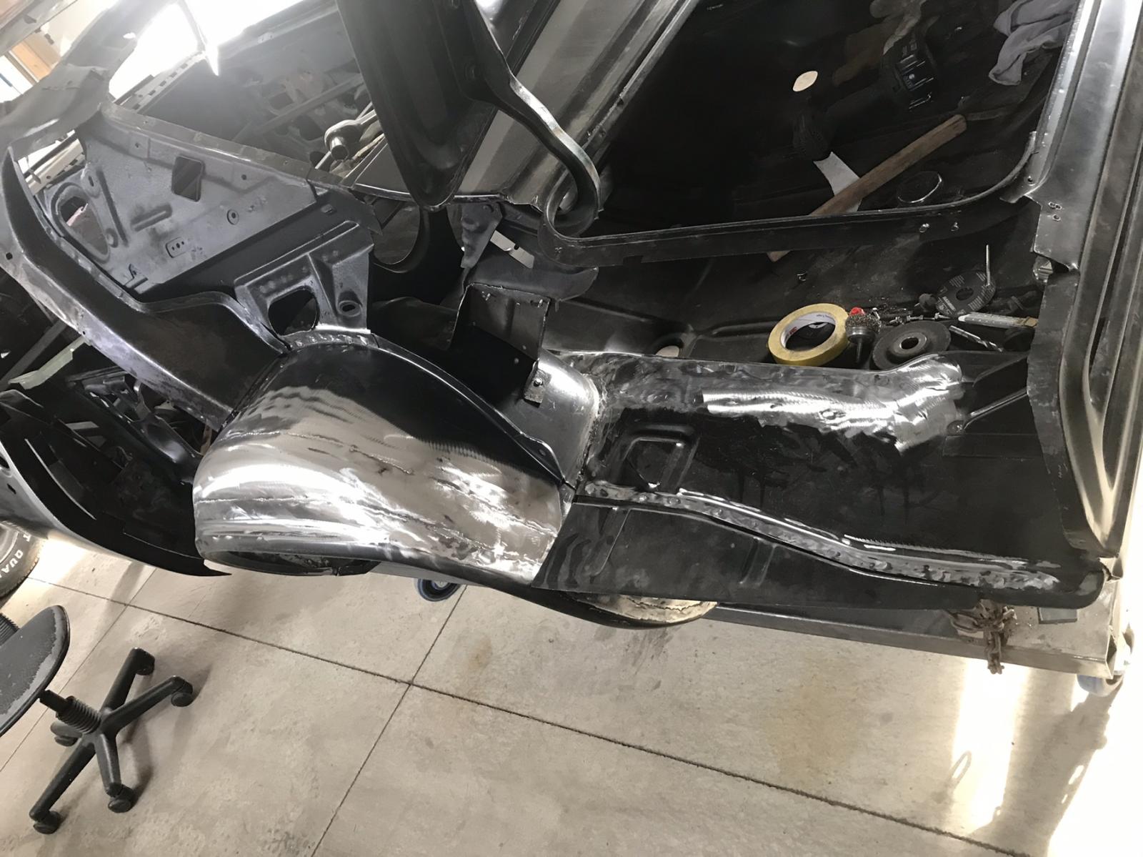

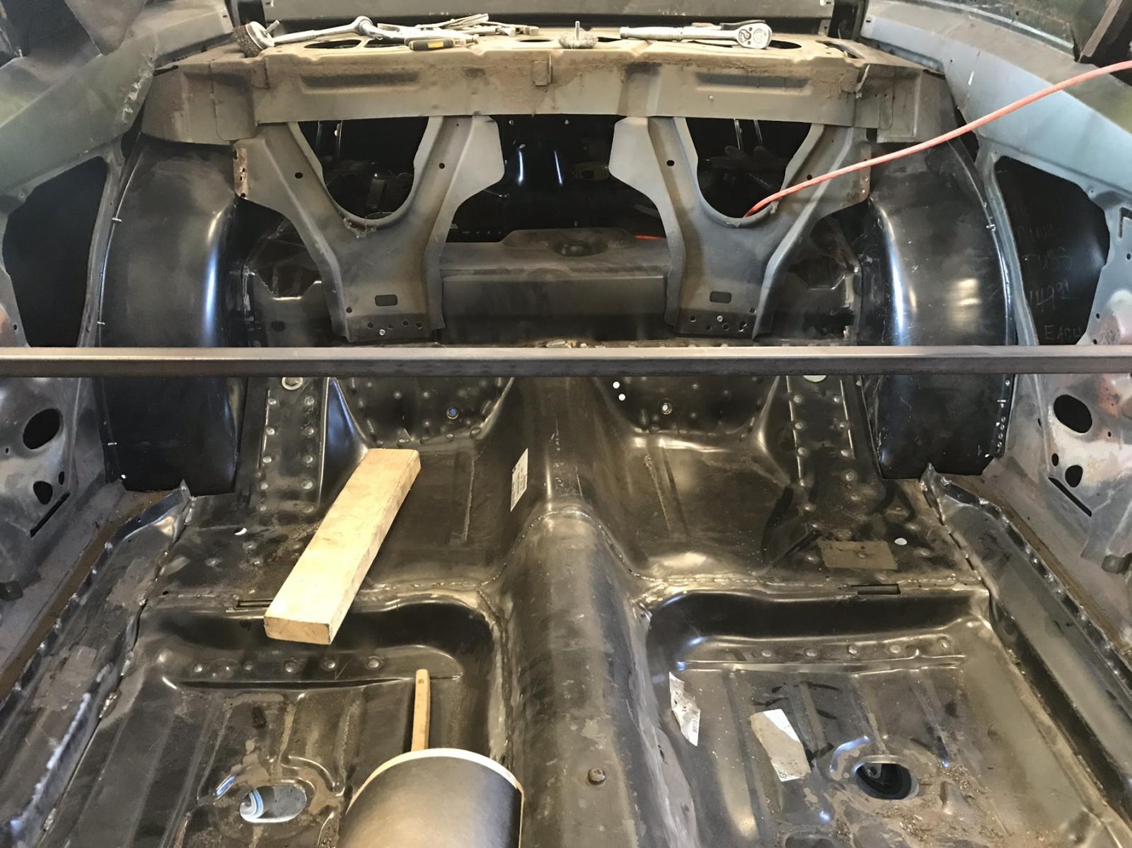

      Here is some of the completed wheel wells and trunk floor etc.
Size:  215.8 KBName:  IMG_1065.jpg
Size:  206.2 KBName:  IMG_1038.jpg

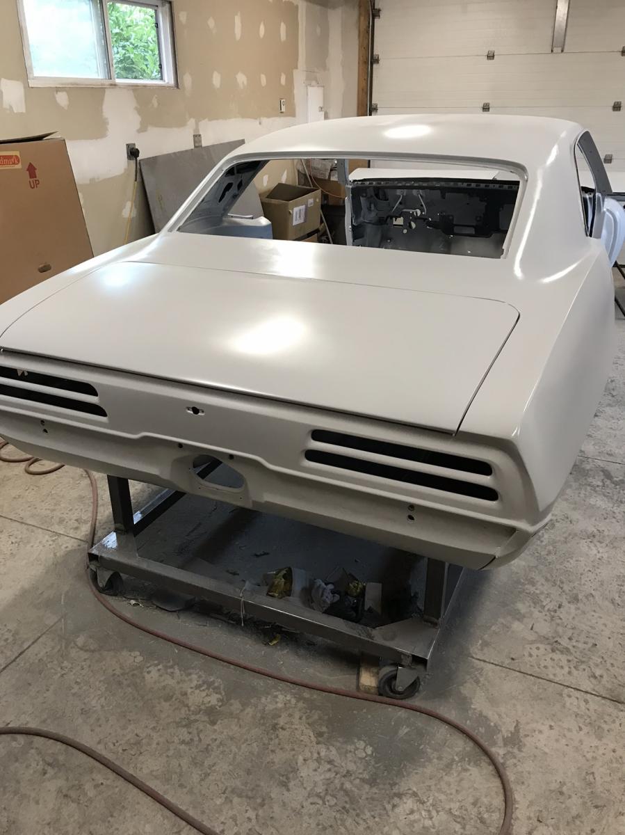

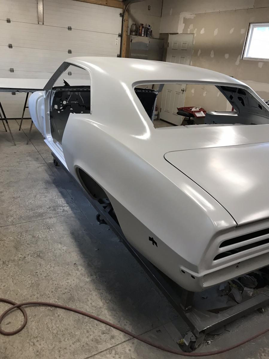

      Now with epoxy primer.
Size:  149.3 KBName:  IMG_1389.jpg
Size:  97.6 KBName:  IMG_1390.jpg
Size:  115.2 KBName:  IMG_1391.jpg
Size:  110.4 KBName:  IMG_1392.jpg
Size:  115.1 KBName:  IMG_1393.jpg

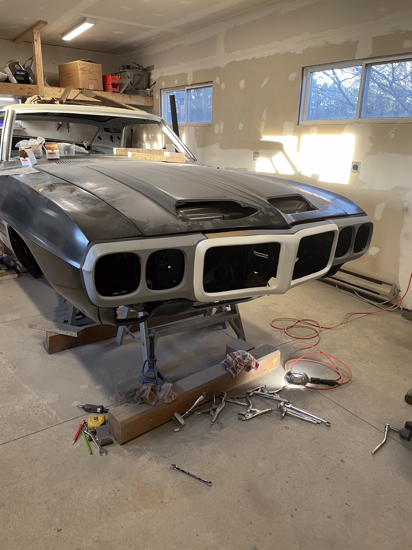

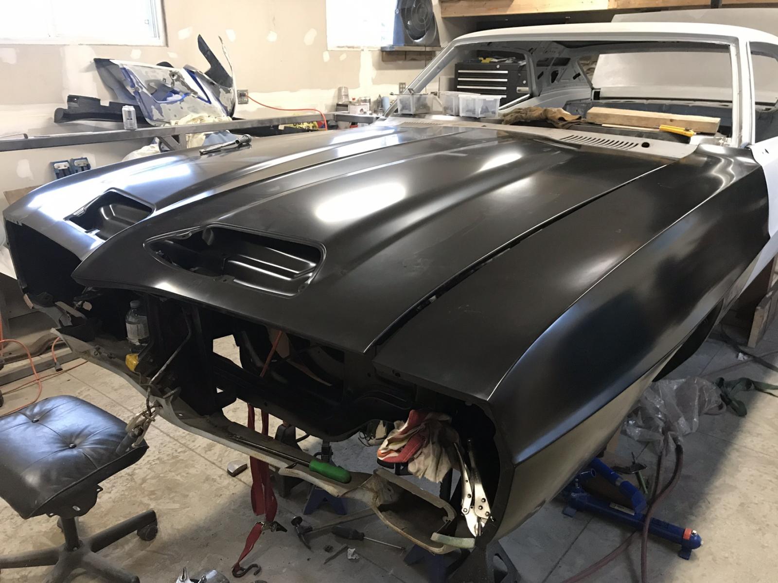

      Now. Off the jig to fit the front end and see how all this goes.
Size:  135.4 KBName:  IMG_1584.jpg

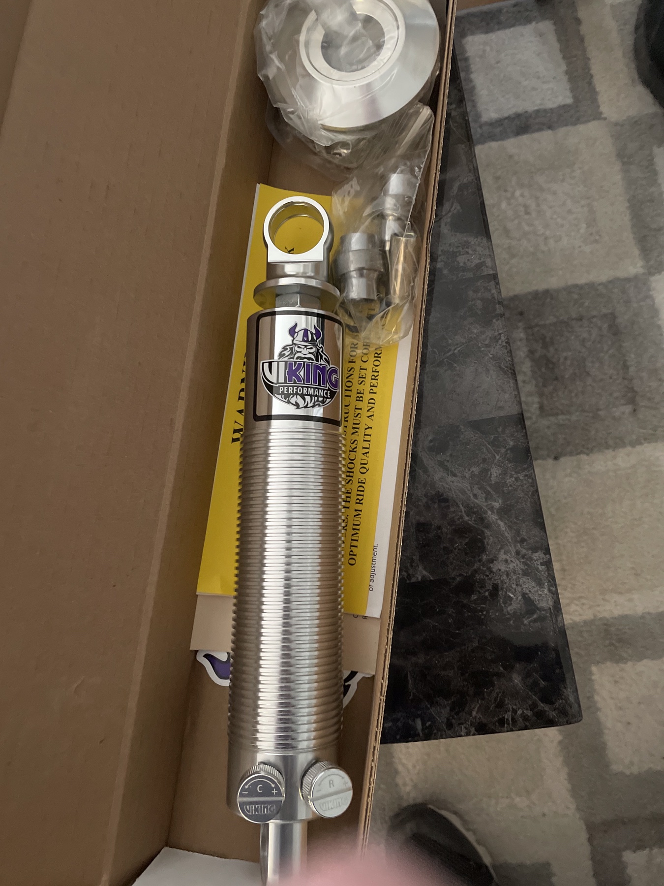

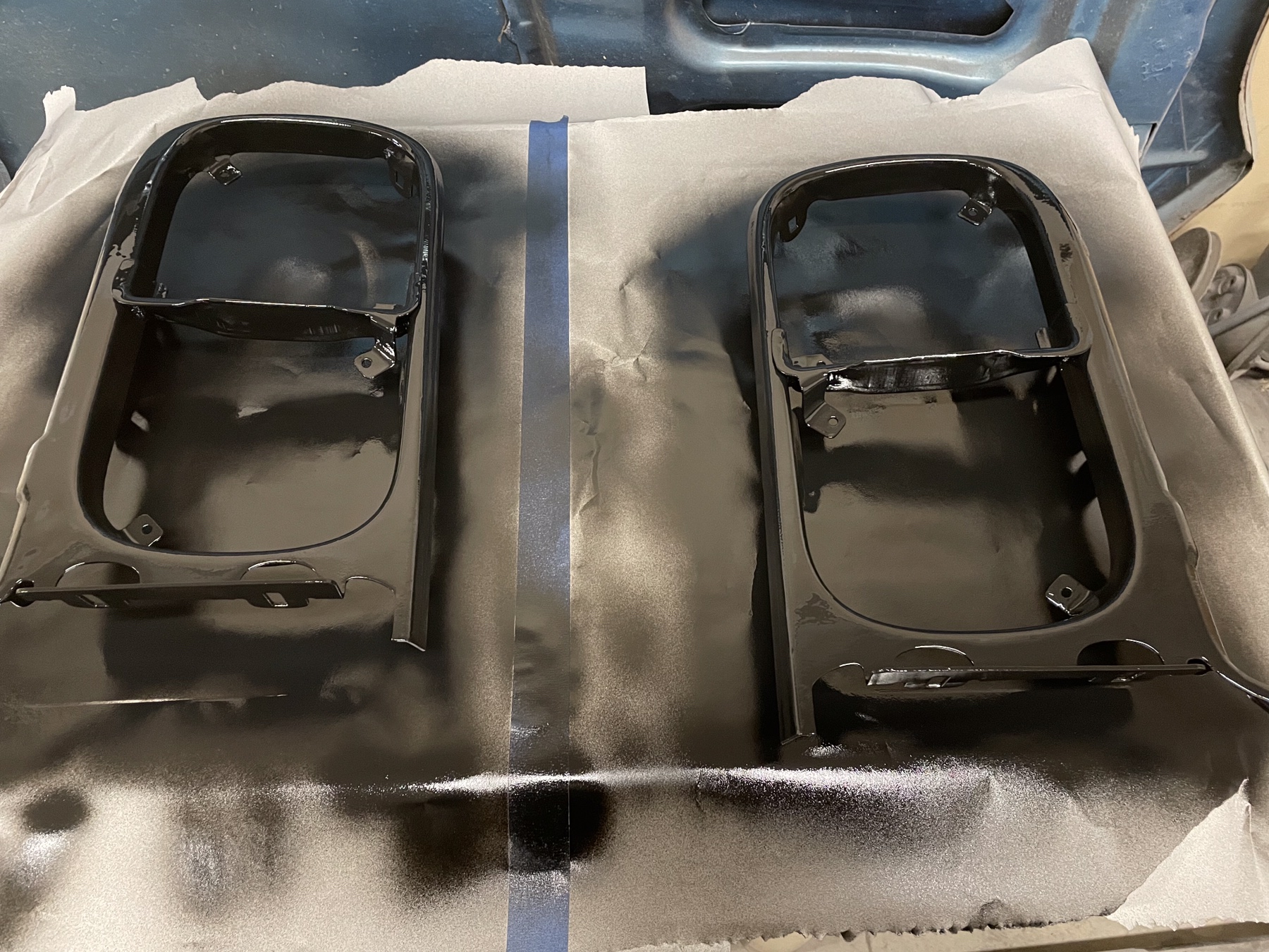

      Well that the way she is right now. I also repaired a frame I had to get. Just the mounts. Next is blasting all the bumper pieces and get them painted so I can start to fit the bumper to the front. I also pulled the trigger on suspension with a big thanks to Rod at suspension geek. I can’t wait till all these parts start to come. It’ll keep me busy for sure.
