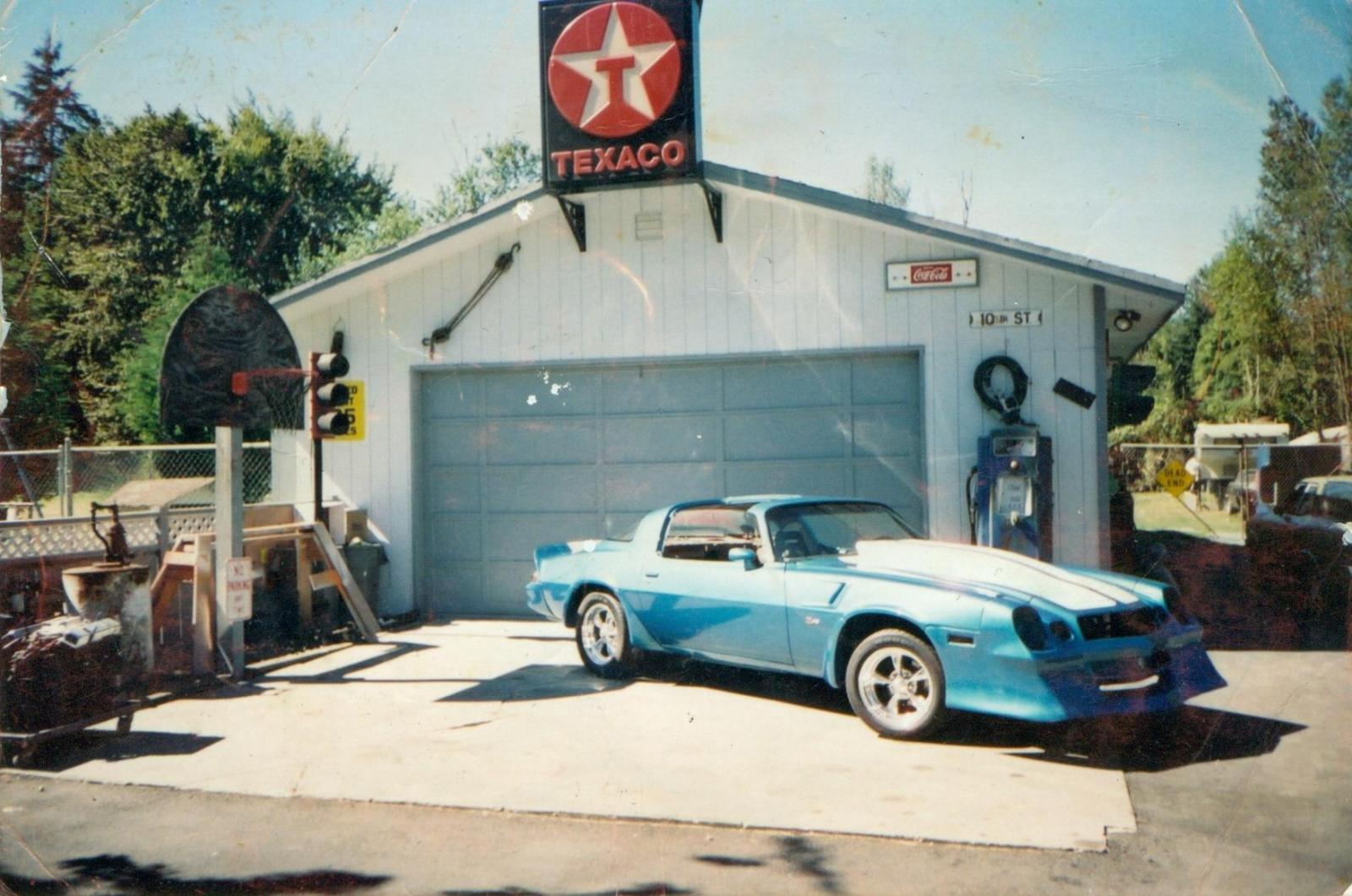

      You could look through the PT Garage for ideas You have to watch the curbs and driveways when you drive it on the street I found out the hard way on my 1979 Z-28 with an Fibremotive IMSA front spoiler.I have also seen cars with similar splitters like yours have a "diffuser" in back.Name:  130044932062378733.jpg
      Already have one planned.
