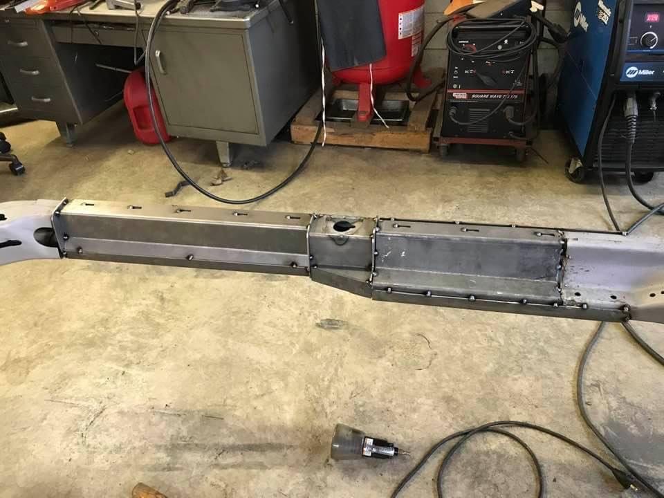

      Just a couple of updates on the buildName:  DD034C0B-3564-4B26-8DE0-8D6B985D8EAE.jpeg
Size:  139.4 KBName:  C2664BE5-6228-4CA3-A2C4-7EE57C7481F4.jpg
Size:  257.1 KBName:  FF1025DE-A106-493B-8565-1ECEB16D89CC.jpeg
Size:  182.2 KBName:  DD034C0B-3564-4B26-8DE0-8D6B985D8EAE.jpeg
Size:  182.2 KB. When I started you could lift a rear corner of the frame afoot and a half before the front would move. Now it takes about 2 inches.

      Frame upgrade
      I am amazed how much of a difference it made. I don’t know if it will change the ever day ride quality but it should handle the curves like crazy. Maybe someone will chime in on ride quality.
