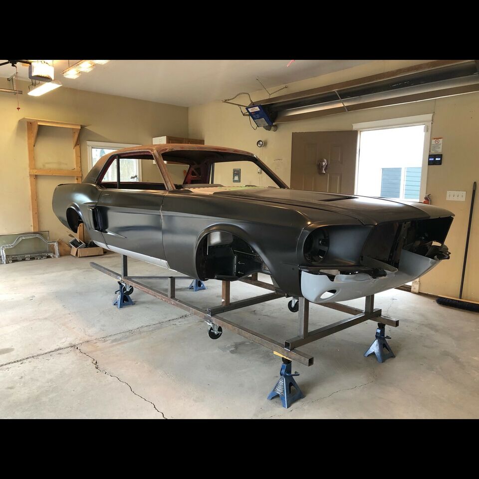

      Here are the pics from the ad: Anything black is new, so.. pretty much everything.

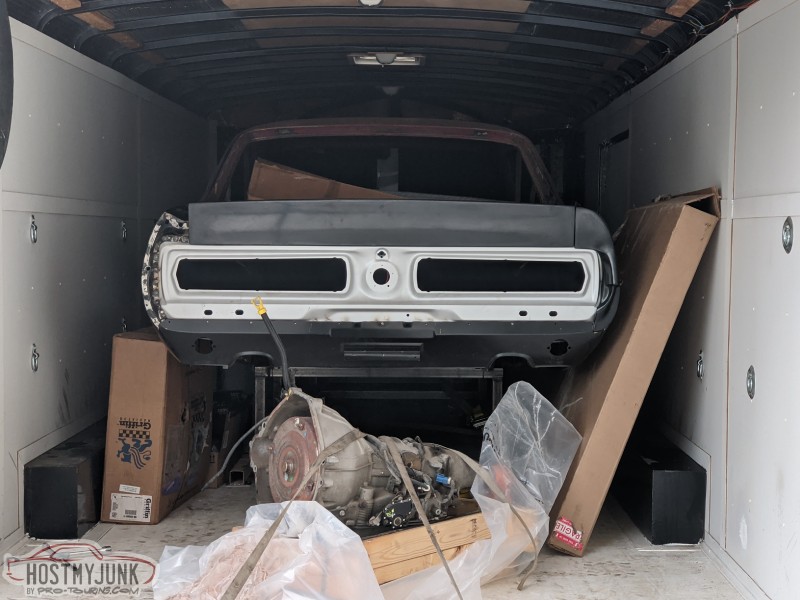

      Thanks everyone! The C4 IRS looks really promising, the only downside I see is the bolt pattern, but I'm sure there's a fix for that with some machining skill. Will have to do a little more looking, but that's a great lead thanks so much!

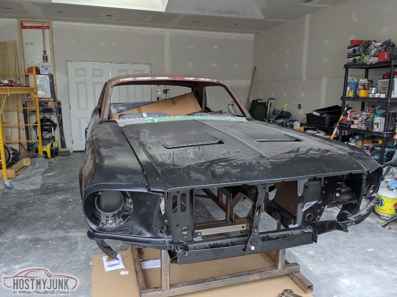

      Some more pics of the car as it was waiting at my brother in law's house waiting to be picked up.
      See you tomorrow night Eleanor, you and your fine a$$

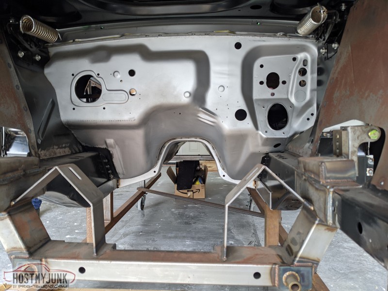

      Good shot of the front crossmember

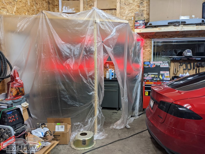

      First things first when engine building, cleanliness is key! I know it's ghetto, but it will keep the dust out.

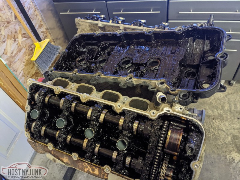

      Struggled for an hour to get the first valve cover off, and here's what was lurking below! It turns out you can make glue from dead dinosaurs, not just dead horses.

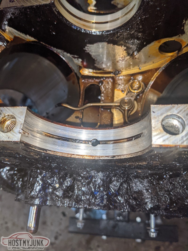

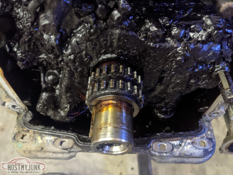

      Yuck. Out of high school I worked at an engine machine shop for a couple years. Had to smash some pistons out of a block with a sledge, but never, ever saw anything like this.

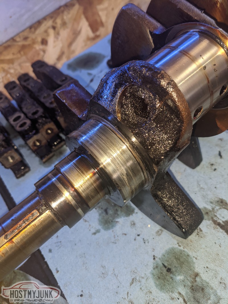

      The block had a spun front main, so is a boat anchor I'm told. Shame really, because somehow the cylinders were in really good shape. I gotta say, modern engines are really impressive.

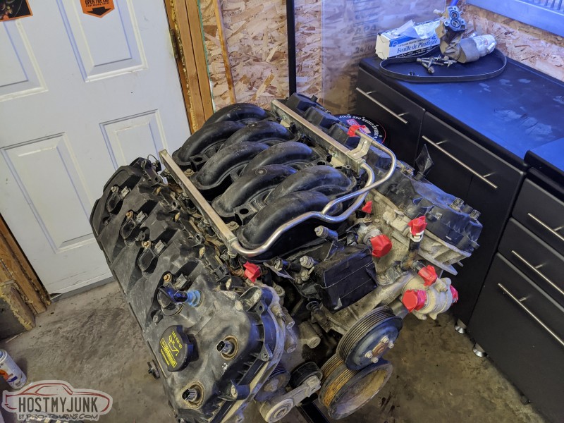

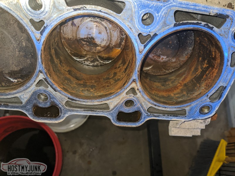

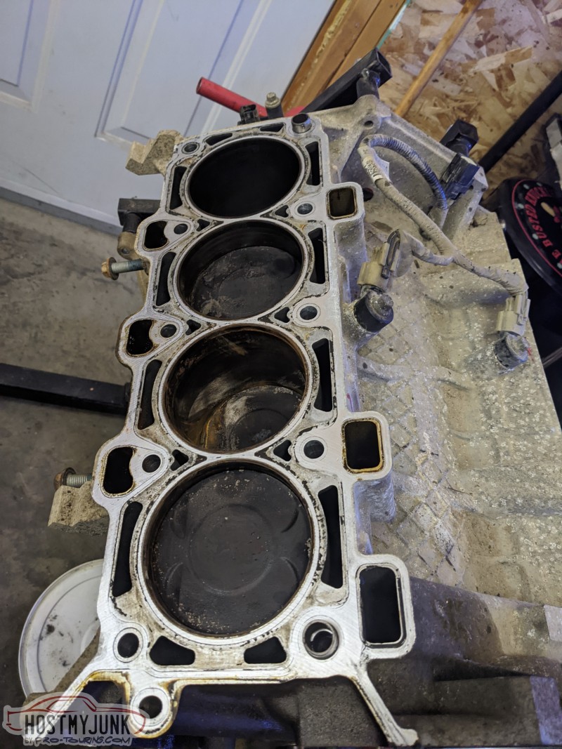

      Deja vu?? Nope, just a replacement engine. Travelled 6 hrs north to pick this up, because Canada. I'll just say right now, if you live anywhere in the continental US, be thankful. You can get parts relatively easily, and almost always free shipping. More on shipping next post. Oh and if you do live in the US, Happy Thanksgiving!
      This is a 2011 F150 yote this time around.

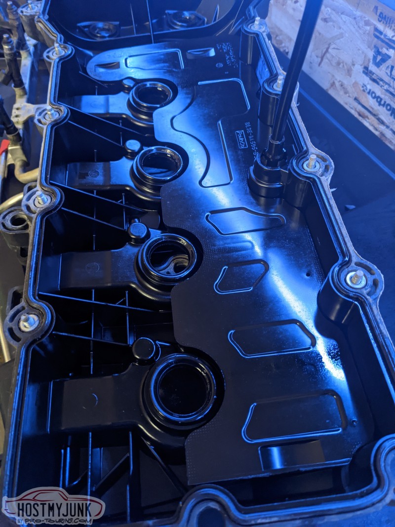

      This time did not take an hour to pull a valve cover.
      What's up DOHC?
      This is what's up. Water in the cylinder. Because 2020, why the F not?

      So the engine is at the machine shop at the moment. Just waiting on them to check out the heads, then going to order pistons and rings, and whatever the heads need. Going with stock replacement stuff for now, and if I'm looking for more power in the future I'll add cams. After I'm comfortable racing and have the bugs worked out, then maybe a higher HP NA engine build will happen. But for now, trying to reduce sticker shock haha

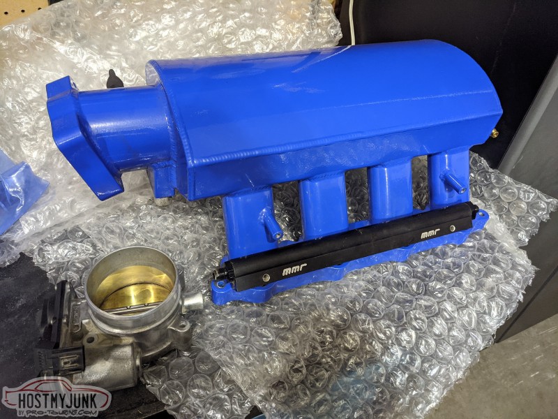

      Here's the intake I got with the engine, which was almost worth the admission price on it's own. It's an MMR Road Runner, powdercoated by the PO. It's meant for boosted applications, but should bring the power band up the rev range, which will help for road racing. Came with the billet fuel rails. Maybe I should look at phenolic spacers?

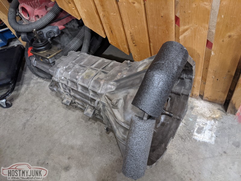

      Also picked this up from the same fella as the engine. 2002 Mustang TR-3650. EvilNoir originally came with a 4R75W, but auto's are gross. Manual for life! Says the guy who's daily doesn't even have a transmission haha
      So anyway, this should be a good trans for the application. I'm planning to use a RAM aluminum flywheel and HDX clutch and Summit Racing short throw shifter.
      Oh and my boy smashed his shin on it, hence the foam insulation haha

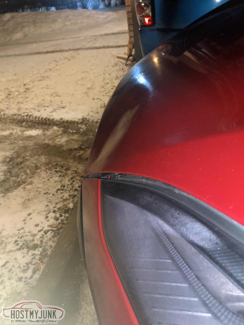

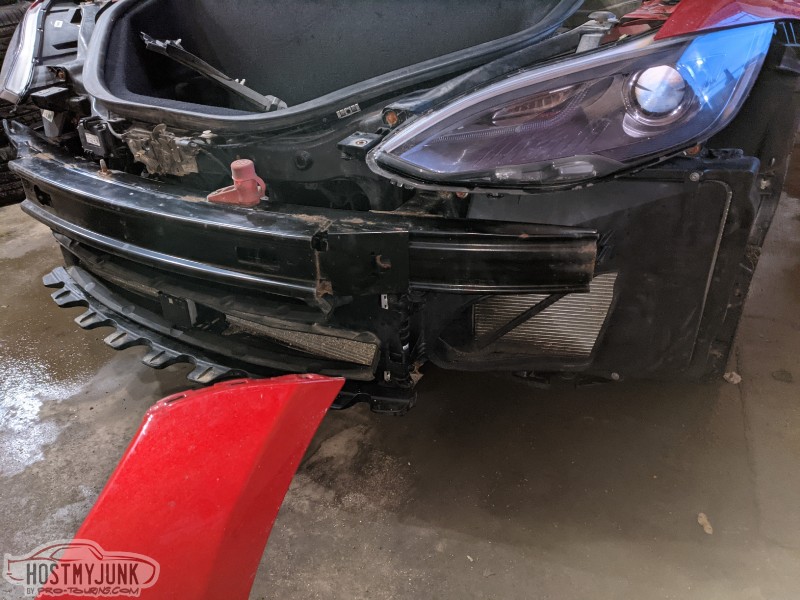

      Saturday I smoked a deer, and not on the Traeger! With my Tesla. :( But the damage isn't too bad, turns out it just needs a hood, and a couple little trim pieces around the bumper. Could have been a lot worse, the deer was 5 ft in the air and travelled maybe 30 ft or so. Glad it didn't come up and over.

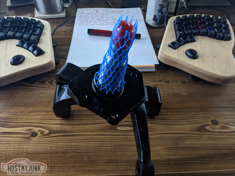

      Got more bad news on Monday, the 2011 Mustang 13.2" Brembo's I bought for the front of the Stang have been lost. The salvage yard didn't have good inventory, so they gave me my $ back. But now I need to find brakes because I already have the hubs for the swap. Unfortunately this was the only set listed in western Canada. I could go with the 12.5" set, but the calipers are only 2 piston and I've heard of people boiling the fluid during track sessions. Does anyone have experience with the base model brakes on a road course?
      Here are the hubs and the Mustang II 2" drop spindles.

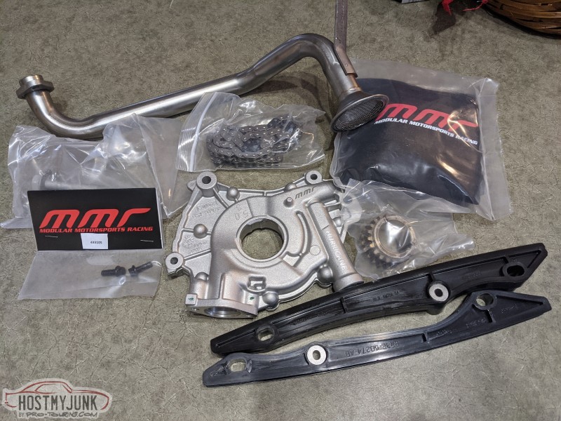

      This morning I did receive some engine goodies though. MMR high volume oil pump and pickup and a couple wear items for the engine. Having trouble finding rod bolts and main bolts, as I'm sure they are TTY. Looking for factory replacements if anyone knows where to get those.
      Oh, and that thing about shipping in my last post... brokerage from UPS for this order was $130. FU UPS! I can't wait for the borders to open again so us Canadian car guys can get our parts shipped within the US again.

      16,120
      The pictures of the first engine are rather remarkable. How can the inside of an engine get so sludged up? Did the people just NEVER change the oil?
      Nov 2018
      968
      Looked like a possible farm truck engine to me. A lot of slow driving, never warmed up, probably a non-detergent oil used. And, probably not changed often enough.

      As for the engine, I don't even know guys... No oil changes ever and probably some kind of junk additive like stop leak or something. I scraped as much sludge off it as I could and then the machine shop put er in the jetwash for 9 hours. There's still a bit of sludge on there, but it's mostly clean now haha

      That doesn't look too difficult at all. Good find, thanks for the info!
      As dumb luck would have it, I found the link to this build on here!
