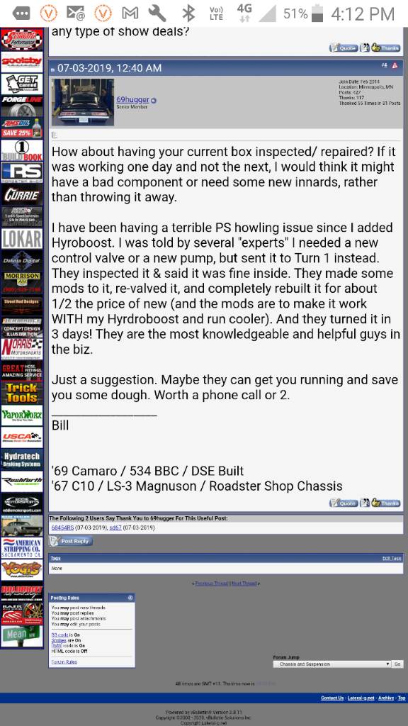

      Check this from Lateral-GName:  Screenshot_2020-11-13-16-12-16.jpeg
