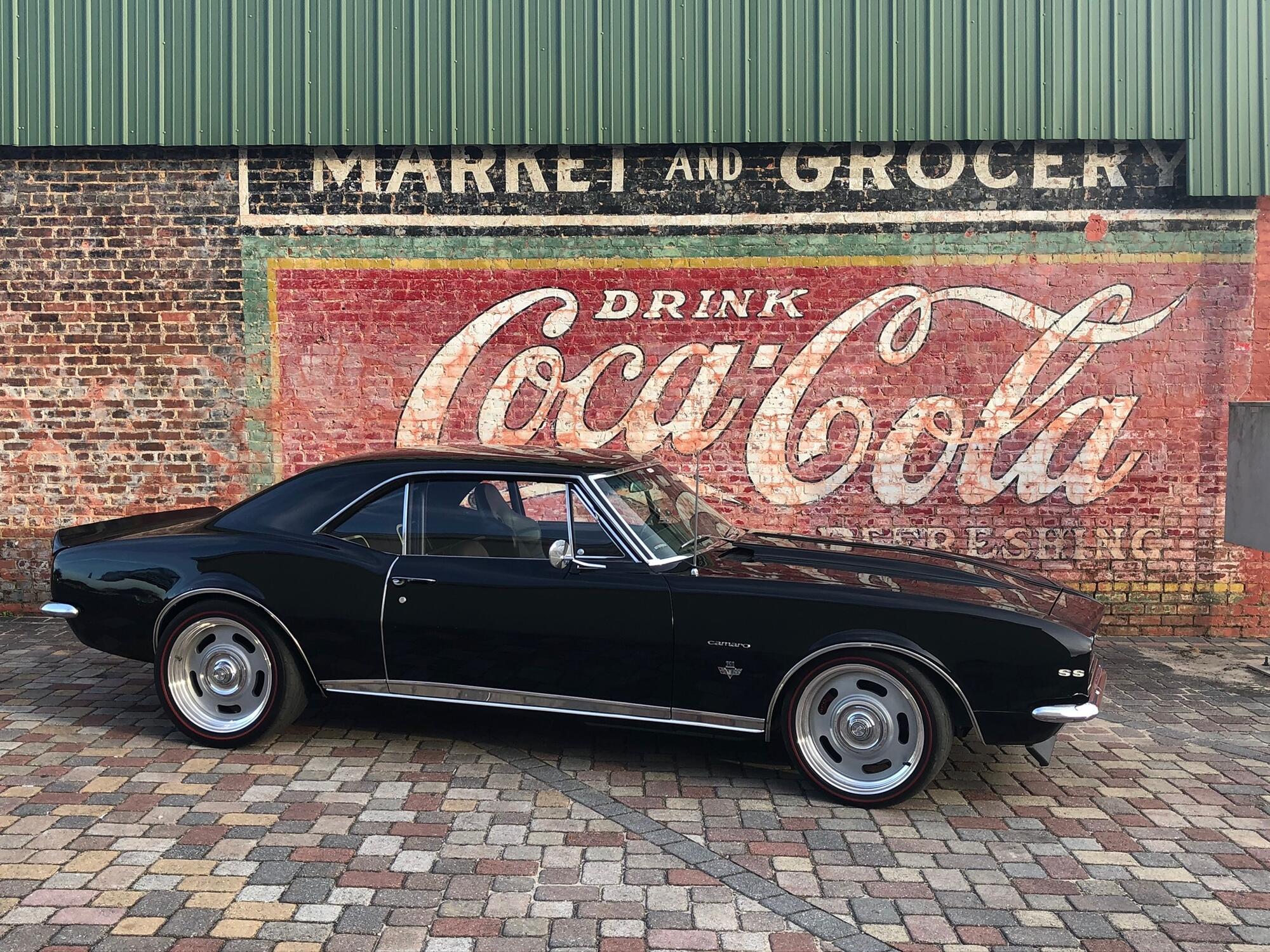

      I have Circle Racing Series 90 wheels 18x9.5 on my Camaro. I bought mine back in 2016. At that time Circle Racing was in California. I know their website was offline for a long time, but recently seen it back up. Them moving to Texas is news to me.
      The wheel is very strong. I had my wheel lips polished and the centers brushed so I could paint the centers. When I bought mine they would do custom backspace.
      When I was shopping for my wheels, I also looked at the Wheel Vintiques and Rev 107s. The Wheel Vintiques had a limitation on brake size on the inside. The Rev 107 I saw at a car show and I wasn’t happy with the quality, the Wheel was thin and the edges were sharp to the touch on the inside.

      First of all Brian your car looks abselutly smashing ! And that background. I Love Camaro and Coke - What a photo
      If yours is an RS mine is 100% like yours from the outside right down to all the moldings.
      Wheels look so good! They look little different though to the ones first in this thread. Can this be down to front wheel sizing and back spacing ?
      What size are you running in the front and what backspacing front and rear ?

      Thanks for the compliments! My Camaro is a true RS car, but not much else left original.
      I’m sure size and backspacing would change the appearance slightly from wheel to wheel. Mine are 18x9.5 front and rear. 6” backspace in front and 5.5” backspace on the rear. It took a lot of metal working to the fender and inner wheel well to fit 275 tires in front and I still scuff the frame at full lock.
