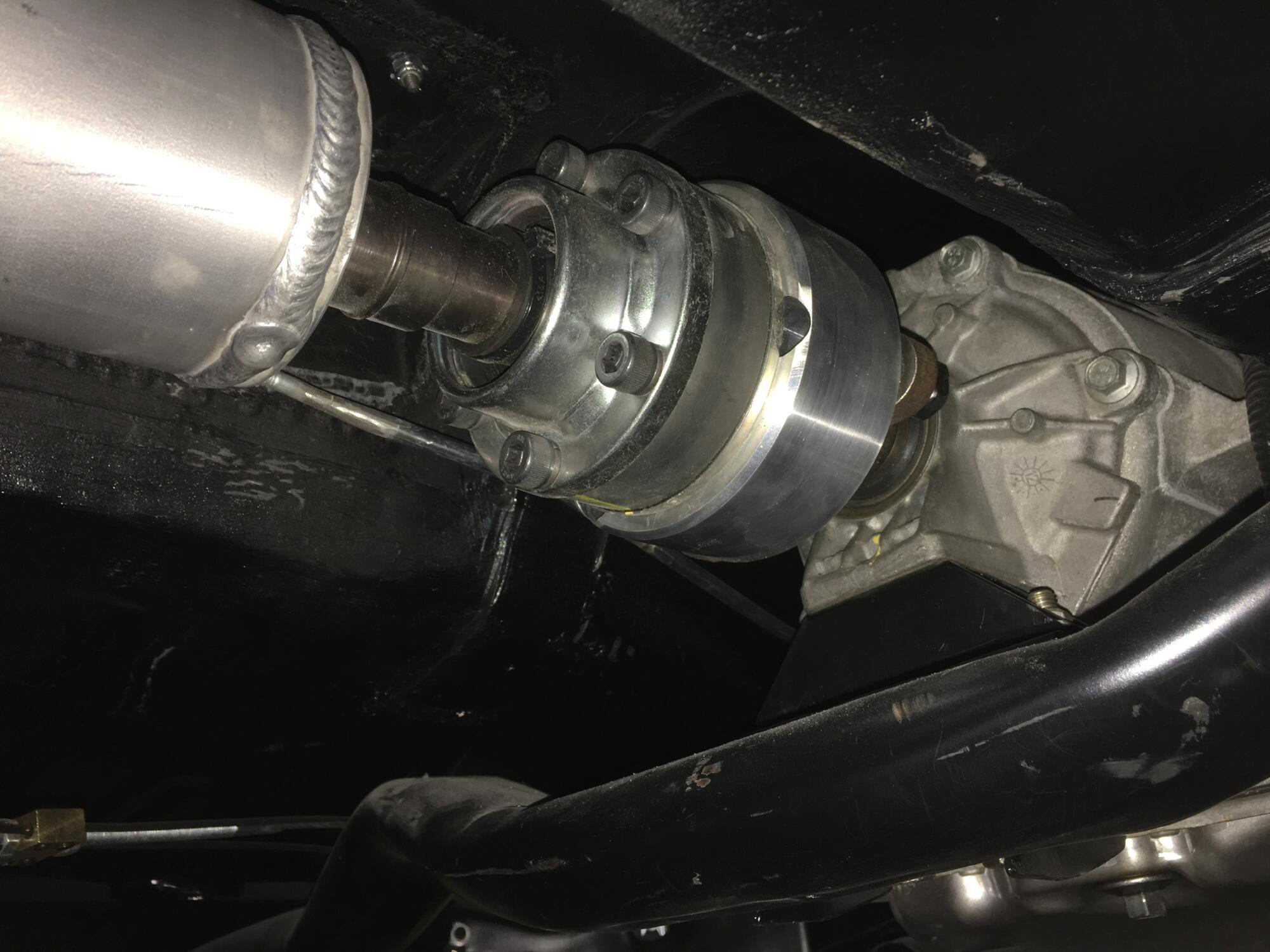

      Did you order/receive your driveshaft yet? I bought mine from DSS a few years ago. Mainly because my transmission has no slip yoke but my trans yoke is also lower than my pinion yoke. It works perfect.

      Is this in a live axle car? How much slip is in the shaft?
      About an inch
      I agree with Andrew; about an inch of movement. Which when I was told this by DSS I was like WTF, that痴 not enough. He told me to look at the yoke on my old shaft (from the power glide trans) and I would see that the wear pattern would be all concentrated in a very small area.
      It was and I致e had no issues with the shaft so far.
