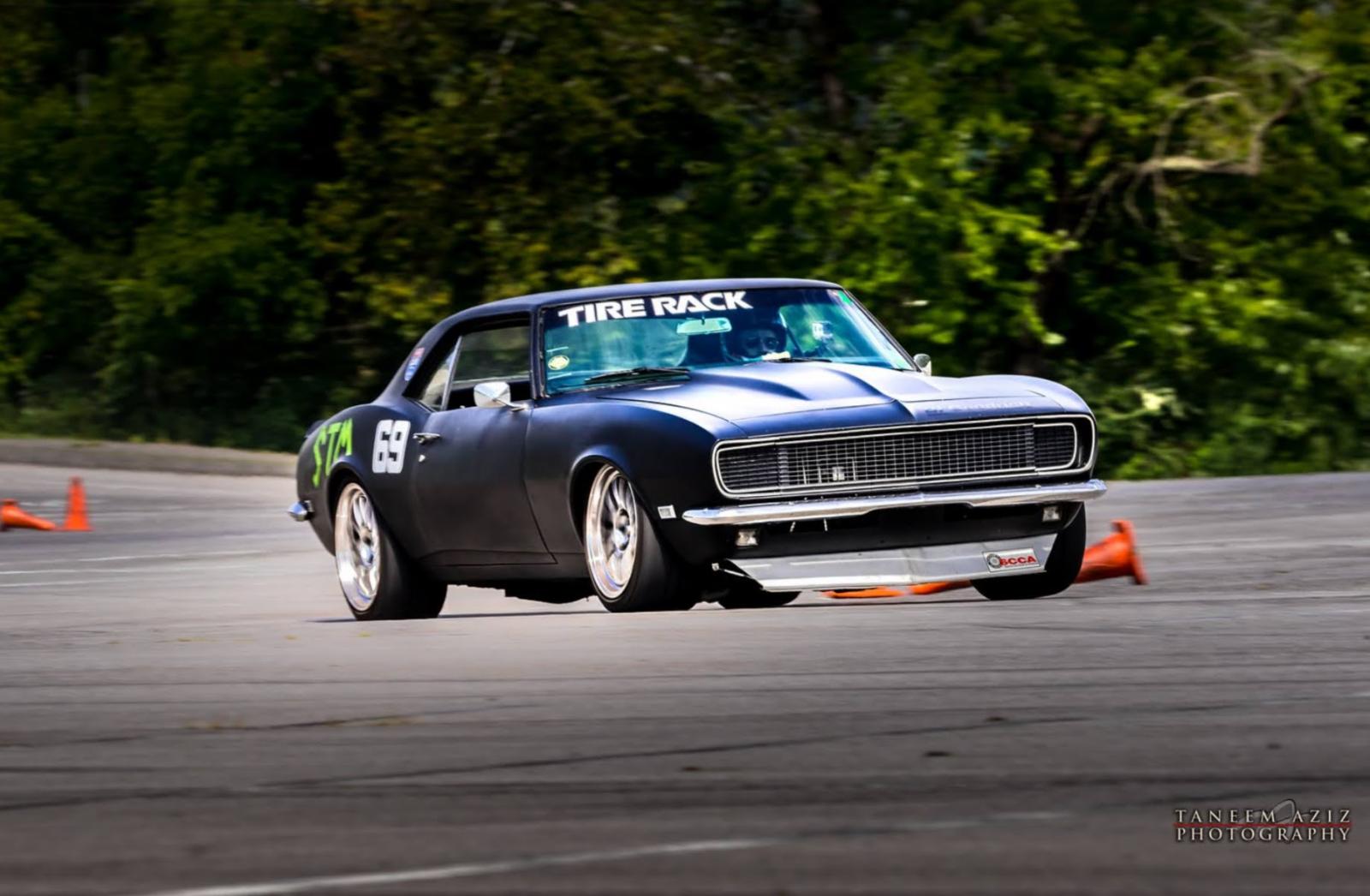

      The course was definitely friendly to putting down power, but there were certainly places where alot of cornering force was being generated.
      Here's a picture showing the front suspension compressing as it should.

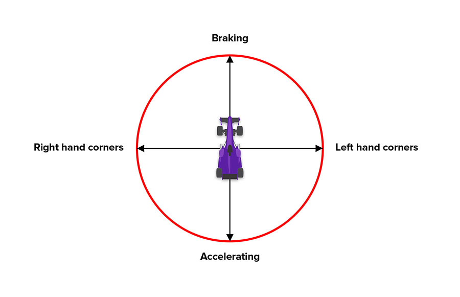

      If we have excess traction, or grip, available in the rear, what can we do? Lets look at the circle.
      A tire gives us 100% available traction in any given direction but if we ask the tire to multi task it has to split up that 100%. So there we sit in our rear wheel drive car as the front tires grind away wondering what can we do to loosen the car up. The answer is underneath your right foot. By using the rear tires to accelerate the car, we remove available lateral grip from the rear tires and then we achieve balance. You can pick up the throttle earlier and harder and will carry more speed to the next element.
      TL;DR More front spring, lower rear roll center, step on the gas.

      Yes, the traction circle tells us there is meat left on the bones in the rear; however, I am mainly having understeer issues on corner entry and mid corner, no corner exit. It is difficult to use the throttle to induce less understeer (more oversteer) in the middle and entrance of a corner. I do understand your point regarding conserving rear grip for throttle application since the car is RWD, but as of now I have plenty of rear bite.
      As you and many others have said before, loose (oversteer biased, more front grip than rear) is fast because the car rotates. The car was very tight. Making it tighter will make it - and me - slower, in my opinion.
      More front spring does not appear to be the solution, in and of itself at least, from what testing has shown. The rear is too soft - or the front is too stiff depending on how you look at it. Either way the two axles weren't working together before, and now they are working better with one another.
