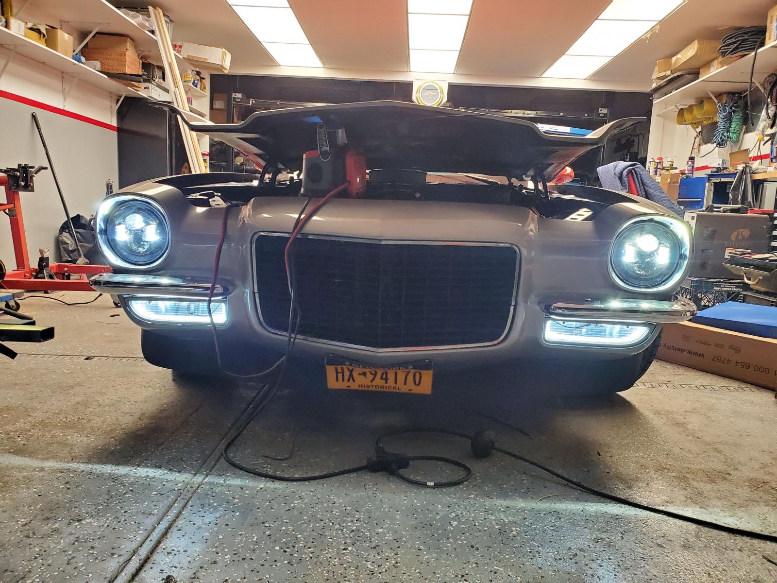

      I used those LED strips too on my '71

      Nice use of the products out there. The only questionable part is holding up the heat and the elements (keeping them sealed up)
