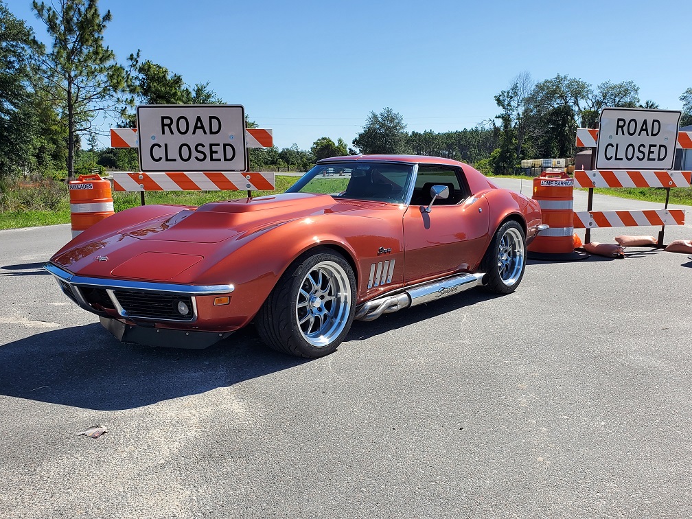

      at a more proper ride height and with the brakes actually working!!

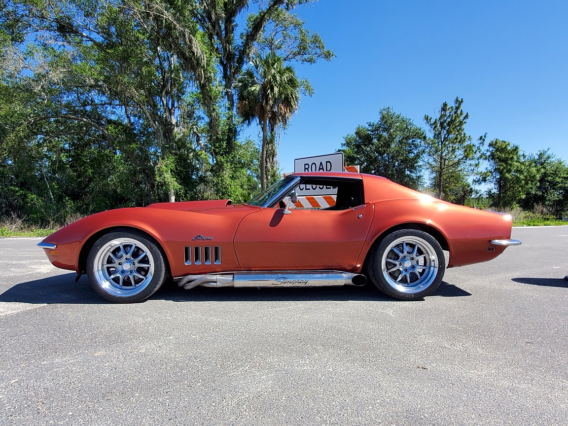

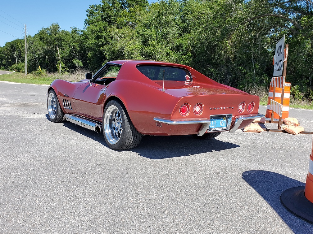

      Do you have any direct side shots yet? Want to see how the 35 fills in the rear quarters ��
      May 2018
      103
      something like this?
