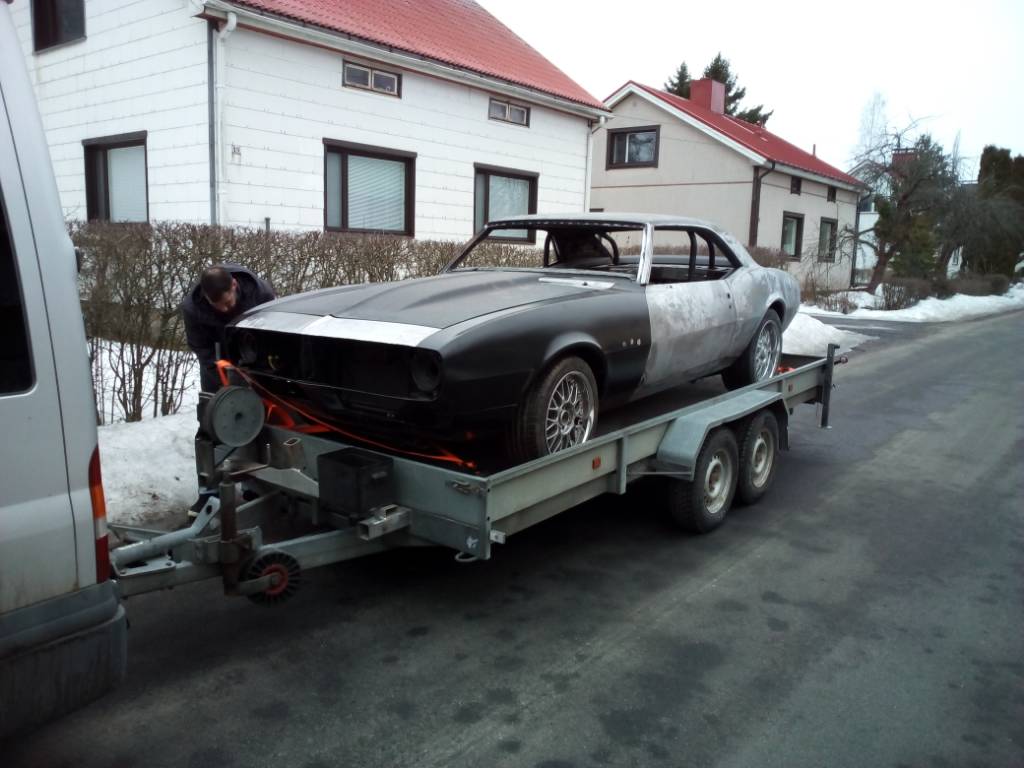

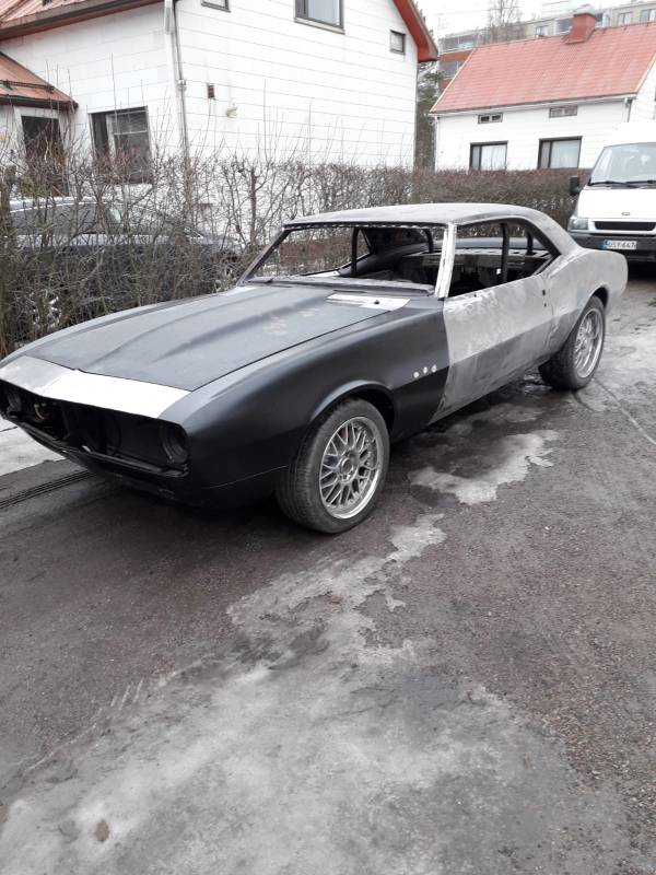

      This is where i startedName:  IMG_20171119_123007.jpeg
Size:  97.4 KBName:  IMG_20190123_194257.jpeg
Size:  83.9 KBName:  IMG_20190113_120327.jpeg
Size:  88.0 KBName:  IMG_20190217_113922.jpeg
Size:  77.9 KBName:  IMG_20190216_112157.jpeg
Size:  79.7 KBName:  IMG_20190108_160322.jpeg
Size:  76.7 KBName:  IMG_20190114_191835.jpeg

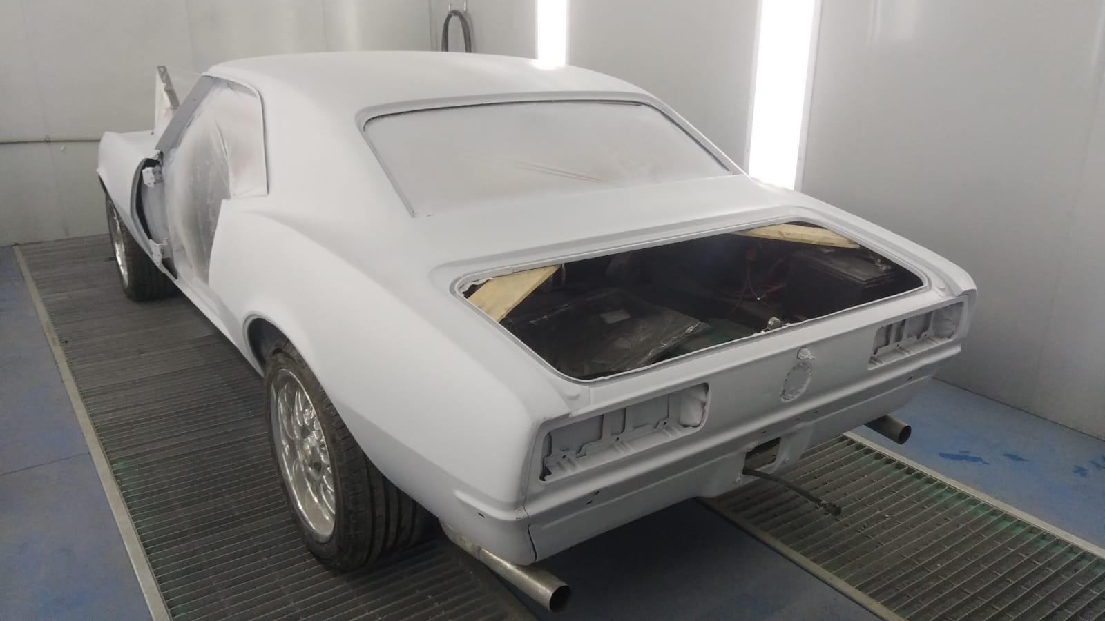

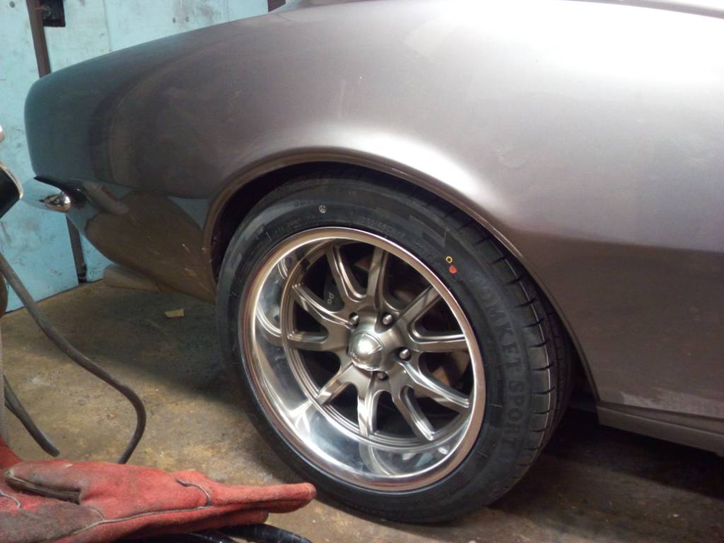

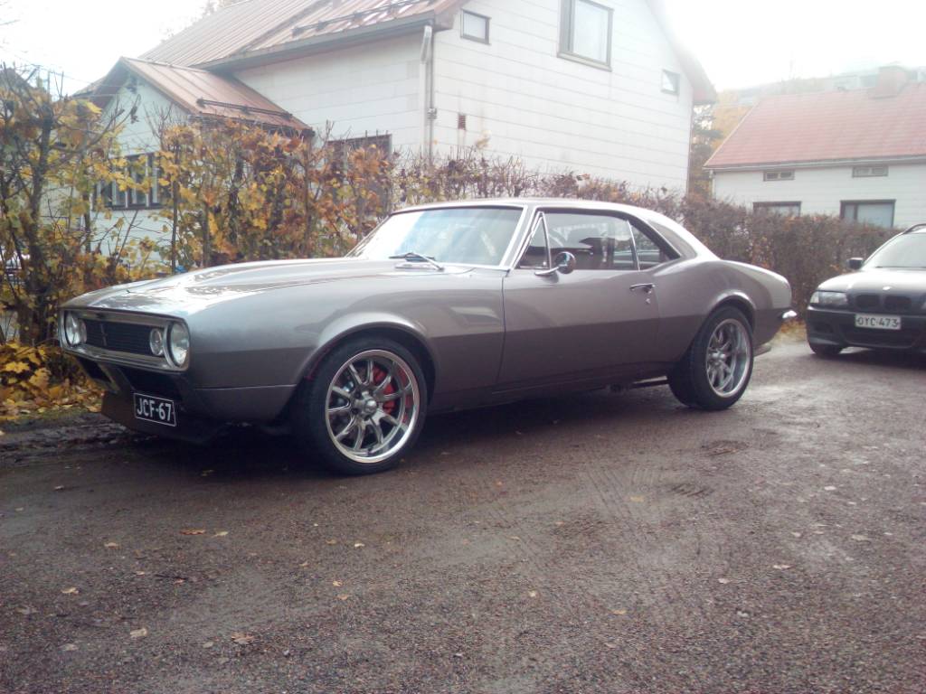

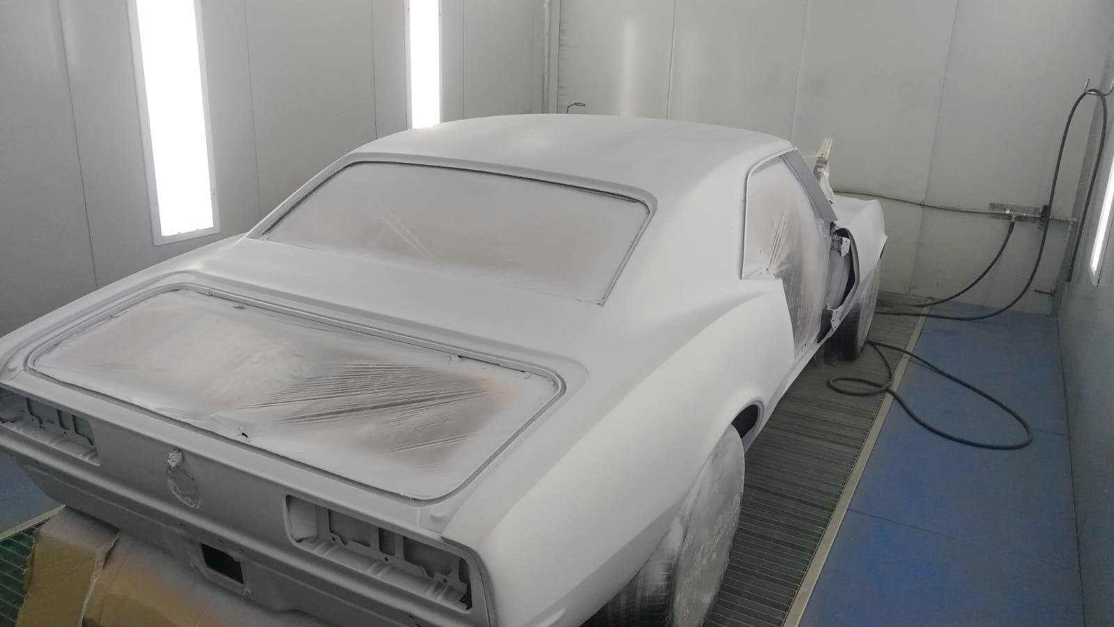

      Paint photos, engine etcName:  IMG_20190626_173152.jpeg
Size:  56.9 KBName:  IMG-20190406-WA0010.jpeg
Size:  91.5 KBName:  IMG-20190406-WA0009.jpeg
Size:  105.0 KBName:  IMG_20190824_172852.jpeg
Size:  71.0 KBName:  IMG_20191019_145915.jpeg
Size:  105.0 KBName:  IMG_20191018_171824.jpeg

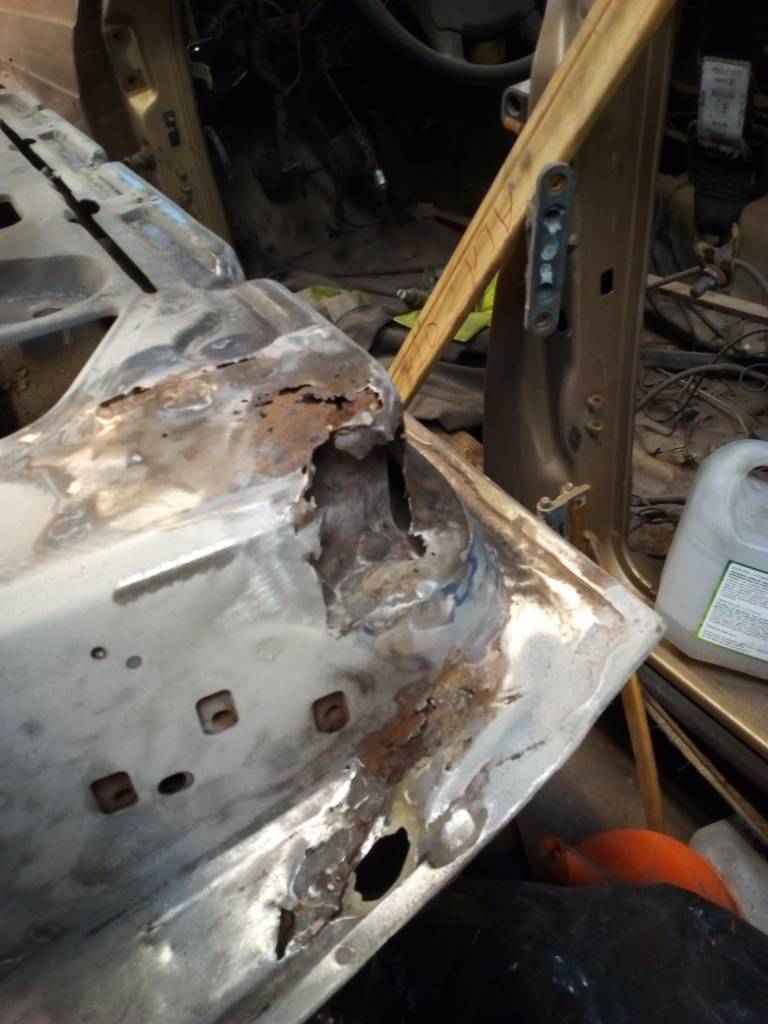

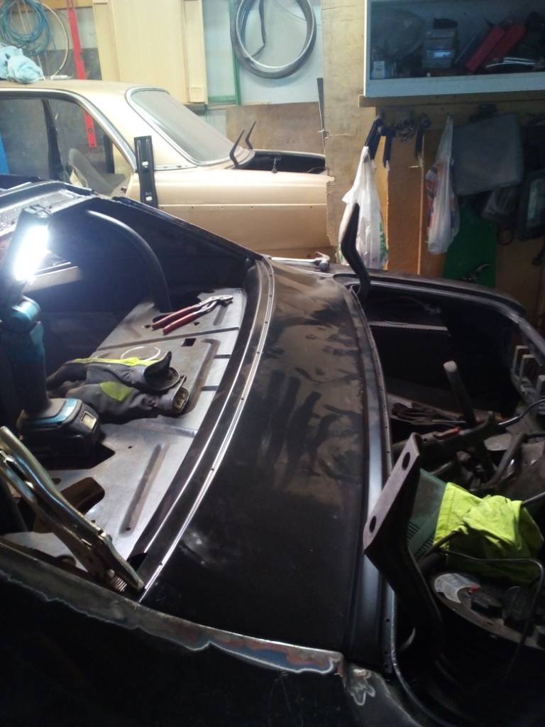

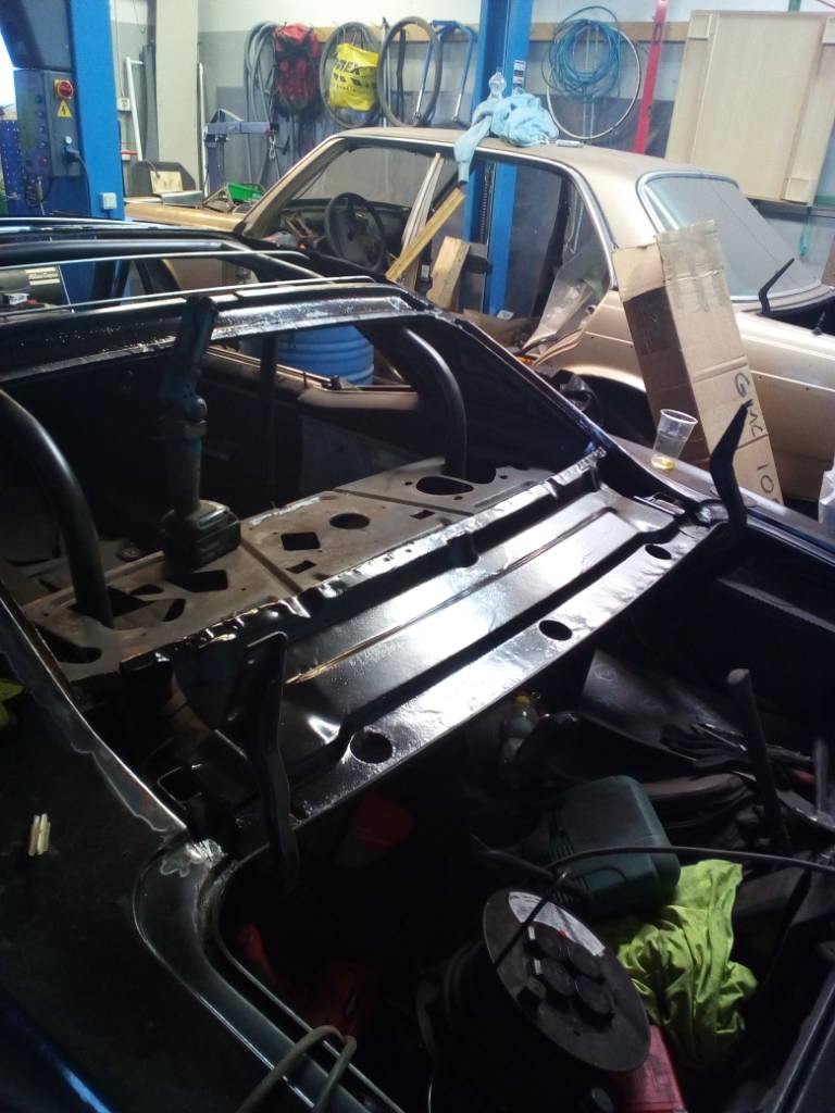

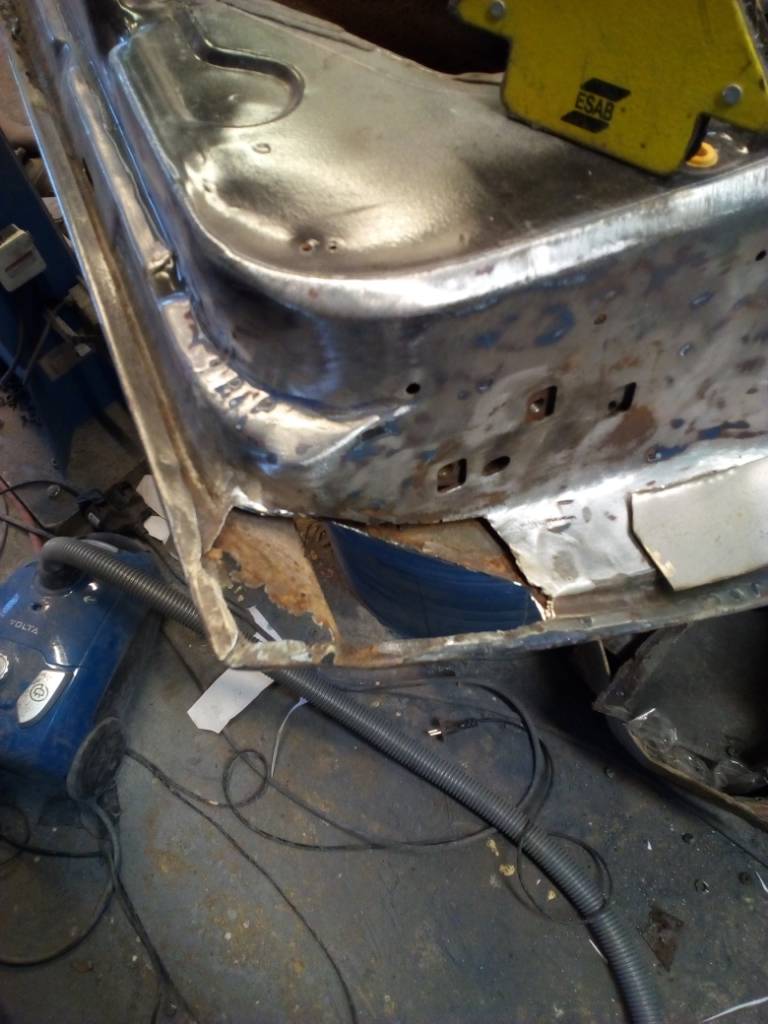

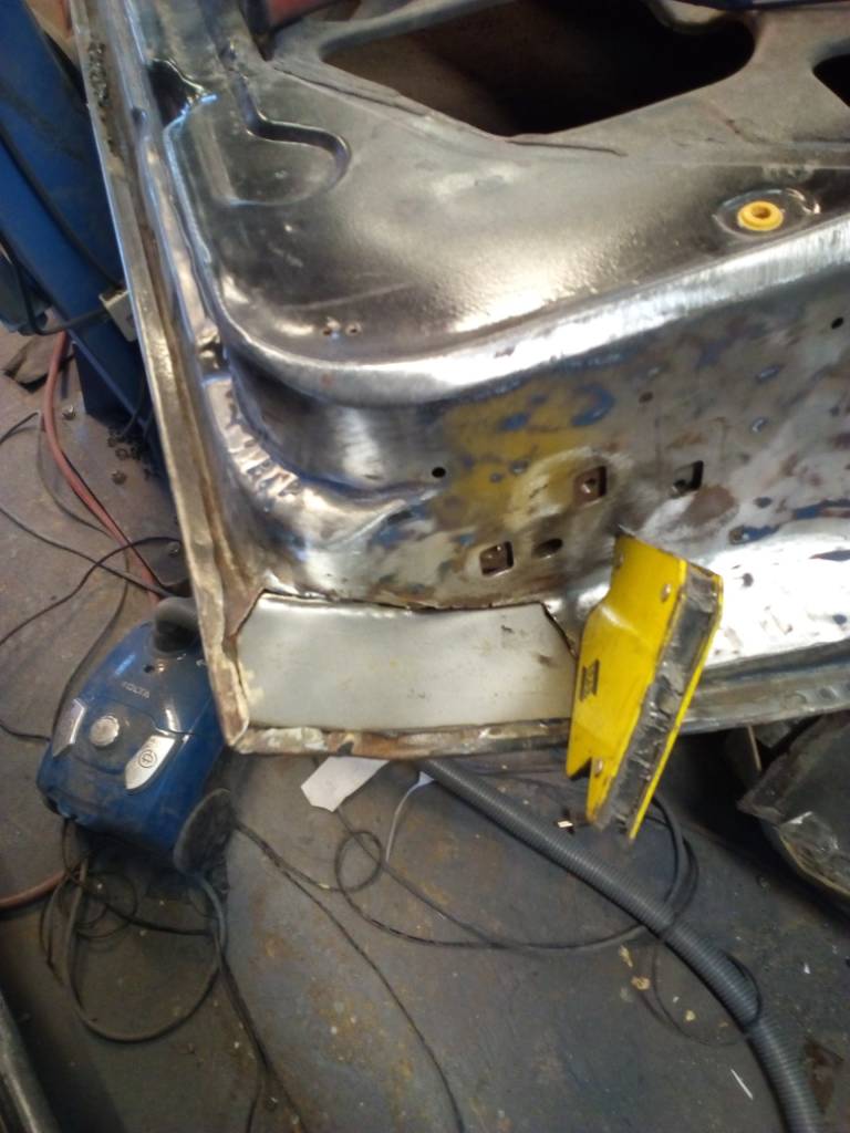

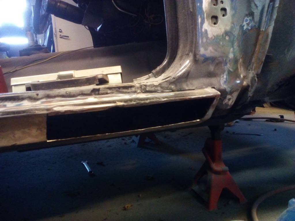

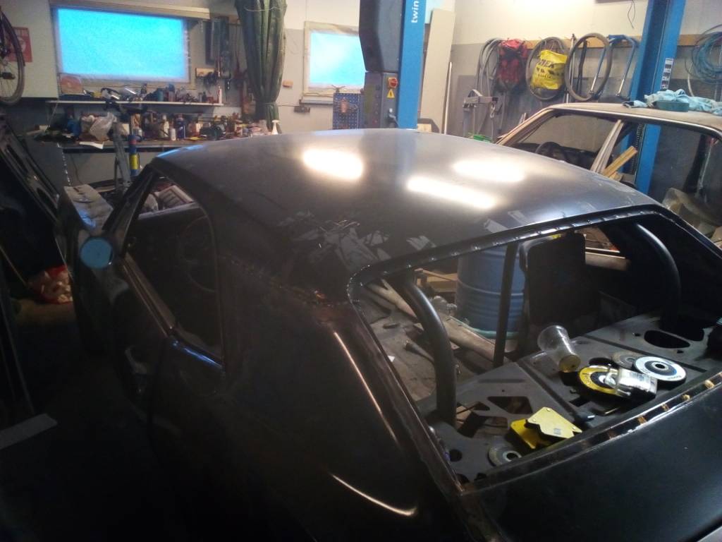

      There was More rust but did not take pictures. Both firewall To the floor connections were totally rotten away.
      Rear panel had 3 patches, Both Doors were really bad and the right Side had big dent In the center and had hole In the center of the dent. Also Both Doors were rotten in the gasket area and had To weld quite amount New metal In there.
      Front fenders, trunk lid, hood and the top had To be replaced because of the amount of rust.

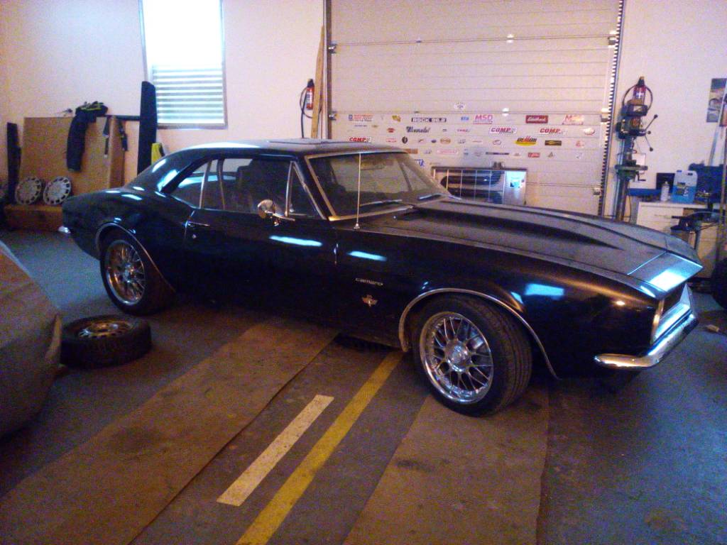

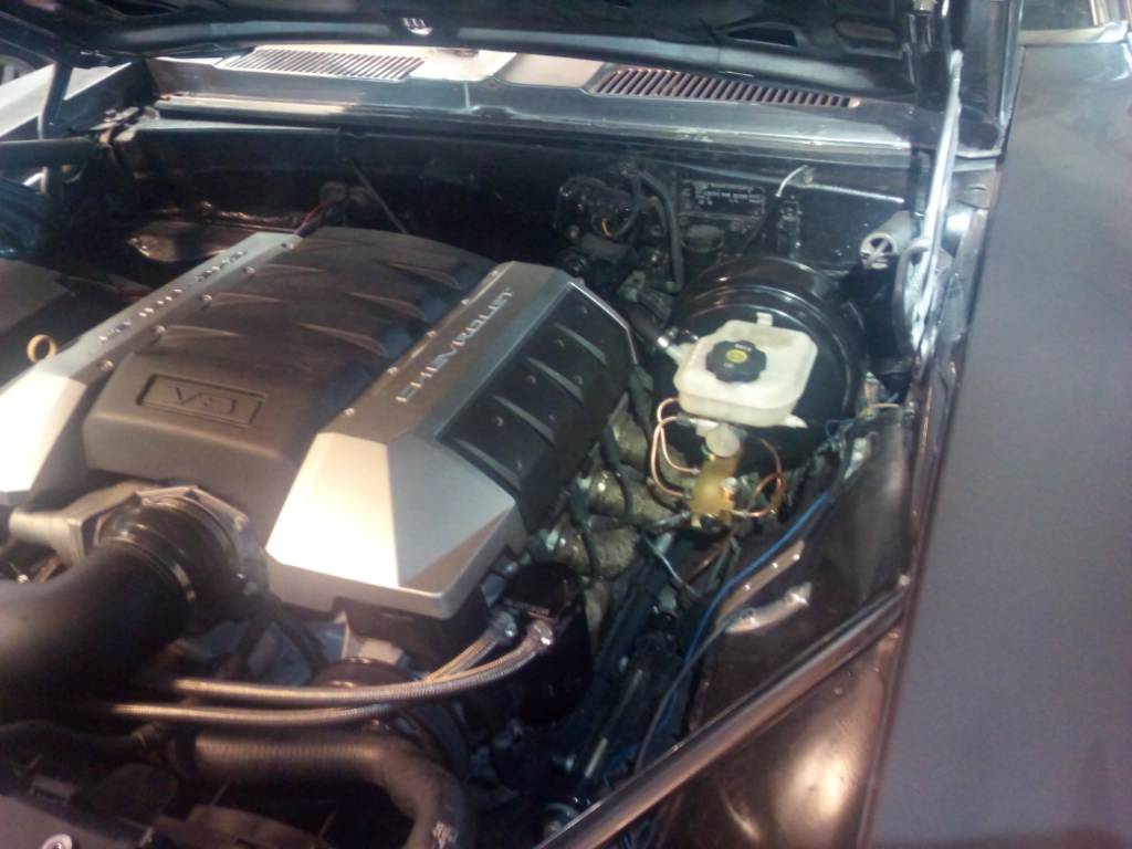

      Car has ls3 from 2013 camaro and tr6060 from the same car. Fab9 rear with 4.10 gears, caltracks, subframe connectors, c5 front brakes, 2013 camaro booster, wilwood 11.5" rear brakes.
      4 point roll Cage, 4point seat belts and sports seats. GPS speedo and my own made panel for those. Tablet mounted To the center console where shows ecu data etc what you want To watch.

      Country Flag: Finland

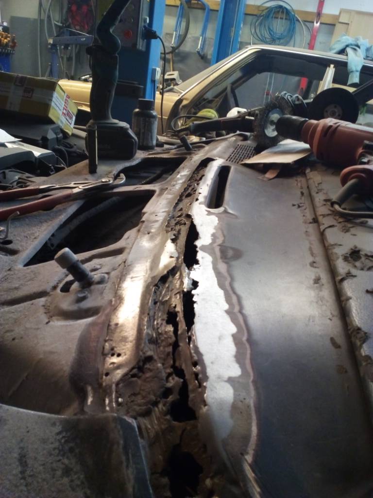

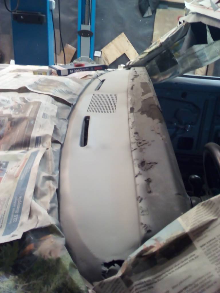

      Rust where all over the carName:  IMG_20190209_153500.jpeg
Size:  71.3 KBName:  IMG_20190216_130639.jpeg
Size:  57.5 KBName:  IMG_20190217_111622.jpeg
Size:  74.2 KBName:  IMG_20190216_112139.jpeg
Size:  75.5 KBName:  IMG_20190113_141631.jpeg
Size:  74.6 KBName:  IMG_20190105_130615.jpeg
