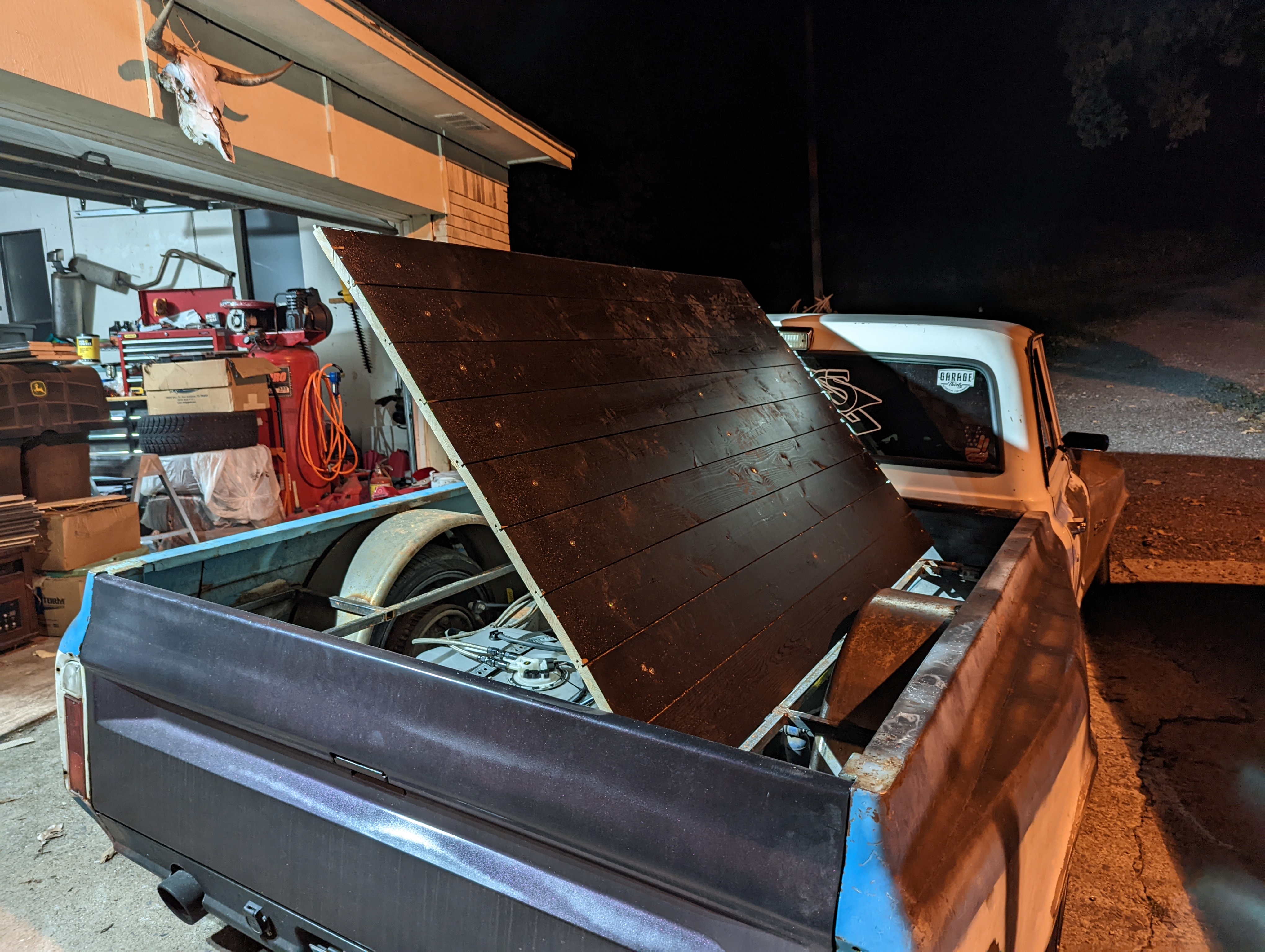

      Put something together for the bed floor Before Sparks in the Ozarks show, its not any where near complete.
