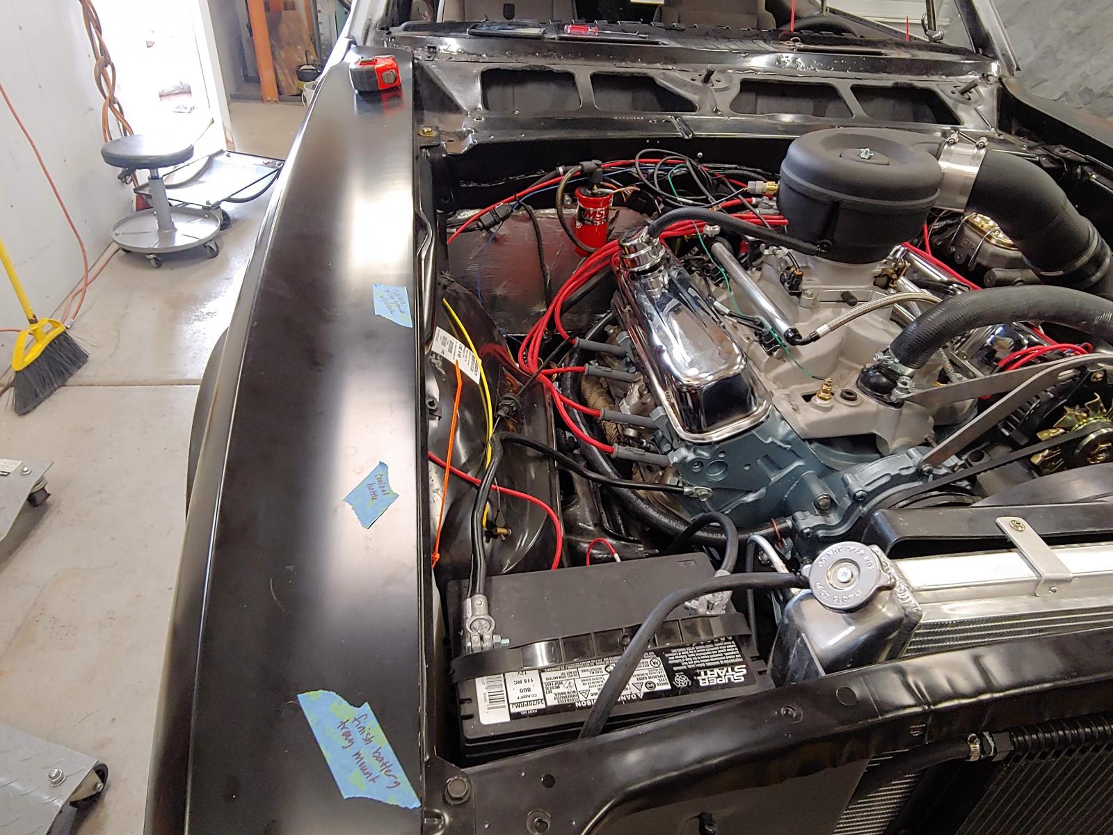

      This week was knocking out a few little tasks to get the car buttoned up enough to take her to the Transmission shop.
      Temporarily zip-tied in the gauge cluster since we will need to get back into the dash later. We still need to install the dash pad and clean/refurbish the gauge assembly. I was bored due to the goings-on so I took a video with cabin engine noises.
      We finally got the pieces together to route the air intake a bit better. The bracket did end up touching the upper radiator hose so we fashioned a little cushion from leftover hose.

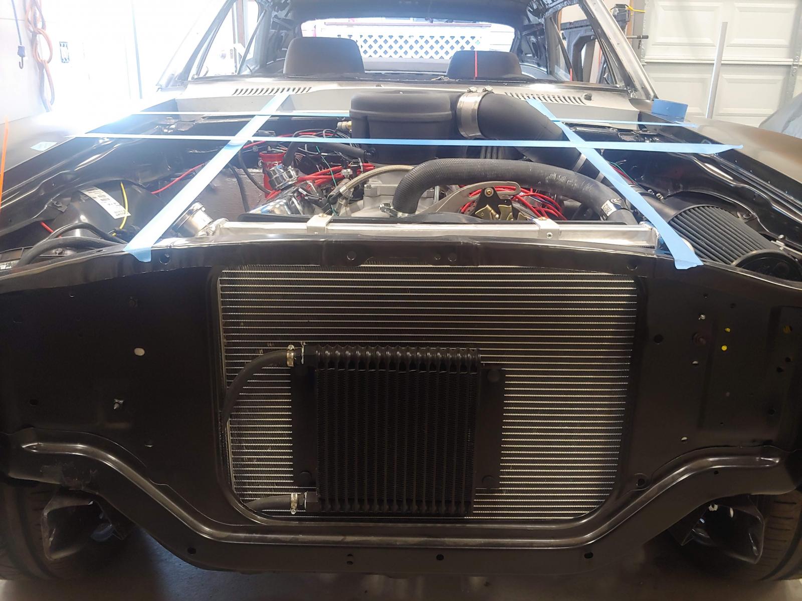

      Before that, I taped out some boundaries to try to figure out the hood situation

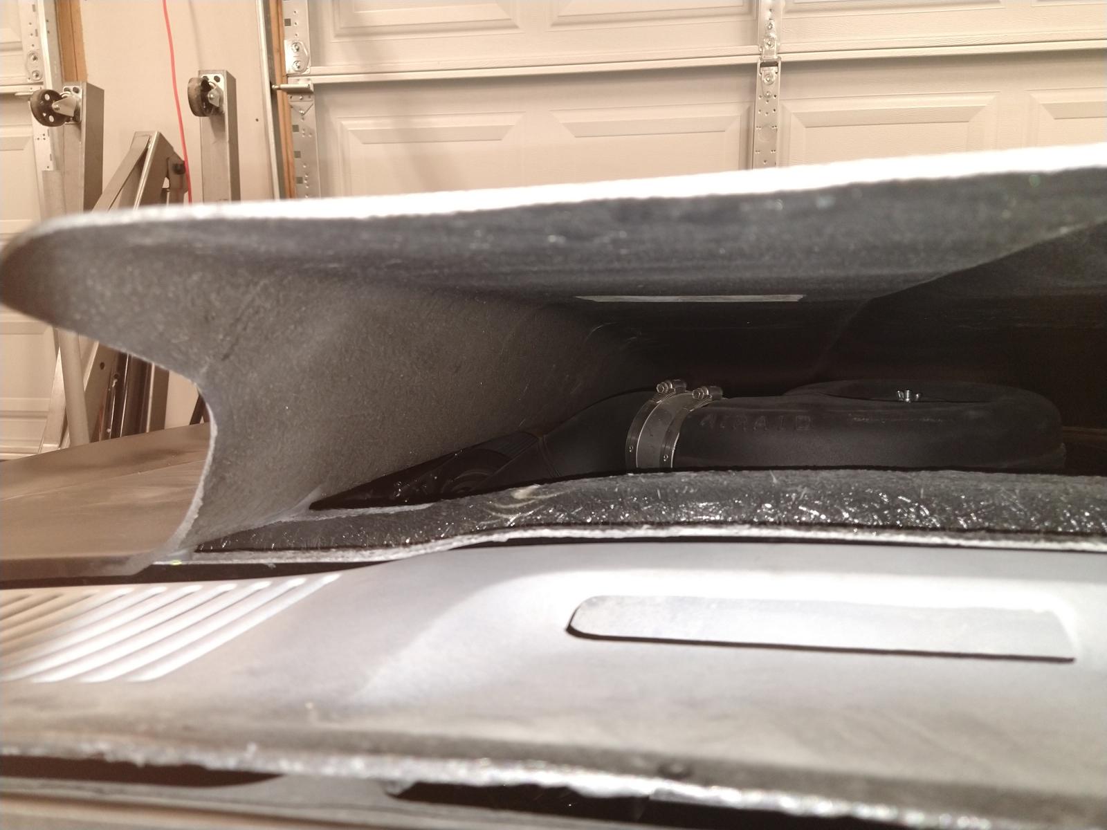

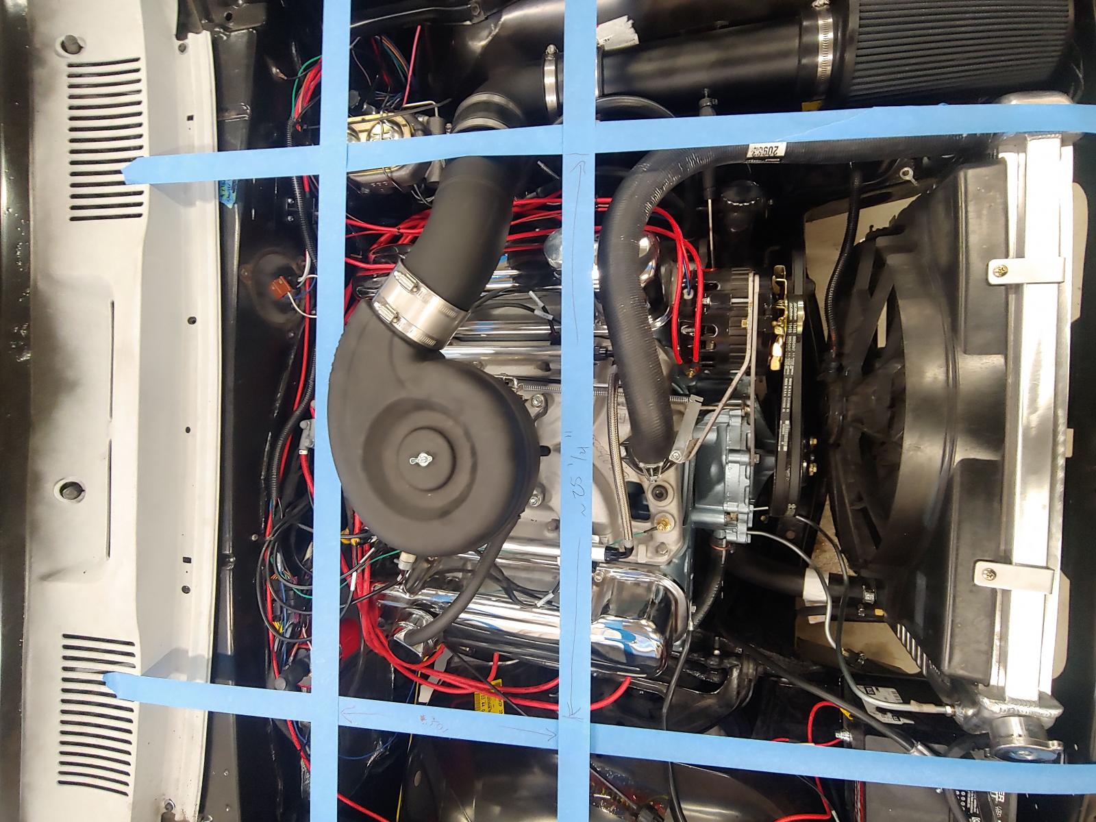

      So with the cowl panel in place, it is looking like our clearance may put us close to being able to use a stock style hood. We have a 400 hood that came with the car, but I am preparing myself for the possibility of needing to get a plain flat hood if we need to do some cutting. I've been back and for on which scoop/cowl to go with, but as of now am leaning towards using a Full Bubble cowl scoop to cover the air cleaner.
      Looks like the high point of the airbox is about 4" above the fender line.

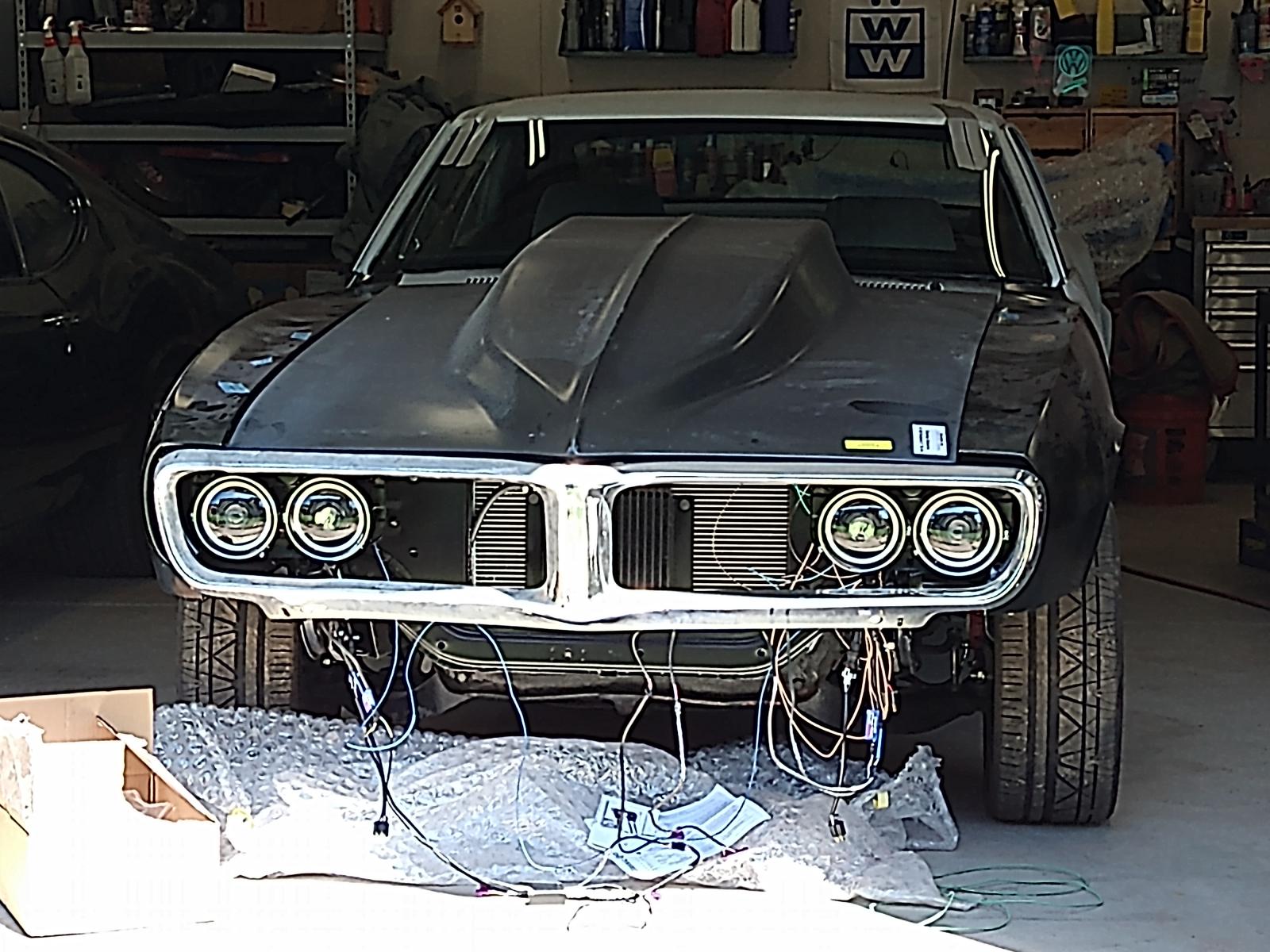

      It's been a while since last update as the car has been at the transmission shop to get the TV cable dialed in. Turns out the throttle rod linkage and Pro-flo throttle body made for problems getting a TV cable installed so the car is getting converted to a throttle cable. So in the meantime, I am collecting parts. Glass, bumper hardware, headlights, and a glasstek hood have showed up and I am just waiting for the car to get back.
      Pictures!

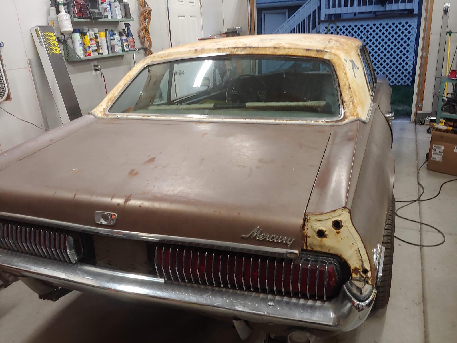

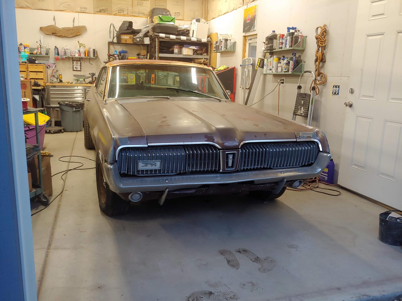

      Also, since my wife has been such a trooper through this whole ordeal we jumped at the chance to pick up one her dream cars.

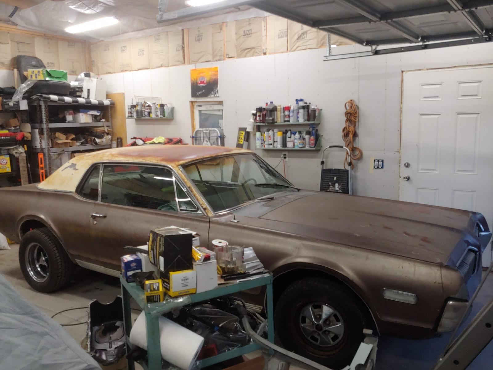

      A dang close to complete '68 Cougar with a 302 and C4 transmission. The worst part is that it is going to need floor pan and torque box replacement. But with a few minor fixes and a tune-up it runs and the sequentials work!
      I'll eventually throw up a build thread for her. Eventually, the plan will be to stroke the 302 out to 347 with a pro-flo as well and perhaps go with a T5 conversion.

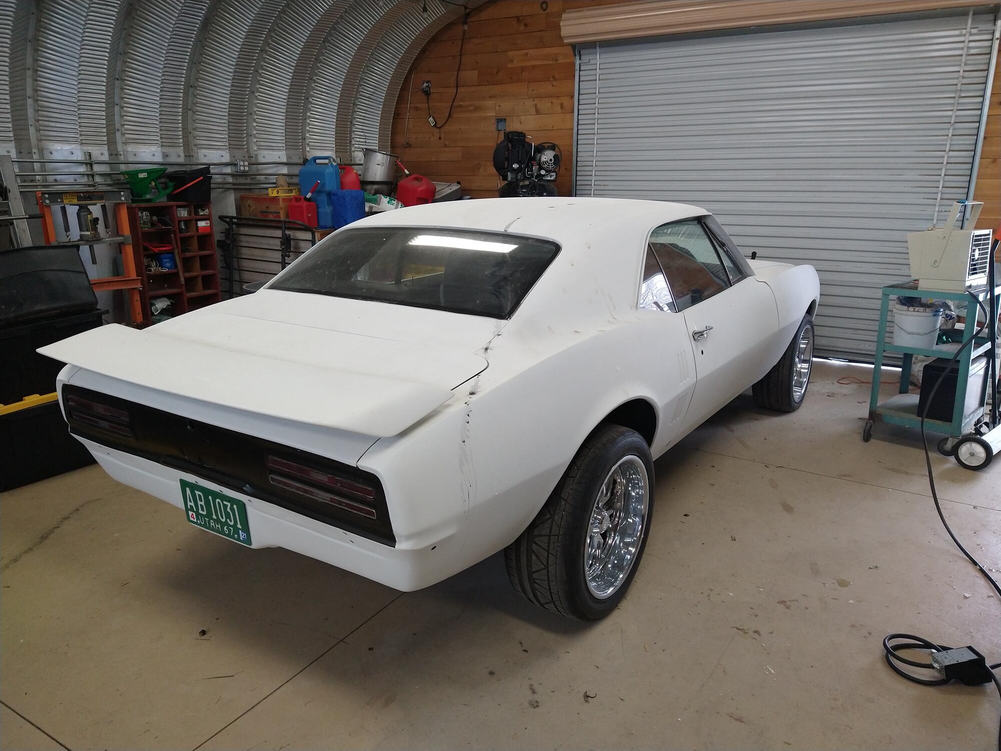

      Love this build- kept the Pontiac motor and used a Fiero spoiler! I’ve literally seen thousands of first gen bird and never noticed anyone using a Fiero spoiler- it looks great. Fiero seats are a nice touch too!

      Thanks! I am happy so far with how the fiero bits are gelling with the rest of the build. For better or worse, I've been trying to do things that haven't been done too often.

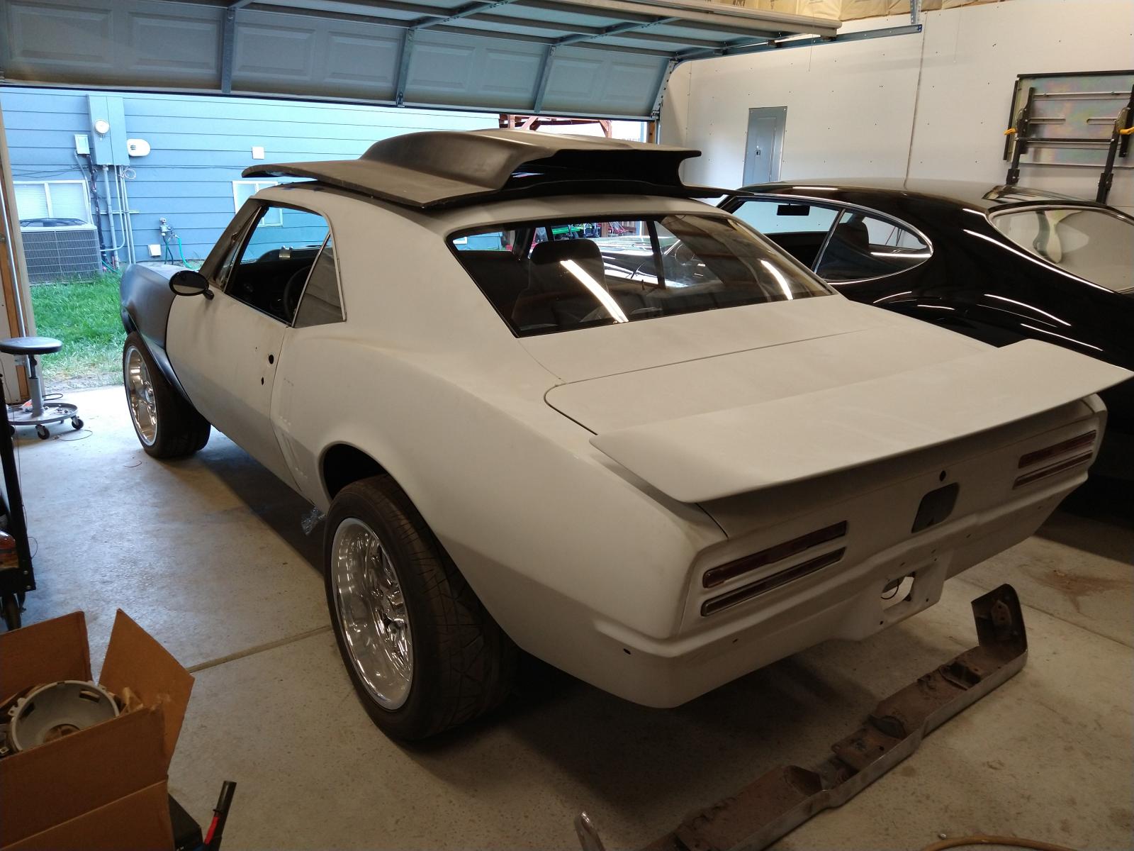

      At long last, the 'bird is back home and can be driven without fear of frying clutches.
      So next steps are to get the lighting structures installed and wired, get the body panels aligned, and swap the power steering pump. The pump that came with the car so it was an unknown until we were able to drive around the parking lot. Once we could drive around under power, it was screeching up a storm.
      Now that the car is back, we could test fit the cowl hood to see how it clears the intake.

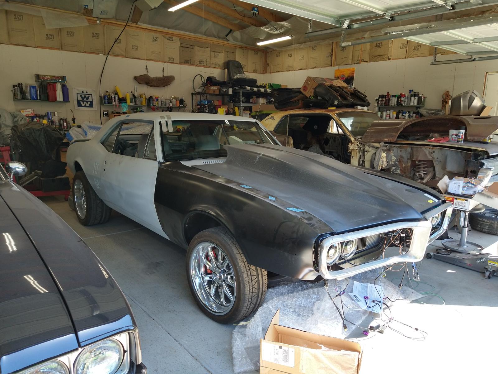

      Been a crazy stretch the past few weeks with looking to sell/buy a new place with a bigger garage. In the meantime, we got a bit more progress on the dash, the remaining glass is installed, lights are in and wired, and installed the Speedway Hollywood side mirrors.
      Catching up on backlog pics, this is the bracket the trans shop had to custom make for the Pro-Flo TV/Throttle cable provision. Still needs to go back in since they dialed the throttle in at 83% instead of WOT.
      Mock up of the hood with the lights. These pictures are making me question my color choice of True Red since the flat black is looking pretty mean. Definitely something to think about.

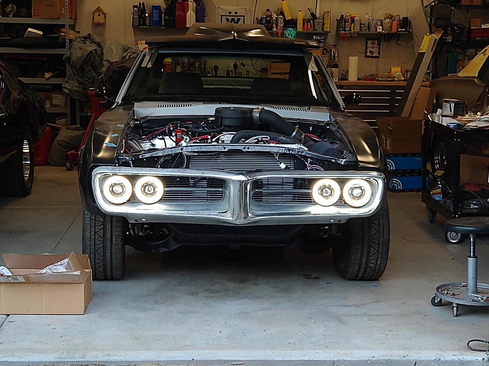

      And here is with wiring tidied up some more and the mirrors and grille in. Also a look at how the halos worked out.
      I haven't fully pinned in the bumper at this time, but am curious on how much further I should expect it to tuck in to the fender from where it is. The gap I am seeing now seems a bit excessive.

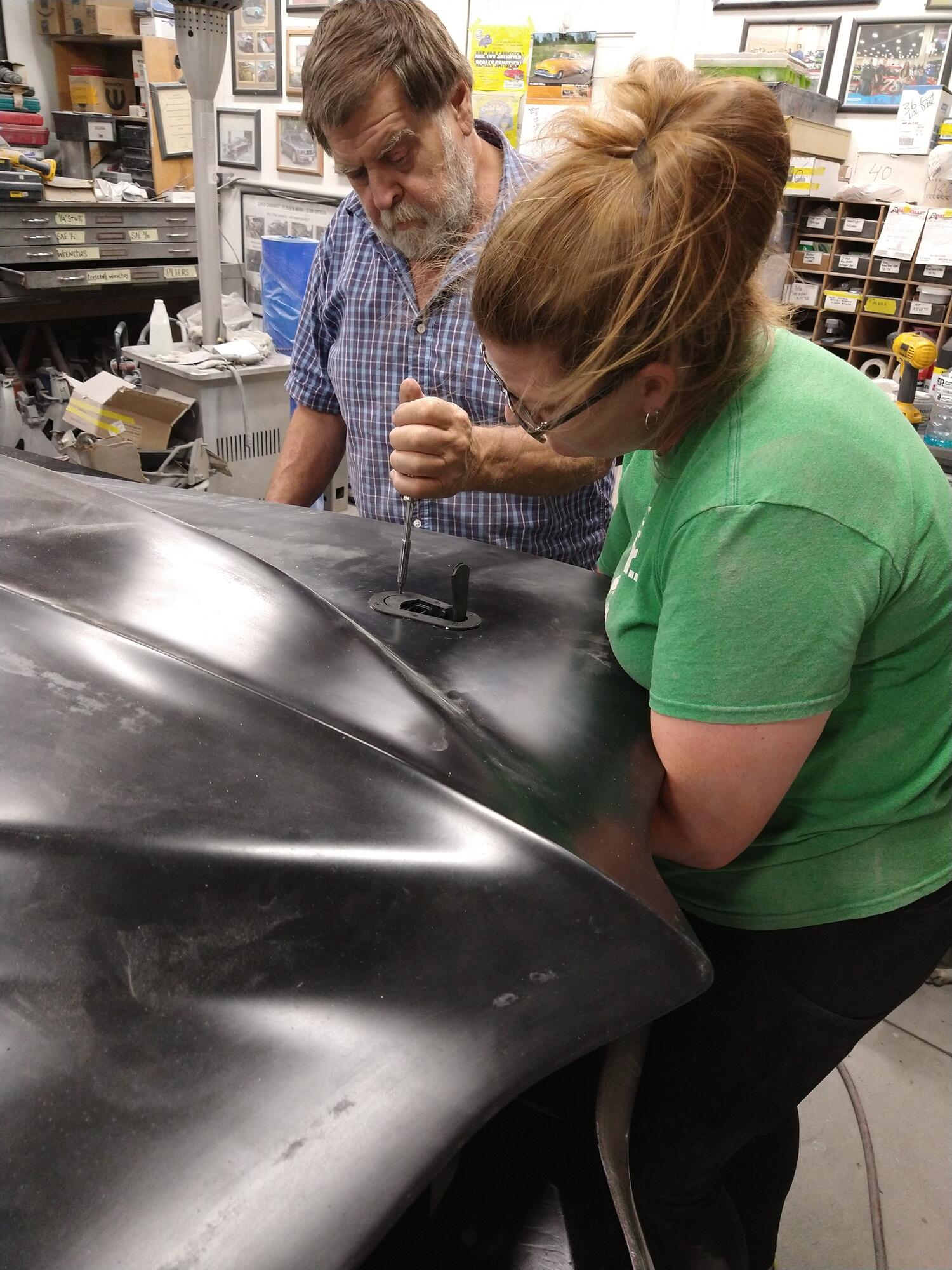

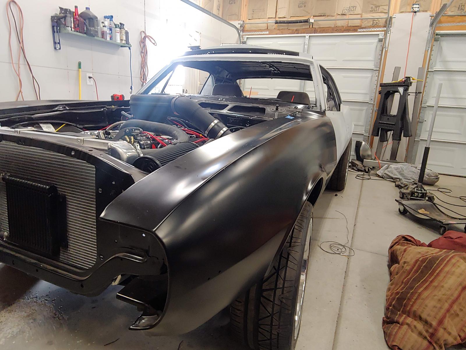

      Spent a nice Sunday with my wife and father in law dialing in the body panels and getting the front end pieced together. It's looking a lot better now aside from confirming that the original bumper had a bit of a twist to it on the passenger side.

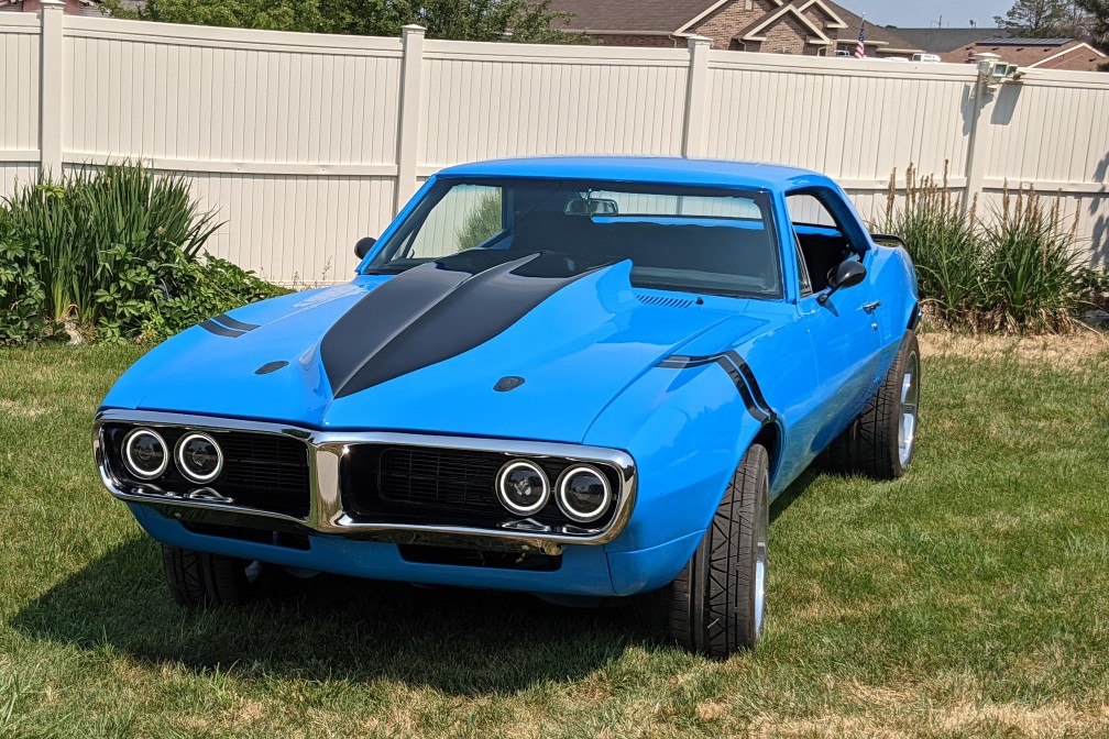

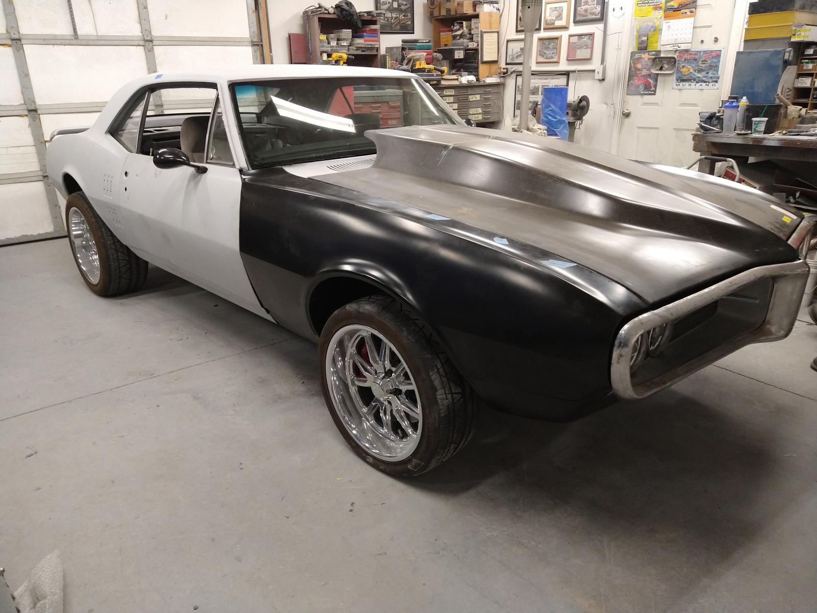

      Wow, so it has been 8 months since the last update and there is a decent amount of progress to talk about.
      With the help of my wife and father-in-law we got the aerocatches and body work done up enough to get into a first primer. We also took the time to get the carpet kit and sound deadening on the floor boards to take some of the edge off the cabin exhaust notes.

      And once we got that far we sold our house and had to store the 'bird for the winter. Getting her out of storage we found that her hard starting had gotten worse and she was burning up power steering pumps and spitting up PS fluid. To temporarily get her home until we could get that figured out, we disconnected the power steering belt.
      After 3 months of dealing with the home buying process and house-sitting a friend's house, we finally managed to find the house we were dreaming of and got all of the cars back home and tucked into the garage until we got settled.

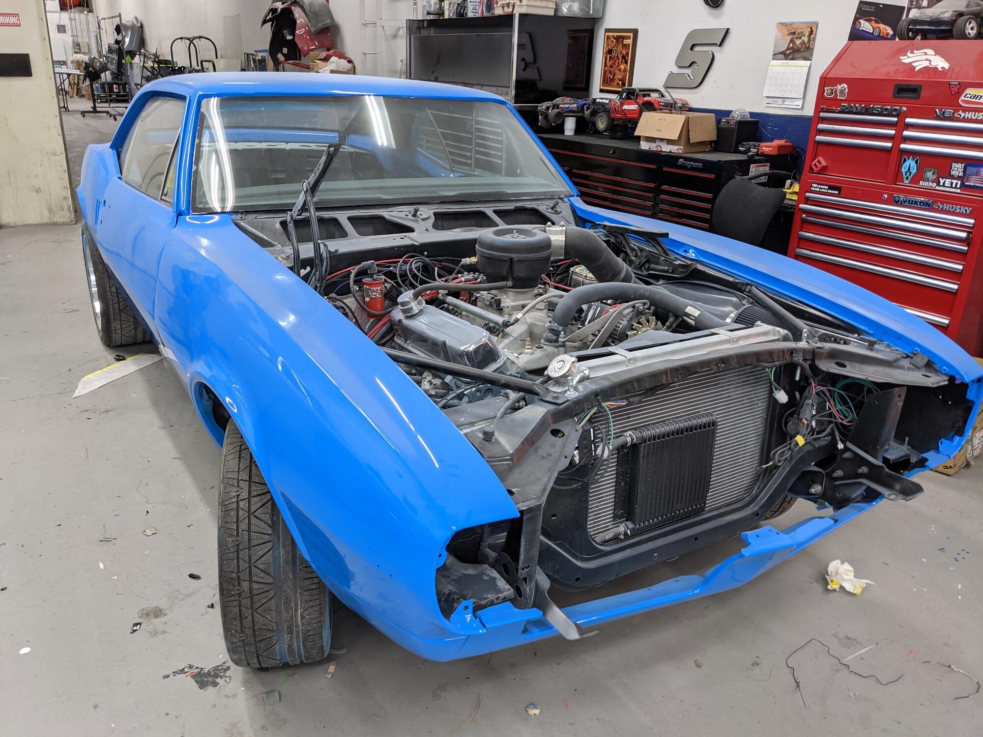

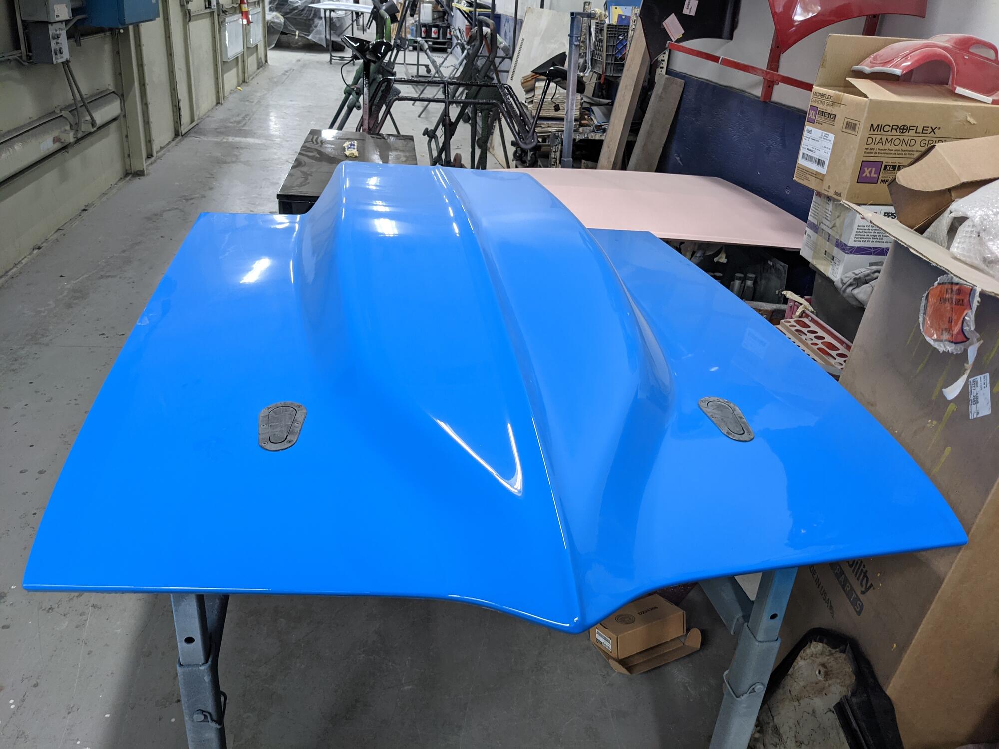

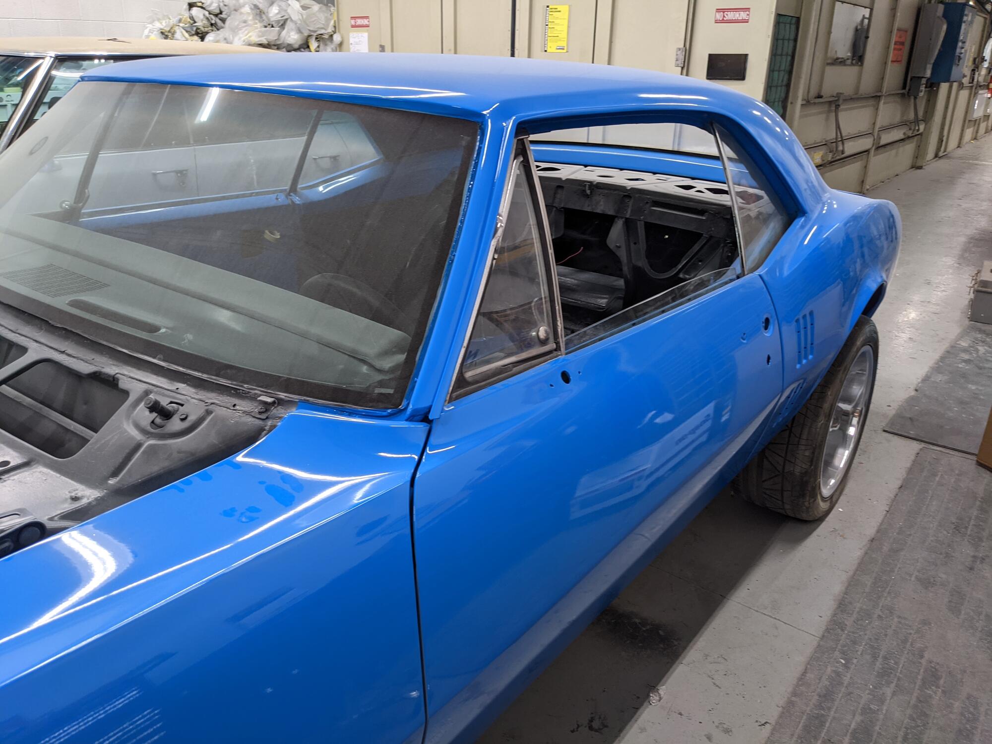

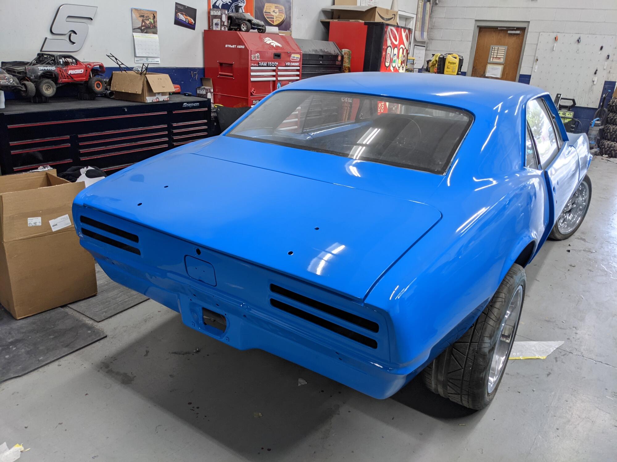

      Which brings us about up to date now to the exciting part, she has some color! The original plan was to shoot her Mazda True Red to get a color with pop. After some looking around a bit, and waffling several times, the family and I decided to take a page from the Ford boys and go Grabber Blue. The 'bird still has a couple more passes through the paint booth to go to get graphics and clear-coated, but this is where we now stand.
Size:  397.2 KBName:  PXL_20210406_215956251.jpg
Size:  276.8 KBName:  PXL_20210406_220608163.jpg
Size:  392.6 KBName:  PXL_20210406_220056624.jpg
Size:  257.9 KBName:  PXL_20210406_220600595.MP.jpg
      Once she gets back and cures a bit, we then have the daunting task of getting all the interior bits and bobs installed. Some highlights are the TMI molded headliner and a 3 point seat belt kit for the safety.
      Thanks for looking!

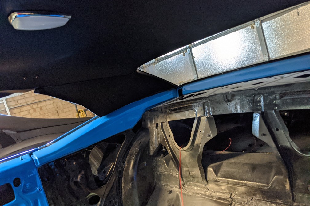

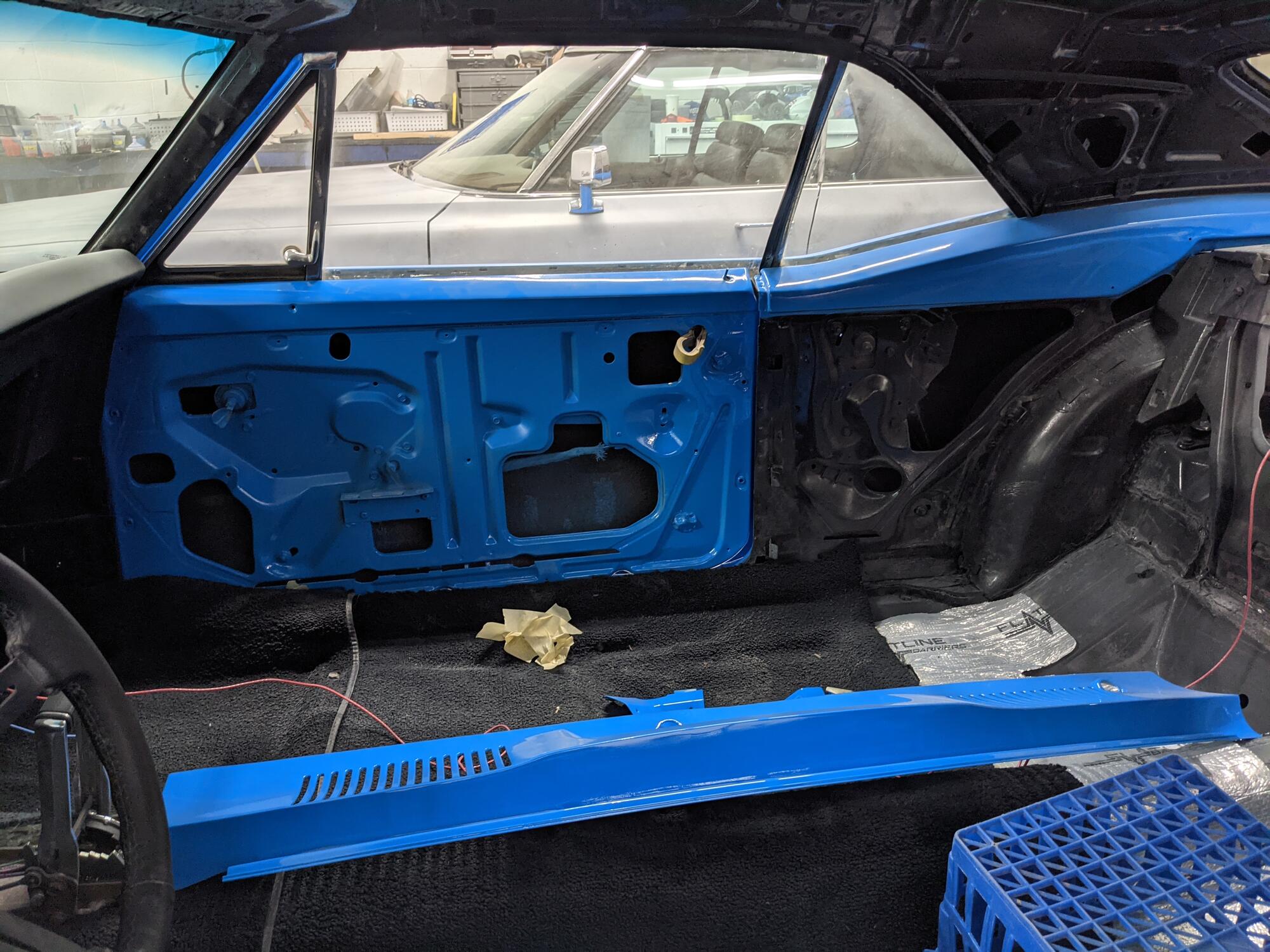

      And we're back! We just got the car back from paint and have spent the last weekend installing a large percent of the boxes that had been piling up for the past 5 months.
      First in was the TMI headliner. It looks super nice once in, but was a bit of a bear to wrestle to get it all in place. The A-pillar covers do leave a bit to be desired with their fitment so we may need to keep an eye out for some OE A-pillar moldings.

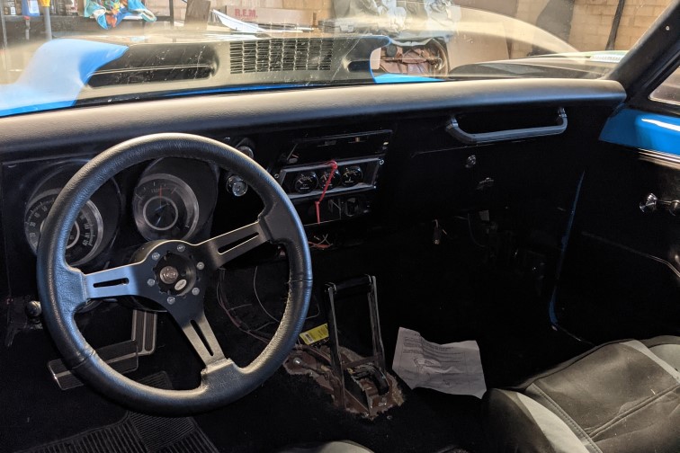

      The interior is coming together but still needs some love. We still need to wrap up installing the console, do something with the dash center stack, and find the rear armrest assemblies for the deluxe interior.
