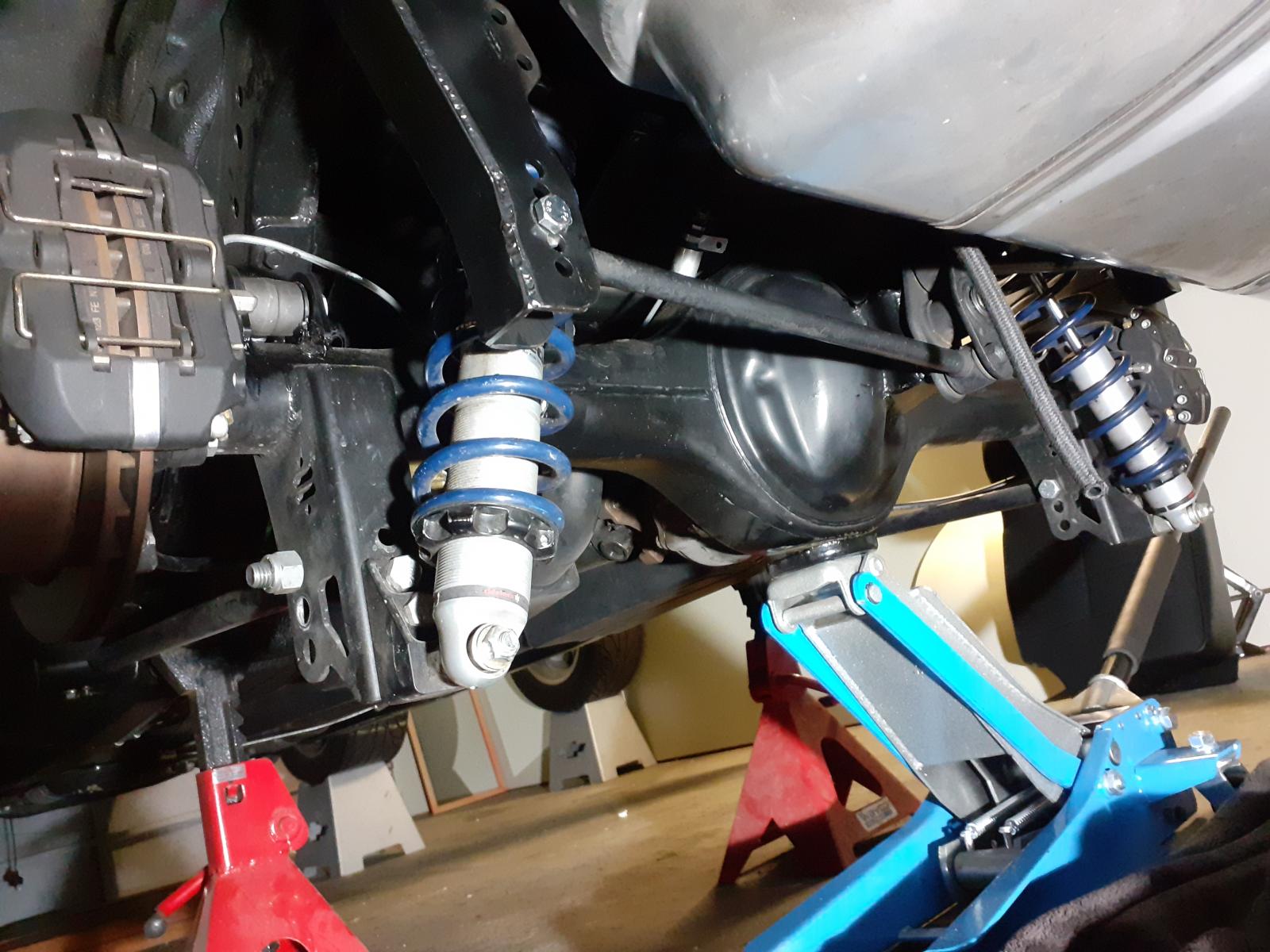

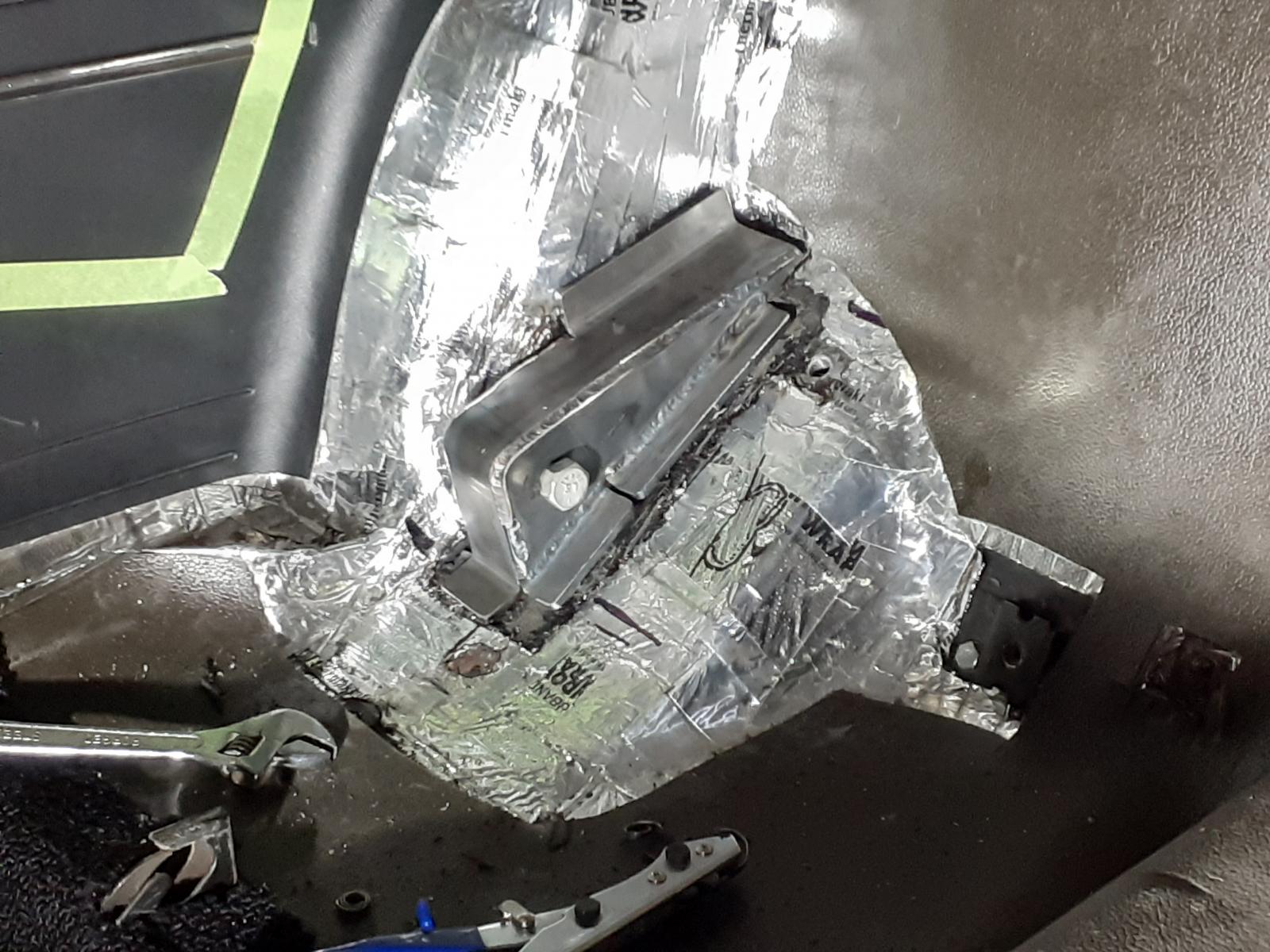

      New top arms, watts link and sway bar installed. Still using the ridetech bottom arms.
      Put 400 mile on new setup, really happy with how it feels. The 200lb springs that ridetech supply ride really nice, but don't offer the resistance on the big bumps and hi speed corners. Have done a heap of reading and am going to try a duel rate eibach spring setup.

      Looks good, nice job going through with it. I'm glad you're happy with the results.
      What car did that watt's link setup originally come from?
      - Ryan

      It looks like it was made for your car. You did a nice job integrating it. I like the rubber bushings for a street car vs the heim joints you see on a lot of the aftermarket stuff.

      Yeah putting rubber in was a no brainer, no need for the heim joints as I have smooth articulation through all travel know.

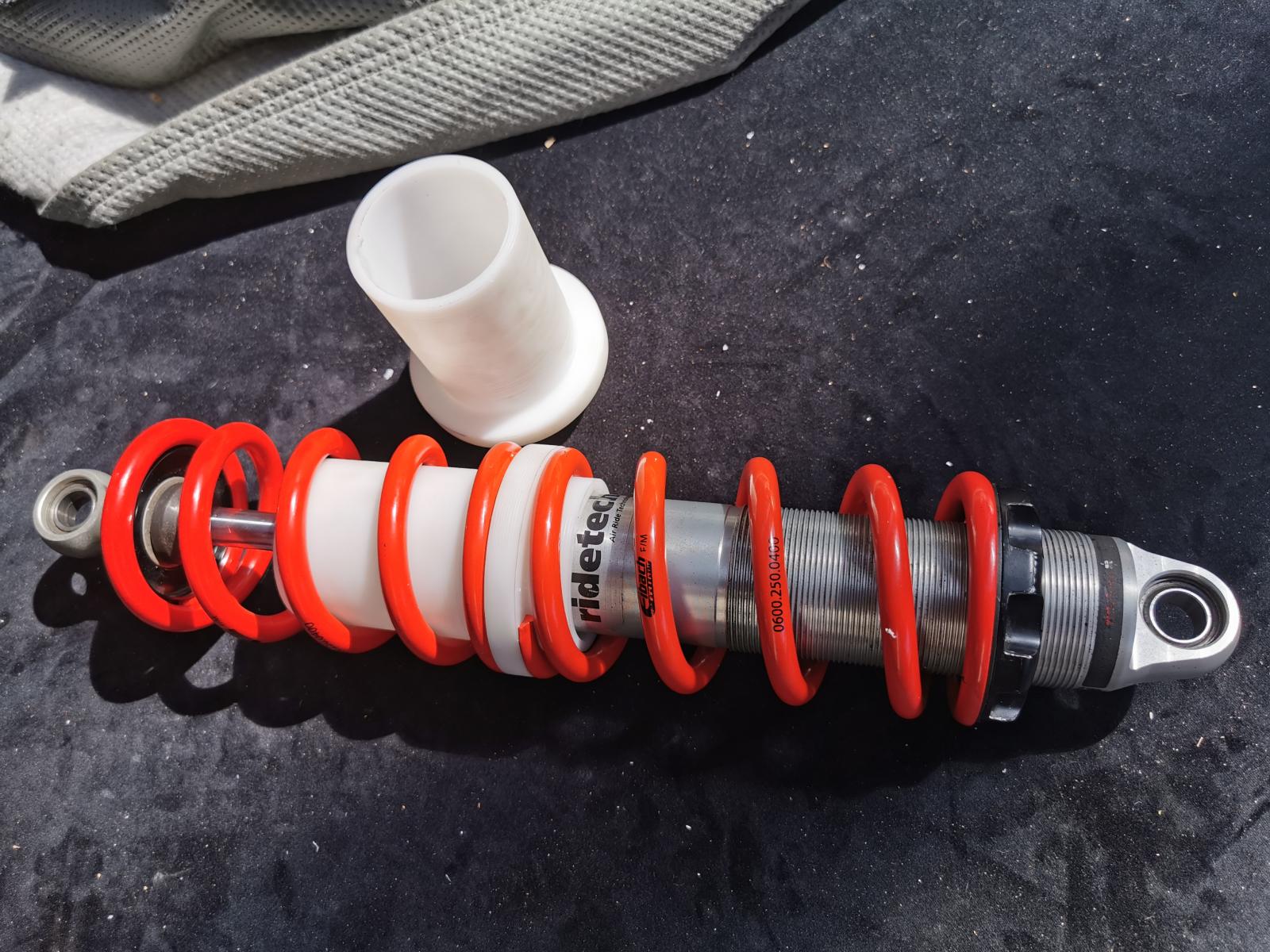

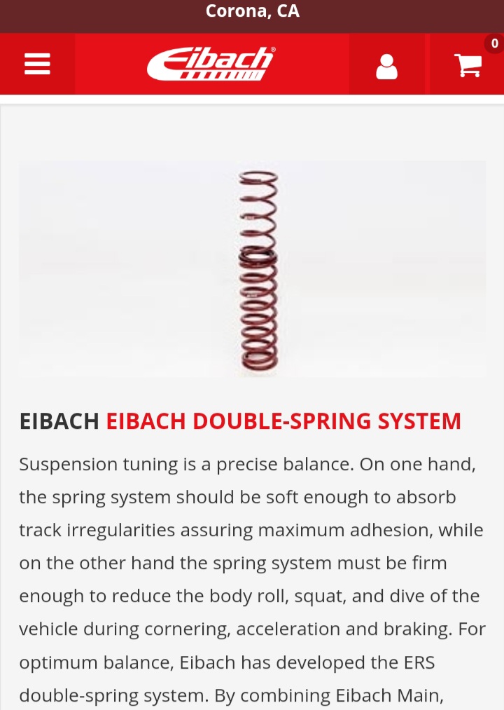

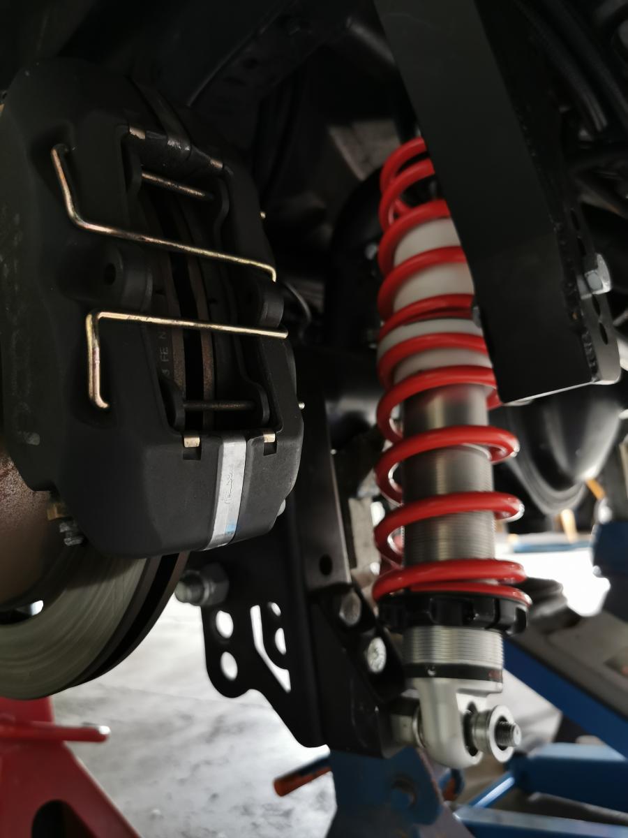

      Eibach dual springs
      The plan is dual springs next, keep the same rate as the existing 200lb springs at cruising, then adds lbs under extreme conditions.
      It's a complex formula, so may need to trial a few different springs.

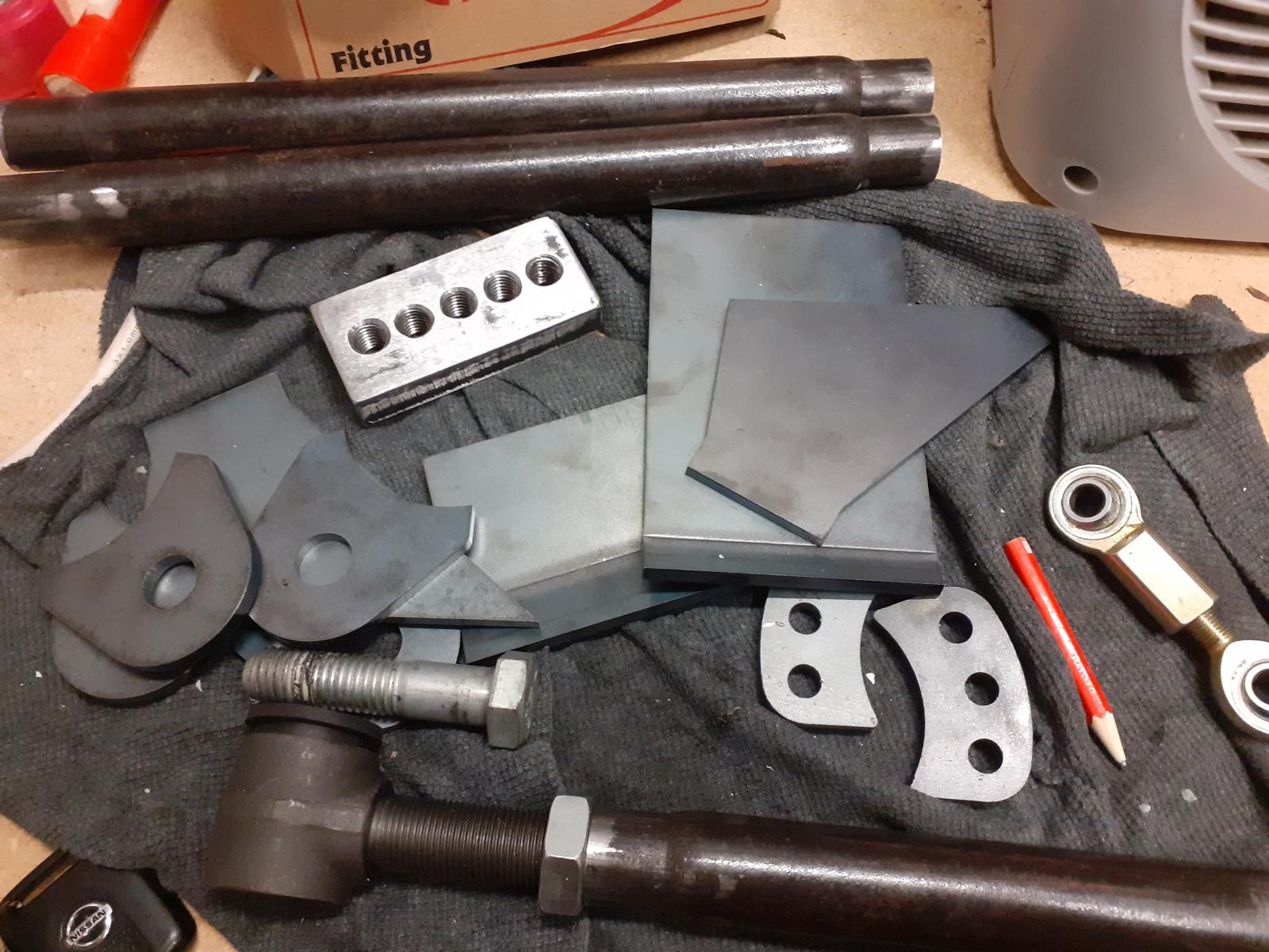

      Dual spring concept
