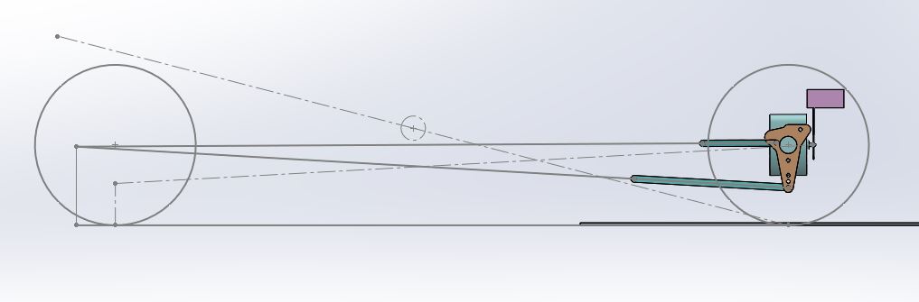

    10. #50
      Mar 2013
      Napier, New Zealand
      220
      Country Flag: New Zealand
      Balanced Articulation
      This one has 42% Anti Squat with equal shortening of wheel base in compression and rebound, so when it articulates at the rear roll centre it has very minimal rear steer.
      Top arm is falling down ever so slightly towards the front, almost level.
      Thought?
      Name:  #CG-42% =artic.JPG
      Damien
      Napier, New Zealand
      Project Page: https://www.pro-touring.com/showthread.php?99096-Project-Camaro-68-P-T-Muscle
      Next Project: 1956 Chevy Truck, Full C3 Suspension, Nascar Inspired

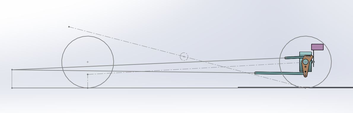

    11. #51
      Mar 2013
      Napier, New Zealand
      220
      Suspension Pros?
      Ok all the suspension pros out there. Crazy long instant center forward of front axle, but still has 24.4% Anti-squat.
      Diff articulates through 4" incredibly well with very similar pinion angle creating almost no bind.
      I was having trouble pin pointing the bind, have since worked out where it comes from on a 4-link.
      Top link imaginary link almost goes straight through CG, is this good?
      Is having the Instant Centre this far forward an issue?
      Damien
      Napier, New Zealand

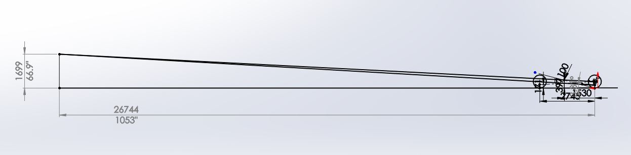

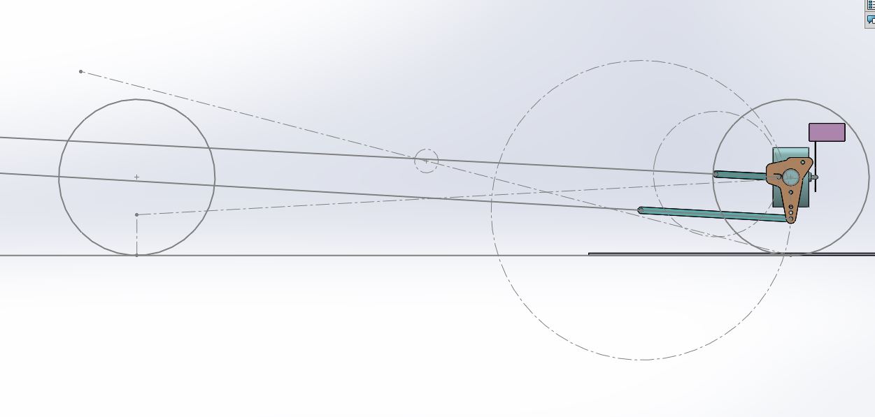

    15. #55
      Mar 2013
      Napier, New Zealand
      220
      Rear Steer with no bind
      Working towards zero Rear Steer (tough with short UCA) and zero bind.
      Currently have 4mm (0.157") Rear Steer at the axle flange when fully articulated diff.
      Small amount of Rear Steer on bump.
      Fully articulates with NO Bind now.
      Would like to see half this amount.
      Damien
      Napier, New Zealand
