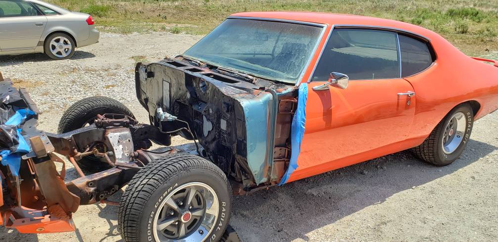

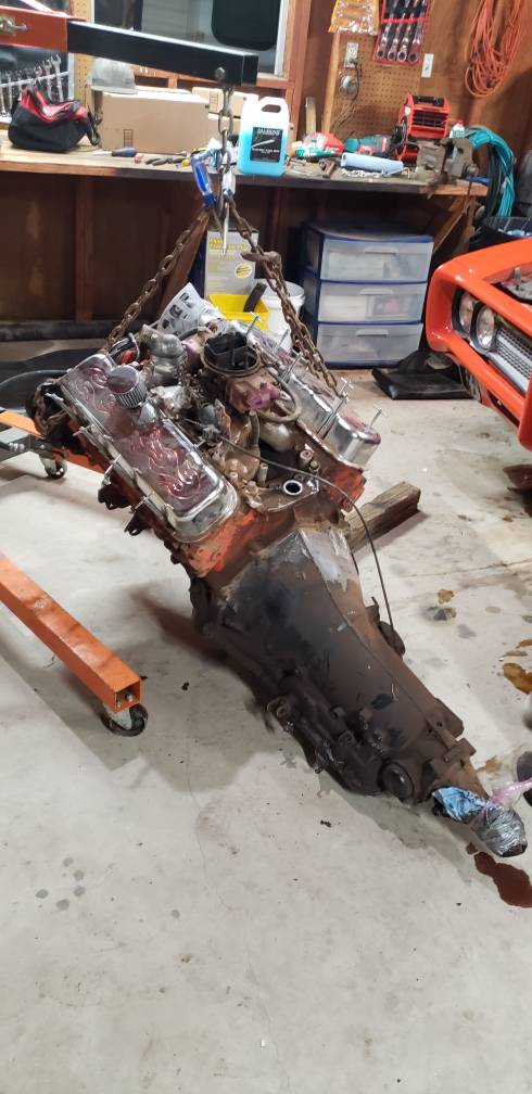

      Bought this GTO a couple months back. Towed her home and instantly pulled the drivetrain and the rest of the car apart. I have a 72 Lemans that is being pulled apart to build this one.

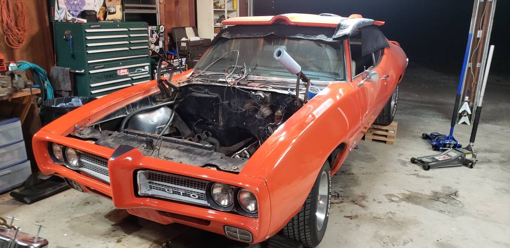

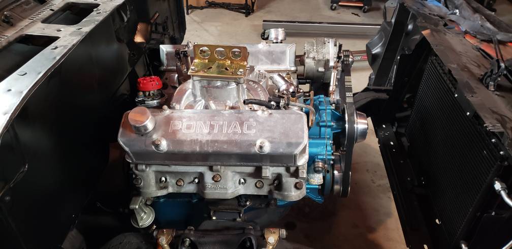

      Got the engine dropped in today.Name:  20200208_181336.jpeg

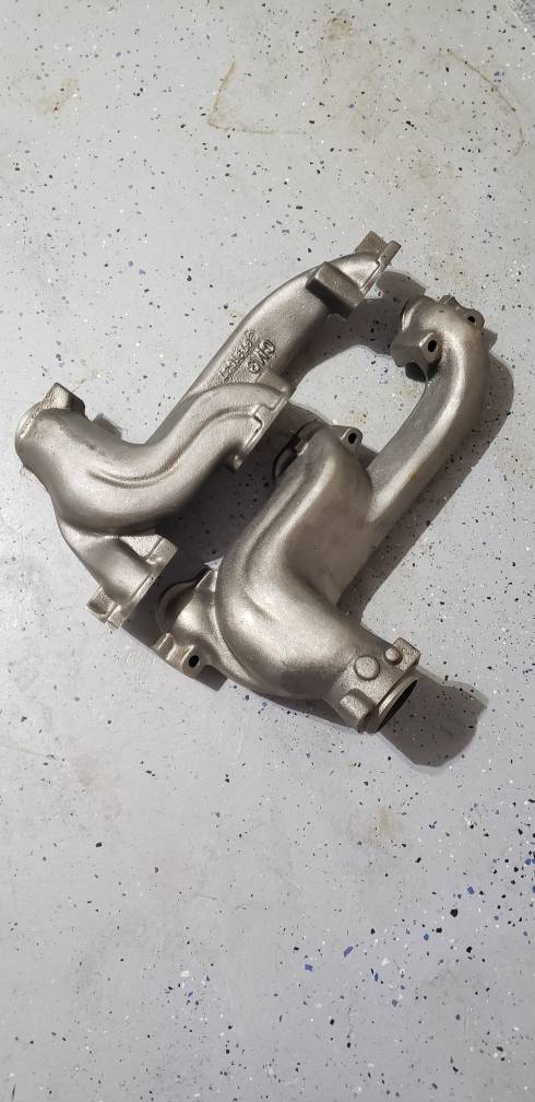

      More parts coming in today. Getting rid of my junk headers and the headache they bring with Pontiac engines. Name:  20200406_122556.jpeg

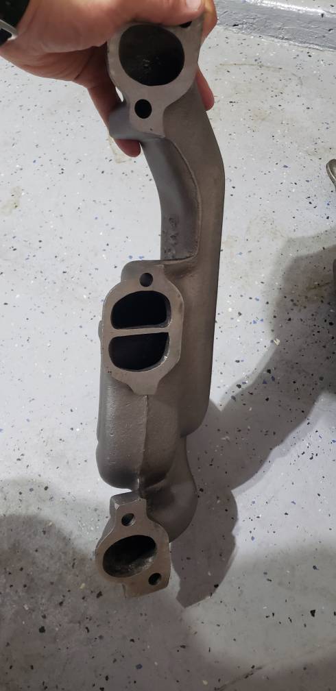

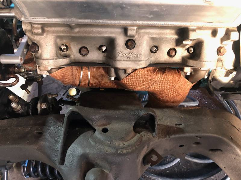

      Got the manifolds installed today. Had to wrap them due to the poly motor mounts and the manufacturer recommends wrap or heat shield to prevent deterioration from the heat.Name:  IMG_9912.jpeg

      I plan on sending my exhaust off to this place for their system: https://headershield.com
      I'm running headers tho.

      If you happen to be running butlers poly mounts they recomend it for both headers and manifolds. I will likely send them off to get coated down the road but for now I just want to drive the damn thing.

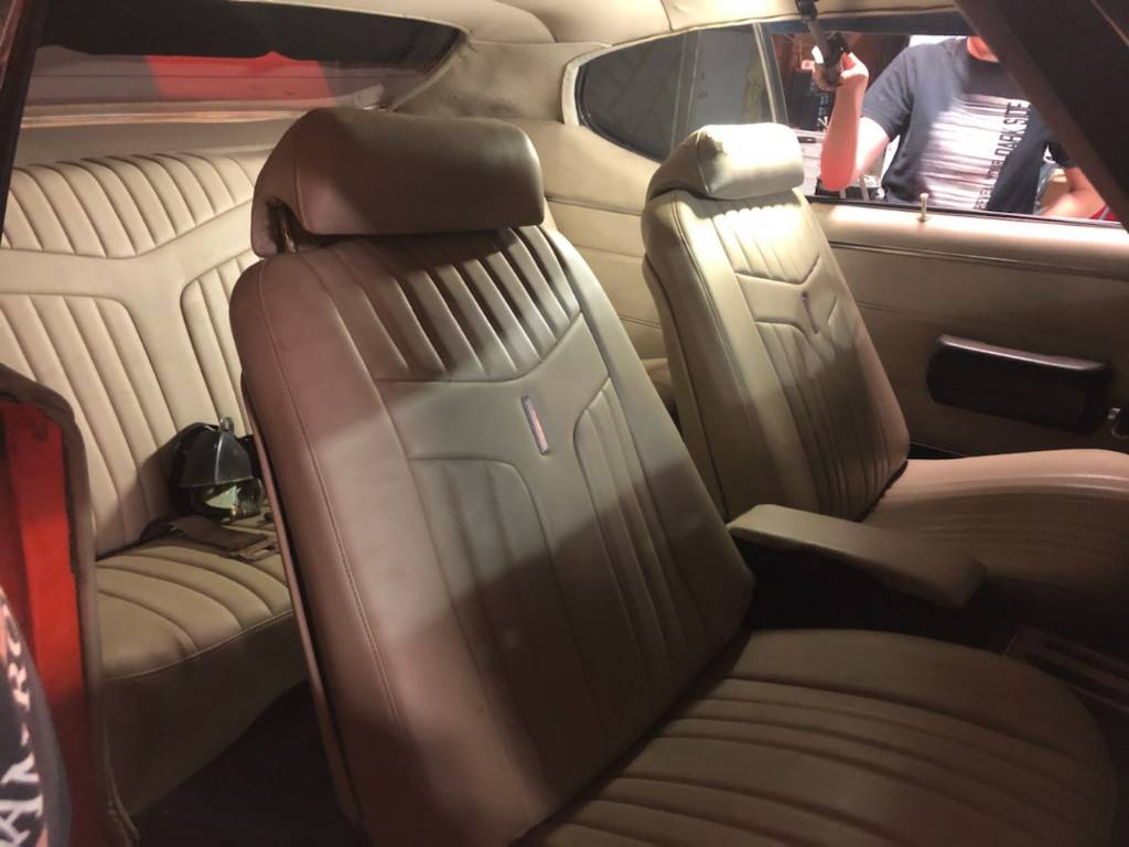

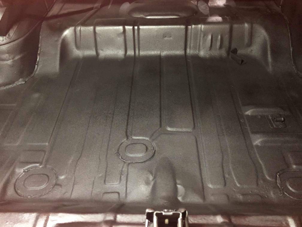

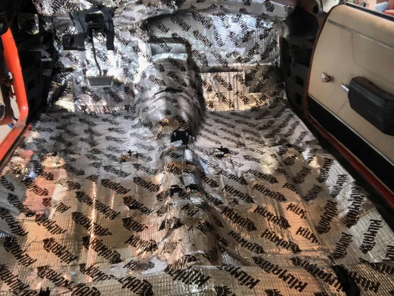

      Interior is coming back together.Name:  IMG_9915.jpeg

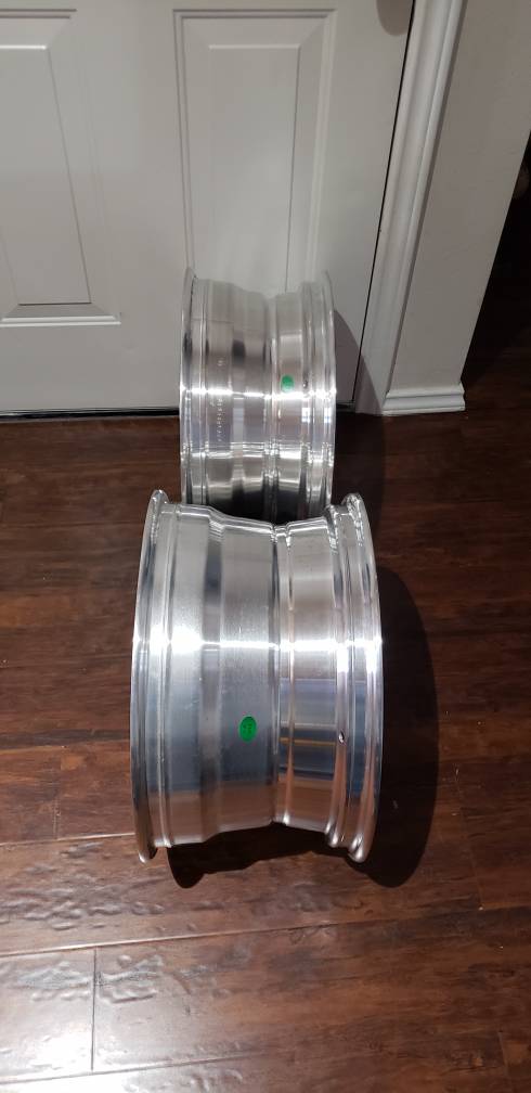

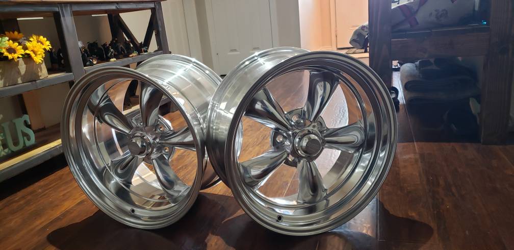

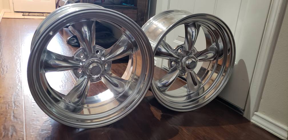

      Got my new wheels today 18x8 for the front and 18x10 for the rear. Name:  20200725_101251.jpeg

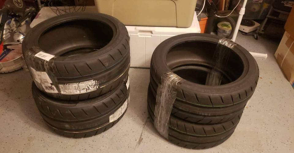

      New rubber showed up yesterday! Name:  received_953728958436311.jpeg
