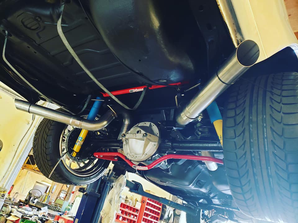

      Now that we have the brakes and suspension wrapped up we will talk about tires. With a variety of tire choices I found that 18"/19" tires can be pricey but I'm not willing to give up performance. I found that the falken indy 500's and the BF Gforce had the best reviews for a summer tire radial. I decided to go with BF's Gforce comp 2's since I felt like this was the better of the two tires. I went with a 245/35r18 up front and a 295/30r19 in the rear, this should help combat traction issues.

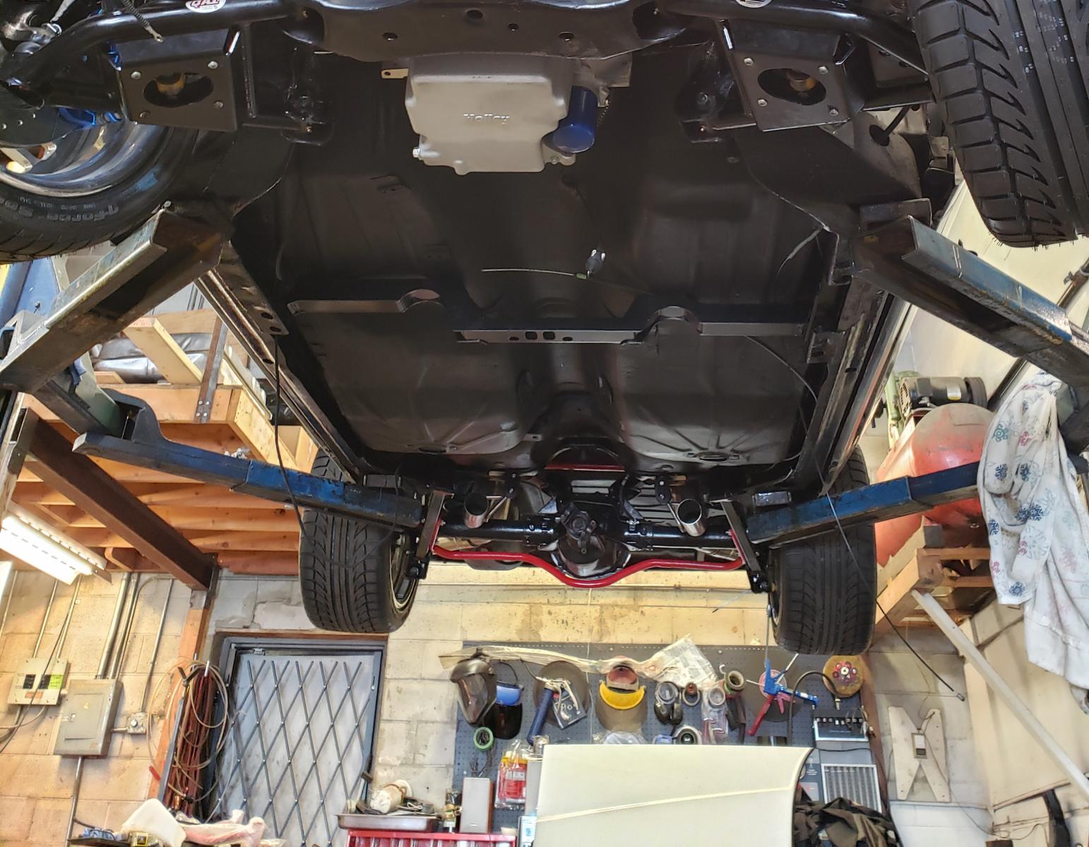

      Having a clean underside is a must when wanting peace of mind. This car was covered in zeebart oily undercoating from the dealer in 1986. While I'm happy at what a good job it did protecting the underside of the car, it was a huge pain in the ass to remove. The easiest way to describe it, it's like scrubbing burnt bacon grease off a frying pan. After long hours of heating it up with a torch, scraping, grinding and prepping it was ready for paint. I wanted something that would protect this car from anything that it could possible come in contact with. The truck I use at work has Rhino bedliner in the bed and has stood up to much abuse. I ended up finding a similar product called raptor bedliner. It will add great sound deadening and keep the underside looking good for years to come.

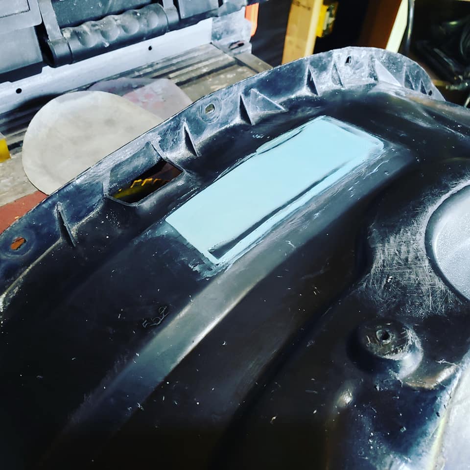

      Ok let's talk about inner fender liners. With custom inner fenders being quite pricey to make, and aftermarket carbon fiber ones being $1200 you might want to think about refurbishing. My passenger side fender was destroyed beyond repair from all the years of the exhaust gasses passing through the down pipe and baking the plastic. I found a V8 regal inner fender that would make a good replacement. The problem is the V8 regal passenger inner fenders have towers on them that ar
      e a eye sore. Keep in mind that only 84-87 regal fenders will work. So I went to work cutting out these towers on the inner fender and plastic welding in a patch from my pre existing one. Once the holes were filled I used a plastic bondo filler and sanded it down to a smooth finish. Once the patching and smoothing was complete I knocked down all the imperfections and edges for a smooth finish working my way through the grits. With a nice smooth inner fender it's time for primer and wet sanding giving it 24 hours to completely cure. For paint I used SEM trim black. I found this to be the nicest satin finish for plastic.

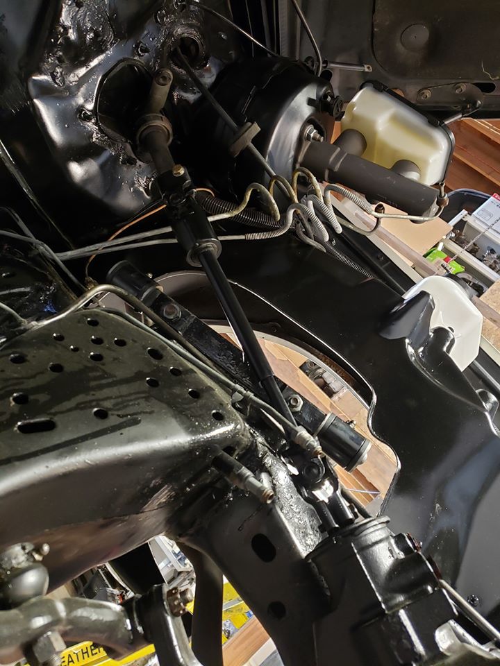

      With most of the suspension wrapped up we will talk about the steering box and steering shaft. We have installed a reman quick ratio grand national steering box. Not knowing the condition of the previous steering box I opted for a new one. AN fittings were installed so it could be run to a oversized powersteering cooler. This will help combat heat extending the life of the powersteering pump and gears. The cooler will also make sure the fluid doesn't break down and maintains
      a optimal temperature allowing for propper function. The cooler we are using is B&M's super cooler series with AN fittings. Next on the list is the steering shaft. Gbody's never came with responsive steering feel from the factory. One of the main reasons for this is the Rag joint. Overtime the rag joint deteriorates from heat causing sketchy handling. They're a few good solutions for steering shafts that eliminate the rag joint and gives you the responsive steering you're searching for. Some examples are Detroit speeds G shaft, 84-02 jeep Cherokee XJ, Borgeson custom and 95-05 safari Astro Van. For this build we installed the Jeep steering shaft. I could immediately feel a huge difference in the steering wheel (no slop!)
