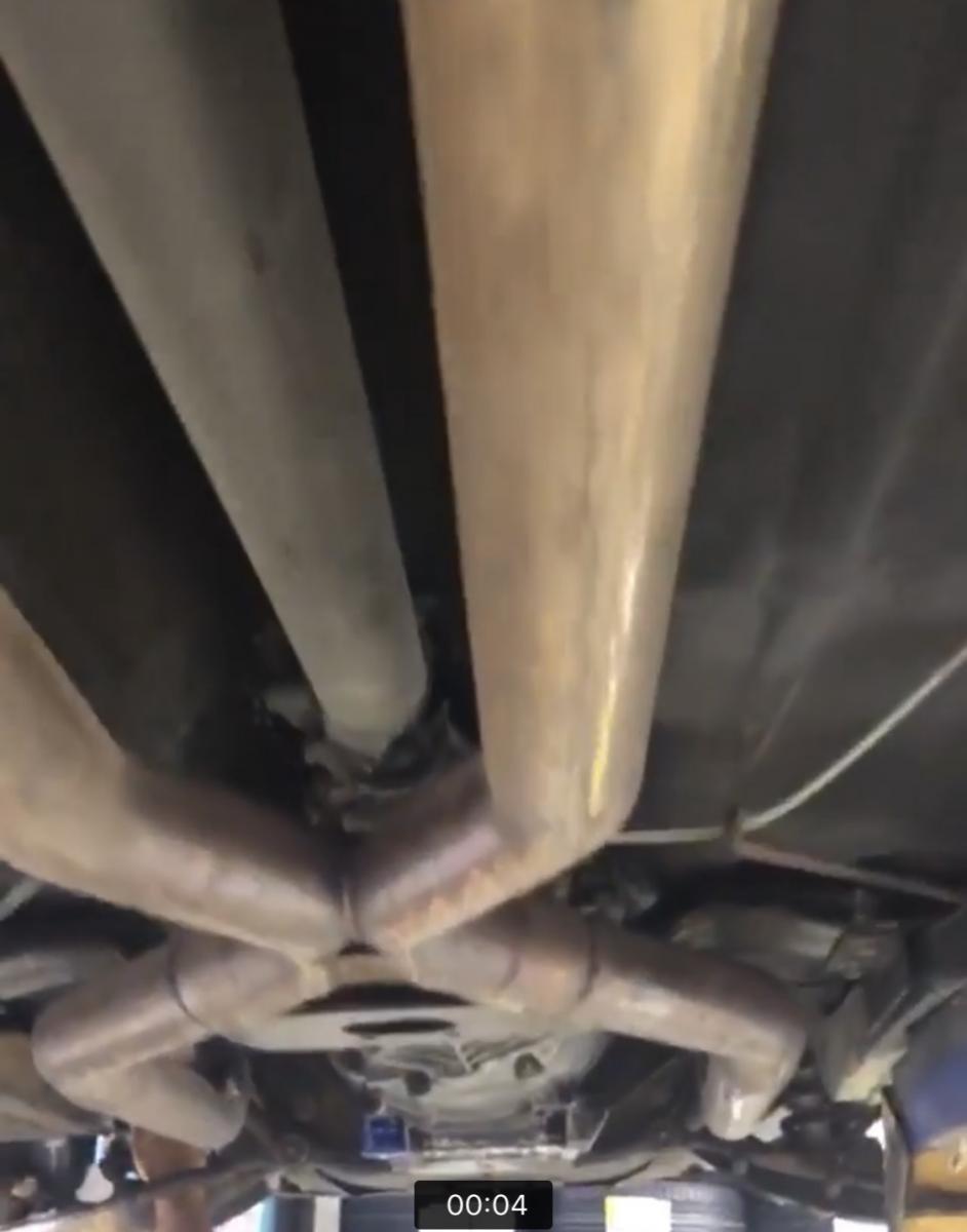

      Are you saying suddenly both of them stopped shutting properly? Are you running subframe connectors?

      The driver side, I always had the window/door jam problem, now it's worse. The pass side, yes just happened all of a sudden. I'm not sure if i do have subframe connectors, sorry for the low quality photo. I can check next time I lift it.
