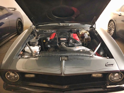

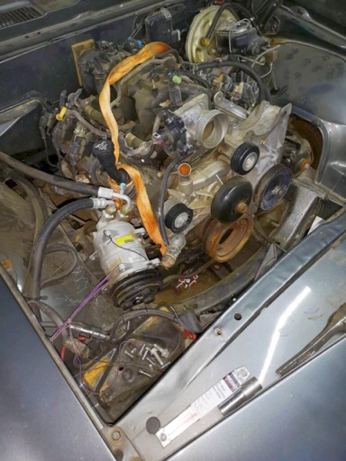

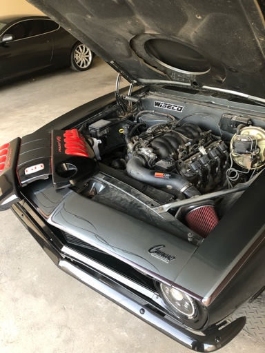

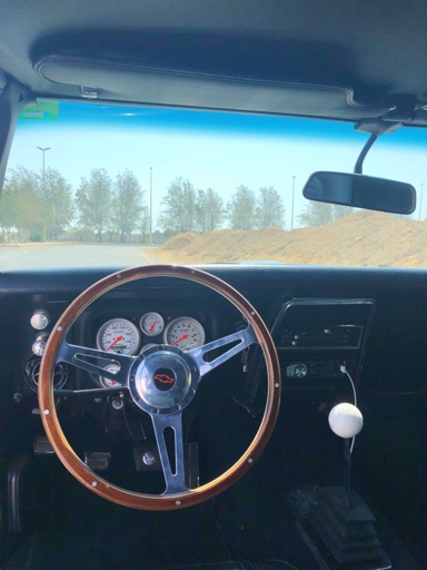

      Below are some Before/After Photos:
      Before
Size:  92.8 KB Name:  IMG_8103.JPG
Size:  58.0 KB Name:  Adjustments.JPG
Size:  66.9 KBName:  IMG_9348.JPG
Size:  87.3 KB Name:  Adjustments.JPG
      After
Size:  73.0 KB Name:  IMG_9729.JPG
Size:  76.3 KB Name:  IMG_2089.JPG
Size:  91.7 KB Name:  IMG_9347.JPG
Size:  91.8 KB Name:  IMG_9550.JPG
      Before & After RideTech Street Grip
      After adjusting ride height and front rubbing with Lowering blocks and coil spacers
      Last edited by majj35; 12-04-2019 at 11:57 PM. Reason: Updates: Installed Suspension

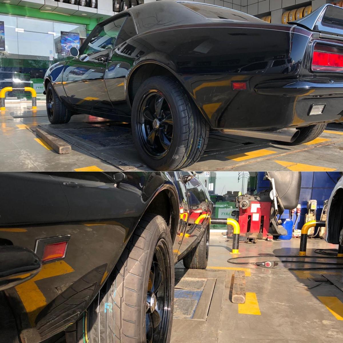

      Installed: Nitto NT555 G2
      Finally found tires, went with Nitto 555 G2 235/45 & 245/45. What a ride difference vs the old Sumitomo's I had on.Name:  WhatsApp Image 2019-10-31 at 4.07.31 PM.jpg

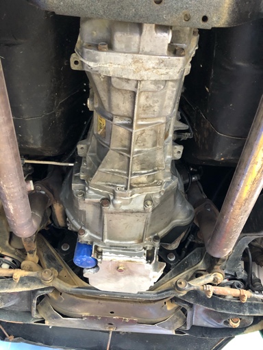

      not sure if it matters but looks like tierods are back to front,long joint is the inside
      Feb 2017
      Jeddah, KSA
      144
      Quote Originally Posted by Gmc427 View Post
      in the transmission photo?
      1968 Camaro SS | LSx 364ci
      T-56 | RT StreetGrip | RT Steering Kit | TRSD Disc Brakes | Wilwood Dual Piston
      Jun 2015
      175
      Country Flag: New Zealand
      yep
      Feb 2017
      Jeddah, KSA
      144
      yep
      I’ll have them check it out. Is it any concerning, safety wise, how its currently hooked up?

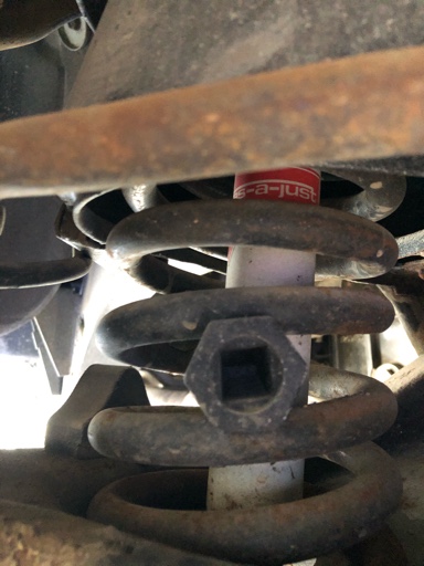

      Update: Installed Ridetech StreetGrip Suspension Kit (REVIEW)
      First of all, ride quality and handling compared to previous 11/10 love it. Shocks are very comfortable, hitting bumps doesn't hurt anymore. The Shocks are currently adjusted toward more firm (8 clicks back from Most Firm setting). Highway cruising , and taking fast corners never felt better.
      That being said, I do have some callouts. The front does scrape when hitting uneven surface, don't know how bad that is but i like the ride height in front now. (235/45/17).
      The rear height is what's bothering me. It's way higher than front and I prefer to even out the ride height. Similar to the photo of the Camaro on RideTechs website. It appears that I have missed out an additional 1" Lowering kit, which doesn't come in the SG kit. I thought the leafs alone give a 2" drop.
      For now, I ordered the ridetech 1" lowering blocks in the rear, and Global West 3/8" coil spacers upfront, which should lift the car about 3/4". Hopefully this aligns it well

      Fixed suspension issues
      I FINALLY fixed the issue of ride height and front rubbing. I added 3/8" coils spacers and 1" lowering block. That did the job!! car doesn't rub anymore, and sits perfectly.

      Next: Focus on steering & tie rod ends
      This was called out by a member, my outer tie rod ends are slightly hitting the inner wheels. Working on the best solution to factor everything moving forward. This time by doing it right.
      This involves: Going with bigger wheels, Disc brake, and steering kits. I'll have to decide what to work on first (safety).
      Right now, my main concern are the tie rods, since they are hitting + look old and rusty.
      Step 1: Add 1/8" wheel spacers, for now
      Step 2: New steering kit - Any advice which to go for? Stick with ridetech?
