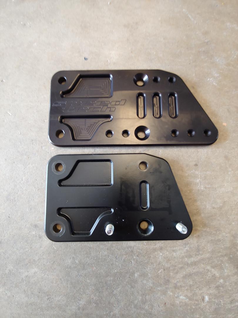

      Update time!
      First off let me thank Chadwick at Speedtech for getting these new mounts out to me by the weekend.
      I received the new engine plates on Saturday. Here are some pics of the differences. As you can see, there are three positions you can use. I used the furthest forward position and it is PERFECT! With these mounts and their Pro-Touring subframe there is plenty of room around the engine and transmission. It is more level and sits lower than in the stock sub. The Holley 302-2 oil pan fits. I can put my hand between the TKO and the tunnel pretty much anywhere. I can reuse my headers. The steering shaft has more room than before. The tires (275/40/18) don't even come close to touching the subframe. I have more pics and can take a specific one for anyone if you need.
      Matt H.

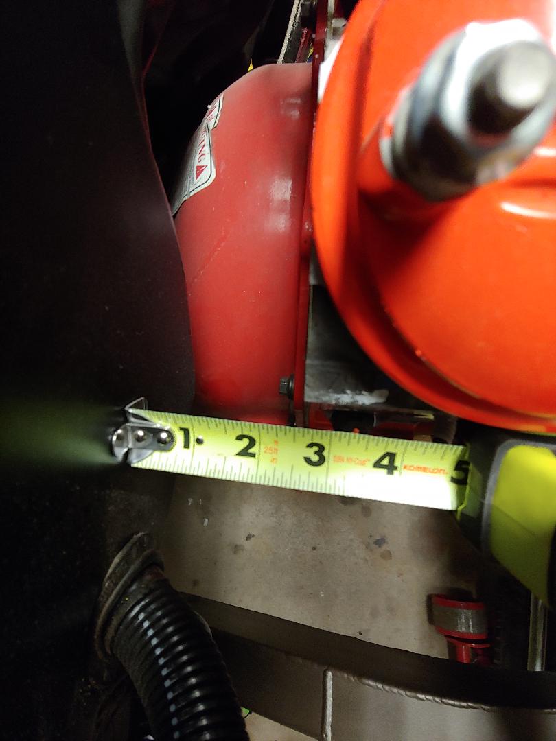

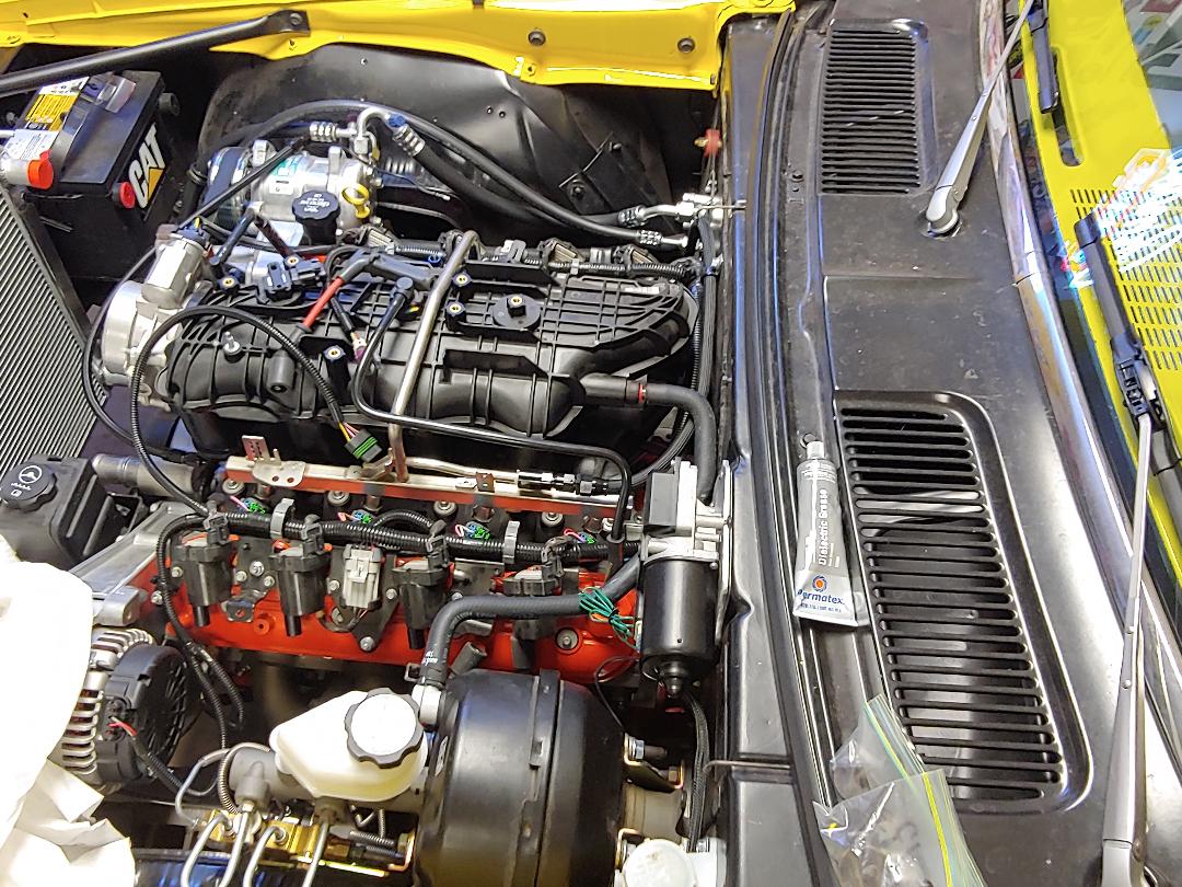

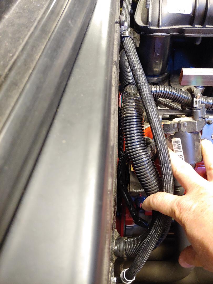

      Some pics of the clearance with engine installed. There is just over an inch of space between the head and firewall on the passenger side. Just over 2 inches on the driver side. Plenty of room behind the manifold. Name:  camaro 1.jpg
