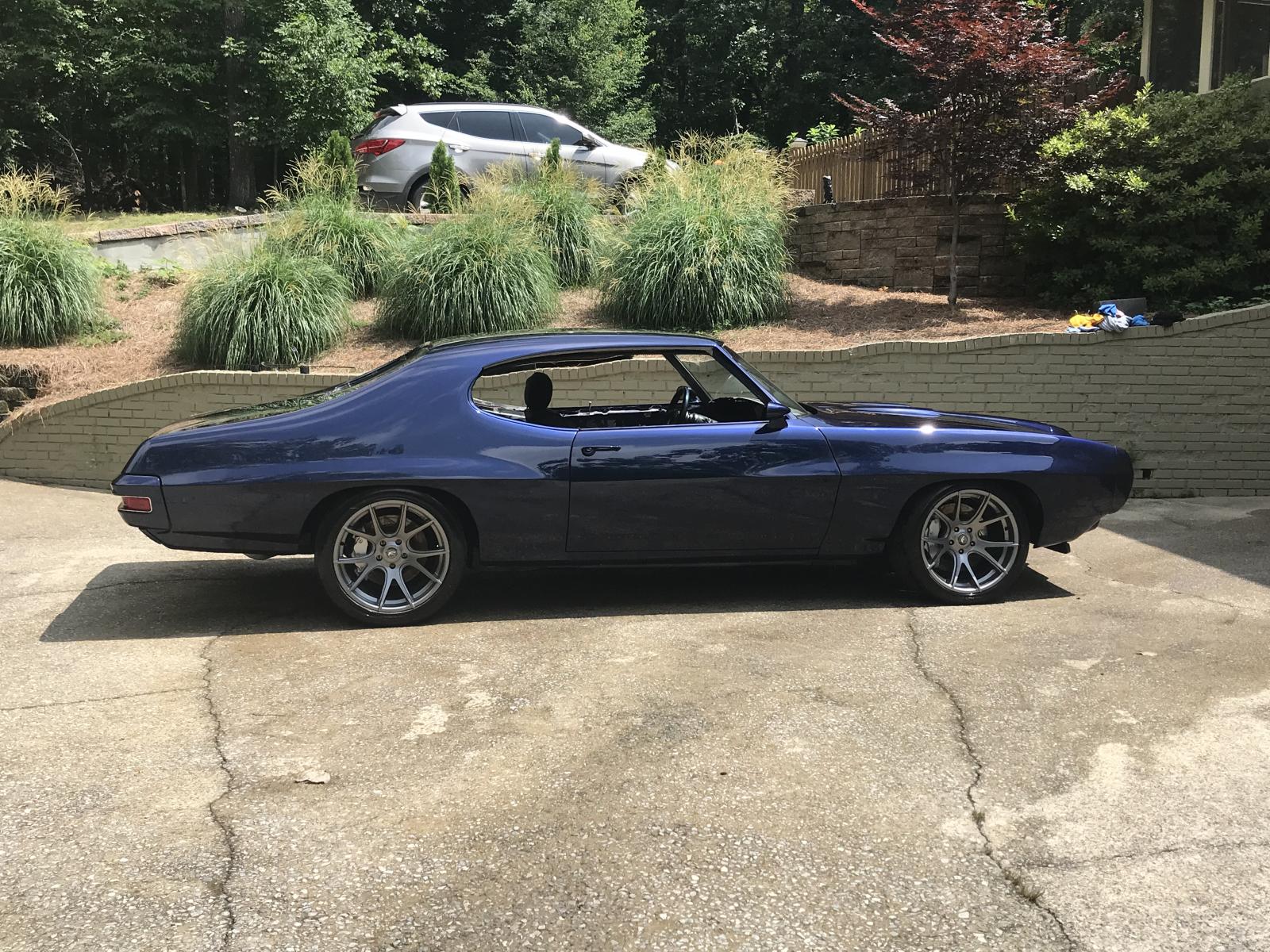

Size:  417.0 KBName:  370E0730-ABD7-4C9A-B449-89D6426966A8.jpg
Size:  437.6 KBHere are some pics of my GTO with 19” wheels front and rear. 345/305 tires.

      Quote Originally Posted by 968ls1 View Post
      What width and back space are you running? And any modification to the rear to get 345's to fit?

      I agree, but I also don't see a need to stagger wheels at all. Look at Tom's GTO...it looks amazing with 19s all around. A light stagger is achieved with having the front tire be slightly smaller in diameter than the rear tires.
      - - - Updated - - -
      Quote Originally Posted by ram540 View Post
      It's tubbed.
      Oct 2015
      64
      12” with 7-1/4” back spacing. Rear is mini tubbed, front fender are slightly modded as well. If I had to do it again I would just run 315/30/18 front and rear like the UMI LeMans and save a lot of time and $$. Andrew is correct my rear tires are 27.2” diameter and the fronts are 26” so it gives me a slight rake. I don’t like the look with staggered rim diameters.

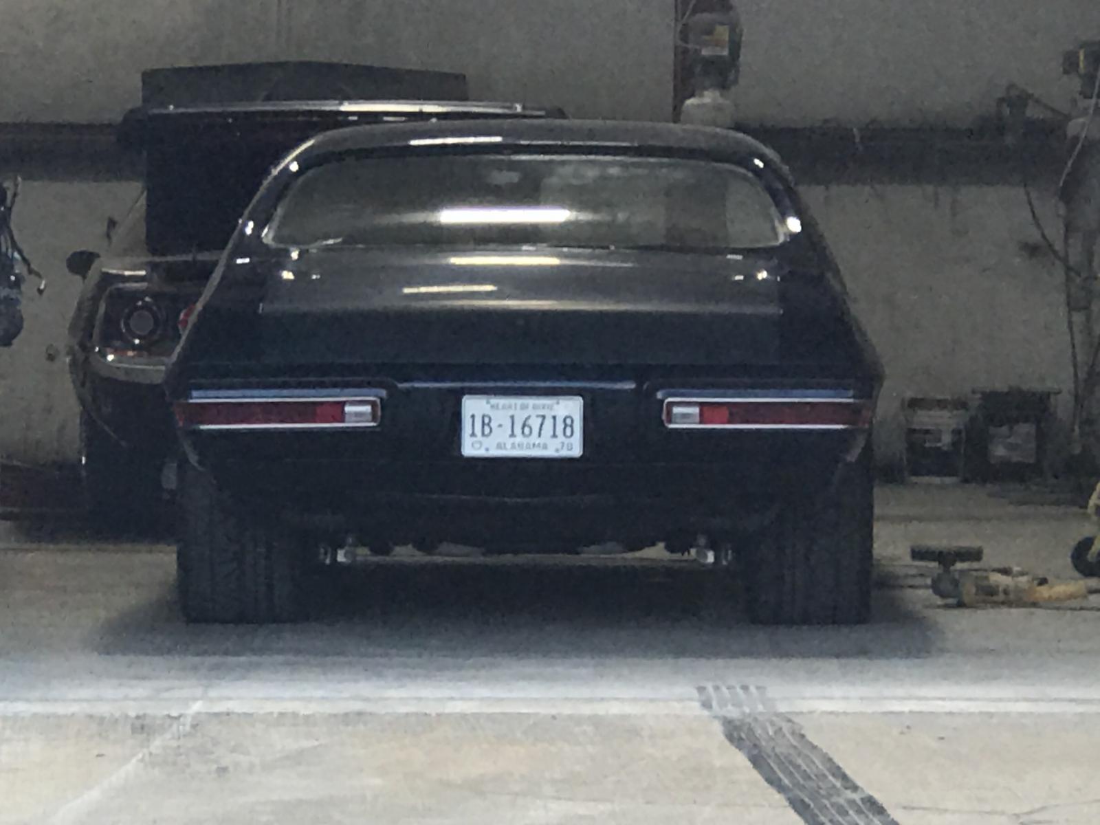

      Oct 2015
      64
Size:  126.6 KBName:  7A027543-89B1-4C0D-90D1-57A3FAA40425.jpg
      Rear shots sorry for poor quality.
