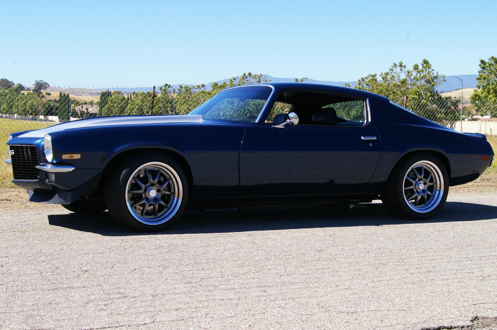

      Hmm. I have hotchkis front and rear springs plus F and R swaybars on a 71 with bilstein shocks and Caltracs. Works pretty good. Car has run mid 11s with this setup. And is more of a handling car. Handles very good considering the old technology.

      yup - not exactly the same but similar set-up between 1st and 2nd gens.
      Picture of the car for reference:
