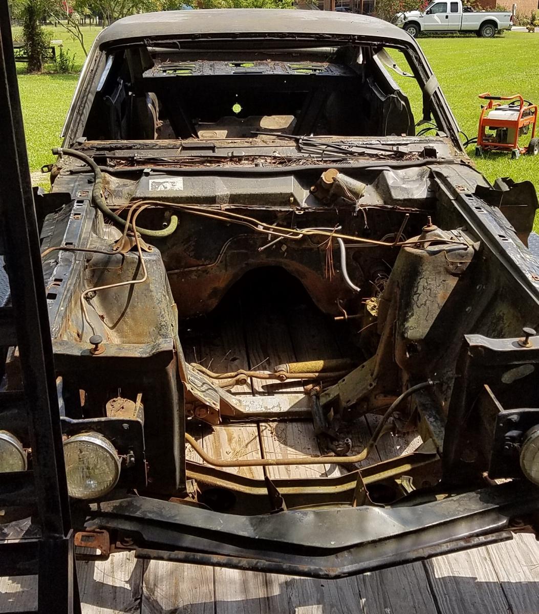

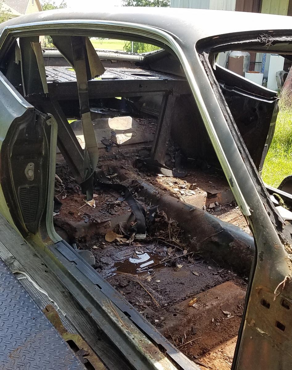

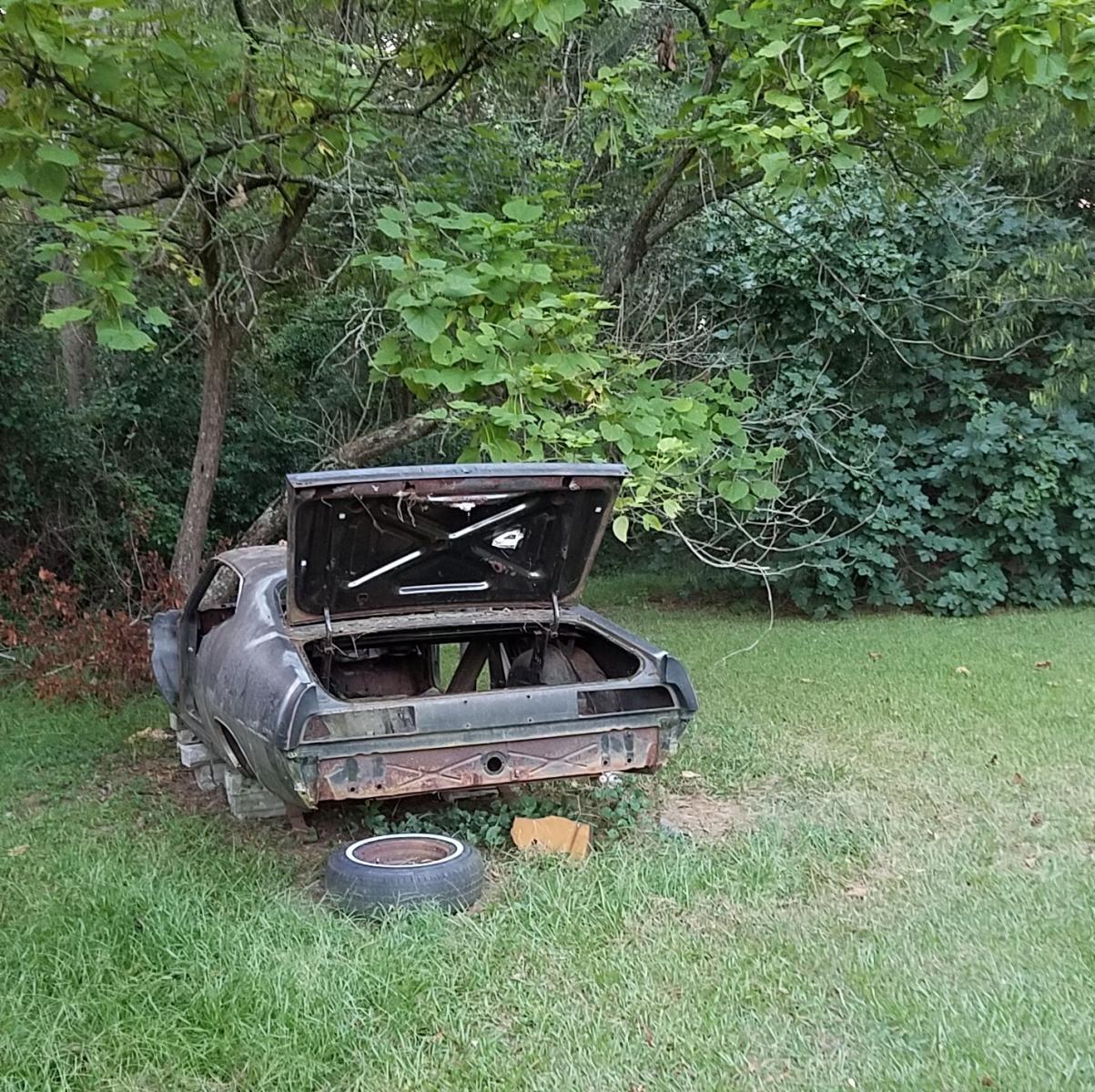

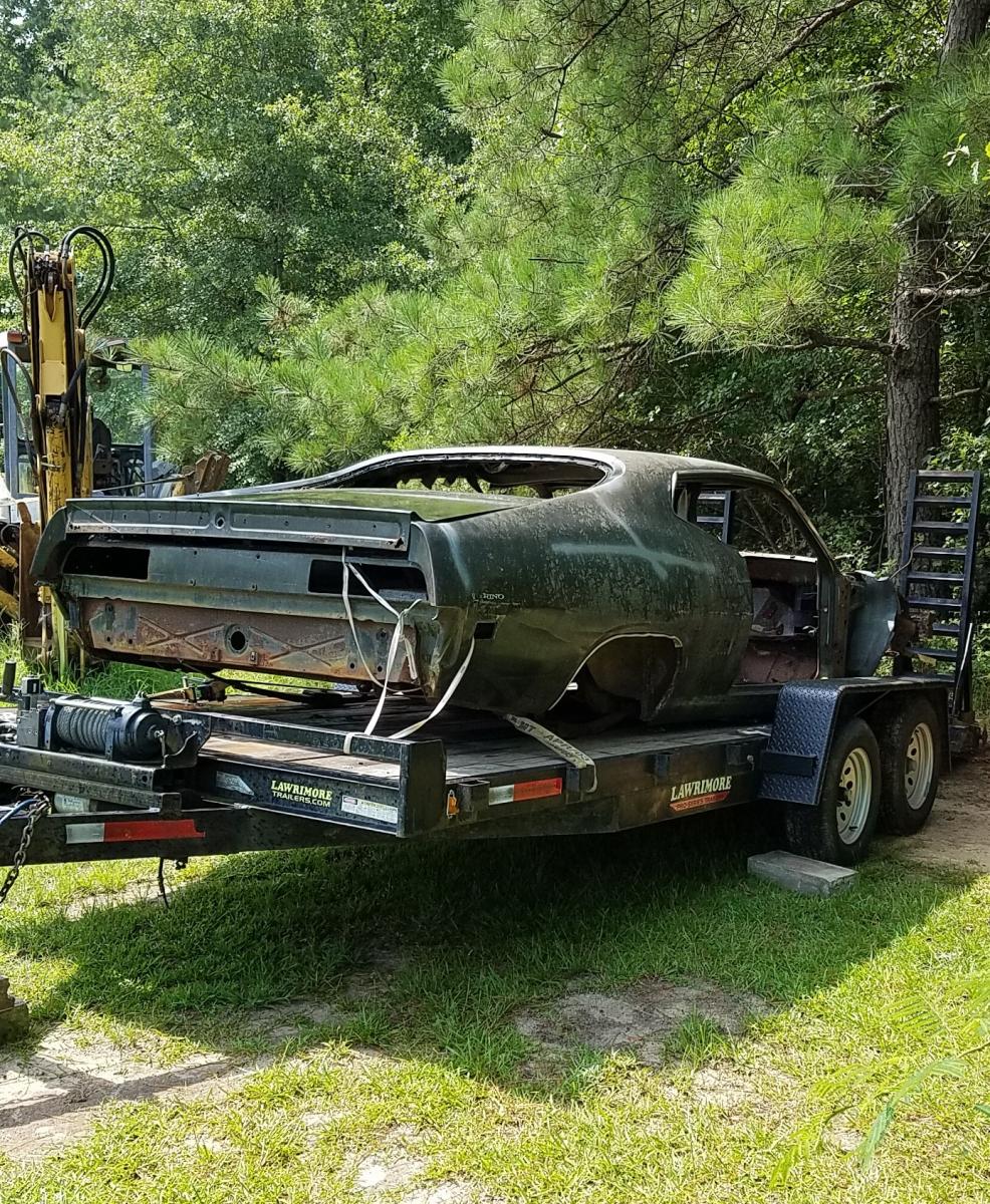

      The 70 shell. Floorpans were toast and the tunnel looked as if the driveshaft exploded but all that was coming out anyway Name:  20160721_110844.jpg
Size:  224.3 KBName:  20160721_110854.jpg
Size:  245.4 KBName:  20160721_110833.jpg

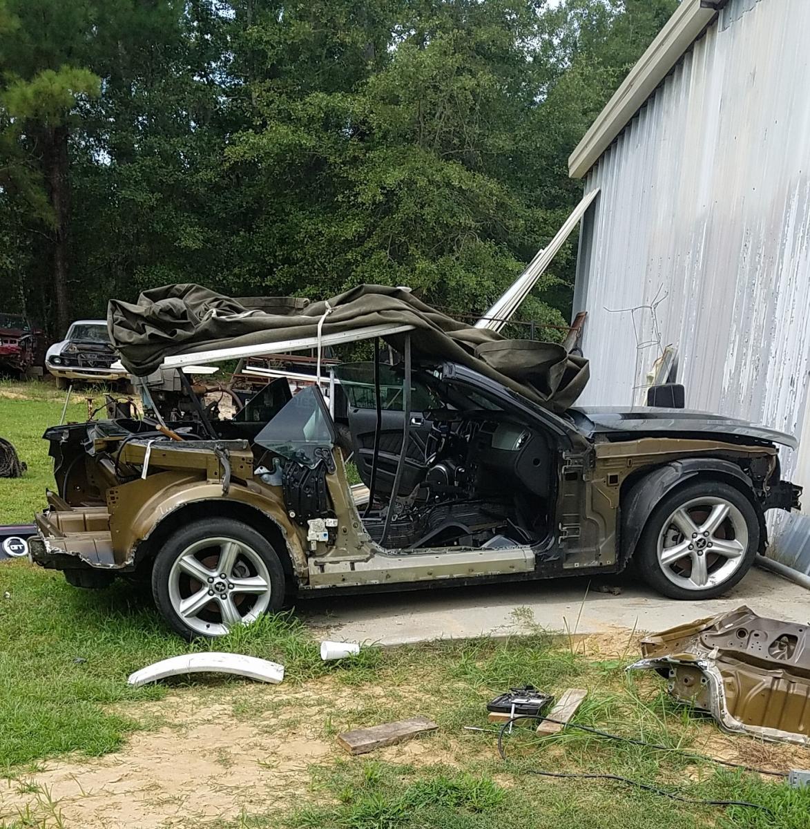

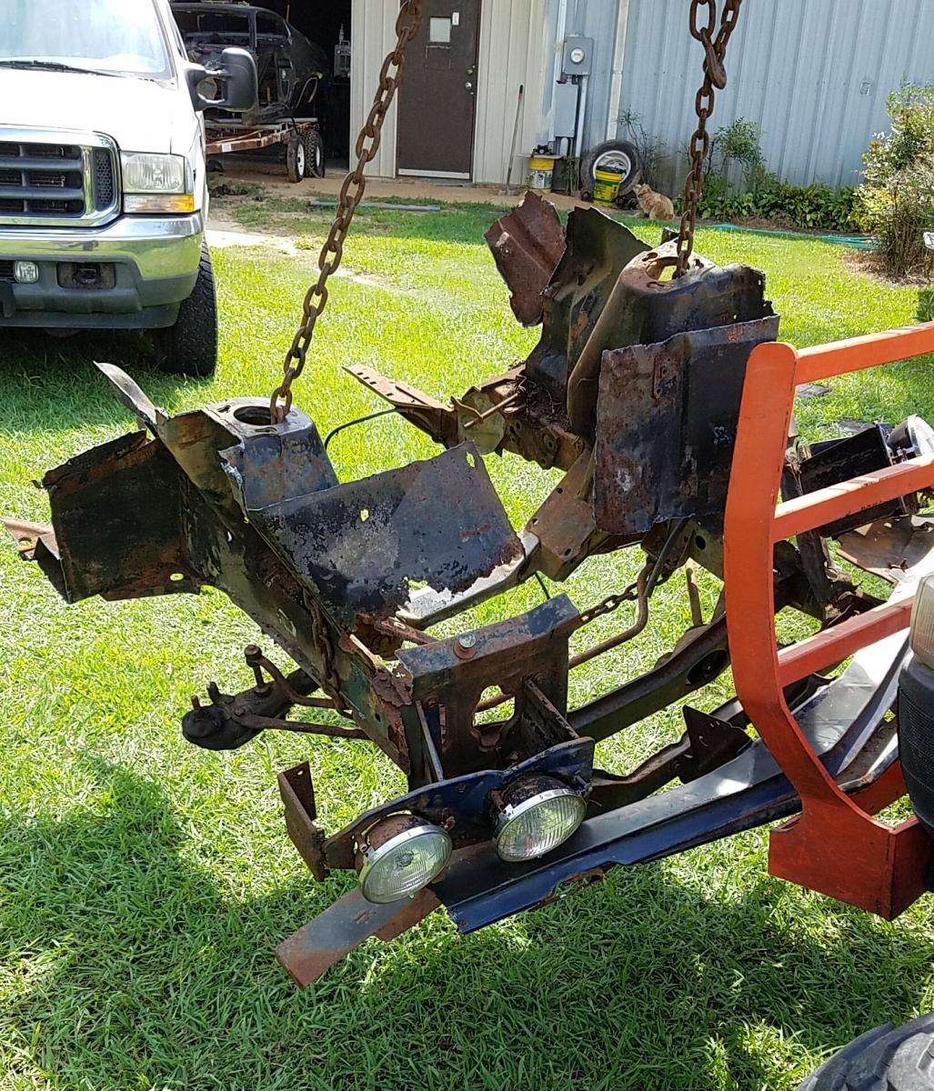

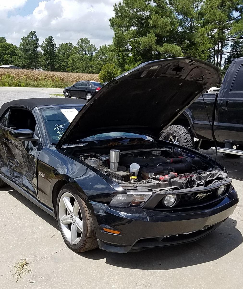

      The Donor car before tear down Name:  20160811_131146.jpg

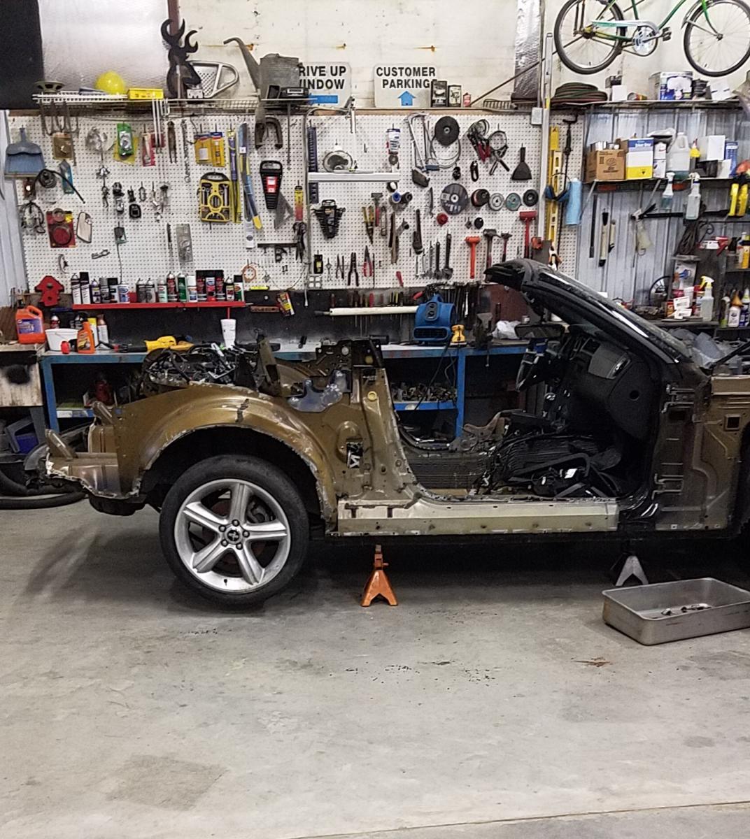

      And after tear downName:  20170728_112002.jpg

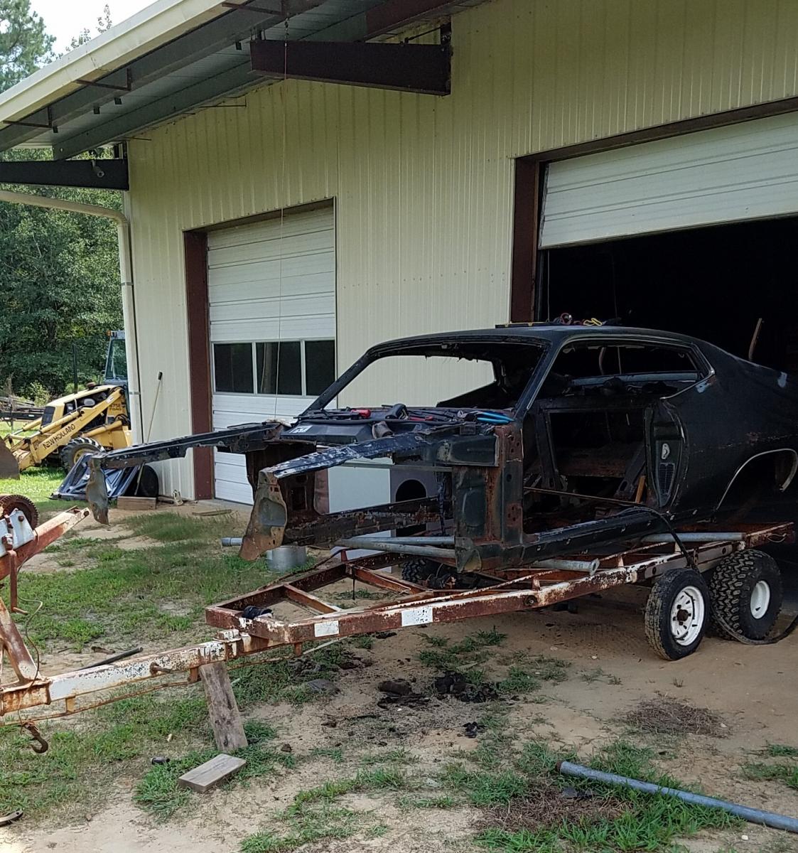

      Turning the Torino shell into more of a hull. Left the fender aprons and cowl attached to get some more measurements. Only fitting that this huge car be sitting on a boat trailer Name:  20170826_145357.jpg
Size:  250.5 KBName:  20170826_145421.jpg

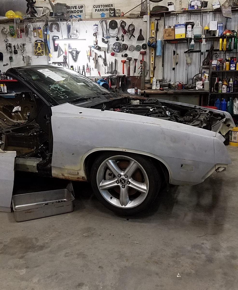

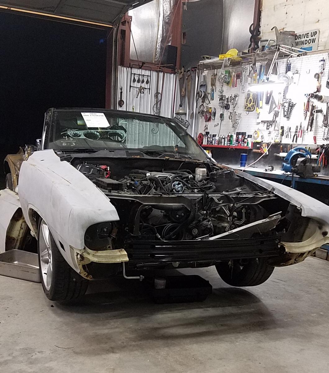

      Hung the fenders on temporarily just to get some inspiration that this would work. Originally toyed with the idea of leaving the factory mustang in place in order to not disturb any of the cowl and dash of the Mustang but trashed that idea due to it being a noticeably different pitch from the Torino. Name:  20170802_204359.jpg
Size:  192.9 KBName:  20170802_204338.jpg

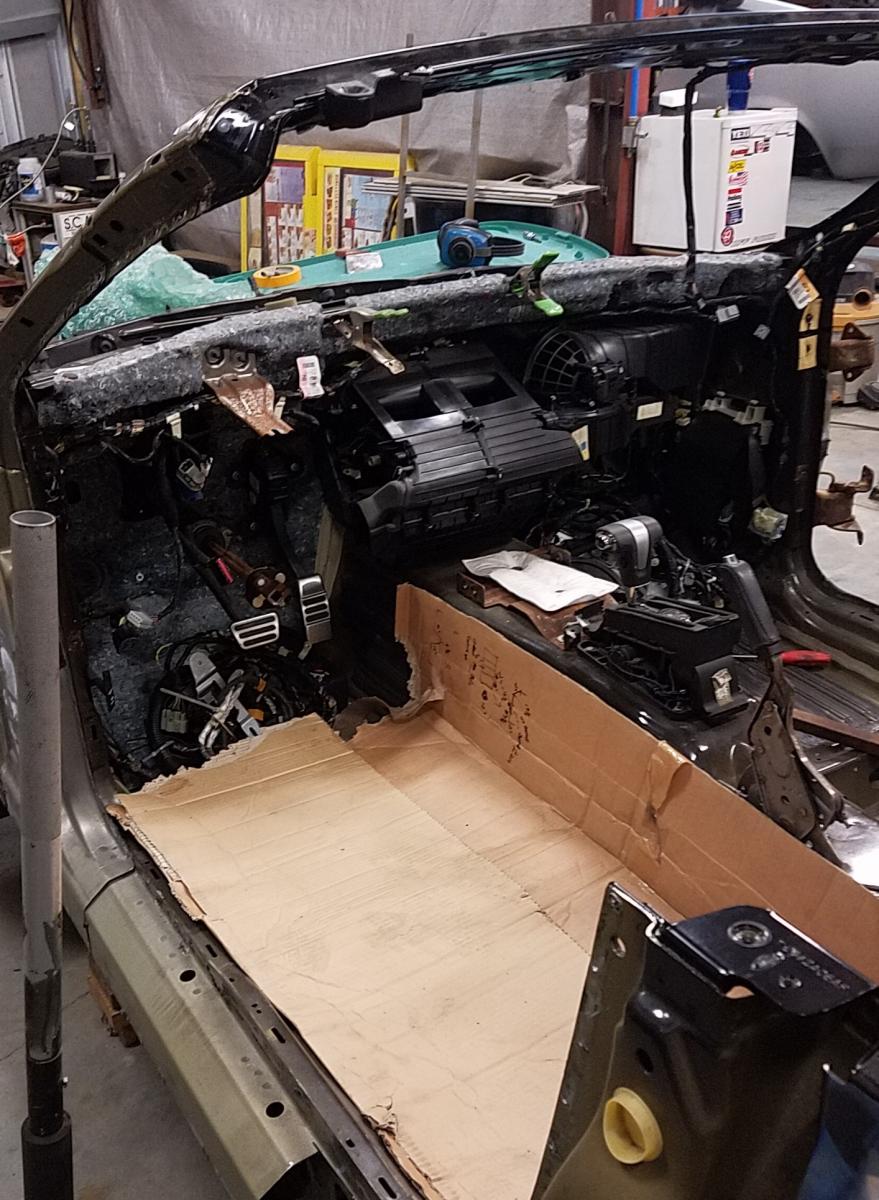

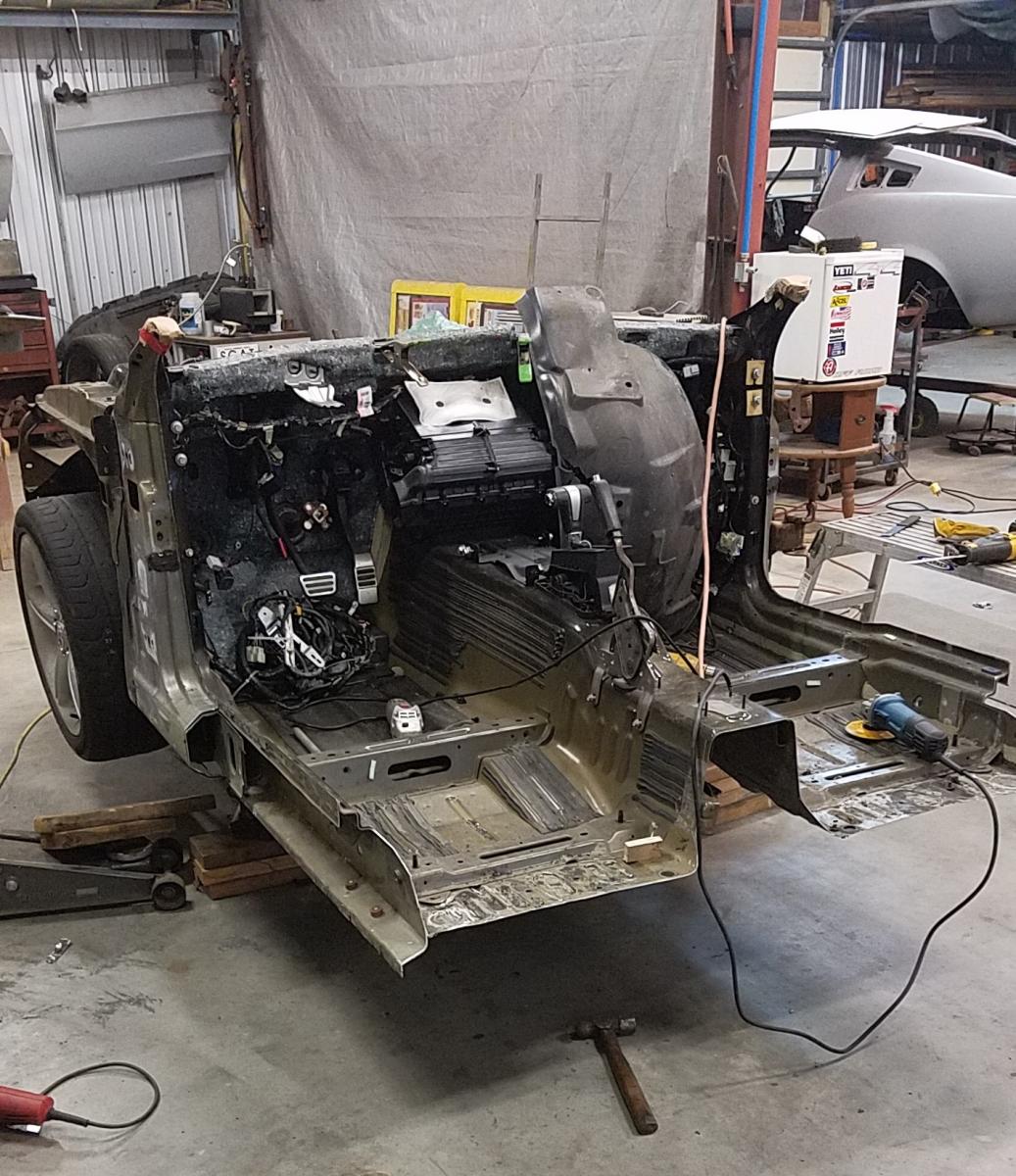

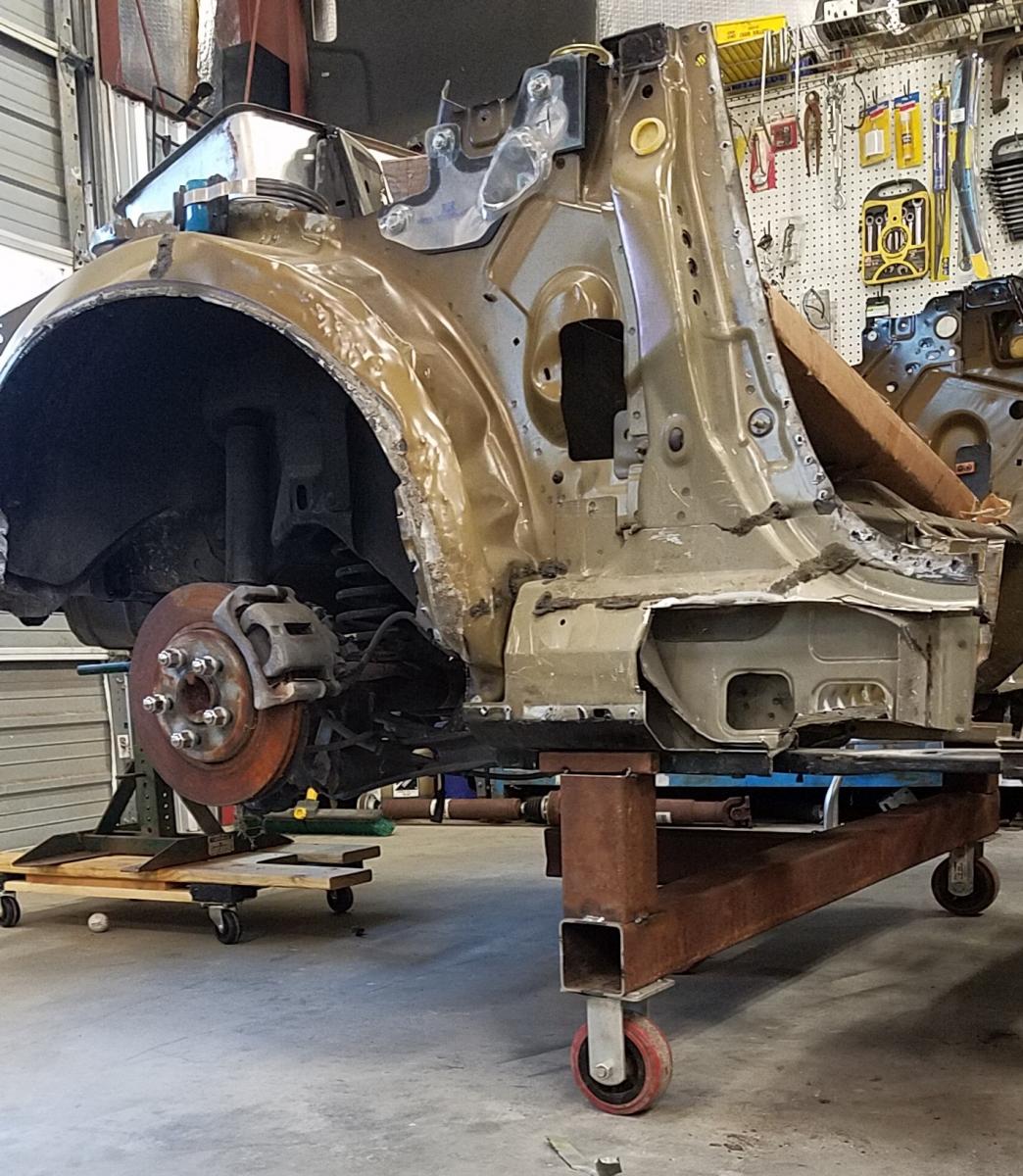

      Since I tend to get so focused when I'm working on this thing, I have a bad habit of not taking time to take pictures of the progress being made, especially the smaller stuff so excuse the lack of detailed progress pictures. Between fighting to get all the interior and dash out, to cutting up the unibody, tear down on the 2011 was a chore. Anyone that believes old cars are built stronger has never tried cutting into the frame/unibody of a new car. Took a lot of cutting wheels and sawzall blades to get the fat trimmed off of the car. In order for the Torino body to sit on the Mustang, the outer structural panels from the door post back to the wheel tubs had to be removed which meant hundreds of spot welds had to get drilled out. Once that was removed, the Torino should slide on to the Mustang's unibody like a glove....Naturally that wasn't the case. Since it seemed neither of these cars were built the same on each side, minor trimming had to take place before the Torino could drop down on the unibody. Name:  20170801_201741.jpg
Size:  222.0 KB Before anyone dogs this car for being automatic, the MT-82 is a relatively crappy transmission especially in the early years and this car went for cheaper than any other car I had watched at the auction, so auto it is. Name:  20171018_223108.jpg

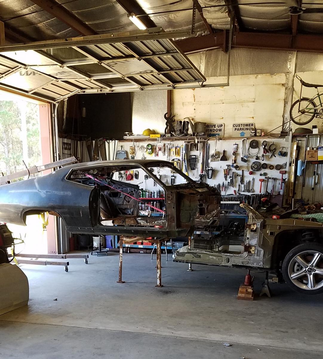

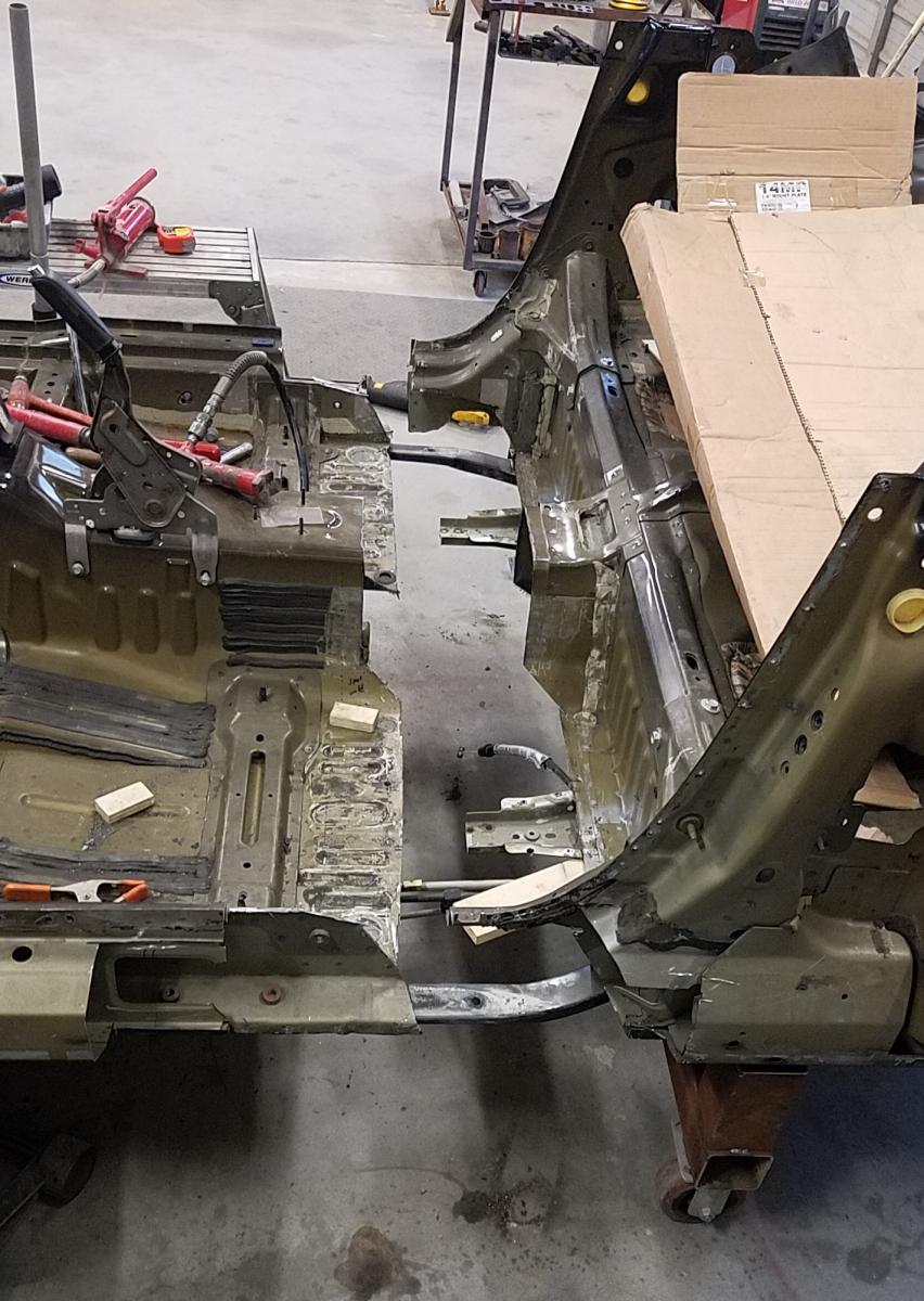

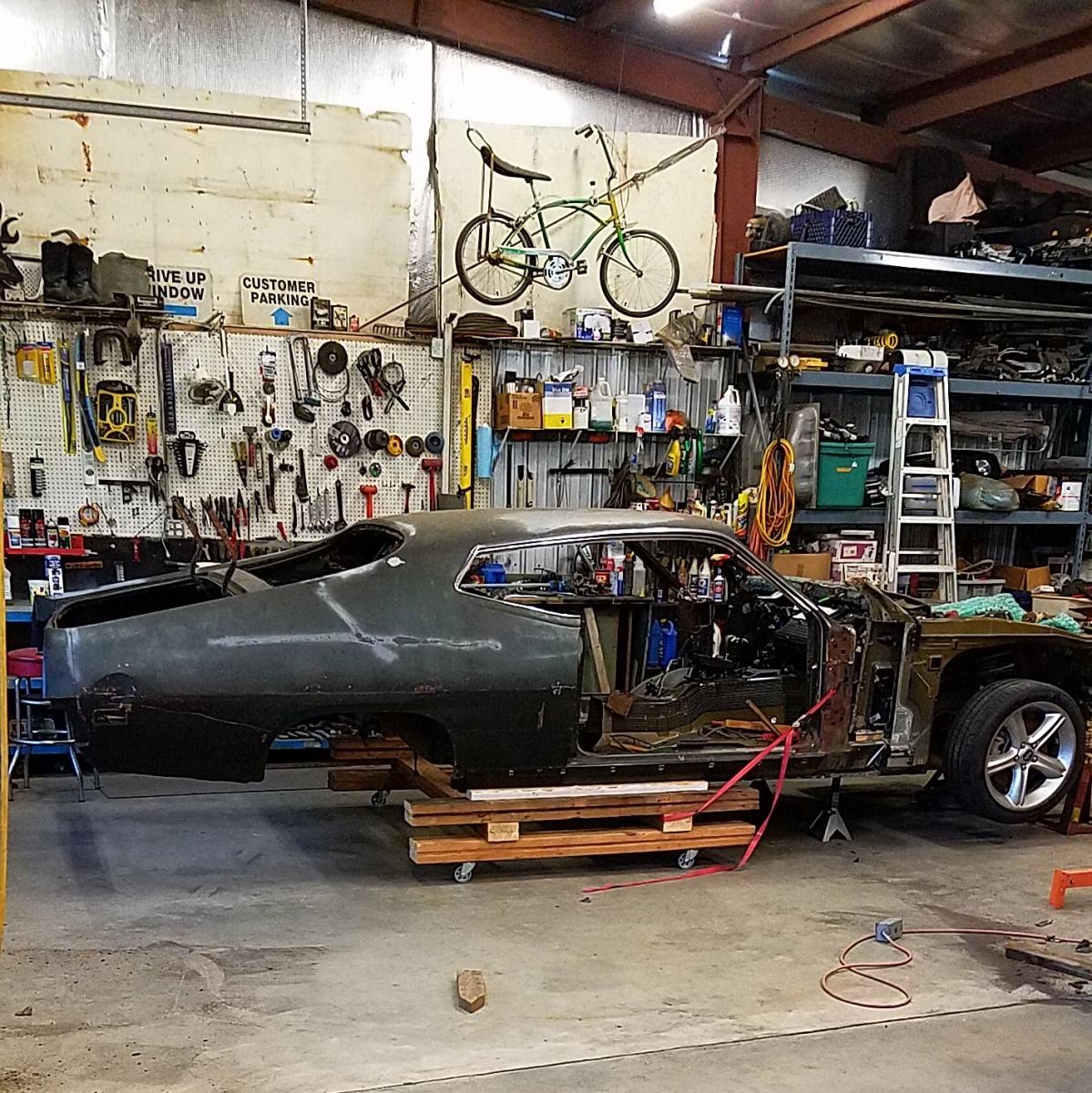

      Next step was to do the crazy part and cut what used to be a running and driving car in half. Figuring out where to make the cut took a lot of planning and measuring to make sure going back together would be easier. Finally ended up cutting thru the rear seat floor-pan as this was the only section with minimal brackets in the way then coming up at a forward angle on the rocker. Another plus side of cutting here would allow for more leg room in the rear. Before cutting we had to make two separate carts to support the car once it was cut so moving it around wouldn't be near as troublesome. Name:  20171021_103337.jpg
Size:  152.7 KBName:  20171022_182105.jpg
      Version 1 of this cart Name:  20171021_103406.jpg

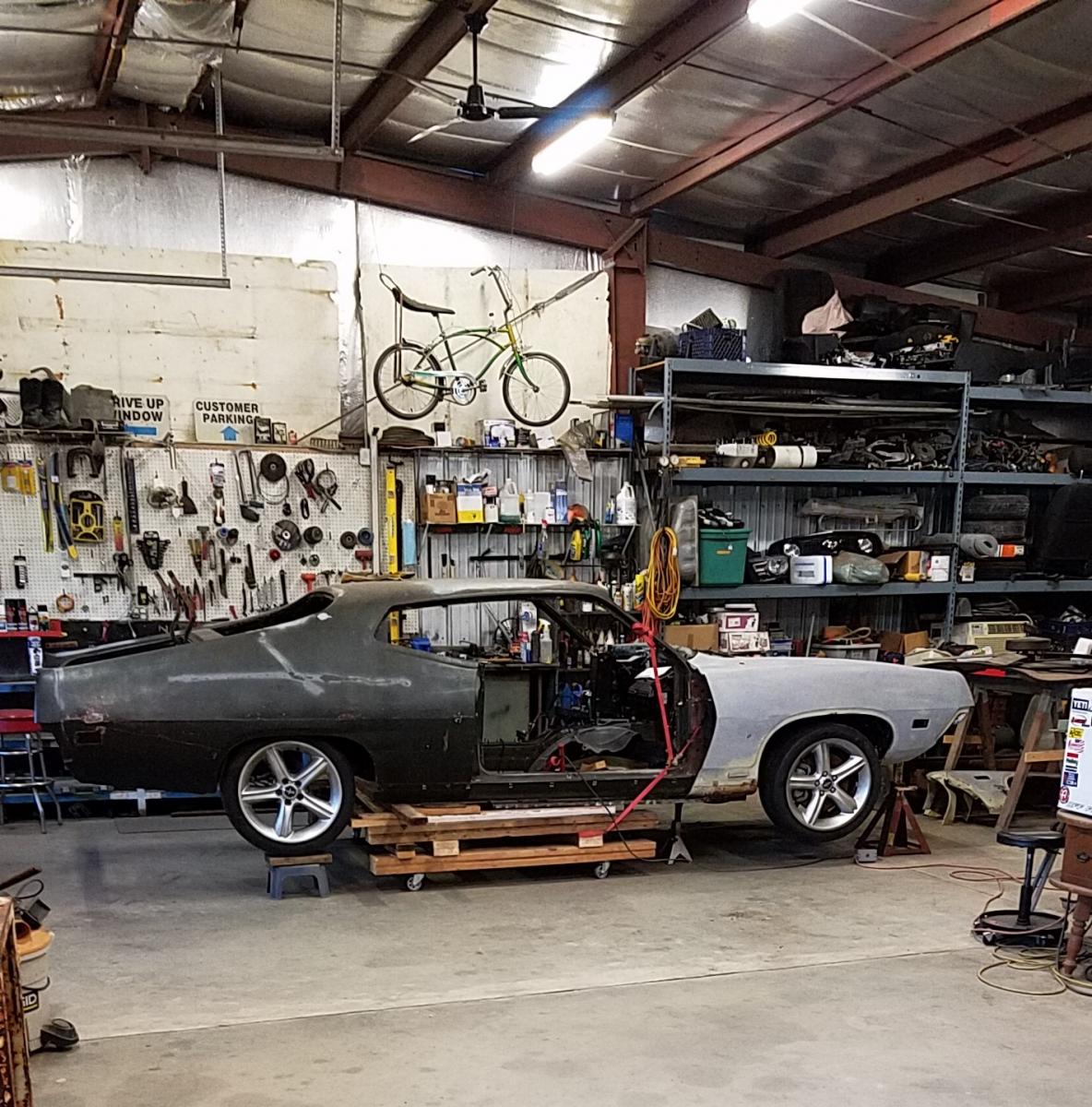

      Once the majority of the fat was trimmed off of the Mustang's unibody, it was time to start trying to put the Torino shell on. Since the back half of the mustang was out of the way, we built another cart to sit the Torino on in order to roll it into place on the front half of the unibody. This made it easy to see what else needed to be trimmed and also see how far forward the car would need to sit to get the wheelbase as close to factory as possible. The windshield was going to be a problem tho since the mustang windshield would not work. Getting a windshield made was out of the question and since this would be a daily driver type of car, I hated to use lexan due to how long it would hold up. So we decided to try and use the factory Torino windshield and adapt it to the Mustang's cowl section. First try, I bent a piece of angle to mimic the curvature of the old Torino's cowl where the windshield sat and was going to tack it near the rear of the mustang's cowl and then build a cover panel to make it all look factory. This would have required trimming the back of the dash a few inches but that didn't seem like to big of a problem until I looked at the dash again. Mounting the windshield this way would have the bottom running right into where the defroster vents are on the dash and due to the way the system is built under the dash, rerouting the vents would've created a lot of other problems and fixes that I was not capable of. I can fix metal to some degree, plastic not so much. So with that idea scrapped, it was on to the next one. After a lot of going back and forth, we finally agreed upon moving the Torino a little farther forward and have it sit slightly higher on the unibody to allow us to slice into the Mustang's cowl and add the new cowl in place. By doing this, the Torino windshield would have to lay back and the A-pillars would have to modified. Hesitant at first of how the end product might look, we made one side to get a general idea and both agreed that it would be barely noticeable once finished. Once everything was in place, we could clean it up to make everything look factory and all the water would run off where it needed to go. This is simply our working idea right now due to making sure the rest of the car is all together before doing anything to the windshield, so this is a future project to tackle. But since we now had a game plan for the windshield, we knew about where the Torino body had to sit on the unibody in order to move on. Name:  20171028_115344.jpg
Size:  232.5 KBName:  20171111_114719.jpg
Size:  287.2 KB Had to throw on the wheels and fender to get another good visual of what the end product will look like. The front fender will require some adjusting to get it nice and centered over the wheel since we are adjusting the original wheelbase nowName:  20171117_143729.jpg
