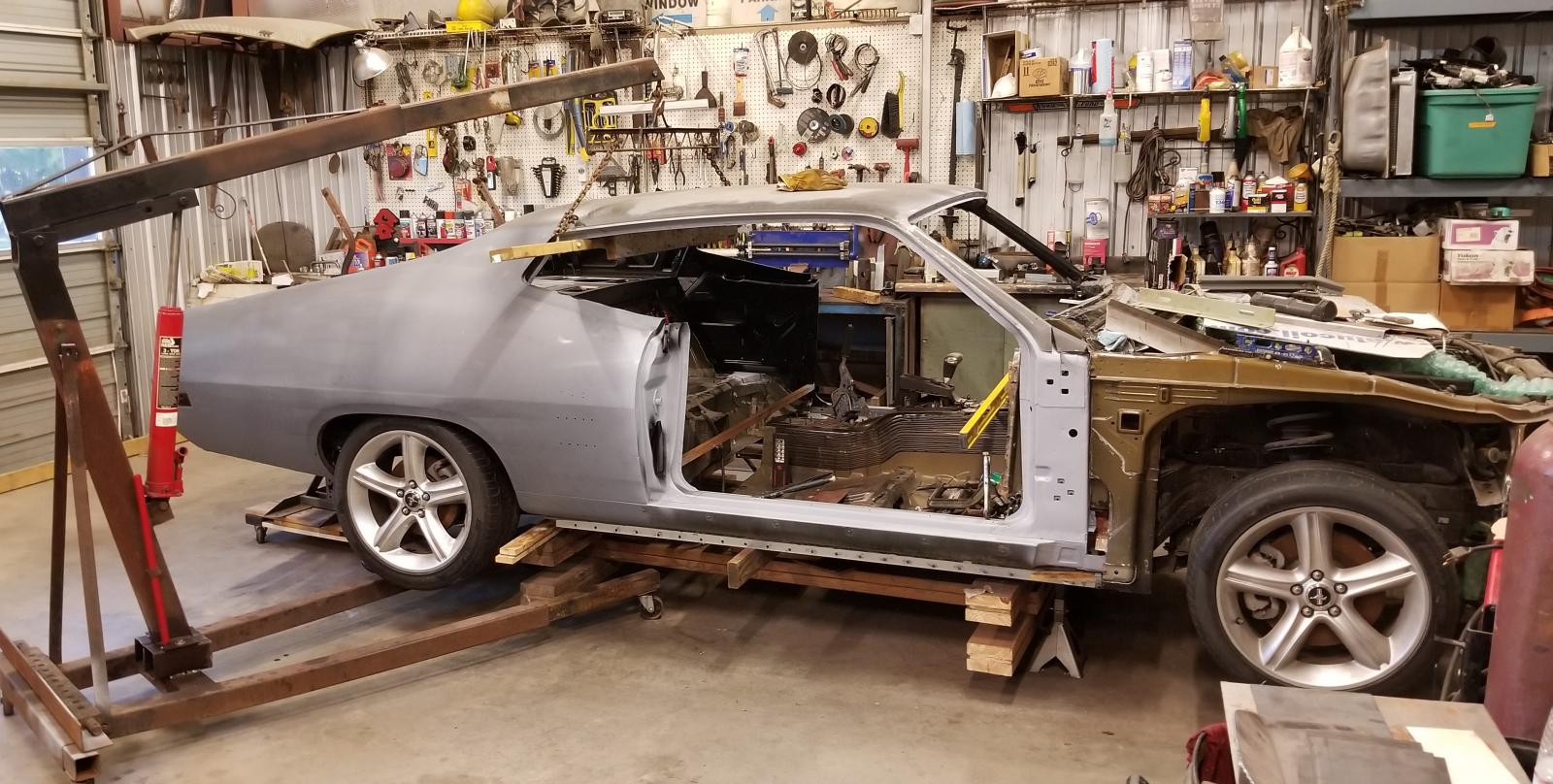

      Had to put the Eastwood Contour SCT from that Christmas to the test and see how good it would tackle this old paint. Was really impressed how good it stripped and the finish it left on the bare metal. Makes me wish this body was completely solid and I would just leave it bare. But anyway started on the back half since the front was pretty much where it needed to sit. Good bit more trimming had to be done on the back tho mainly around the wheel tubs. It seemed like every time something was trimmed, another piece caught something else. Frustrating to say the least, especially lifting and lowering the car with the engine hoist, but finally got it to sit where it needed to go. Once it was down, it was crazy to see how close everything came together. Going to be a lot of filler pieces but it was very relieving to see that this might actually work.Name:  20171202_135402.jpg

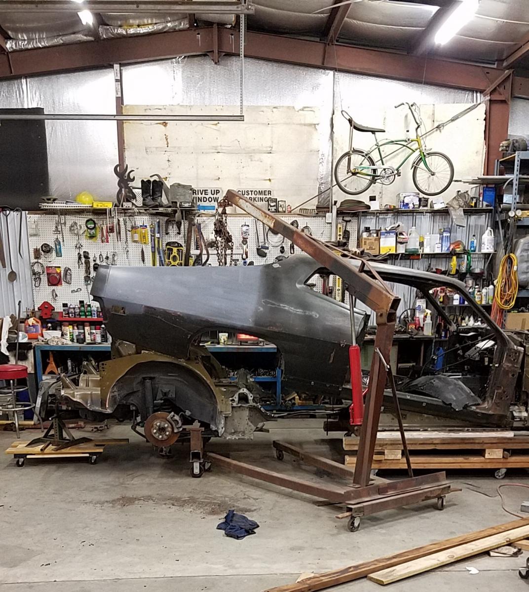

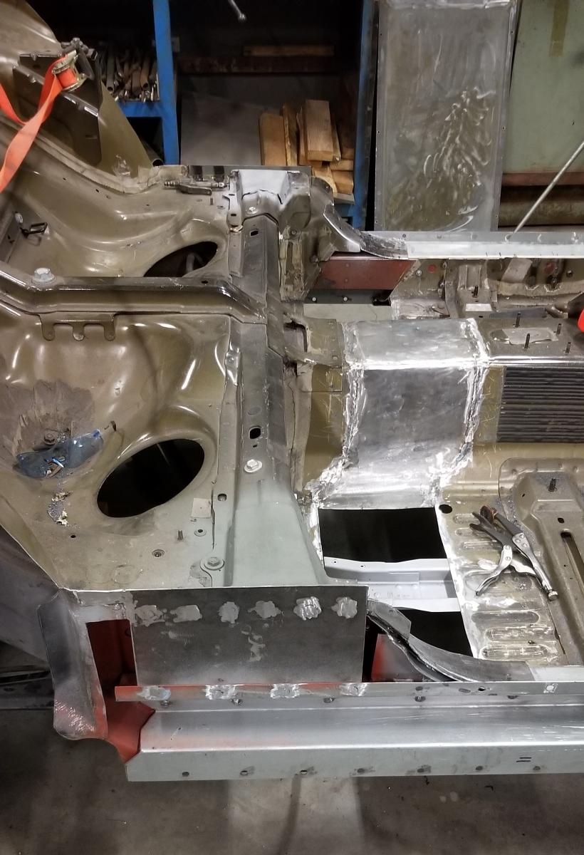

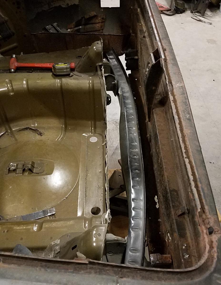

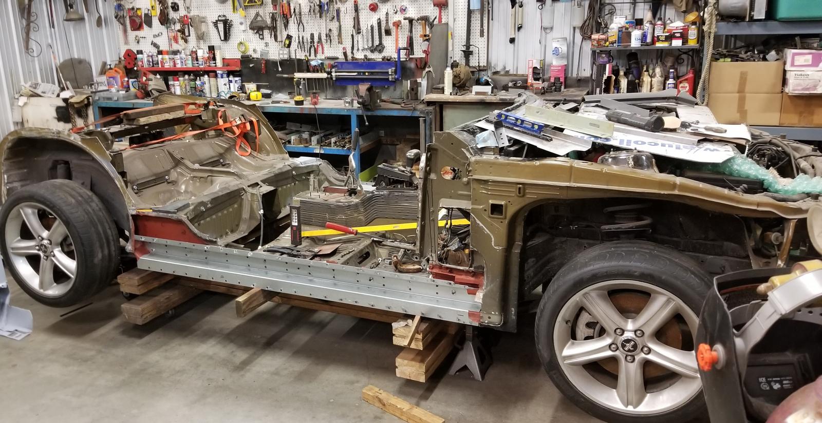

      Now that everything was all under the Torino shell, it was time to start putting the pieces back together. Making sure the car was as strong or stronger than before was the main concern. Came up with an extended rocker to bridge the new gap in the pans and also the gap from the Torino's inner rocker and the Mustang's inner rocker since the outer had been trimmed off. Couple of test pieces and designs later, we finally ended up with something we were happy with and had 2 pieces made at the local metal shop. Once they were clamped in, the back half and Torino just slid like a drawer into the front half making it easy to get the wheelbase exact and square. Name:  20180313_201436.jpg

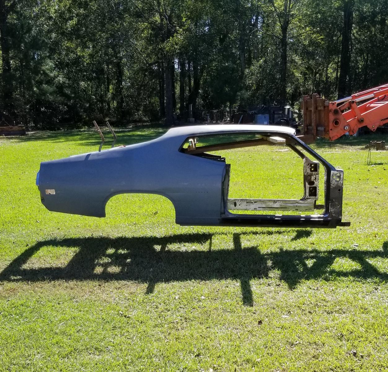

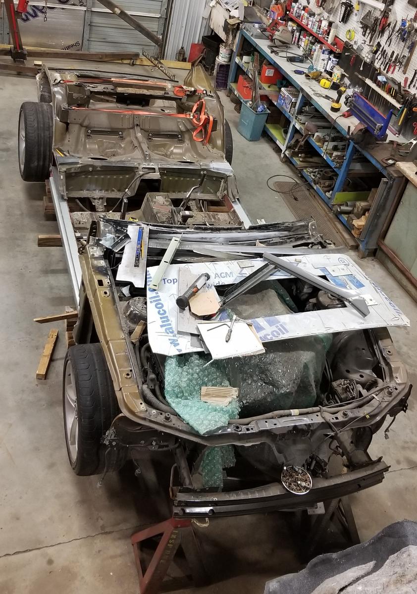

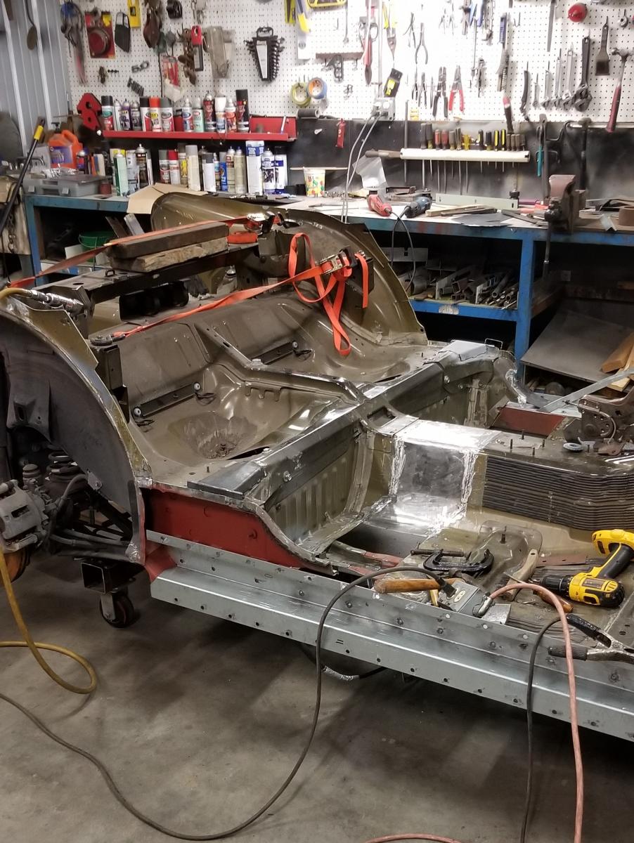

      Had a good sunny day after weeks of rain so pulled the Torino shell out and sandblasted and primed the inside. Needless to say it took quite awhile to blow all the sand out of all the crevices. Set it back down on the Mustang chassis to make sure everything was lined up before beginning to tie the unibody back together. After quadruple checking every inch of this build, we agreed it was where it needed to be. And so the welding began....Name:  20181013_115803.jpg

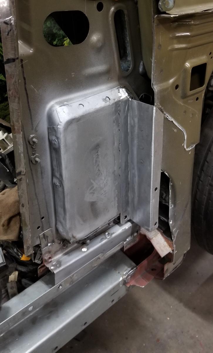

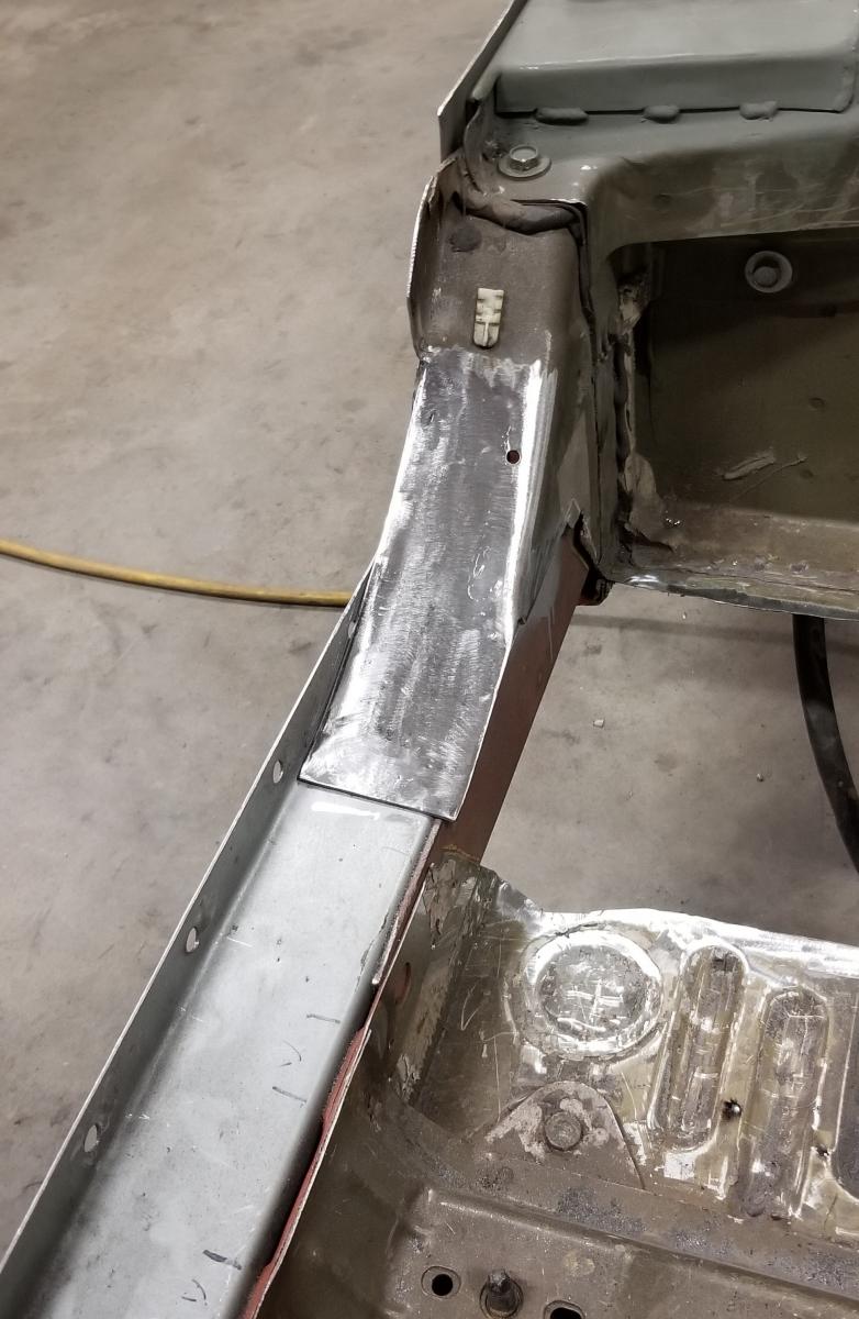

      Decided to knock out a couple of small things on the car while the body was off. Nothing fancy or groundbreaking but progress at least. Slimmed up the fuse panel and braced it to the inner rockers, added some more strength in the rear torque boxes, cleaned up the transitions to the new inner rocker. Also big shout-out to BMWrangle for the article on Was not expecting anything like that on my car especially at this point in the build. Name:  20190710_174753.jpg

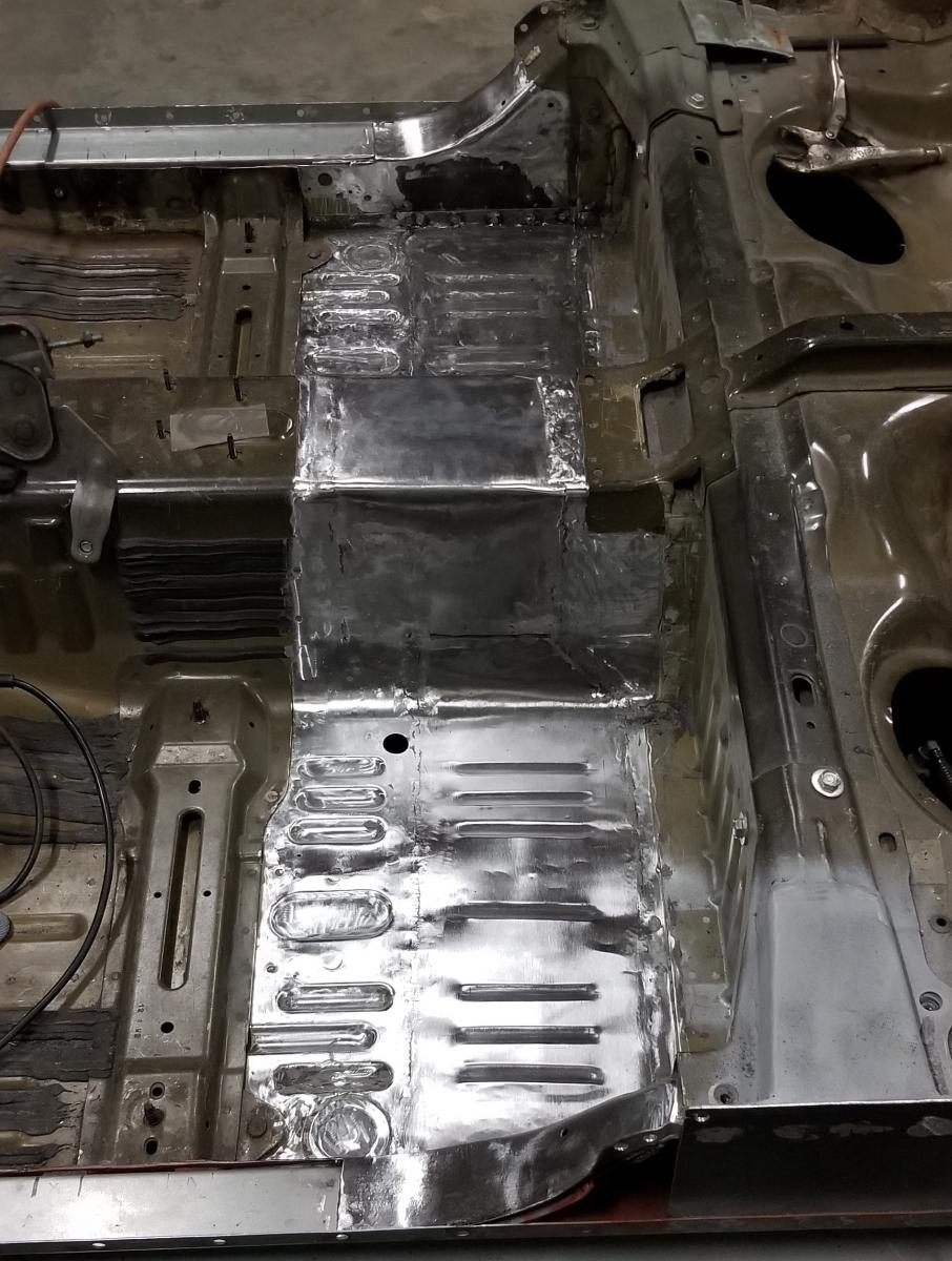

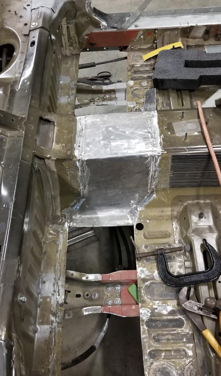

      Got the rear floor pans made and tacked in. Took a little longer than expected but I'm happy with how it turned out. Still have to add some more support to the trans tunnel and a new bracket for the brake cable, but atleast the floor is solid again. Also ran across a deal and picked up some 12 gt500 wheels and new nitto invos for cheap. Already digging how they look, just going to have to roll the inner lip some on the rear for some added clearance.

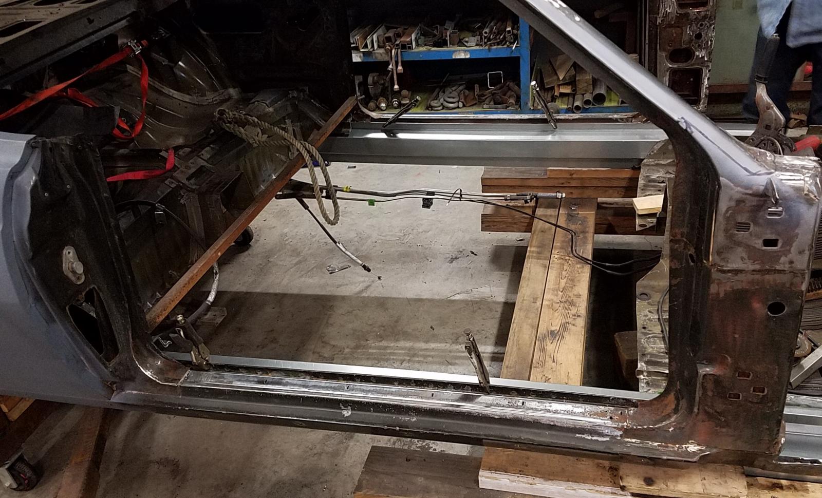

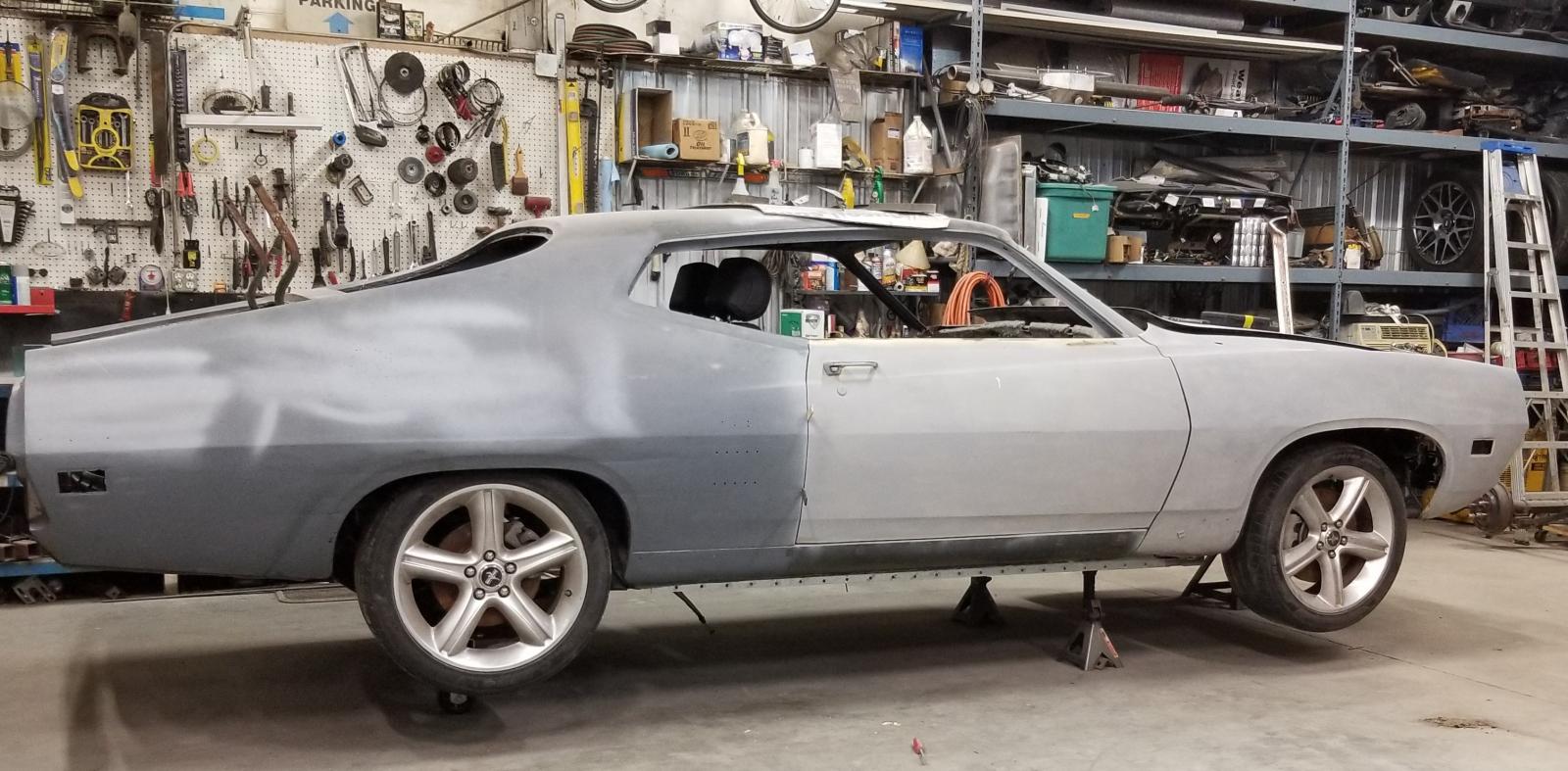

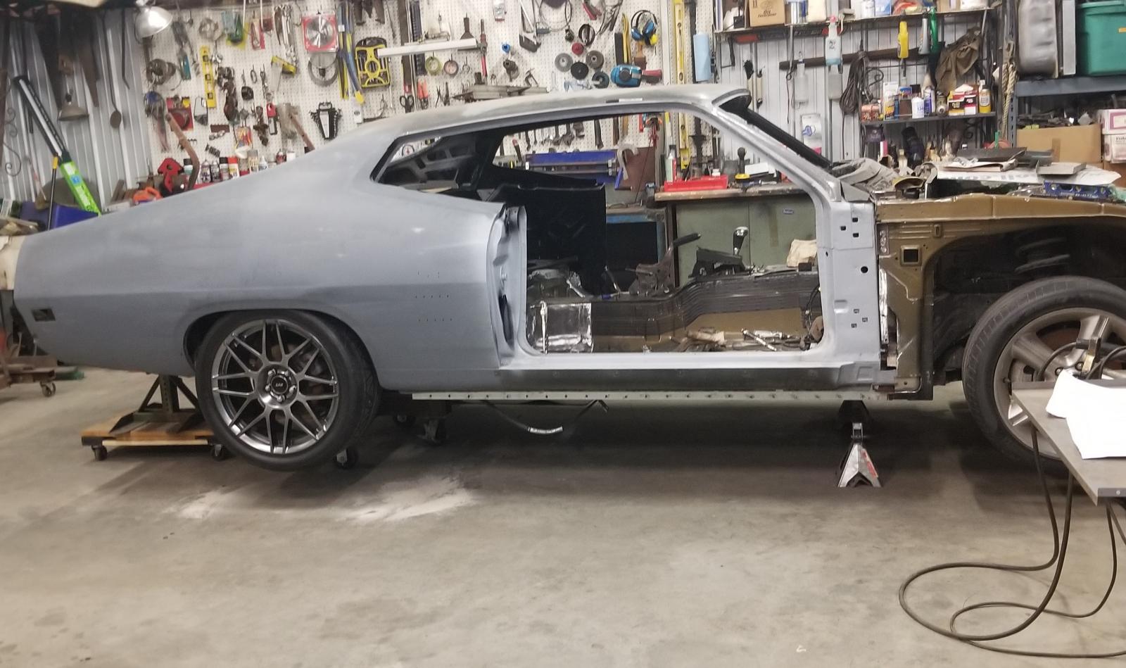

      Progress has been slow but I'm off for winter break so hope to make some progress on the 71 Torino and the S-1970. Hung the door shell to help get the fender lined up so I could free up some space in the shop and stay motivated. Most of the progress right now is on cleaning up the underside where the floor was extended and making some extra braces to stiffen things up. Slow and small results but results nonetheless. Name:  20190919_230300.jpg
