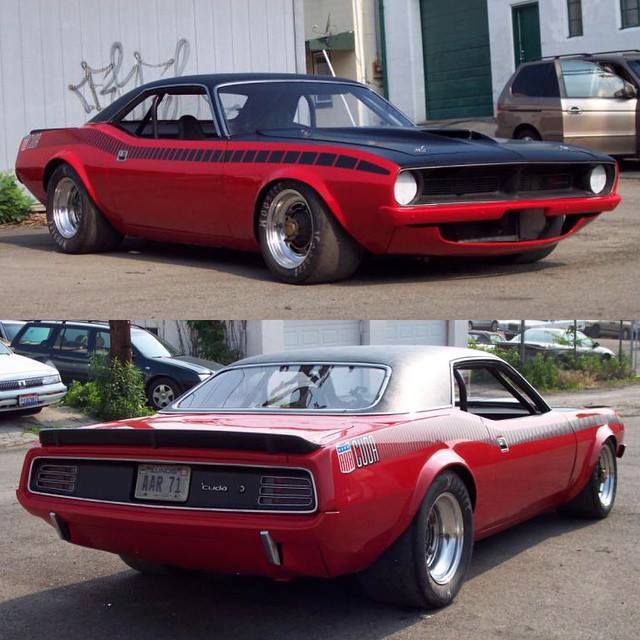

      -or John Sanberg's car, a winning Pro Solo car. They brought this thing to a Goodguys track event and left all the "high end" sponsored "Pro Touring" cars in the dust. This thing is a beast.

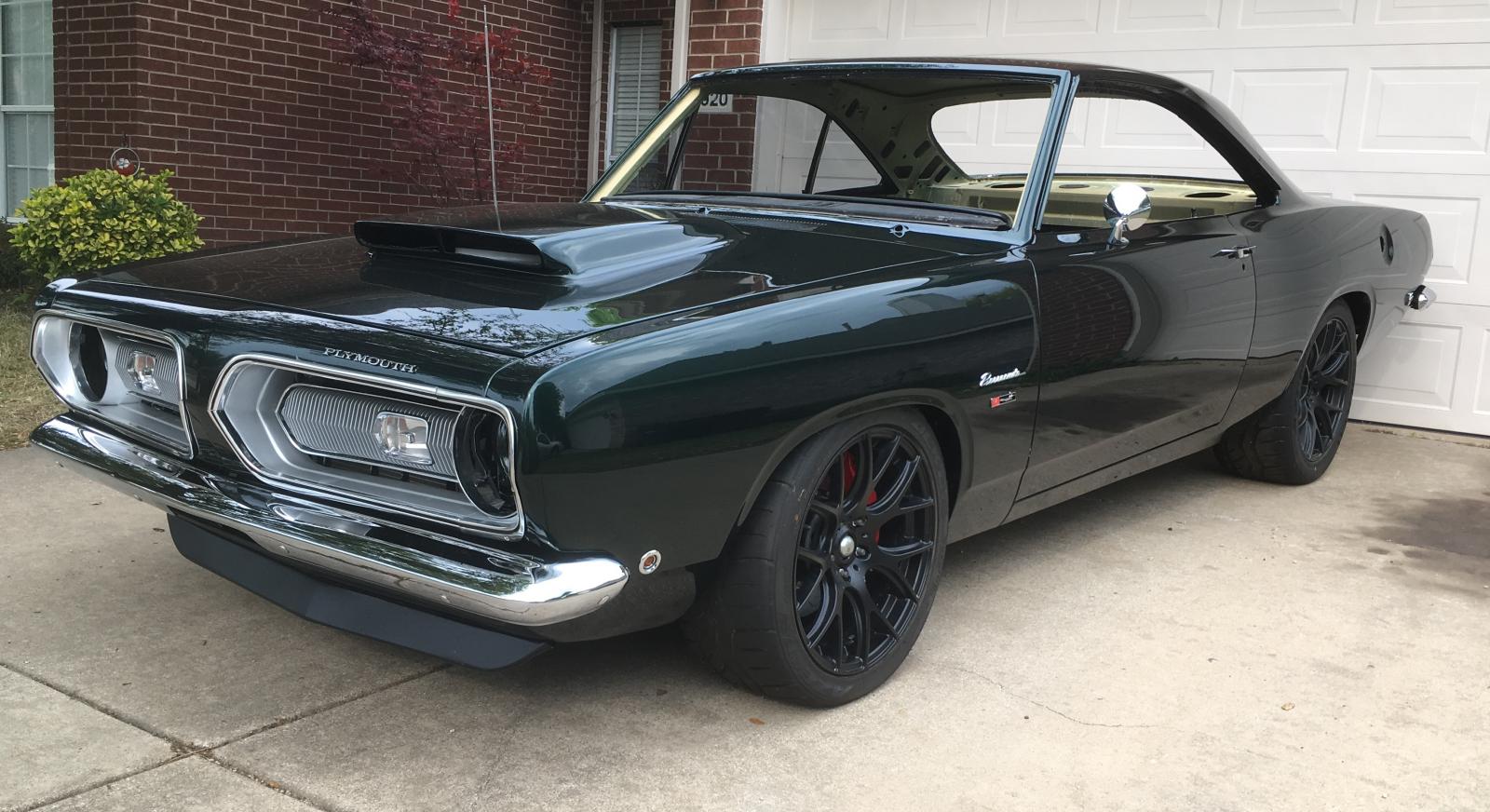

      This is a torsion bar suspension rear leaf optimized car. It has drop spindles and a few other tricks. Guy driving is Dr Bob Reed. I believe he won a national championship at one point driving Mazdas, so he is no slouch. This is his '68 Barracuda at Willow Springs.
      https://m.youtube.com/watch?v=x0q7w6...ature=youtu.be
      He sold it and just finished building another one with a Gen 3 392 Hemi.
      His new car:

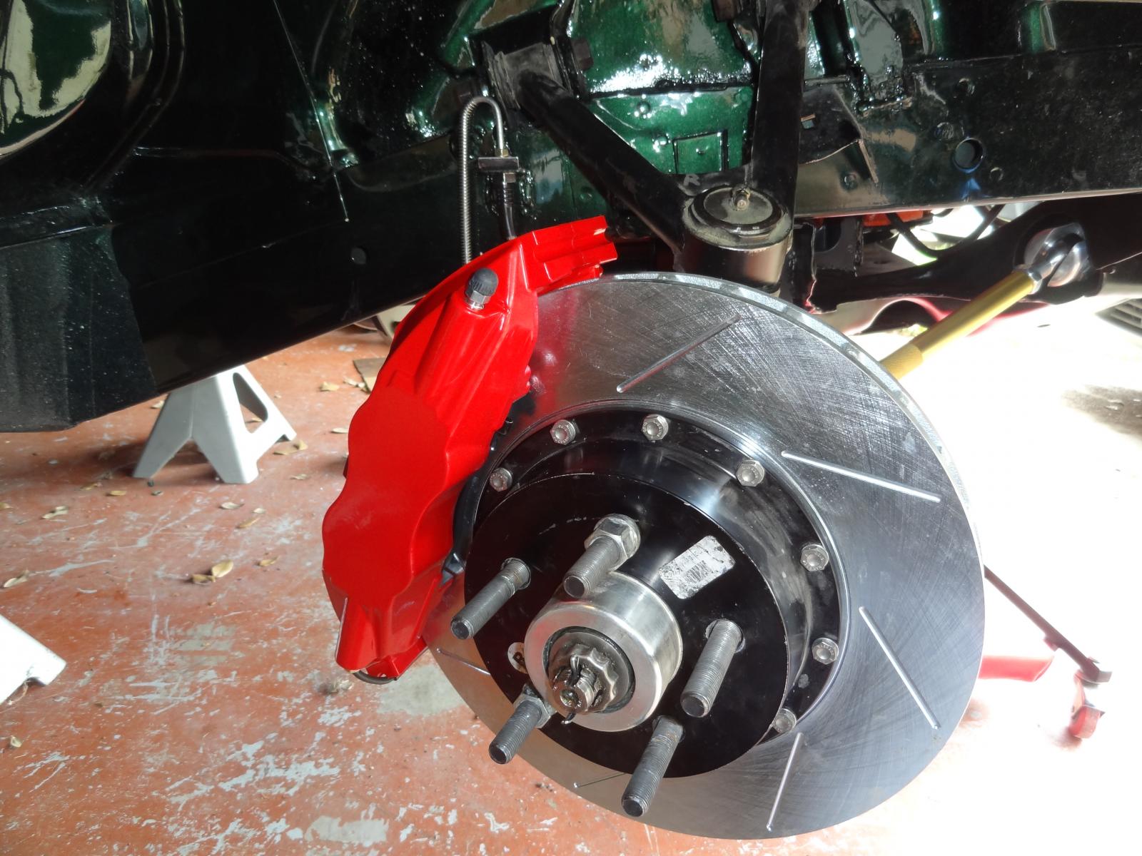

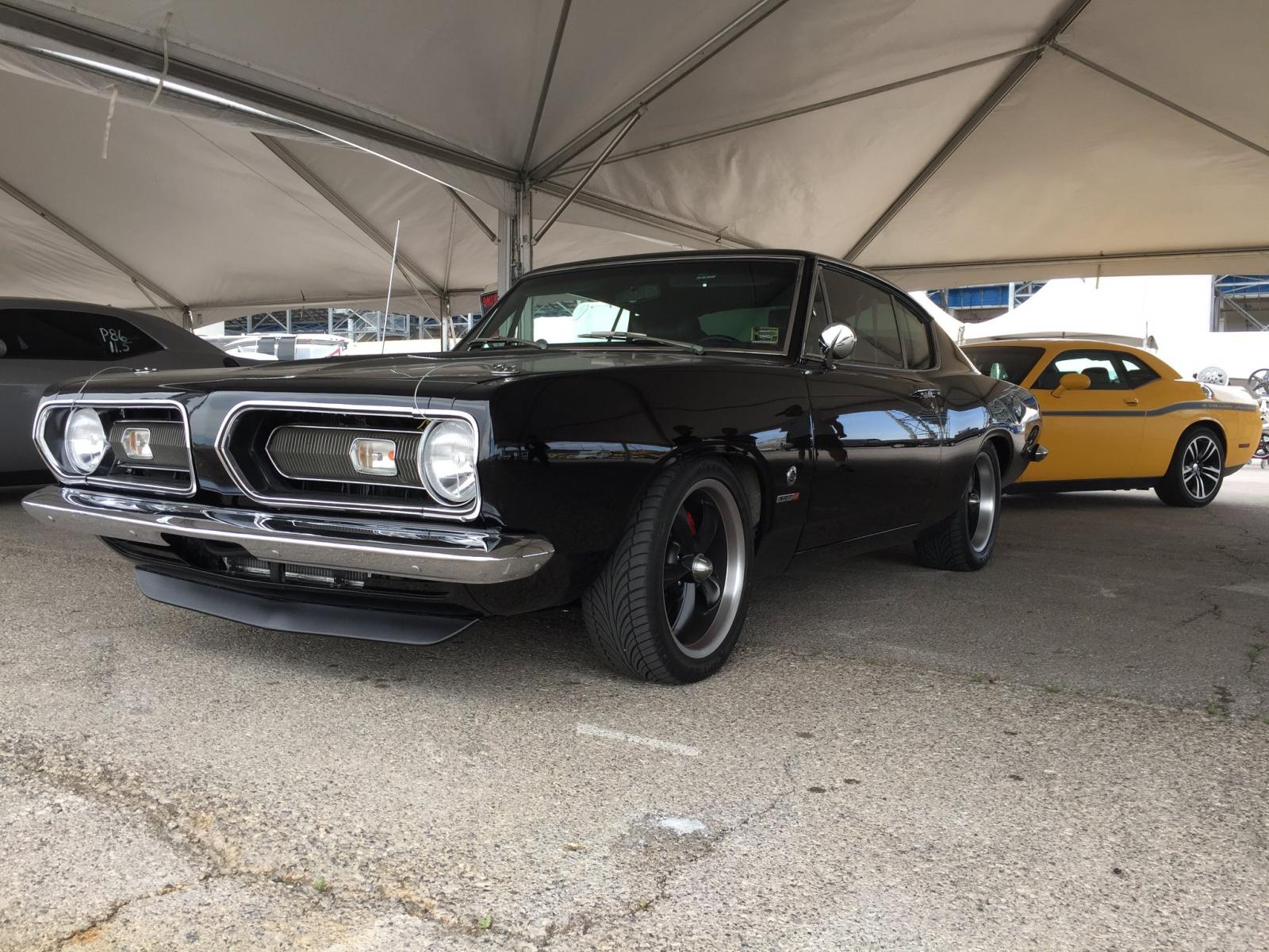

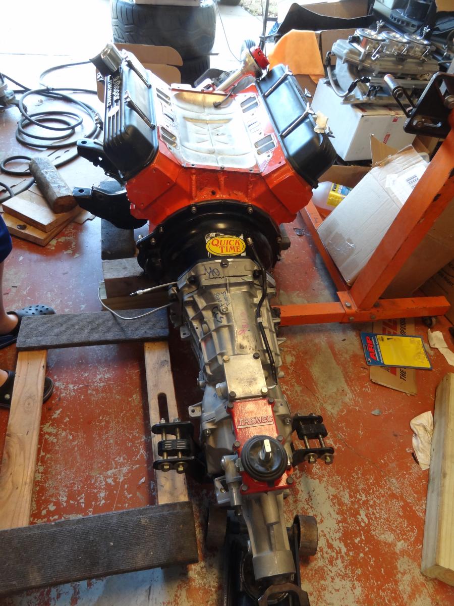

      … and in the under construction category. My old beater:
