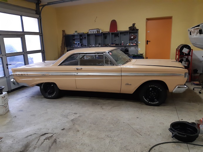

      On another notes, the suspension is finally all assembled and the car is on its feet. The rear is where I want it but the nosebleed stance has to go although I think I need to drive it for a 1000 miles or so to allow everything to settle. If it does not improve I'll cut the springs a bit and see how it affects the ride/roadholding/handling. I still have the old stock springs so I could use those also and get them properly treated by a local firm that does that to increase the spring rate. But that won't happen yet as there are other things which need doing like insulating the firewall, putting back the heater, laying the carpet, dismantling the oil sump and cleaning inside (sludge) etc. etc.
      Steering feels a lot tighter (well it's new) with the new ratio and Pitman arm. The idler arm should also arrive soon and then I think it'll be as tight as it'll ever be which for a non-racecar is enough.

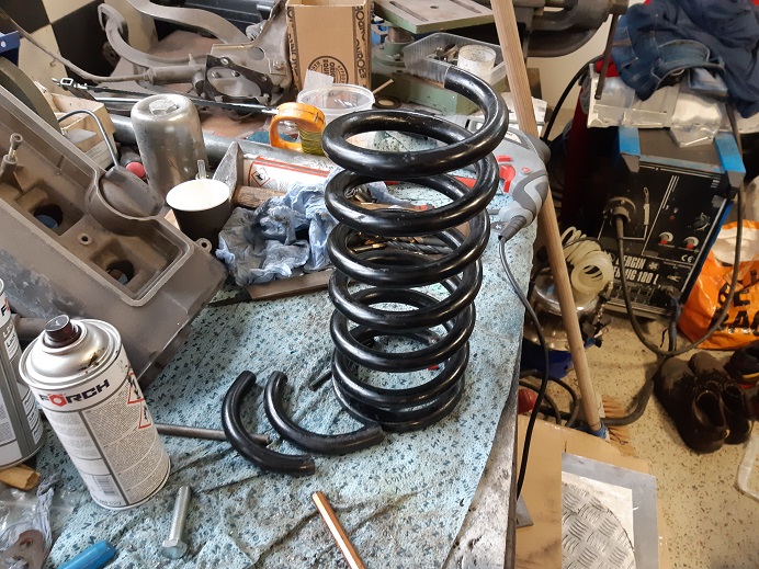

      Another update... After the problems mentioned in the last post I managed to cover about 1200 Km to allow the springs to settle and see how the engine behaved. Well after the sludge was disposed off, the sump bashed into shape and two oil changes things improved a lot with over 40 psi at 1200 RPM and over and the engine runs cooler (never more than 200°f on a hot summer's day). Cannot get rid of a leak around the rear crankshaft seal but that is probably because the seal was not fitted well enough. It's not major but annoying. But the big news is that I got the coils shortened by about half a coil which resulted in the car dropping its nose to where I wanted it. Fitted the Opentracker camber kit and after the usual fuffing about with gauges and shims now have -1.2 camber, +2 caster and about 1/8 toe-in which I believe are correct for a Shelby drop. The weather was nice yesterday so I used the chance to do a test drive of about 60-70 miles around our country roads. First impressions are:

      On the minus side the steering is still loose on the straights which I put down to my dying idler arm (am trying to get a new one which is not easy on a 64 car) and possibly ball joints which, having been awoken from many years slumber in Oregon could not handle Austria air. Also the (new) steering box could use some adjustment. Yes I realize the standard Falcon/Comet steering system will never be as precise as a rack but those are $1600 PLUS shipping PLUS import duties so I'd rather try optimising the standard set up before spending more money. Last but not least car tends to wander to the left which could be a slightly grabby drum brake (which will at some point will be replaced by a Wilwood disc so).
