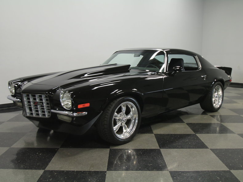

      How it looked when I first got it. The paint is nice from a afar, but far from good.

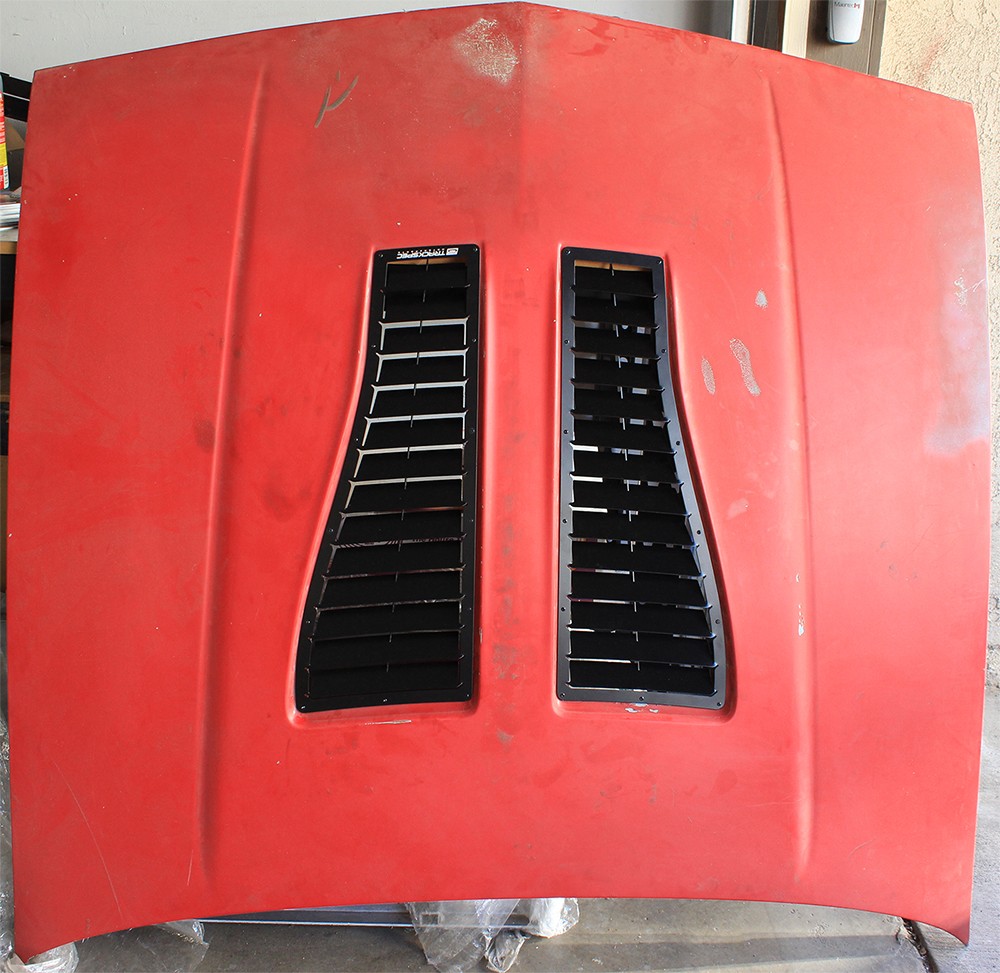

      Was waiting for answer on hood, but I had a feeling it didn't exist premade.
      Making a good fitting quality hood with an understructure is quite an initial process. Another option is if you can find a decent quality stock fiberglass hood from someone like vfn or even harwood & raise the center up & add structure to hold some aftermarket functional venting IROC hood vents, which I'm pretty sure are still out there. VFN lists stock flat bolt on hood for $475. Weight 24 lbs http://www.vfnfiberglass.com/7081camaro.htm
      If venting the top of the hood, then the back of the cowl area should be closed off from having windshield air forced back in, causing turbulence, which is something I need to correct on my own custom hood later.
      Do like the rendering. On small details may want to junk the factory door handles for something like the rectangular Kindig Flush models.
      From casual glance, it looks like you got a good starting point, hopefully no surprises that won't be scrapped anyways.Name:  iroc_top_hood_1.jpg

      Those are the vents that I want incorporated into the hood. I'm going to try to get Trackspec Motorsports on board and see if they want to be apart of the build. It should be pretty neat.
      The final version of the hood will get rid of the peak that's often found on these cowl hoods. This will allow the top area of the fenders and hood to flow a little better in my opinion.

      I dig the Carbon Customs hood too. I just prefer a slightly higher rise and with the vents incorporated into the hood. It should look like it's part of the hood like that red 3rd gen hood and not like an afterthought. However, the CC hood was the backup plan if this idea doesn't work out.
