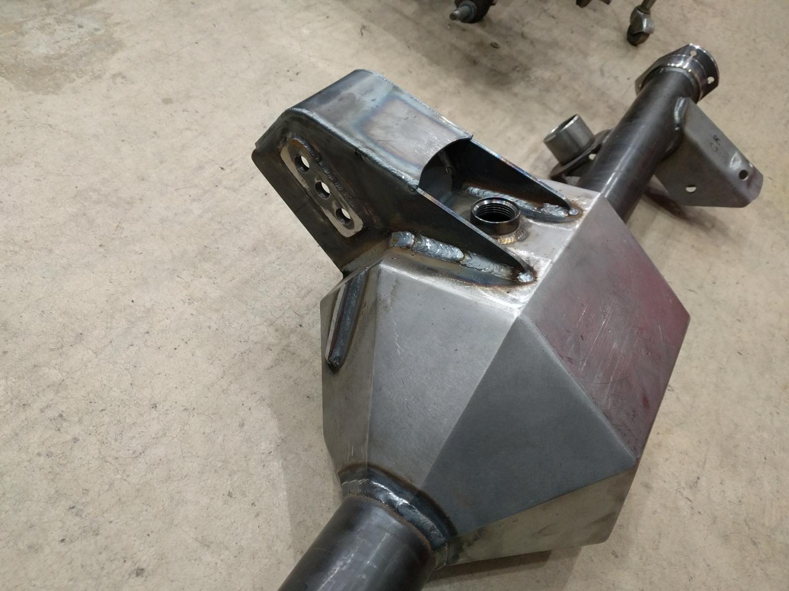

      I originally planned to hang mine behind the axle, like you're talking about, but then as the project kept growing, I abandoned the idea to concentrate on adjust ability since I will use it for AutoX and roadcourse(Blackhawk Farms, Gingerman..etc). The stock triangulated 4 link had very short SVA uppers, and I didn't really have an issue with the amount of pinion change on launch, so I charted for same or better.
      I would say, that even if you don't get the adjustable holes in the exact perfect spot, having extra adjustment will help. My first trip to blackhawk had wicked wheel hop when I was hard into the brakes, I think this is a combination of 100% AS and still too much rear bias. I plan to drop it down a notch to 70% and try again. I have three holes on the axle side and 2 frame side, to give me a range of 40-160% in 30% increments.

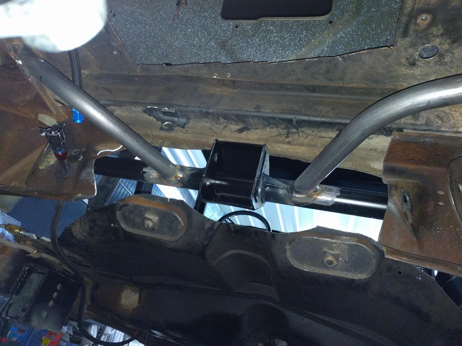

      Offset 3link! dude that's awesome. you seem to be offset nearly the same as the example pics online. Height might be a little low, but I'll resist the urge to armchair QB your build since there's only one pic, lol. I'v always thought the FFR's were so awesome, good luck man, hope you get it on the road soon!
      Oh, and I love the LQ9.I've got it paired with a 228R cam and it was super easy to tune. On track it just sings and it's been dead reliable for several years now. Each year though I consider the LS3 head/intake swap, but never pull the trigger.
