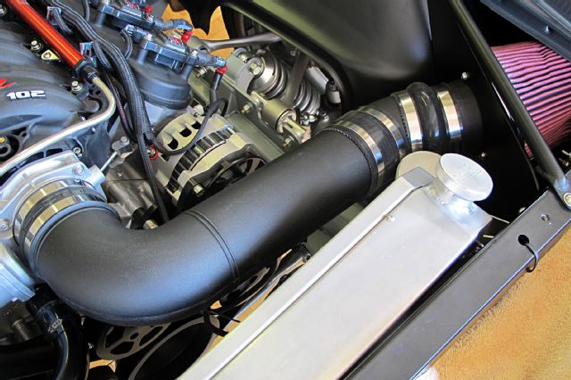

      Have you looked at the Spectre and Airaid kits? They don't go through the support, but they tuck up into the corner and come with a heat shield. The Spectre kit uses a polished aluminum tube.

      Have you looked through the Muscle Cars from the 1960`s and 70.s for ideas
      431
      Quote Originally Posted by AU Doc View Post
      does this actually work? I found that I couldn't really get good results until I got the filter completely out of the engine compartment.

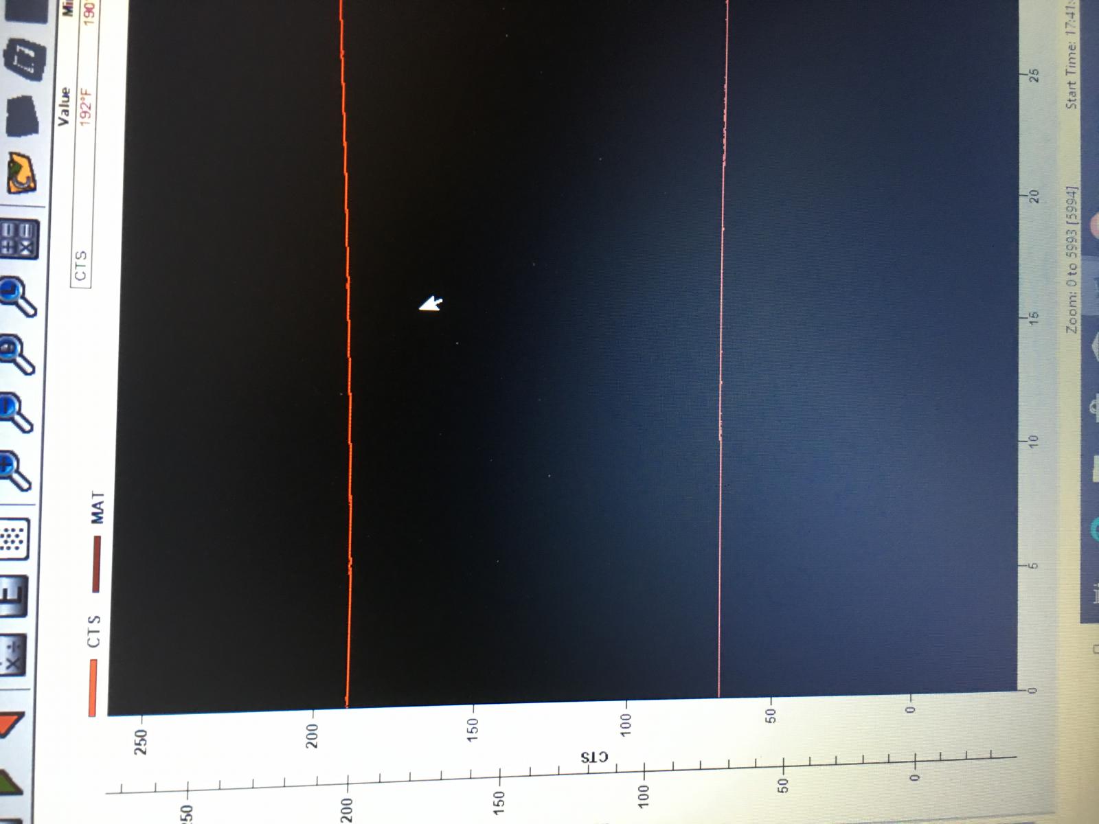

      Quote Originally Posted by ULTM8Z View Post
      I haven't really paid attention to intake temps, but here's a screenshot of a datalog with the car up to temp, and the intake temp is pretty well at ambient. I believe I took this is a datalog from a rolling start to WOT through 2nd and 3rd gear. (sorry the image is rotated)

      16,129
      Quote Originally Posted by arriusone View Post
      Works good on mine !! If it’s tuned with the current temp it should run fine.
      Tuning actually involves putting in compensation values for changes in air temperature.
      yeah I had to do a lot of reworking of my MAT tables.
