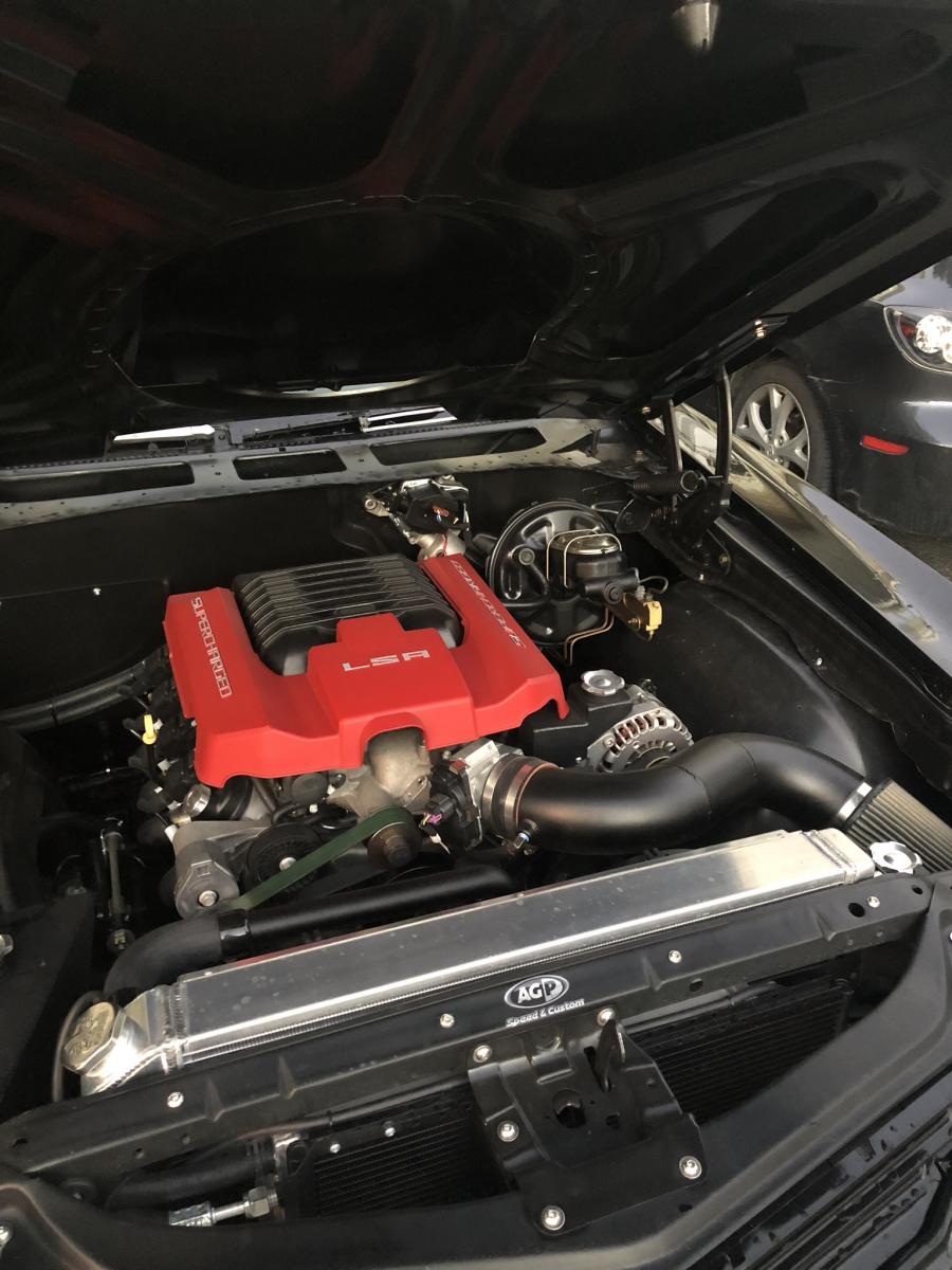

      Power brakes? If yes, where did you connect the vacuum line? Is the check valve working? What size is the booster? Post up a pic.

      Check your booster check valve....

      If that is fine, tell us what your idle vacuum is, ensure the check valve is working on the booster, also make sure the booster rod is attached at the lowest hole on your brake pedal arm. It sounds to me like a force issue, so if you don't have enough vacuum, you'r not multiplying your leg force enough. If the check valve is dysfunctional, same thing. If the pedal is in the "Manual" brake hole(top) instead of the bottom, less force again.
