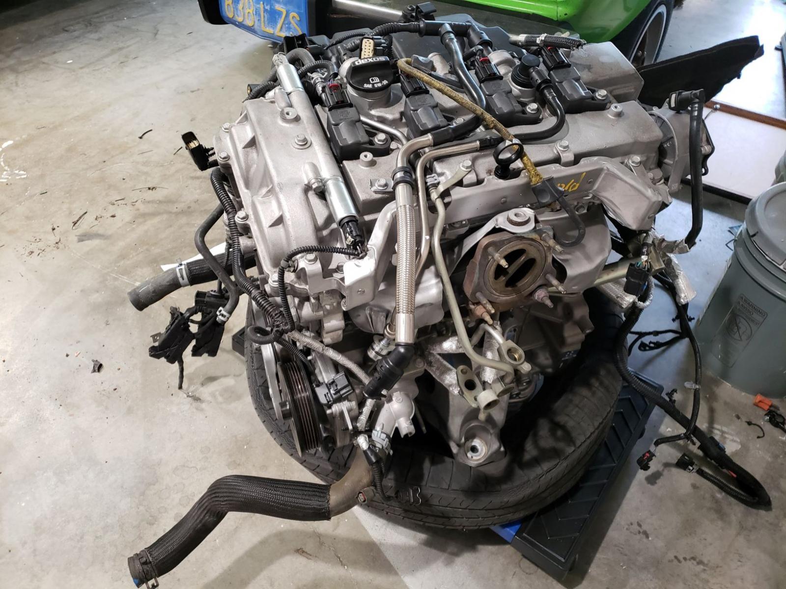

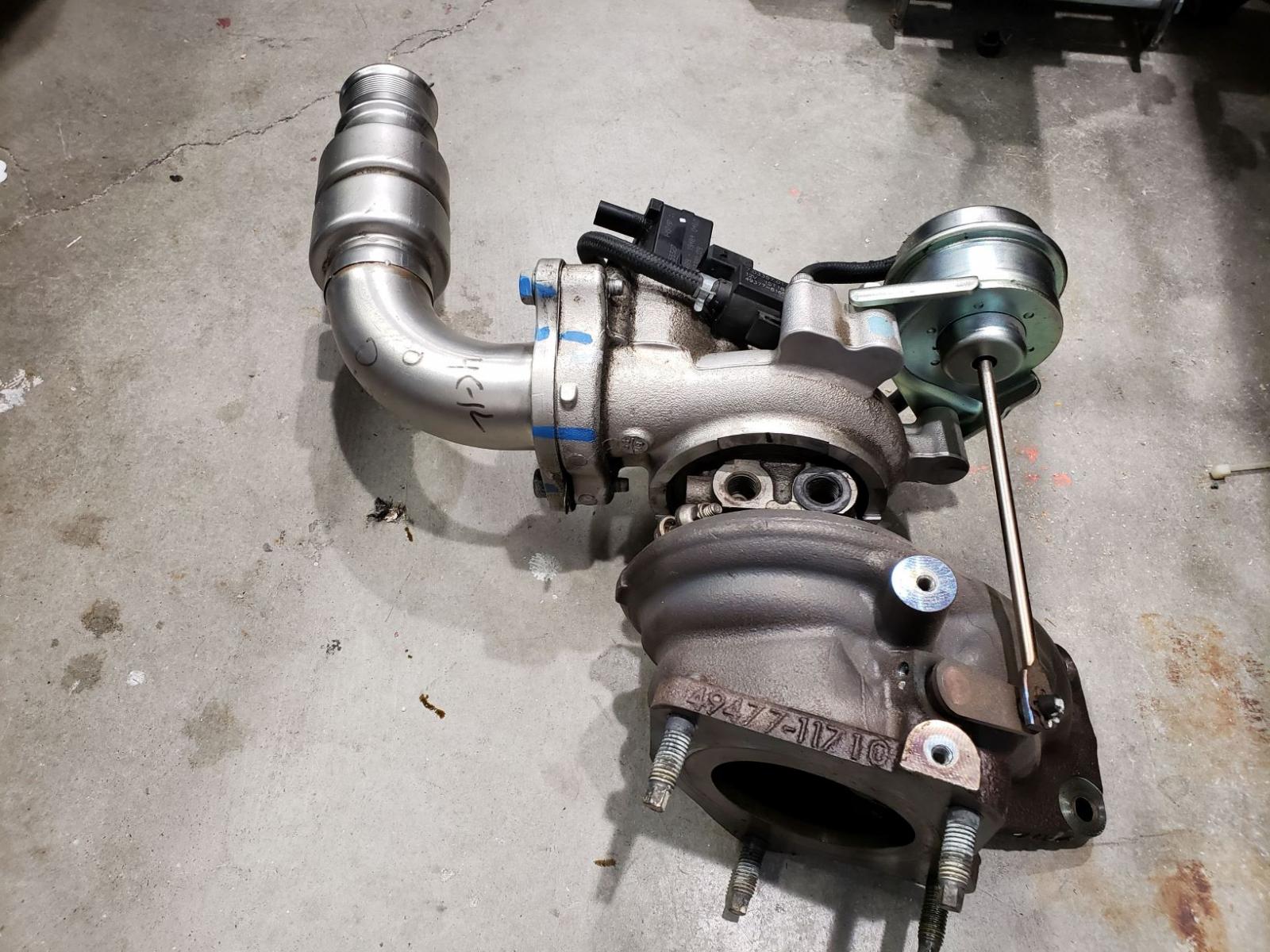

      Ecotec ltg and 5-speed trans
      After looking for the right engine for the last few months, I was able to locate a nice one locally. It is an Ecotec LTG 2.0 Turbo. This is the latest version of the 2.0 turbo. The engine I bought is from a 2016 Camaro. It has 14,000 miles. The transmission I bought last month is an Aisin AR-5 5-speed manual. It is a brand new unit. This is the same trans installed in many cars including the 2007-2009 Pontiac Solstice and Saturn Sky which bolts up to the Ecotec.

      Good stuff. I would love to do a build with one of these engines!
      Mission Viejo, CA
      631
      Yeah Andrew, I've been really wanting a small 4 cylinder car that I could build for a long, long time. Because I live in California, it had to be pre-1976 so I wouldn't have to smog it. After finishing the GA, I realized that the car is everything I wanted it to be with the exception of two things, 1: It's big 2: It's too nice to mess up. I really wanted to autocross and track the GA.....which I will, but not as often as I thought. So that is where the Manta comes in. I'm leaving the patina, and perfecting the drivetrain. Rock chip, no big deal. I like the JDM stuff, but everyone thinks that stuff is worth a fortune. The Opel is super rare. I already have a rare car in the GA which I like. The Opel is probably more obscure. I really like stuff that nobody has.
