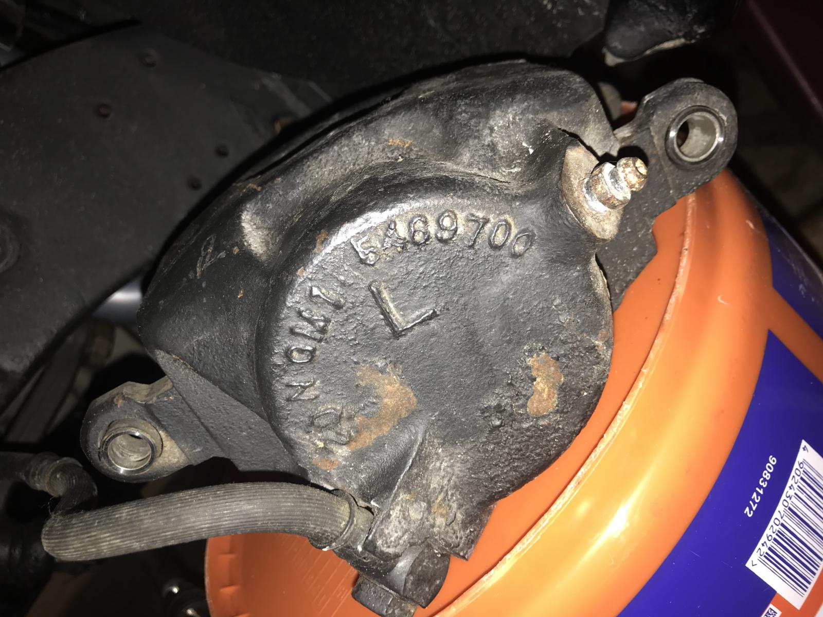

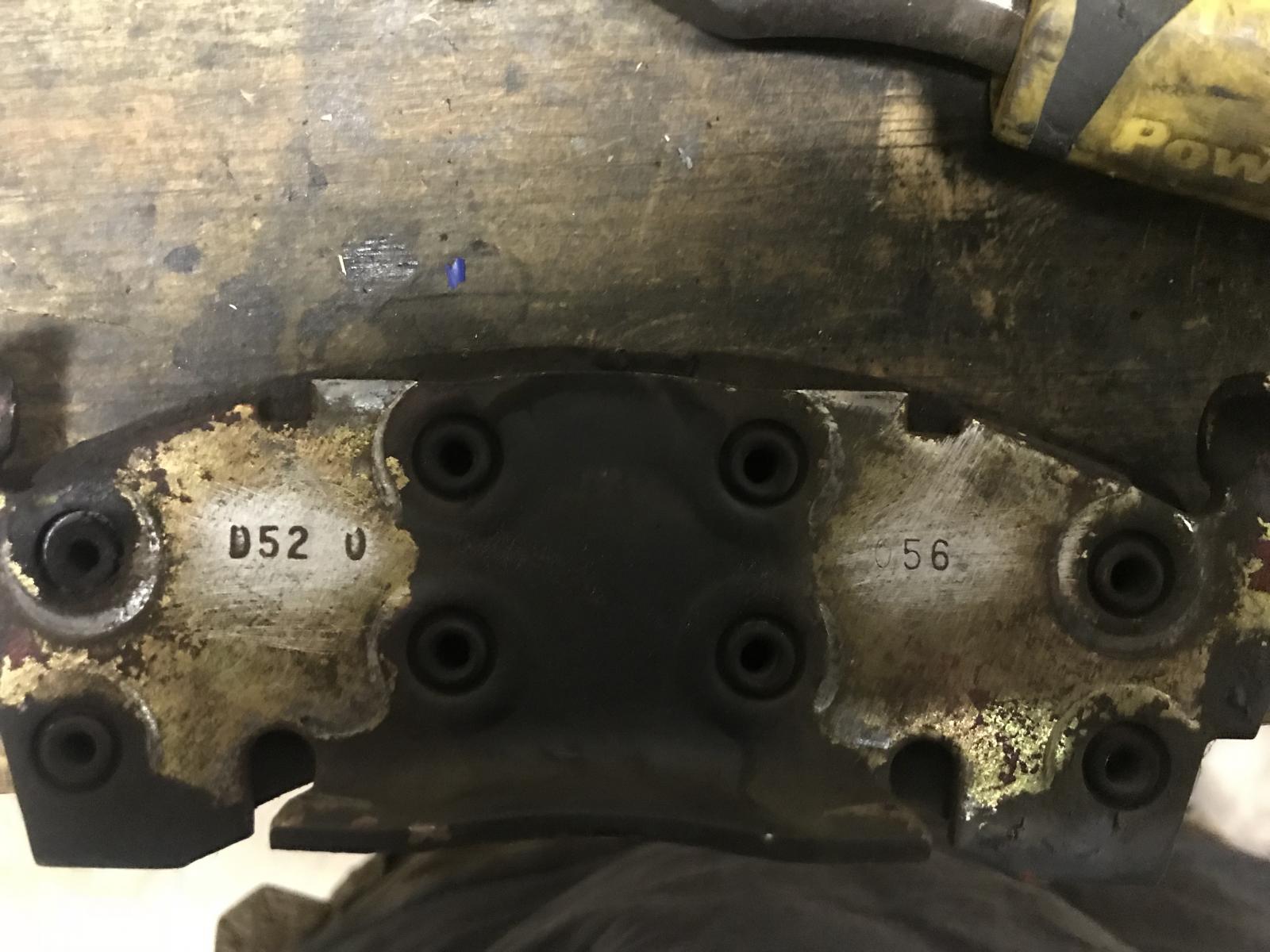

      I finally got a frt wheel off. Here is what i know.
      1” willwood manual master.
      Brake caliper is stamped 5489700 with a single 2.83 OD piston.
      Rotor is 11” stamped 615100. Century. Not sure if that is the rotor brand, or possibly buick century.
      Pads are stamped D52
      The hardlines from the MC to the calipers is .185 OD.
      I couldnt find a stamp on the dust cover or spindle.
      Does any of this mean anything to anyone?

      Those are the original disc brakes. They were never offered as manual as far as I know. 1” master is likely too large.
