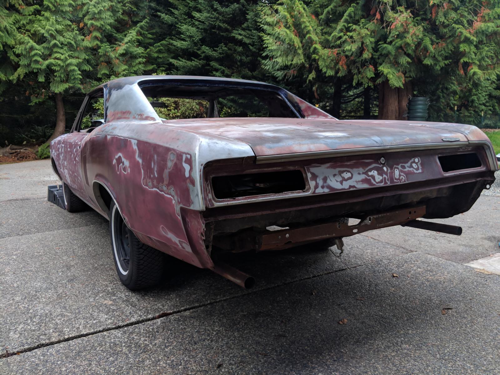

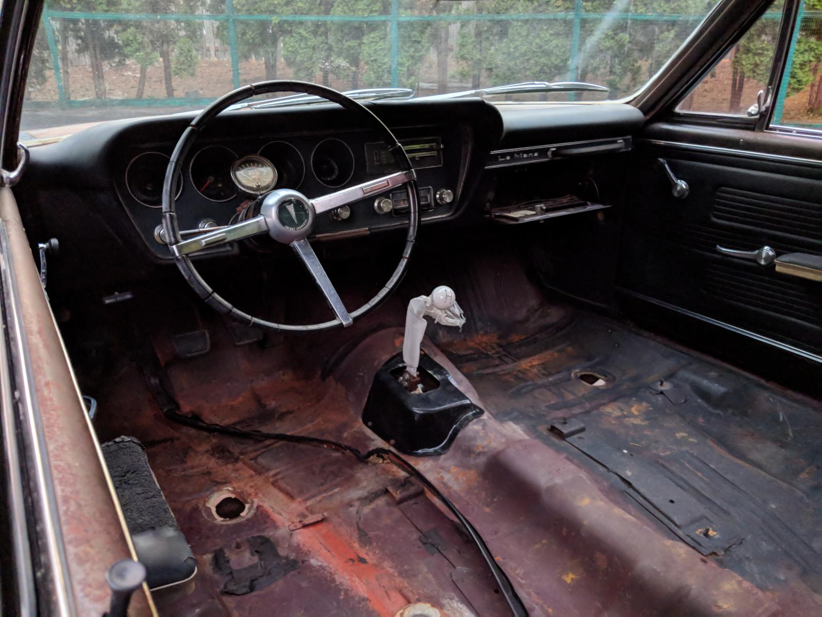

      I've lurked for awhile, drooling over high buck and low buck builds all while gathering ideas for my own project. I'm sharing this to help document the process for myself while also hoping others chime in with suggestions, criticisms, and words of encouragement.
      My goal is to end up with a driver. I do track days with my other car, so I really want this thing to end up more then comfortable on the track and autocross course. I have had this car for far too long. It's time to just jump in and get something done. This is going to be a drawn out budget build.
      The car is a 1967 Pontiac LeMans hardtop. It's a 326 with 3 on the floor, red over black. I inherited the car from a family member who bought it back in 71, so I am the 3rd owner.
      My goals are to clean up the body, throw much more running gear under it, run the stock 326/3spd for awhile, then put in a LS and 6 speed when funds allow. I'm currently looking at UMI's setup but am still doing research.
      The car has had a cheap paint job done. The original was trashed from the Mount St. Helen's eruption. Luckily there is little body filler, and short of a couple patch panels and the trunk pan, the body is in relatively good shape. I'm in the process of stripping it down so I can shoot the car in SPI expoxy primer. I've ordered a new trunk pan kit and GTO hood from AMD.

      Looks like a very solid start!

      THats got some awesome patina to it.

      Clean ride, looking forward to the build!

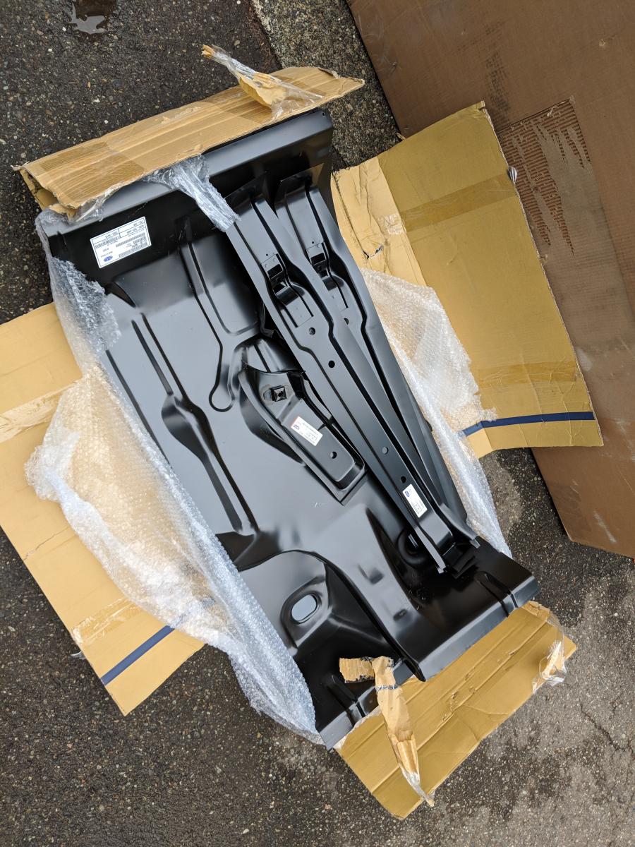

      I received my new trunk pan, so I'll document that when it goes in.
      For now, my gto hood showed up! I think this really sets off the front end. I'm excited to get this thing all one color.

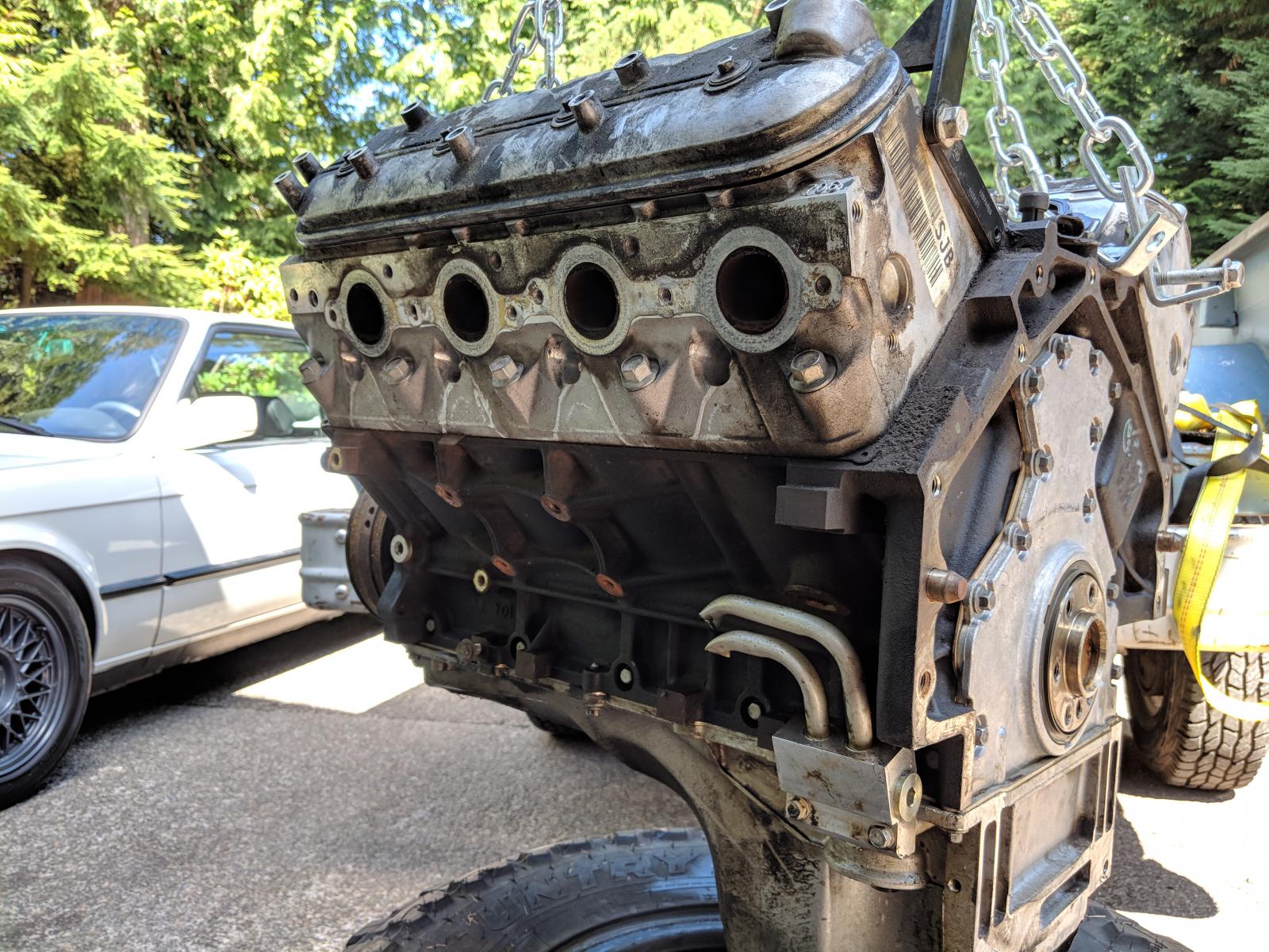

      I bought a thing that I was not expecting to do for awhile.

      Looks like an iron block gen 3 engine...what displacement?
      Houston, TX
      1,197
      Looks like either 4.8 or 5.3.

      It's the 295hp version of the 5.3 LM7 with 706 heads. It's a runner and I got it for less than $100. I'll clean it up and give it a good look over. But I figured for the price why not take a gamble.

      HAHA cant beat that price! 243 Heads and cam you will make over 400hp how it sits. Im a huge fan of these LeMans, I remember seeing one racing on youtube a while back and my jaw hit the floor. They just look so good lowered and in track form. Cant wait to see it come along.

      Still getting the body stripped down. Pull the front and rear windshields, rear bumper, taillights, door cards, and am working on the dash. I still need to figure out how to pull the side windows.

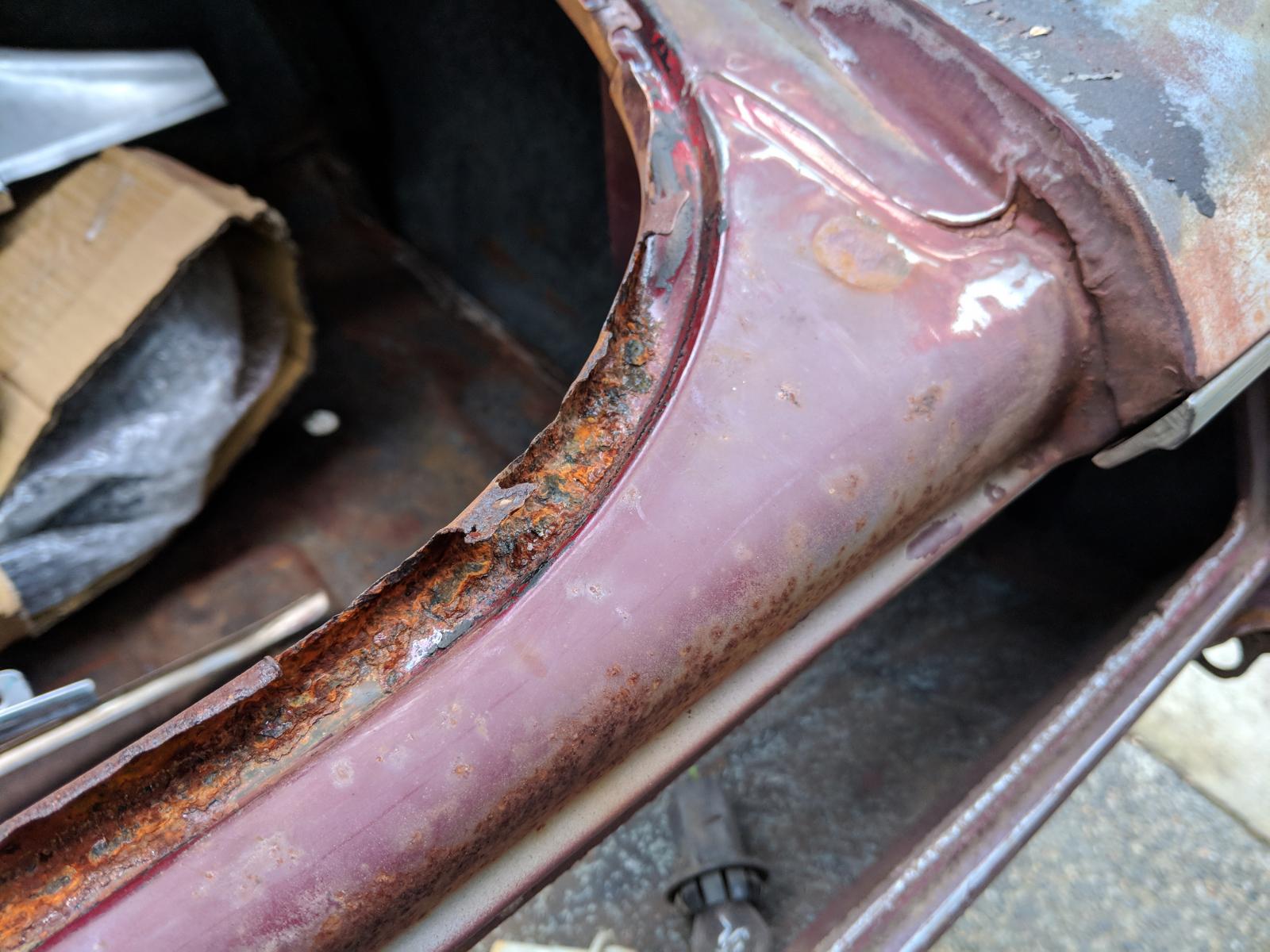

      I need to replace the trunk seal channel. Does anyone have any recommendations on where to get this?

      I just redid a 66 gto for a friend. I had to hand fab the channel all the way around on his, I was never able to source any replacements...

      I had same issue on my 66 tempest and ended up replacing the tail panel to fix since there was other damage to it and just easier to replace complete panel.

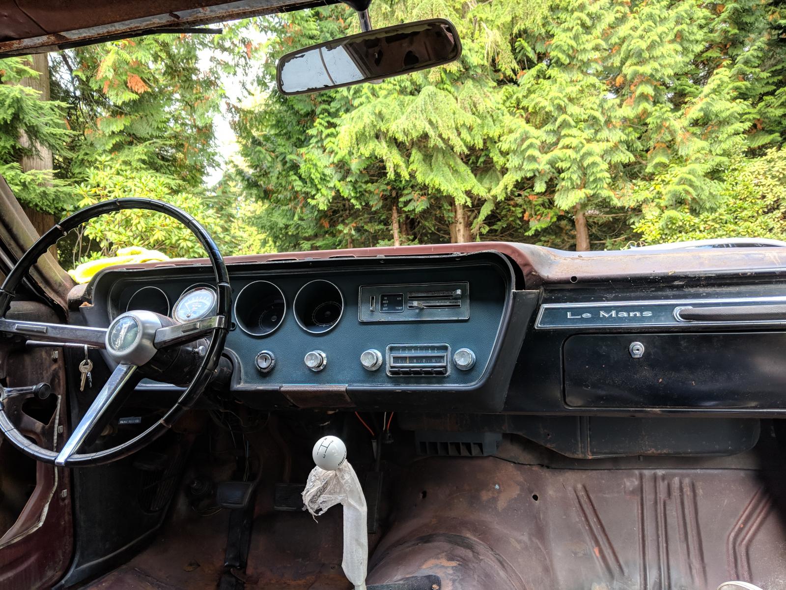

      Getting closer. I need to figure out how to remove the instrument panel while also being extra gentle. 50 year old plastic isn't the friendliest thing to work with. I do like the look of the stock gauges. I'd like to find a tach in the same style to throw in there.
      Also removed the cowl to inspect underneith and remove the wiper linkage. Aside from a ton of crud, everything seems to be in pretty good shape
