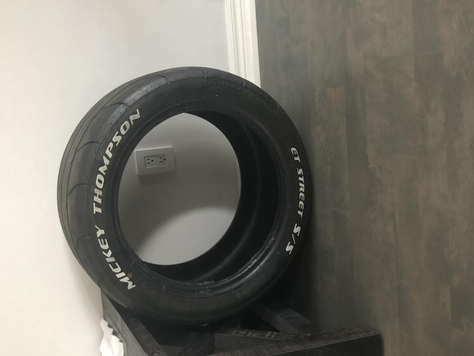

      1971 chevelle LSA 700hp -
      16,129
      Quote Originally Posted by 1sikride View Post
      I was about to recommend those. I got 3 years out of my last set. That includes three trips to LSFest with drag racing, although they showed chords at the last LSfest. They were toast. If you are careful, you should easily get 10K miles out of them. Tire wear is directly proportional to your right foot!

      I know it's a bit of an old thread, but I'm new here. I've got 285/40 on 18x10s on my Mach 1 (dyno'd at 673 HP and 748 ft.-lbs.) and I can tell you that anything less than drag radials is going to be fun for sure, but futile....My regular Nitto 555s light up at anything under 60 mph with my 3.90 gears. The Mickey T's are the best set of drag radials out there, they've been much better than the old BFGs and Nitto 555Rs I've ran before.

      My CTSV is 713 whp and I am currently running PSS' ,and have run Sport Cup 2 also. Traction is futile. Period. You can get a 305 on a 9.5 inch rim, just get some DR's. Mickey T. is your friend. I am running a R888 345/18 on the Chevelle with a set of Mickey T's on a spare set of rims for when it counts.
