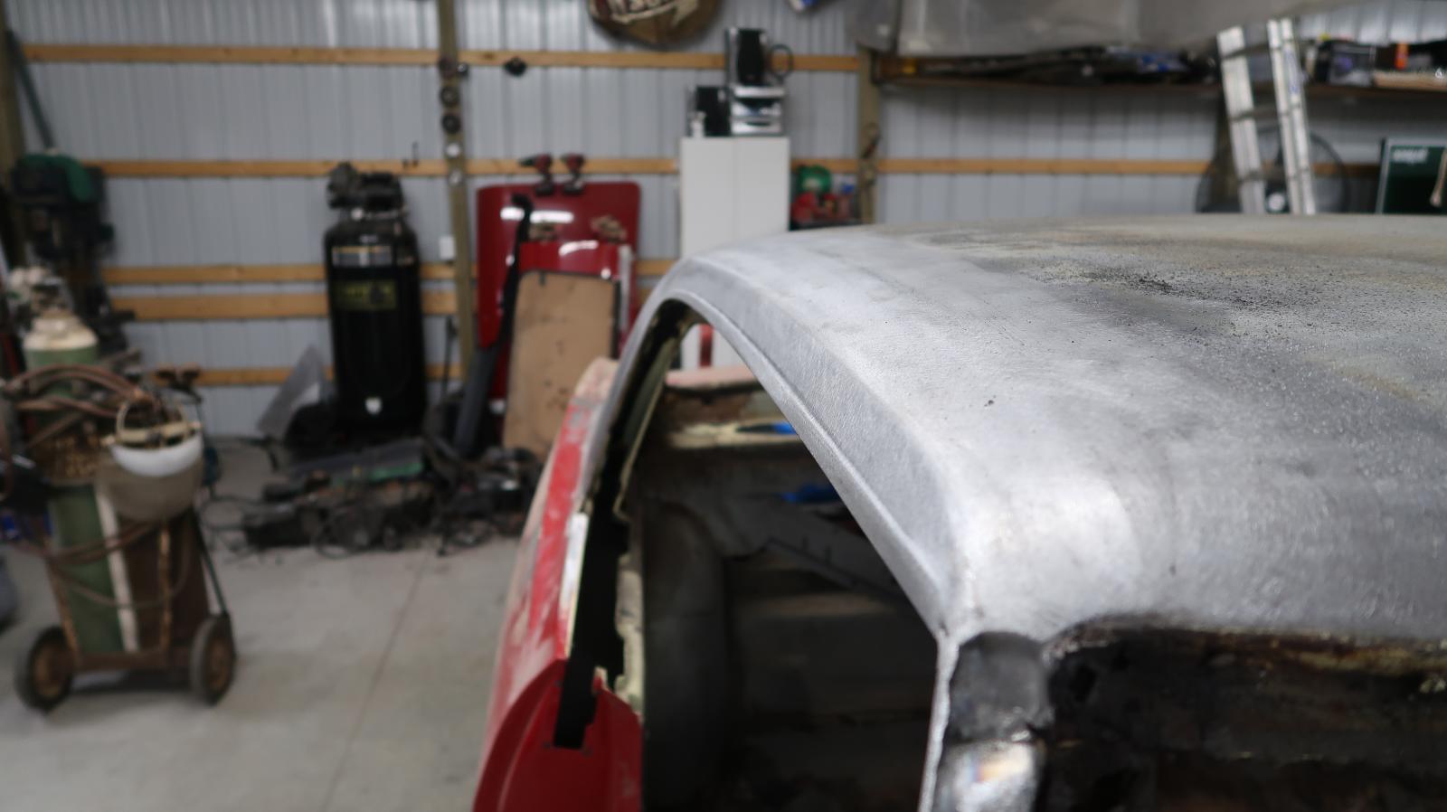

      This is my first weekend of working on the car. I removed the ugly drip rails because I plan on running no trim on the car.
      Name:  Driprail Before.jpg
      I was going to add a 1/4" rod across to keep a distinct line above the doors, but after cutting off the drip rail, it left a very nice body line about a half inch above the roof line.
      Here it is all finished up in a nice days work.
      Name:  Driprail DS after.jpg
Size:  153.2 KBName:  Driprail PS after.jpg

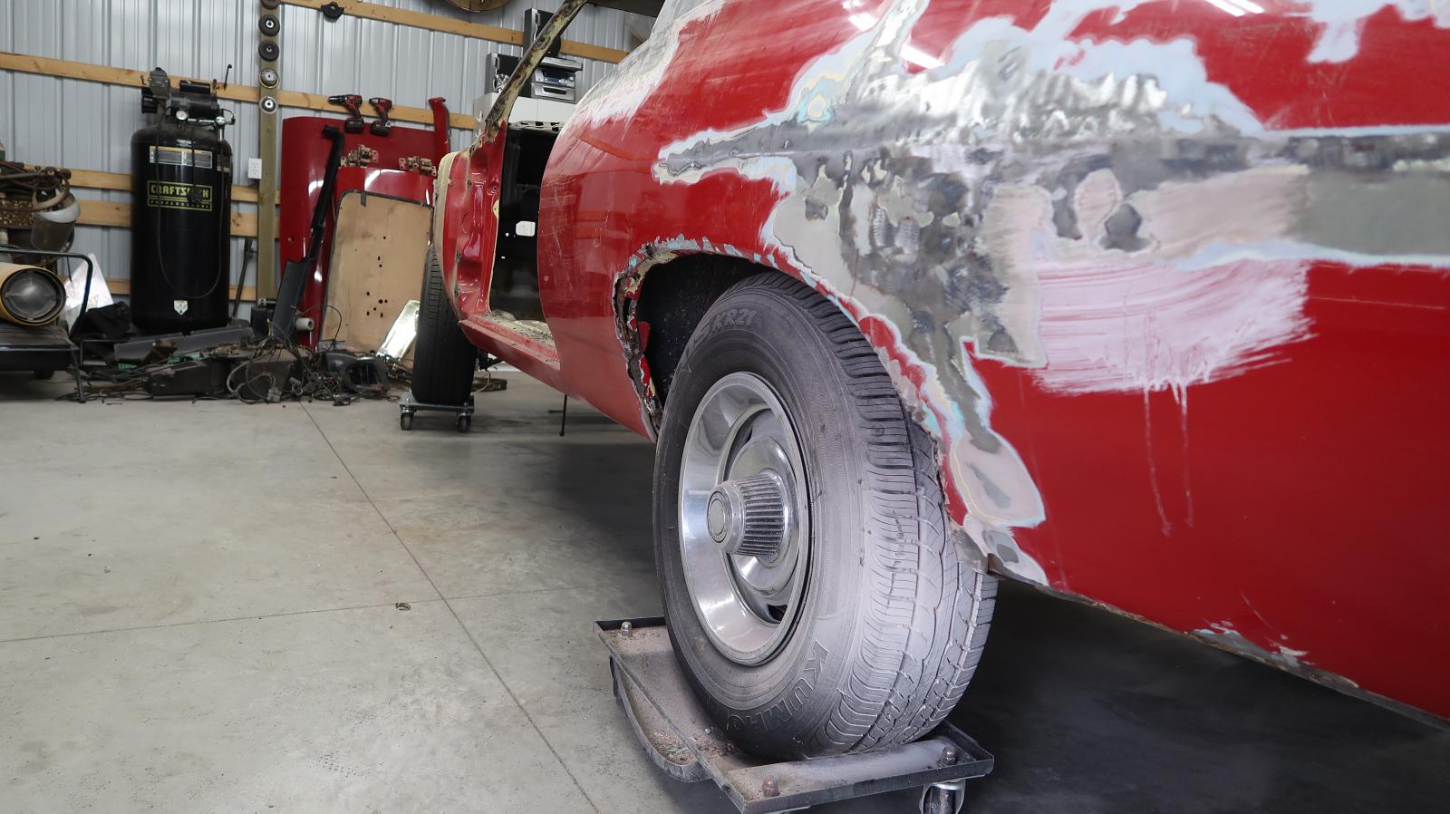

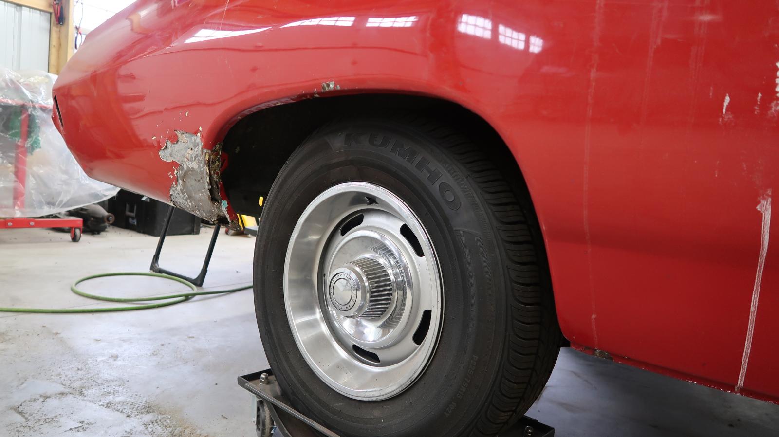

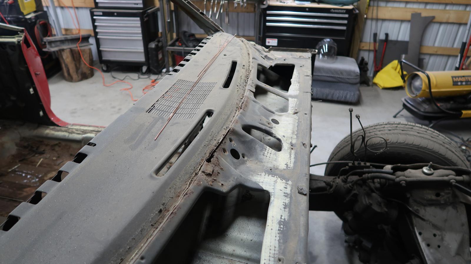

      This morning before heading up to Ferris, I stopped in the barn and took some picture of all the rust for you guys to see so you can get an idea of what needs to happen.
      Here are both quarter panels. I just removed paint in random spots to see how much body filler has been used. Some spots are easily pushing 3/8". Using my tinners hammer, I smacked the fender around the wheel well and found that there was literally no metal behind it... It was all bondo.
      Name:  DS Quarter rust.jpg

      Around the front windshield on both A pillars is rust as well as the top of the cowl.
      Name:  A Pillar rust.jpg
Size:  143.2 KBName:  Cowl Rust.jpg

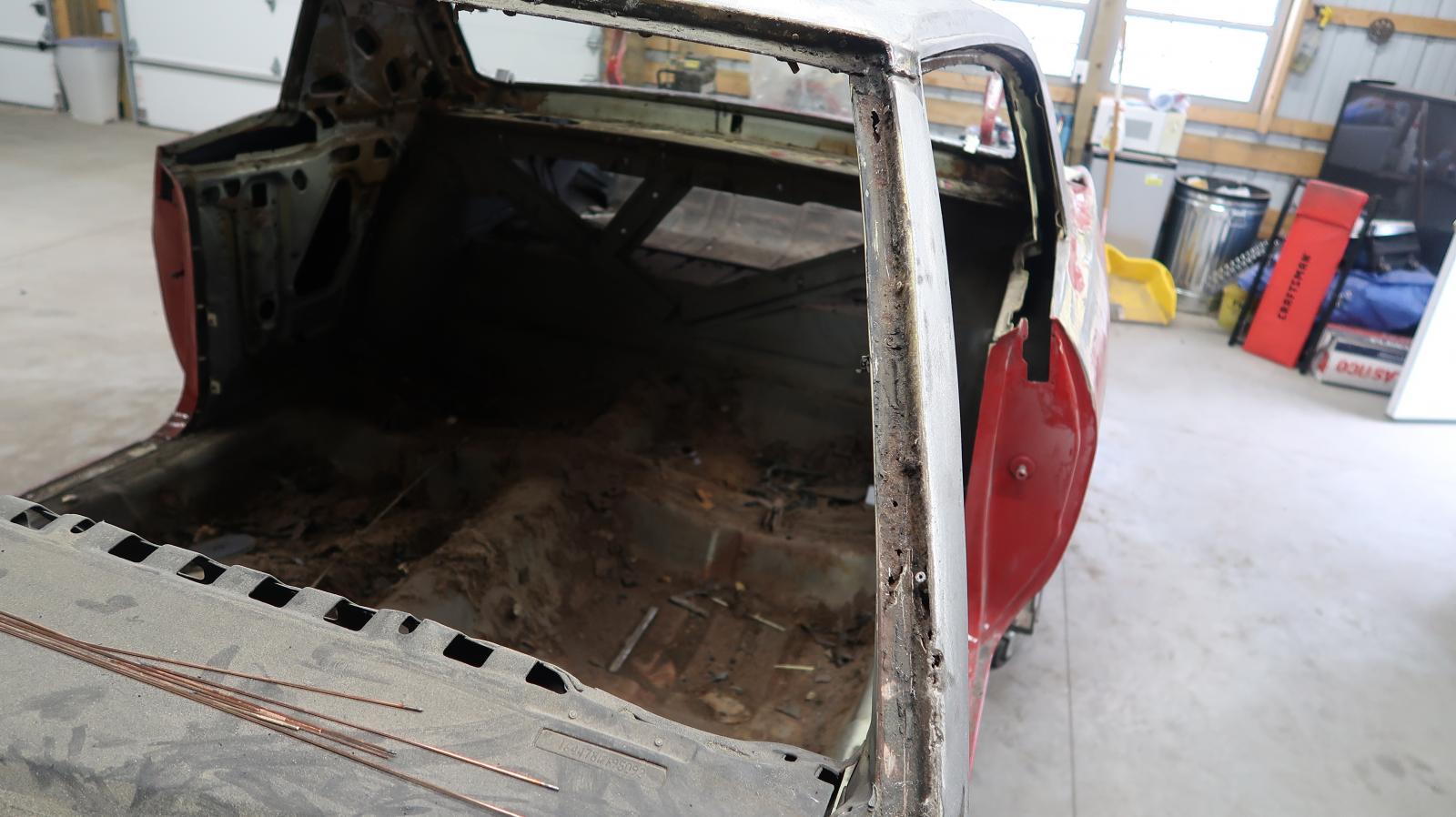

      The at the bottom of the rear back glass is very bad. Good thing I am flush mounting it so all that metal will be replaced.
      Name:  PS rear window rust.jpg
Size:  149.0 KBName:  DS rear window rust.jpg
      Around the back is where the decklid seals. I was messing with a hammer hitting areas I thought needed work done. My hammer went straight through back here. What I found was foil tape used as a backer, and completely filled with bondo.

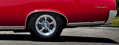

      I have been doing some research on how to flush mount it. It's really hard to find anything because everyone just buys the kits. No one does it the old school way and builds the frame for the original glass to sit in. Luckily I have a cousin pretty high up at Safeflite who is a glass connoisseur who can help me out. What I would like to do is have it completely flush by bringing it up a half inch for the glass to sit on with no trim or anything, just a 3/16" gap between the glass and the metal. The hard thing is, I am not sure what kind of gasket I would need under the window to get it in place or how big the gasket would be or anything. Or if I could go the entire half inch up and just use a special glue and not even run a gasket underneath.
      And for the fenders, This is what 1966 GTO fenders are shaped like. You can see the flare around the wheel well that I am going after.

      Here is what my Impalas rear wheel well is shaped like originally.
      Name:  1968 Impala car quarter cropped.jpg
      Unfortunately I do not have any drawings. I have attempted to make drawings, but man, I am the furthest thing from an artists when it comes to pen and paper. It's horrendous. I vision what I want in my head, and build to that. Seems to always work out pretty good. I would love to have a rendering eventually, but man they can get expensive.

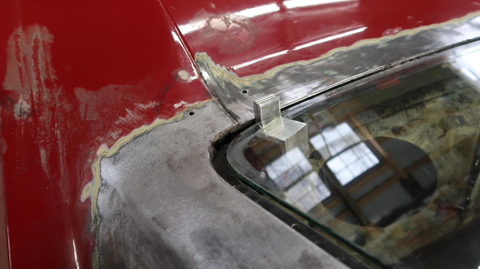

      NOW.. here's where I have to go back to the drawing boards. The dang window (which I thought might happen) bows differently than the window opening in the car. So when I have it flush in the middle, it dives in over a 1/16" on the ends and looks horrible. Being there's only about 16" of window there, there is no where near the flex it needs to be flush everywhere.
      So this throws out my flush window idea. My cousin from Safeflite is coming over Sunday to help me come up with a solution. If we don't come up with anything clever, I guess it's a good thing I never ruined the original trim.

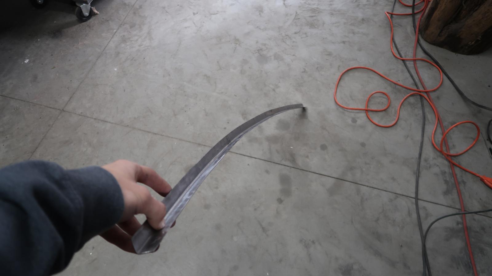

      After this, I needed a shrinker/stretcher so I went to good ole harbor freight and bought el cheapo just because I have used it before and it is plenty good enough for what I need. I then proceeded to remake the angle that goes from the glass to the rear filler piece. I slowly shrunk the one side and stretched the other to give it a nice bow/complex curve until it fell into place nicely.
      Name:  Rear window metal shaping.jpg
Size:  94.0 KB Name:  Rear window test fitting.jpg

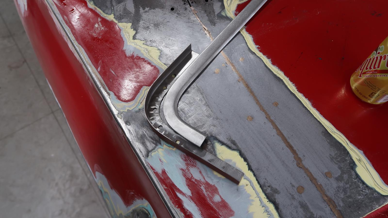

      Since flush mounting was out of the equation, I got the trim back out and built the bottom corners to match them perfectly.
      Name:  Rear window metal shaping 2.jpg

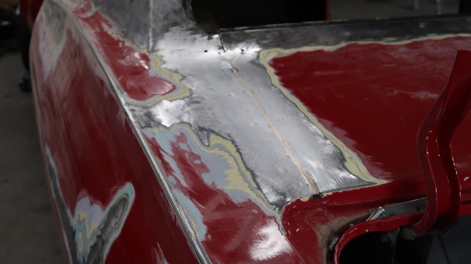

      To start, that spot I welded sil-bronze, I cut out to remake with a patch panel and just tig it in. With a flange in the way, there was no way to get under the weld with a dolly. Cutting it entirely out, made it much easier to work and get most of the warpage out. I did this on both sides.
      Name:  Sil-bronze repair.jpg
Size:  198.6 KBName:  IMG_0123[1].jpg

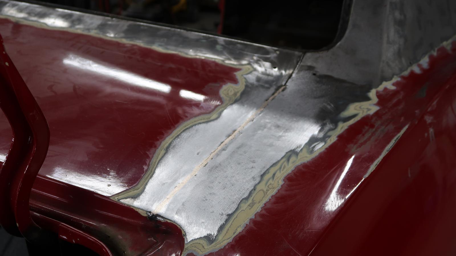

      After this, I moved back to the trunk area where the seal goes. This was a big pain as I had to cut then entire piece out at the bottom, and remade the whole thing. Waiting to go to Alro in the morning to get some more steel to finish this area out. Mostly done as it sits now. Just need to put a 1/2" lip all the way around to hold the seal in place. There was a couple other areas up higher in this area that I fixed along the way.
      Name:  Trunk repair rust.jpg
Size:  205.4 KBName:  trunk lip repair.jpg
Size:  172.1 KBName:  Trunk repair progress.jpg
Size:  257.0 KBName:  Trunk lip repair done2.jpg
Size:  190.2 KBName:  Trunk lip repair done.jpg

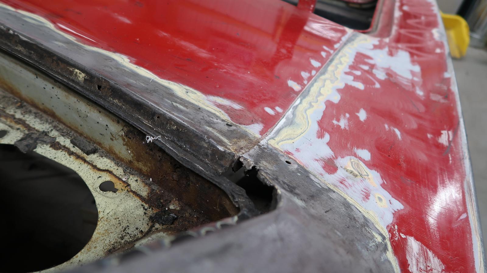

      Tomorrow, I will start working on the A-pillars, and taking care of all that rust. Just working my way from top to bottom.
      This project is will easily be all of 5 years to complete. The more I have read on other builds, and the amount of money people have put into their cars while doing all the work themselves, I need to get me another job Nah I'll be fine.. Just need to make it through these last couple years of college while doing all the dirty metal work before I can start really putting money into the build.
