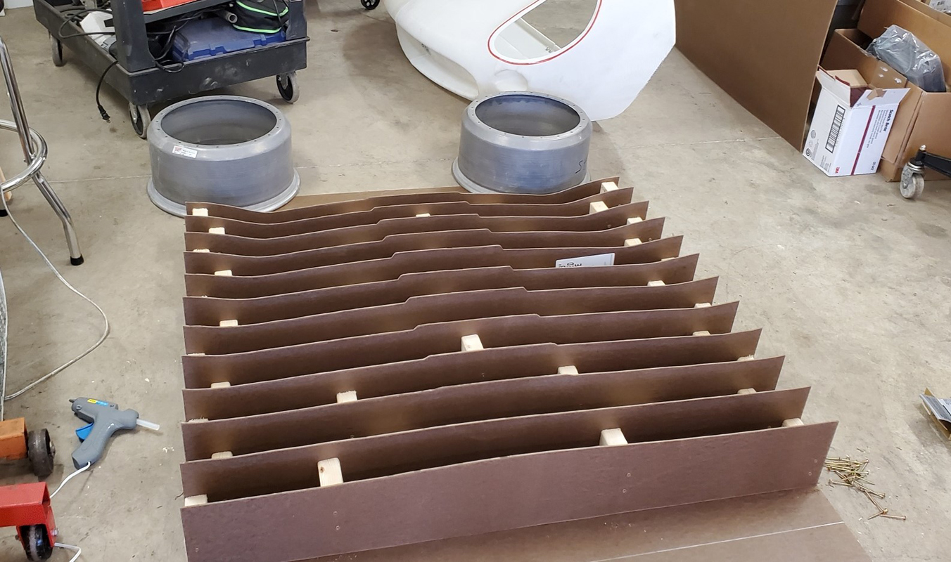

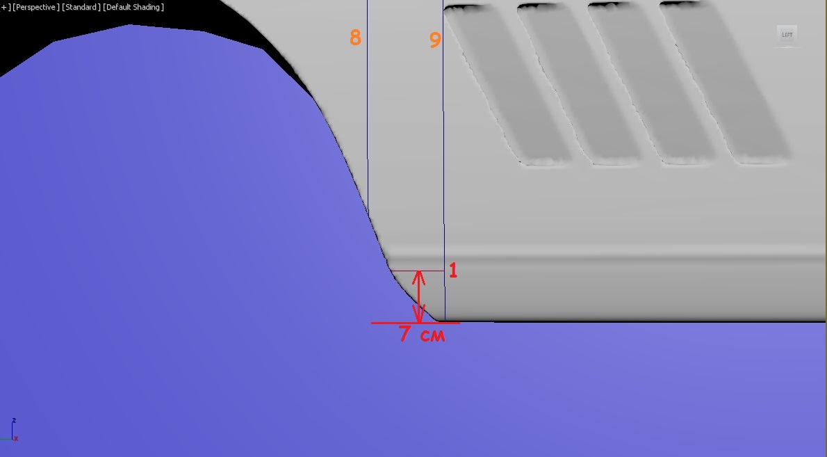

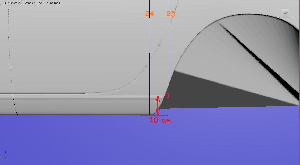

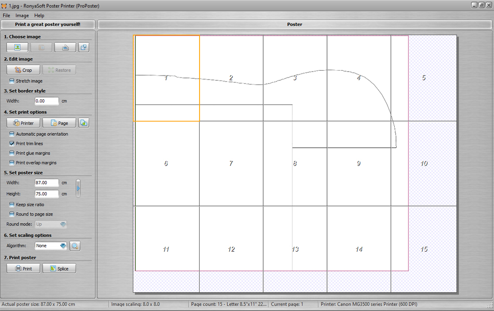

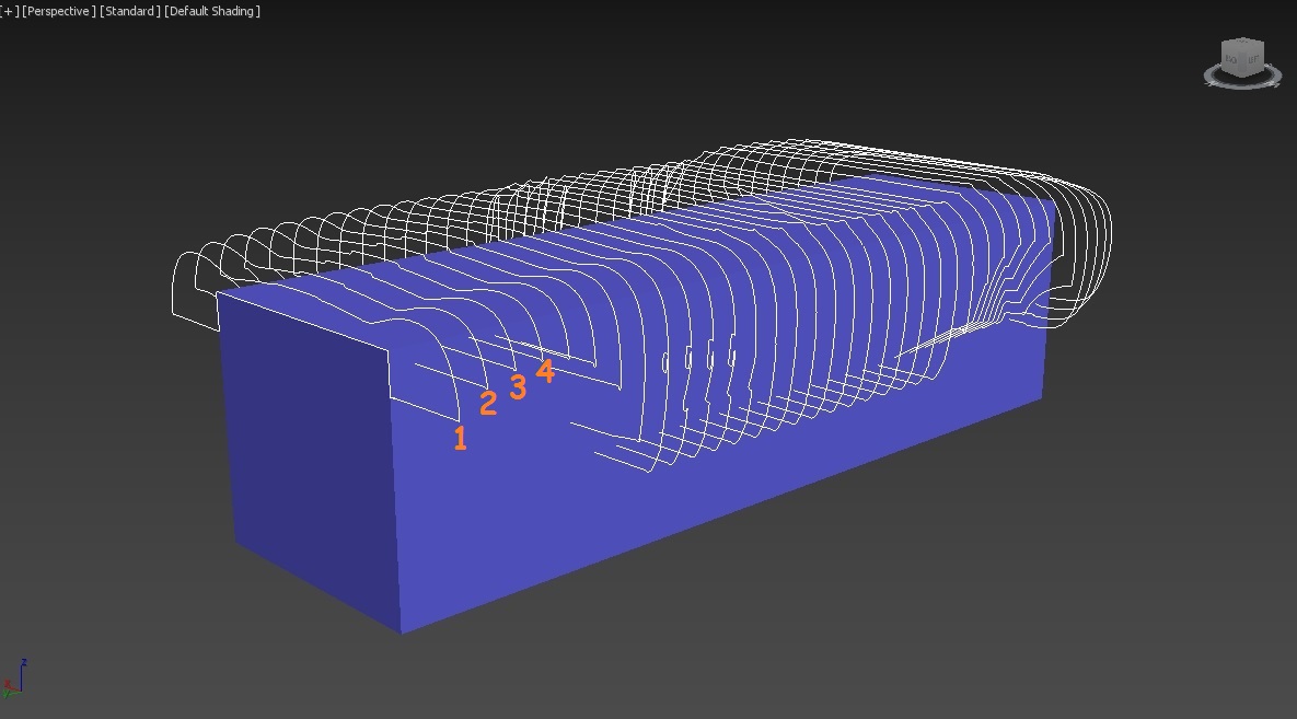

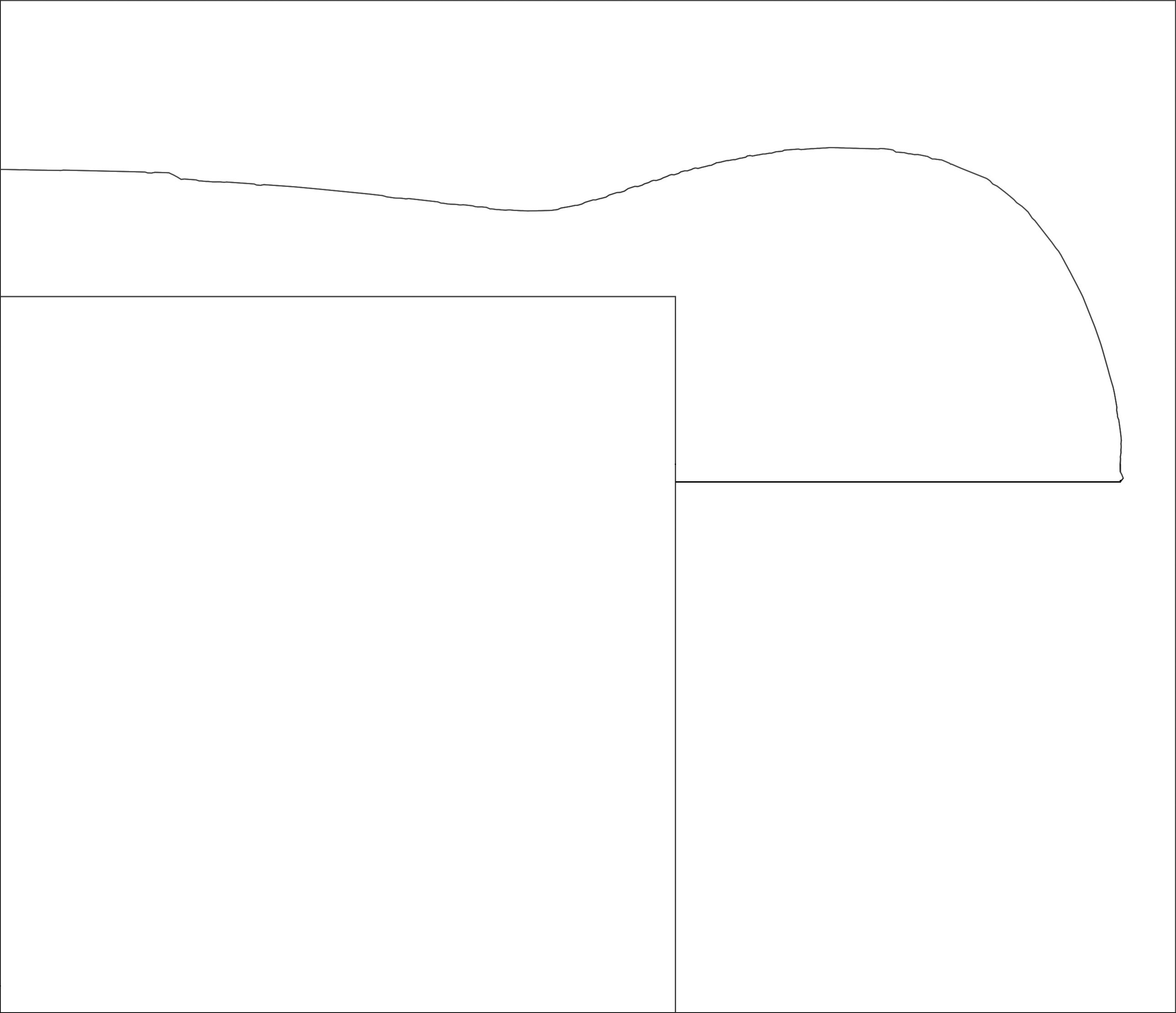

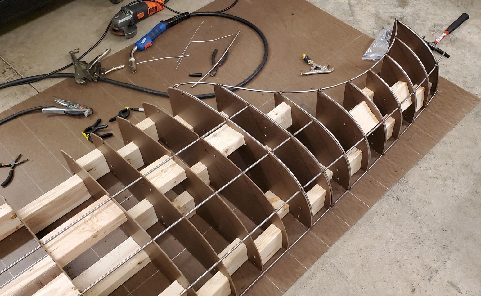

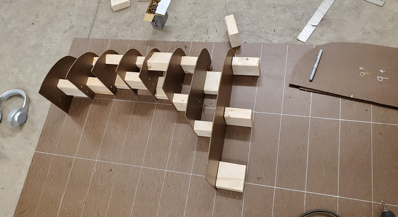

      ​Long time no update... For several months I had been fiddling trying to break down the computer model down into sections to make the buck to no avail the last few months. I pretty much gave up. Good news is I found a Russian guy who was able to do exactly what I needed with the computer model i had already . https://www.facebook.com/RustinhoPRO/ He did an excellent job for a very reasonable price and included thorough instructions. Since I am building a wireframe buck I will do things a bit differently than the other car bucks you see on his site, but I printed the 2d sections on paper and then transferred them to masonite to make a temporary buck/jig for welding the wire together. Here are a couple photos of the computer modeling work.

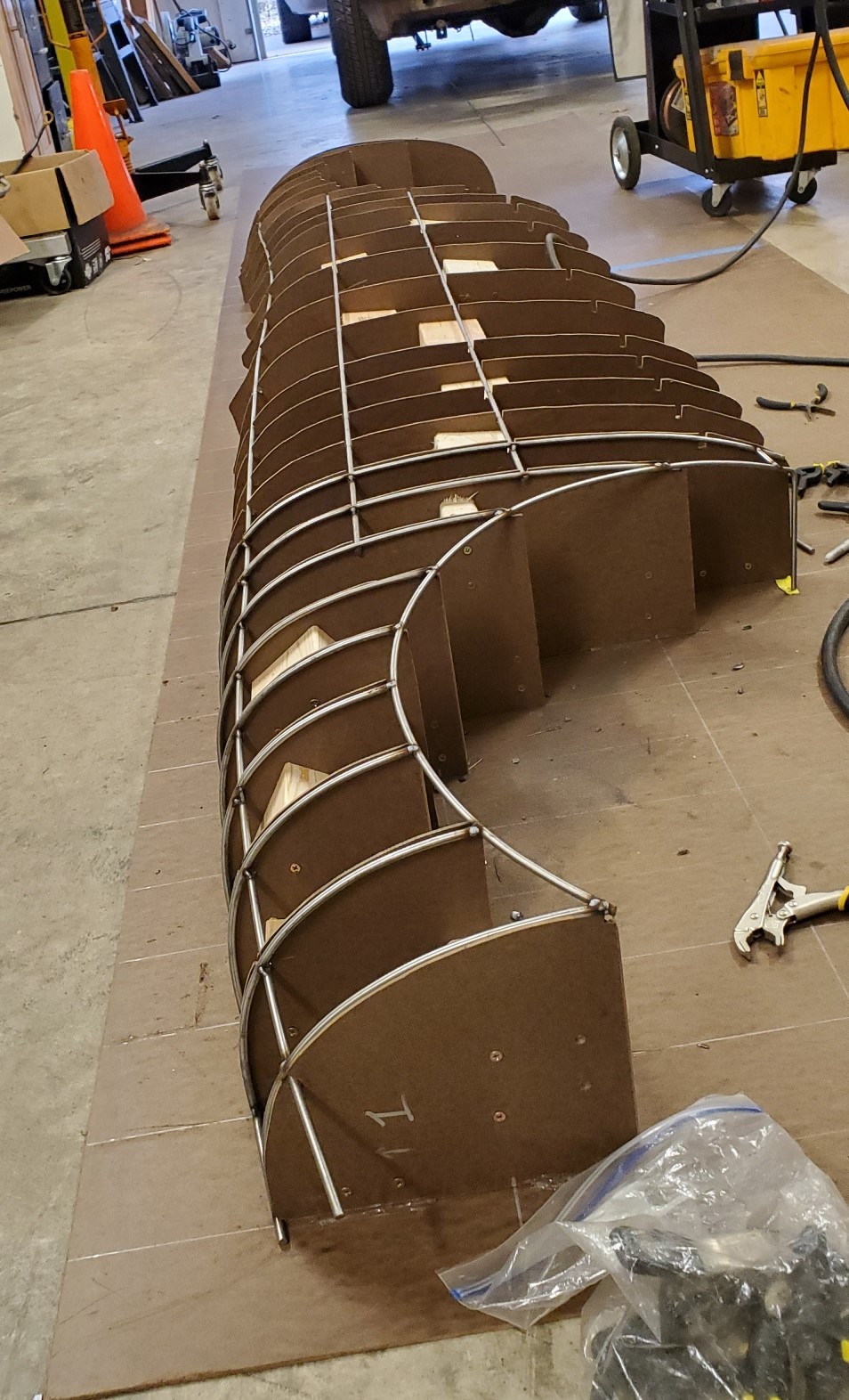

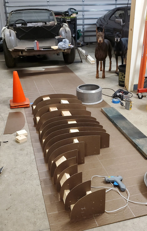

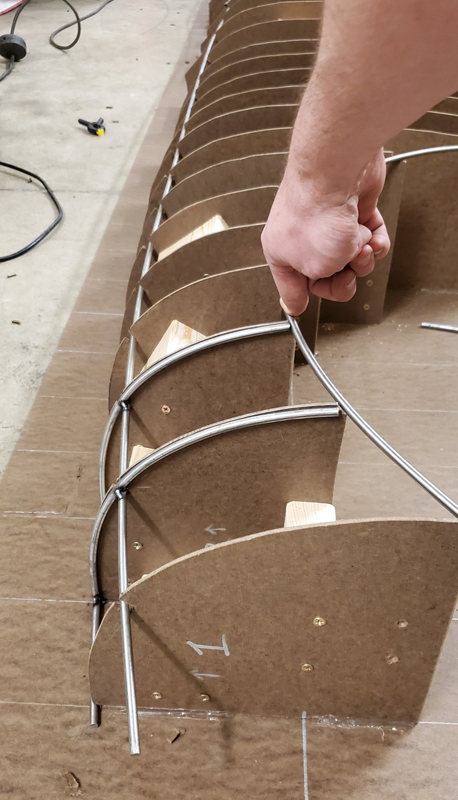

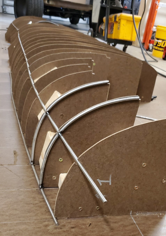

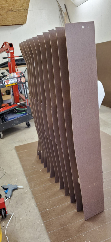

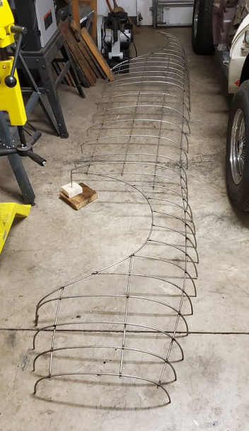

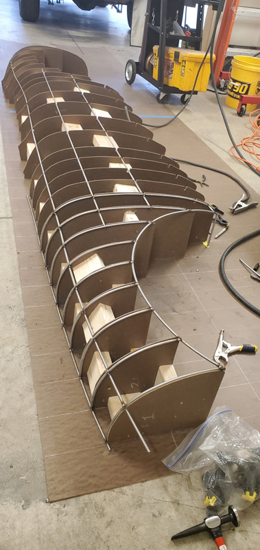

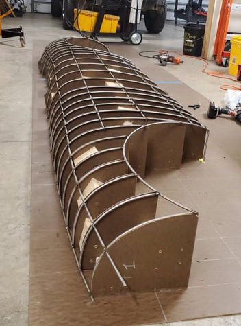

      ​I have the hood and left side bucks made. Remember I am only using these as a jig to hold the wire while I weld it all together, then I will remove the wire frame structure and weld/bolt it on to the car. Bending the wire is turning out to be a very tedious process but it's great to see it coming along.

      Thanks y'all! I am going to build the body in aluminum. The welding on the chassis tubing was all TIG but MIG for any of the sheet metal work like the firewall and trans tunnel. The wire form buck was also just mig welded as it doesn't really matter. The body panels will have to be TIG welded as it's the cleanest method and also I don't know how to gas weld.

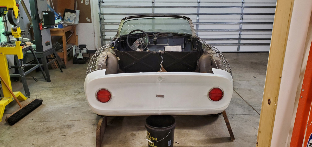

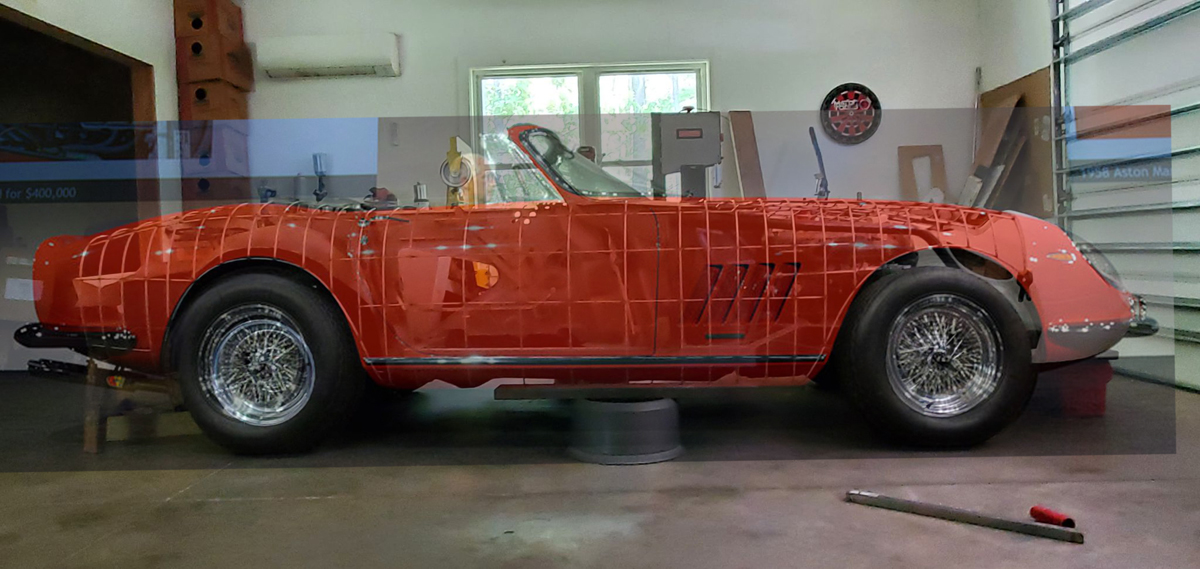

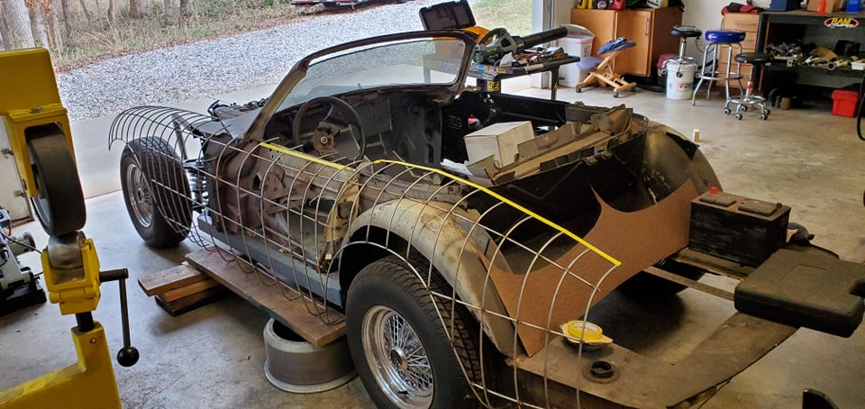

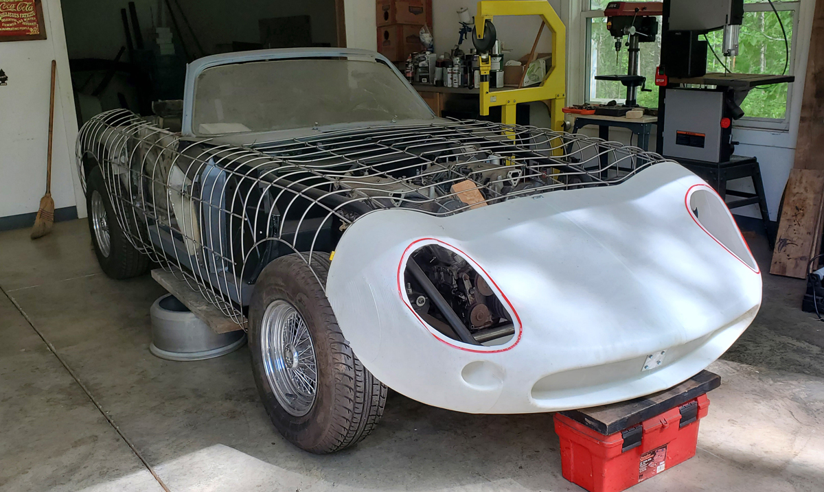

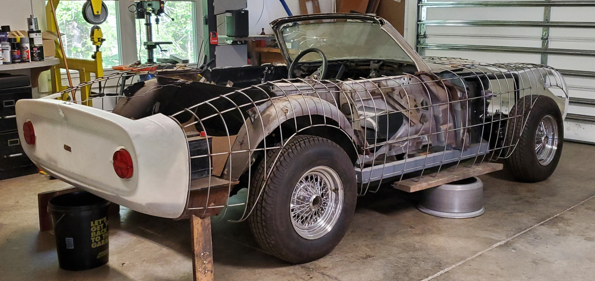

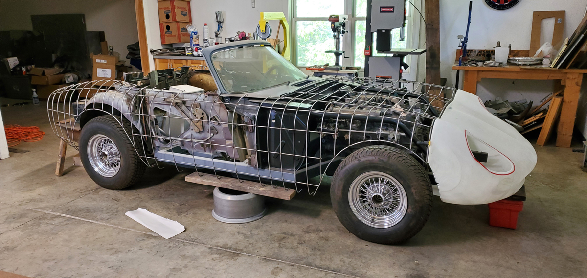

      The hood and opposite side wire form are now done. I ended up shortening the sides approximately 2" for the wheelbase to match the body as well as massaging the rear quarters to look closer to photos. Visually it looks correct after a quick photoshop job too. I have to just assume the 3d model I have been working with was a tad out of scale. Unfortunately the 3d printed parts are quite fragile and I need to reinforce the insides before I crack any more pieces off... After that I can begin hard mounting everything on the chassis. The plan is to have it all be bolt on for ease of removal as needed for working on specific sections.

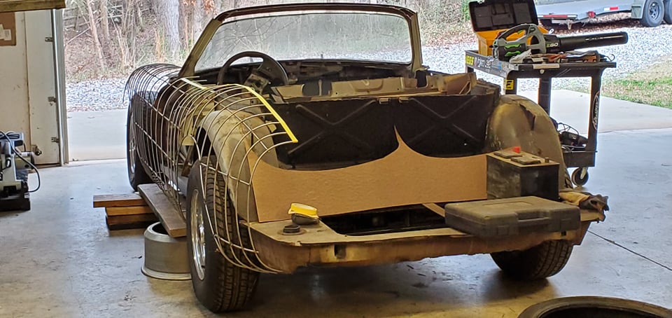

      I'm not thinking I'll get too much further without doing that! Having the body buck complete and possibly having the car running and driving will help facilitate that as well. I am eager to get some hands on experience, youtube and metal shaping forums only get you so far.

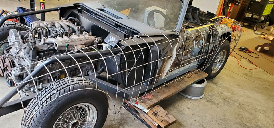

      Mocking up the rear

      South Carolina
