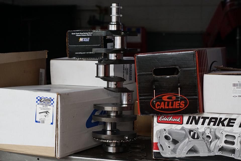

      This past weekend I made a trip out to NY to visit my engine builder and to drop off a lot of parts for him. My block is almost ready for assembly, just needs a final hone and a dip in the tank to wash it out completely and then its time to install the Callie's 408ci stroker kit. I forgot how nice the Stage 2.5 243's I had Texas Speed & Performance do for me came out!

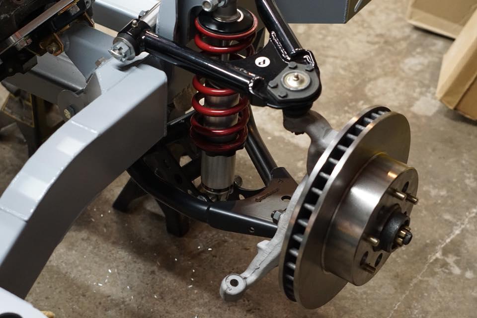

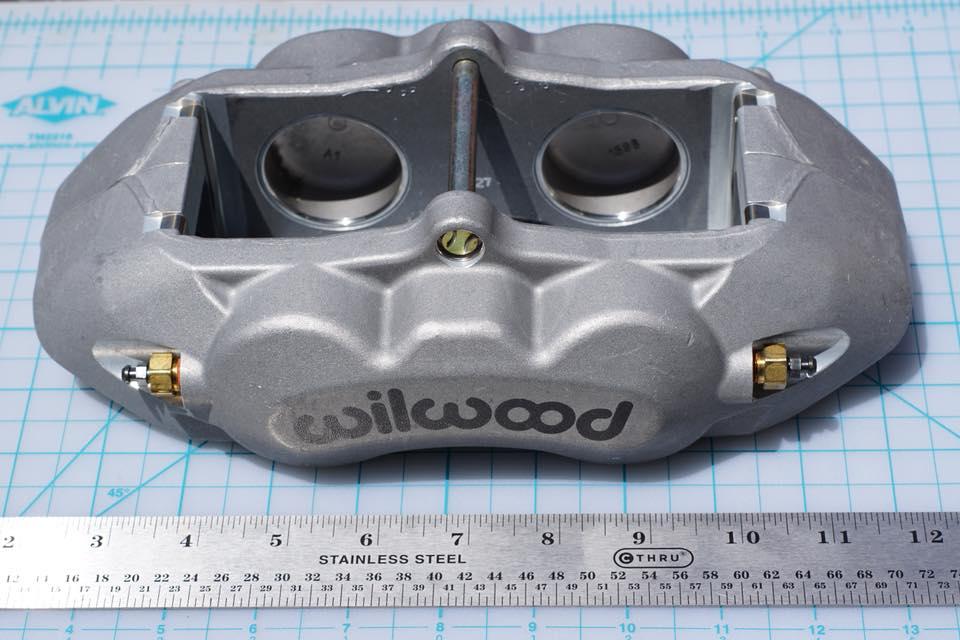

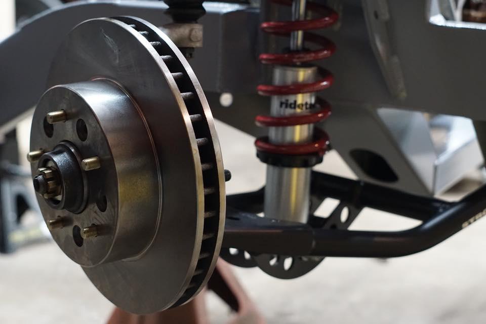

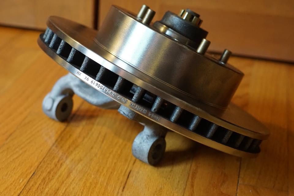

      I decided to go with a more traditional look for my car. My new brakes will be based off the 1967-1969 SCCA Trans-Am series Camaro. I wanted to buy OEM calipers but it was almost $1200 a side and they are heavy as F**K so I decided to run everything period specific except for that. Wilwood D8-4 calipers will work and are much lighter. So im running factory 1969 Z/28 spindles, 1967 drum hubs, and 1969 Z/28 rotors. I will need to make a custom caliper bracket I am amusing. I think a 15" wheel and meaty tire will do the car more justice than the modern trend of 18" wheels.*

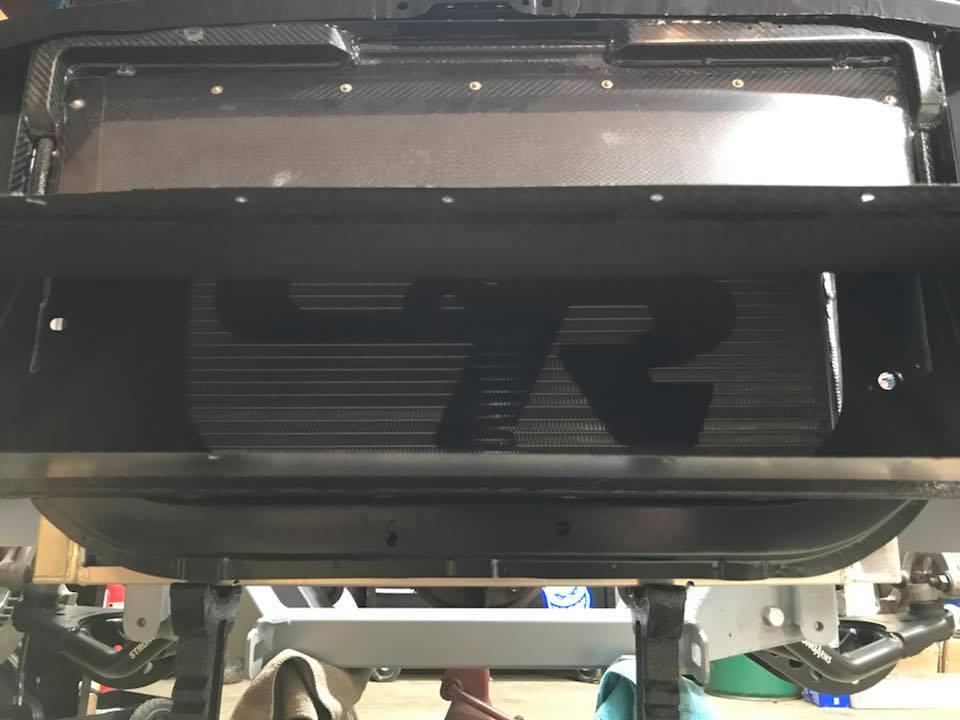

      I also got my cor support mocked up with the NASCAR spec C&R radiator and NASCAR carbon fiber duct.*

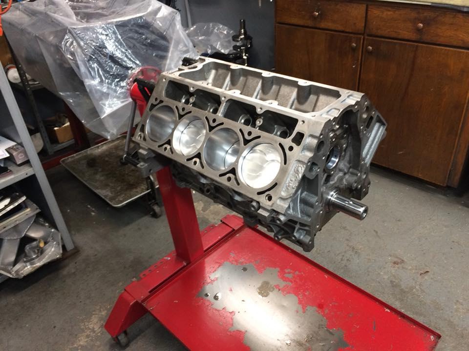

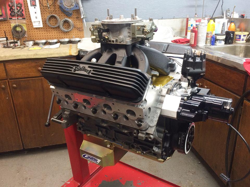

      Speaking of updates, Bottom end is assembled on the 408ci*

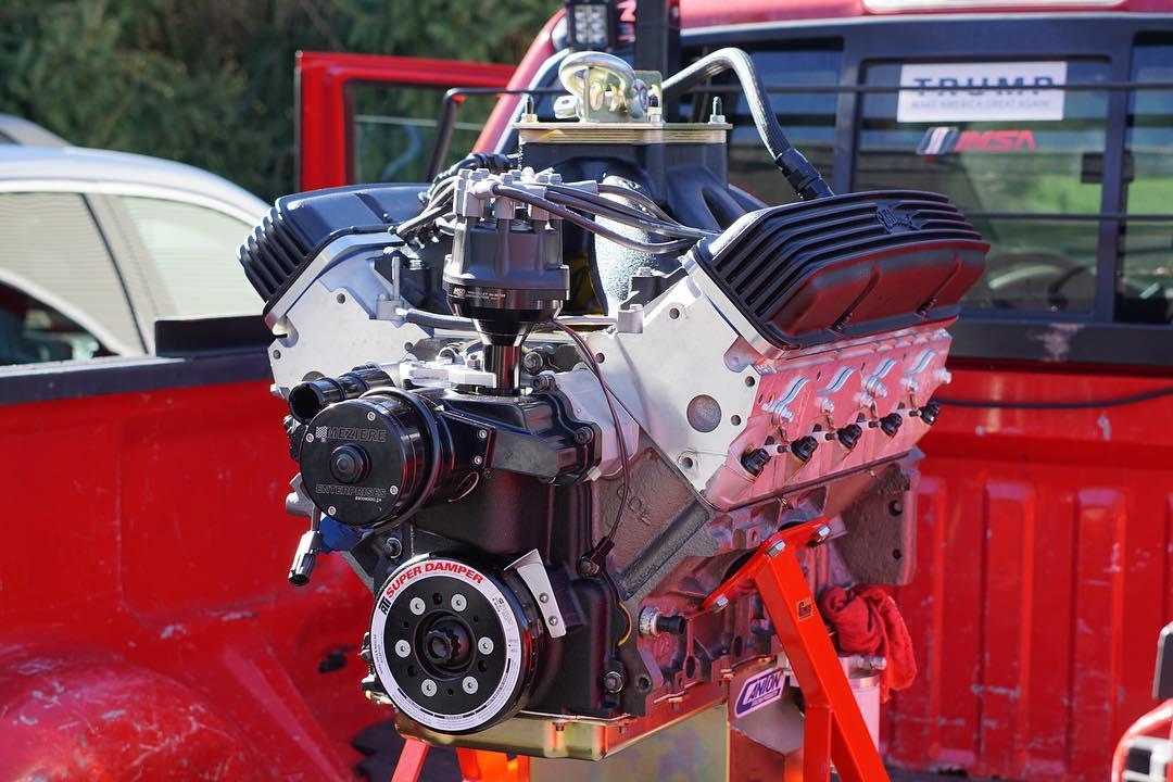

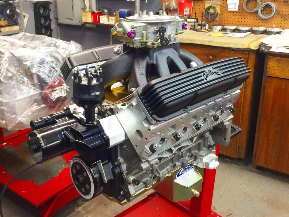

      Huge engine update! Its assembled and going on the dyno in 2 weeks
      Just waiting on a vacuum pump and a custom alternator set up and she is ready to spin. This is really exciting for me.

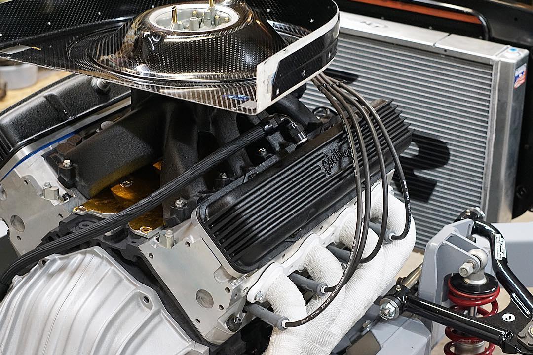

      I picked up the motor a few weeks back! All in place in my subframe and ready to finish mocking up the radiator and hoses.

      The sub/motor/rad support look awesome all together now and I fully support the 15" wheel/tire trans am look! If you are planning to drive this thing in anger, besides having adequate brake ducting, maybe look into getting wider rotors to help dissipate heat. The lower operating temperature will allow you to run a less aggressive pad for street driving.
