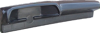

      I will also need to buy and install a dash, mostly to comply with CAM rules, which require a somewhat finished interior. I'm thinking about going with this fiberglass dash, to save weight and money:
      Not only is this dash cheaper than a stock replacement, it may allow me to forgo a gauge panel. If I can, I would like to use a generic 6 gauge instrument kit installed directly into the fiberglass. Just cut holes for each gauge. This seems like it would be cheaper than buying kits specific for Camaros which include their own panel. The difference seems to be about $400 for a generic set vs $750+ for a Camaro specific one.

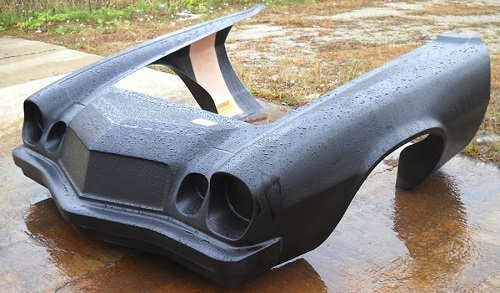

      Alternatively, I could get a full fiberglass front end, such as the one below, which incorporates the bumper. It would all be body color, but the weight savings would have the performance advantage. Besides that, the shape is quite well executed. To be fair, it does have the rubber strip area flattened out, but I'm okay with it. The Glasstek front end:

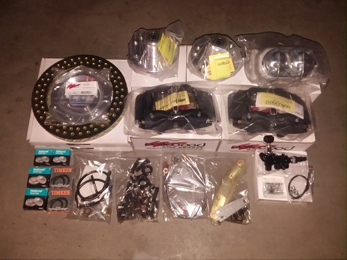

      Alright! The front brakes and mc have arrived. I pick up the rest of the parts tomorrow on crate. I'm stoked! I may try to get that mc installed today.
      These parts are arriving just in time for me to be done moving and helping my friend renovate her apartment. Also had to work on 3 different vehicles other than the Camaro. Seems like life just wants to get in the way of what I really want to do. But now I should be able to actually get going on this. Is it too good to be true?

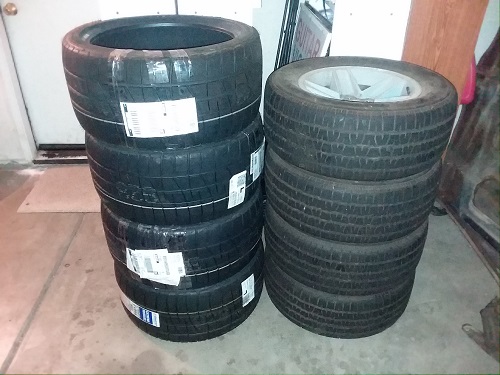

      Something else that I'm pretty stoked about, these wide, sticky tires! Pic shows new tires next to the old, which were already wider than stock, being from an 80's Camaro.

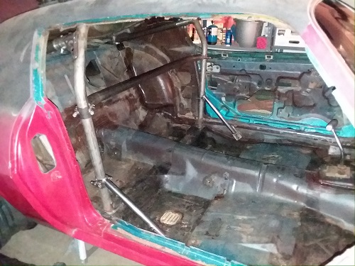

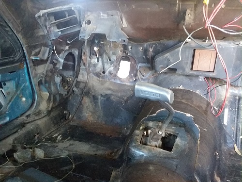

      I wanted to test fit the cage, so I started stripping the interior. The old wiring harness is a complete rats nest, so that had to come out. The carpets looked dingy, so those had to come out. The headliner was warped, so that had to come out. Everything was dirty, so everything came out, even the foot pedals.

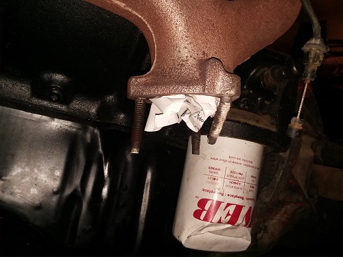

      In other news, well, this isn't new, just funny. So, when I got back from deployment I took a look at my engine to get casting numbers to see which Edelbrock crate engine this was exactly and get an idea what kind of horsepower I'm making. Well, apparently I've learned a lot about cars since the original purchase of the Camaro some 5 years ago. I don't know when I picked up the knowledge, but I hadn't actually stopped to look at the engine in, well, years, apparently. So I get home from deployment, glance at the engine, and right away I know this is not an Edelbrock crate engine. Edelbrock heads are aluminum. These are obviously iron. I've been telling people that the engine I have is worth what I paid for the car. Joke's on me and I'm not even mad about it. I don't even think the guy who sold me the car knew either, because I don't think he did the swap. I remember he told me the engine makes 350 horsepower. Even then, I knew enough to be skeptical of that, especially with a stock looking exhaust manifold. 1 hp per ci is pretty good, and I doubt you can get that with those restrictive manifolds. Those also were a clue that whoever put the engine together was going cheap, so it never made sense that it would have been an Edelbrock crate engine. It just had Edelbrock intake, valve covers, and air cleaner. Even the carb is a Carter. Knowing that the engine isn't Edelbrock, everthing makes a little more sense. The bondo over giant rust holes in the fenders. The original 3 speed manual trans that came with the 6. The electrical tape wiring job for the aftermarket sound system. The roughly circular hole drill pattern in the rear plastics over the speakers. The blue masking tape over jagged holes cut into the rear deck metal for other speakers. The inch-thick stack of shims on the right front suspension to try to correct for a past accident. A hundred little details that say someone either didn't know what they were doing, or didn't give a crap.
      The engine is more revvy than the 350 in my 75 pickup, so now I'm curious what it actually is. This is where my knowledge ends. How do I go about figuring out what kind of parts are in the engine? Should I get headers?

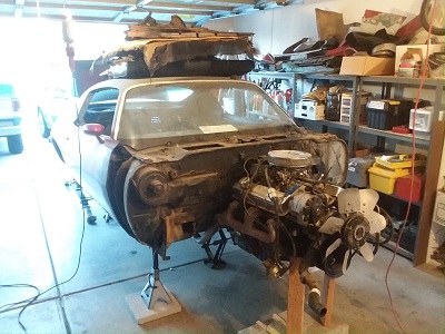

      5/18/2018
      Removed most everything, including front body panels. Drive train and rear end still in place.
      Wiring harness out:

      Test fitting the roll cage:

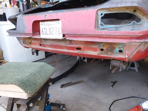

      5/24/2018
      Rear Bumper off. Ordered parts from Glasstek

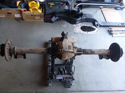

      Rear end out

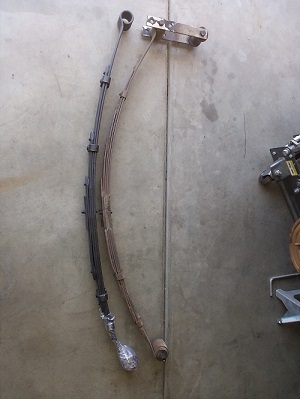

      Leafs, old vs new

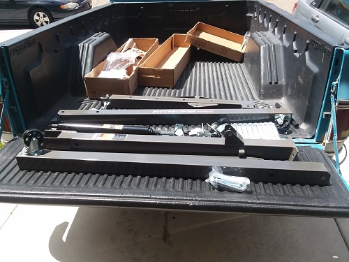

      Brought home some proper equipment
      Much better!

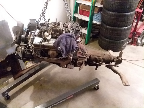

      Damage from engine drop

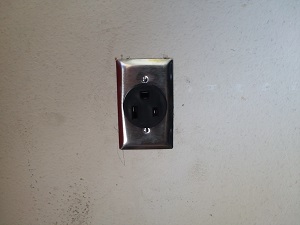

      Outlet for a welder installed $$
