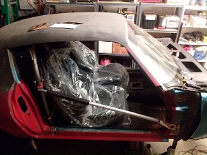

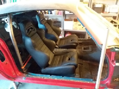

      Seats came in. They weren't supposed to be leather, but I suppose Corbeau may have sent these due to low inventory. Word from CWP is that Corbeau is going through some big changes. The leather may not be as good for autocross as cloth, but they are so beautiful I don't mind!

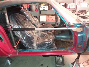

      Ideas for door bars

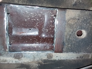

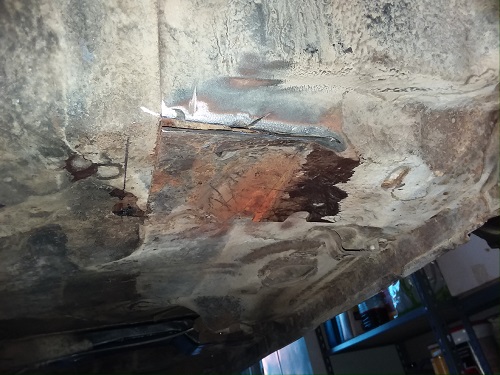

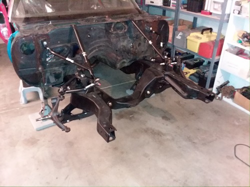

      Repairs to sf mount:
      Cut out damaged area
      Drilled out spot welds and flattened the pieces
      Welded the cage back on

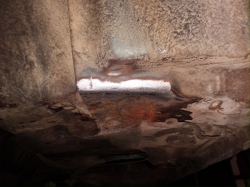

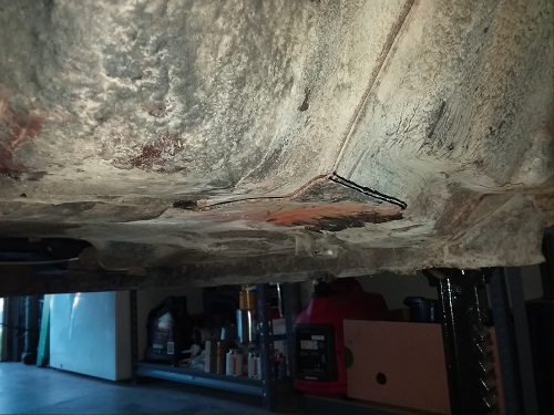

      Problem area with fitting the PTFB lowered body bushings. The sharp corner you see here was pinching against the frame
      So I cut it
      Welded and smoothed
      And fit the frame!

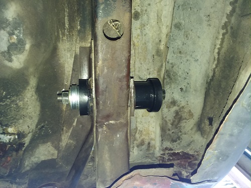

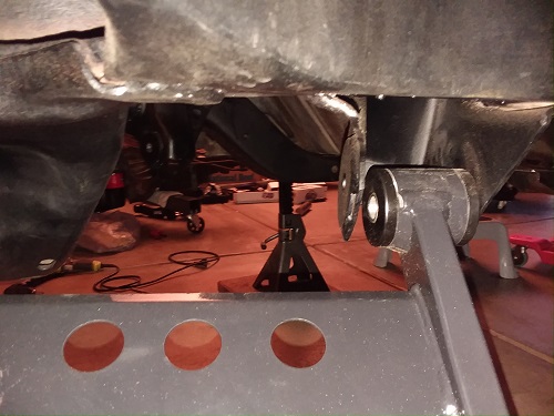

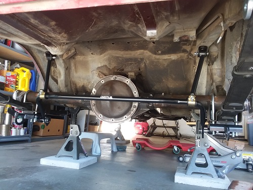

      The lca not fitting properly due to poor factory tolerances on the stock frame
      So I got a solid bar, 1' cut down to 2 3/8" ($10), which I used to beat the openings a little wider
      The lca's installed (backwards). Also test fit the strut braces. They will have to be installed permanently after alignment shims are in.

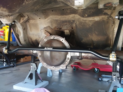

      The lca's in correctly. Also steering and sway bar

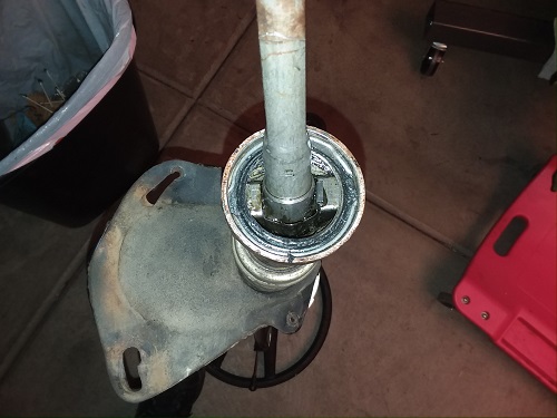

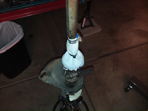

      Didn't want to pay $120 for a new steering collumn u-joint, so I
      Cut out the old dust boot and cleaned out the grease
      Then re-greased and made my own dust boot out of a heavy-duty rubber glove
      It will get another hose clamp on the larger section, just have to go get one.

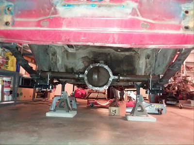

      Installing leaf spring bushings
      Rear end in!

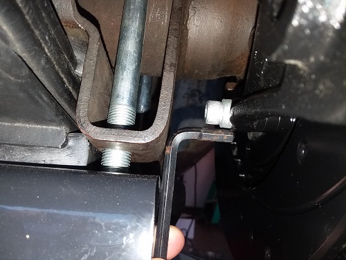

      Trying to install rear brake calipers, leaf spring interferes with bolt
      I have to swing the caliper bracket down to get the bolt in, but the allen key wont fit between the bracket bolt and the axle housing

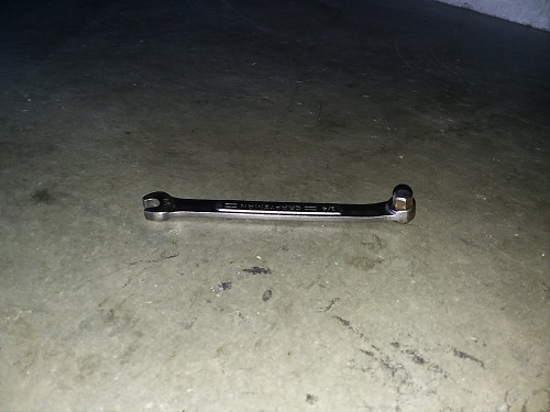

      Cut off a 1/4" drive section from a 1/4" bit, fit that into a 1/4" wrench
      And use like this

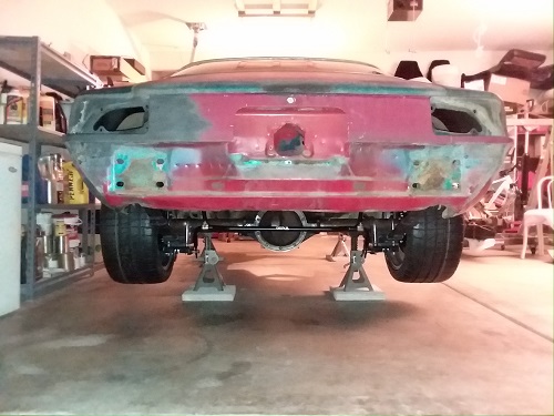

      So, here I am at the computer, just updated from over a month ago. Please note that I left out many many details. I have been working hard on this project every day. Every inch is fought for, and everything is a force-fit. Everything requires a new tool or an additional part. Or people forget to ship you part of what you paid for. One thing I should mention is that UPS has lost my freight, which was the fiberglass front end, hood, doors, and rear bumper. I'm being told that they should find the missing freight soon, but it's been over a week now since it was supposed to be delivered. Glasstek says this happened to them once before, and the freight was found a few days later. UPS is investigating, looking through footage for the unmistakably huge crate. Good news is, I have plenty to work on in the mean while!

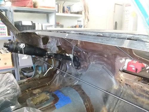

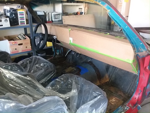

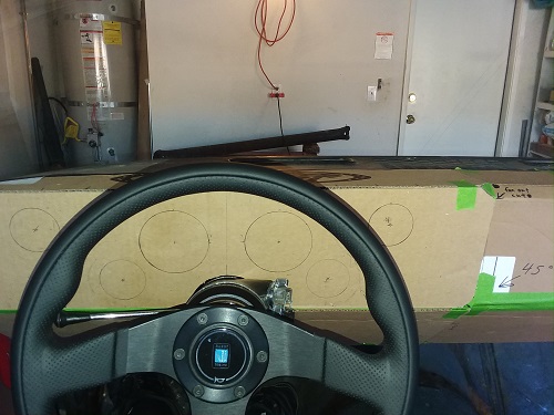

      Over the last four days I have been building an aluminum dash. First, I built some cross bars out of 1" x .125 steel,
      then mocked up the dash out of cardboard.
      Lay-out how I want the gauges.
      Then built it out of .063 aluminum. I ended up not needing the upper steel cross bar, as the aluminum was plenty strong without it.

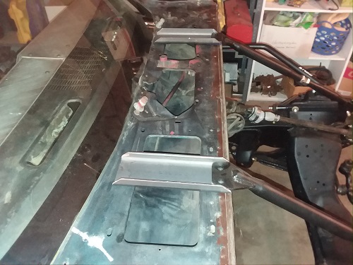

      Ended my day making these chassis-stiffening brackets. You will see the full application soon!
