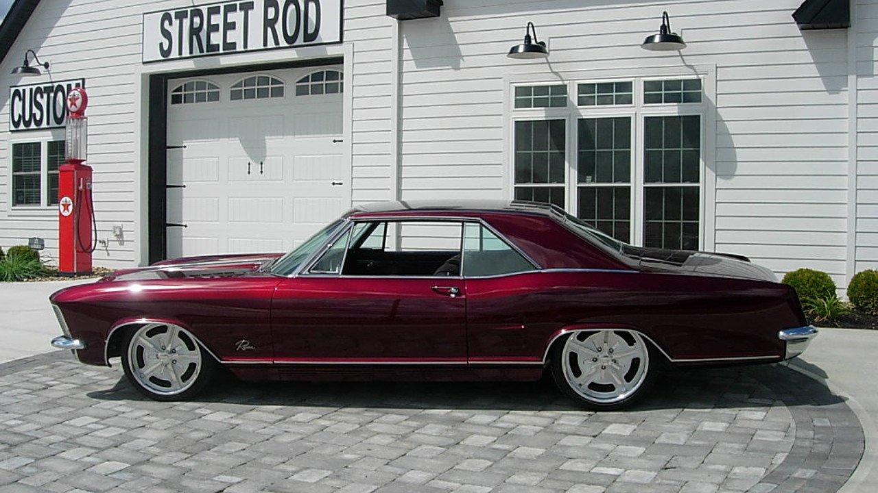

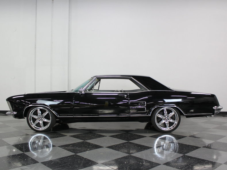

      I'm a big enough man to admit I might be wrong. I decided to look at a bunch of google images of 63-65 Rivieras with 18 and 20in wheels and saw a lot that looked horrible and remembered that I have the HD springs in my Riviera which make it sit ~1-1.5in lower to help with its stance vs. a lot I see like these:

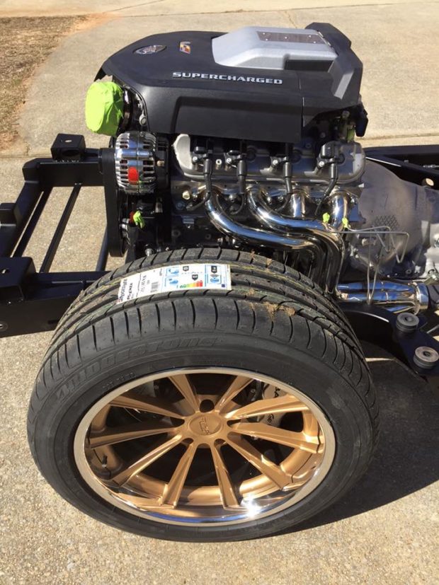

      Then I came across this car:
      https://www.engineswapdepot.com/?p=13923
      Dig as I might I can't find what size tires are on the front because that or a fuzz more is really what I'm looking for. I choose the Engine Swap Depot link for it since it shows the chassis which as a custom frame with different front end in it so they've fixed a few of the issues I'm after resolving though I bet they aren't going after scrub radius as hard as I am. Anyone know what size tires ended up on this thing in the front? I can't read the stickers well enough to be sure but it looks like a 255/45R1* from this picture:
      That would give me 4.5in of sidewall and a 27 or 28in tire depending on 18 or 19in wheel; I'm betting 19in. Either way I can live with it.

      Looks like a 255/40-18 wheel with a "fat" outer lip.
