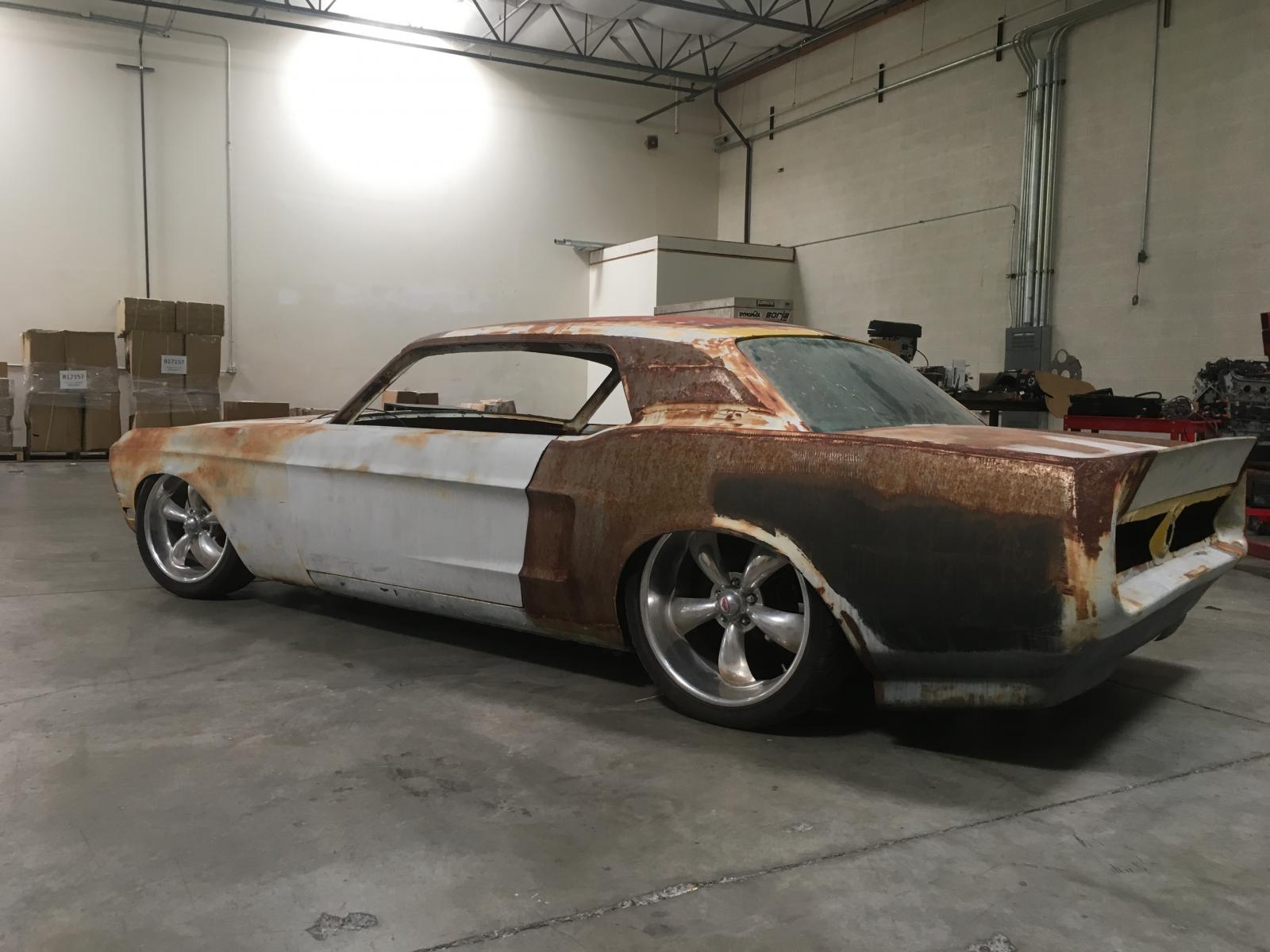

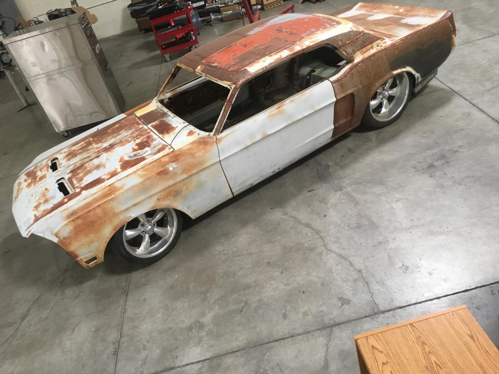

      This is a 1968 Mustang I started building almost 10 years ago and am now finally going to finish. It has quite a few modification I previously did such as ridetech air suspension (which will need some updating) shaved cowl vent, door handles, emblems etc. made a trunk spoiler that is laid down, made quarter extensions out of steel and incorporated into the body as well as the rear bumper. Started on the ground effects and most noticeable chopped the top. The car is currently at The media blaster so we can continue the modification necessary to install something a little different under the hood. What we will be running is a Ferrari V8 that will receive a set of turbos as well.

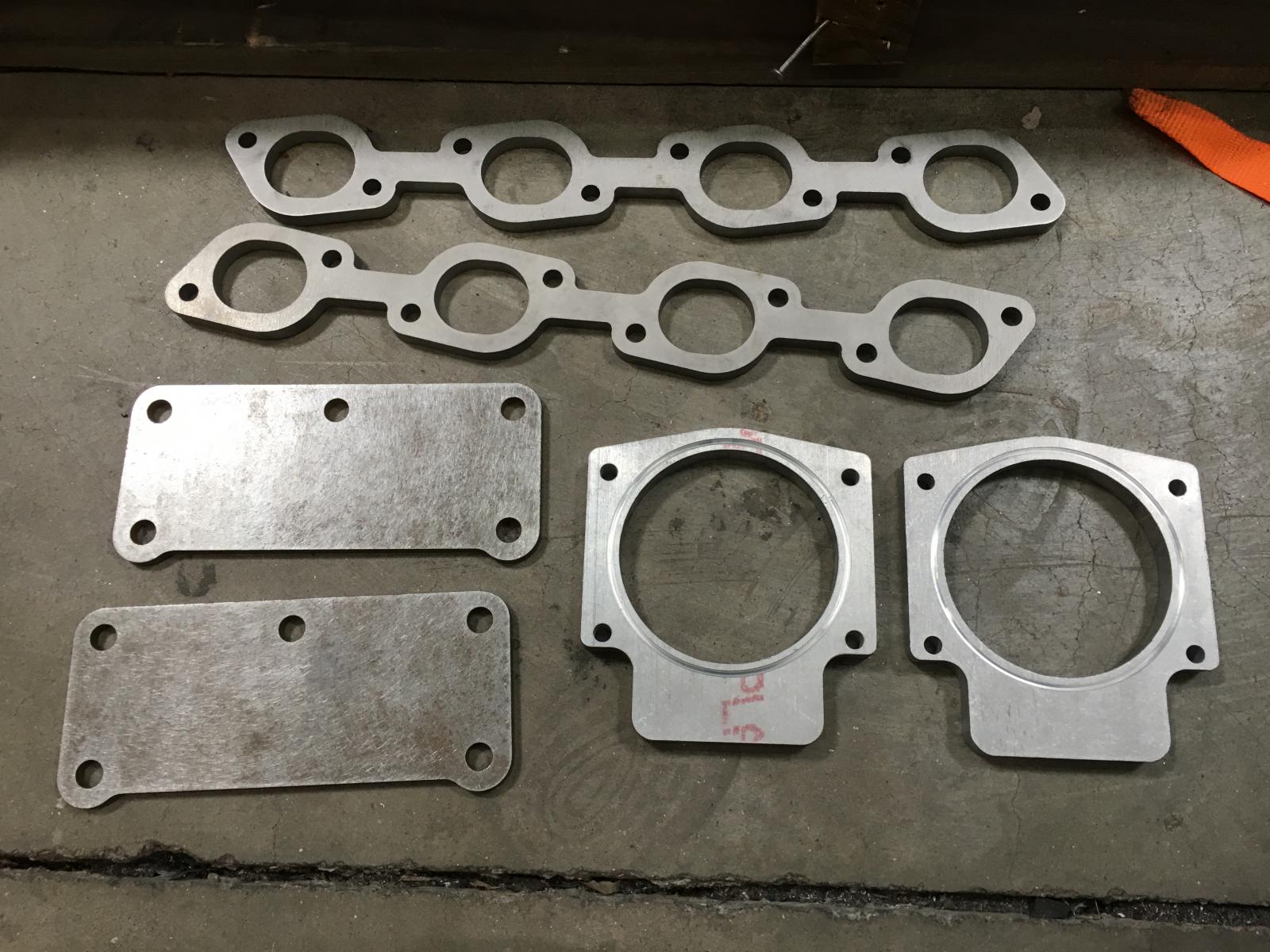

      Got all the pieces water jetted to adapt the engine. The throttle body flanges will get welded to the intake so I can bolt the LS twin throttle bodies to it. Name:  IMG_1098.jpg
