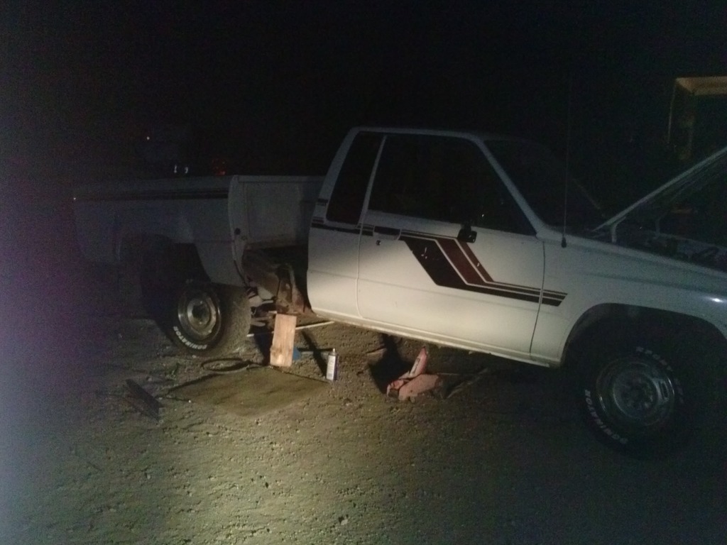

      As it was when I picked it up

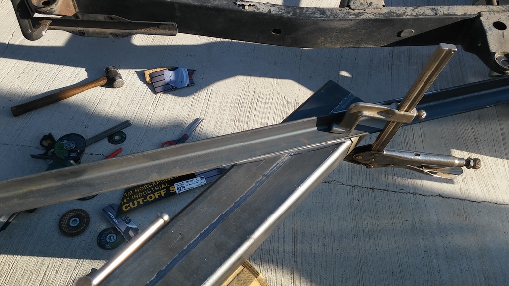

      So with that taken care of I only have 2 evenings and a day to get it done I suck it up and get started with a pile of ratchet straps,90amp Fluxcore Squirt gun from HF I go to town. My new RAGE3 saw came in the day I was going to start the rear section but when they dropped it off it looked as though UPS used it as a wheel chok for one of their Tractor/Trailers so out came my little little 4" grinder and a section of angle as a guide.
      The rule is measure twice and cut once. My problem is I still measure with a mic and cut with an axe!
      Los Angeles
      592
      Got everything tacked up With the baby mig. I rented a welder for the final welding that was being dropped off the next morning, The little place here does not have the ability for 220 so I found a guy with a stand alone unit that was reasonable. I only needed it for about an hour.
