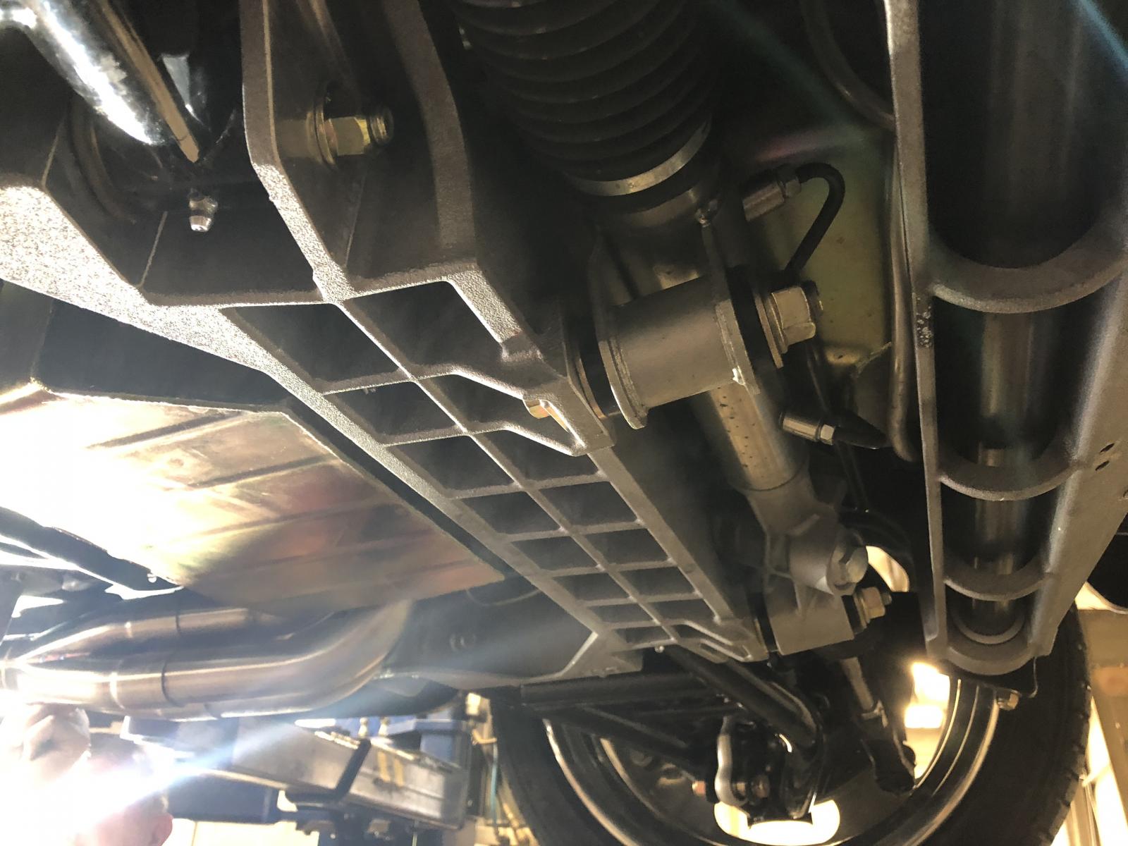

      To answer those who wanted pics of the suspension components installed: here are some pics from yesterday when it was on the lift for a overall inspection after a few hundred miles of break-in driving. The Detroit Speed components are the Aluma-Frame front and QUADRA-Link rear suspension kits for a 65-70 Mustang. That chassis is quite a bit different than the larger Fairlane, but these units can be adapted with time and effort.Name:  IMG_0542.jpg
