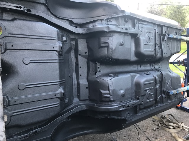

      Looks awesome. Funny thing, I'm doing my 73 as well and I just finished the bedliner myself last weekend. Looking forward to your build.Name:  IMG_0034.JPG
