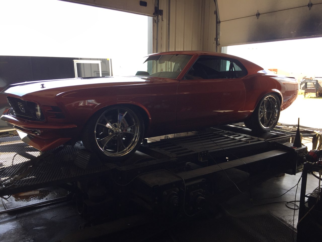

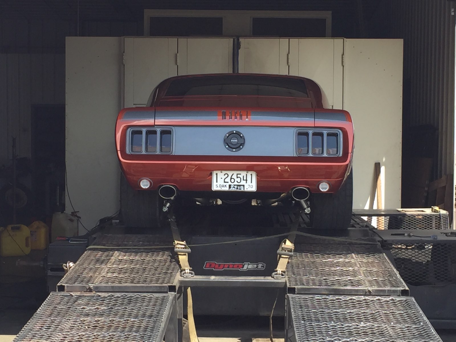

      Next on the list after giving it a couple small test drives around the neighborhood was a final Dyno tune. The terminator EFI I'm running is a self learning system and you can use the hand held controller to fine tune it yourself which I did to some degree but it's hard to beat getting info from the dyno. Just from tweaking things I believe we picked up around 20 hp at the wheels and also learned that the engine liked to keep pulling to around 6,500rpm on the chassis dyno where it stopped around 5,700 on the engine dyno.

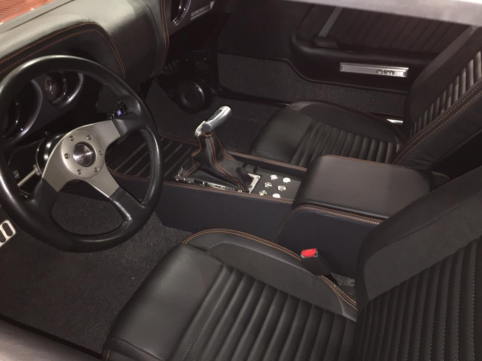

      A little more interior progress. The center console is now finished along with the back seat.

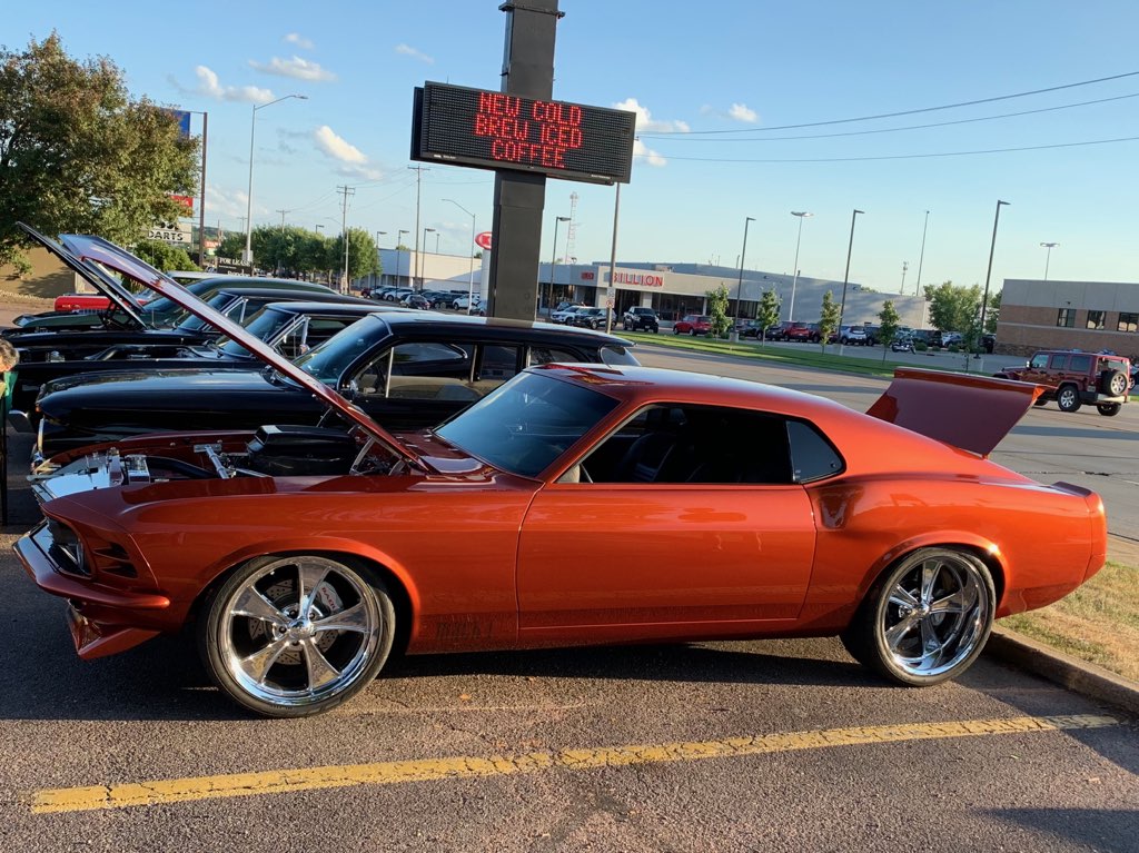

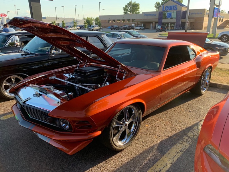

      The wife and I were able to take the car out together for the first time in over 6 years to a local cruise in the other night. I'm really liking how everything came together and the new and improved version is definitely just that! The ridetech coil over suspension rides really well!
      One area I am battling is my power steering and Hydratech Hydroboost combination. I was pleased with how the steering felt before but at low speeds while braking and steering I would get a little feedback through the wheel that felt like I would momentarily lose assist. I am using a Randall's rack system that utilizes a GM Jcar rack along with a GM type 2 pump. I spoke with Hydratech and I have tried a few things but it seems like I may have added an issue. In trying to slightly increase pressure from the pump that seemed to help a little with the braking and steering combo issue at low speeds I may have created a new issue. The steering feels a bit touchy at faster speeds. The larger tires in front prevented me from getting a lot of caster but its sitting with about 2.5 degrees positive with a little more on the passenger side. Camber and toe were set for good street manners and tire wear.

      Thank you! I'm not sure what to take away from the dyno as he was making the pulls in 2nd gear. He said he assumed I had a highway gear in the car and didn't want to get it spinning so fast with a lot of wheel speed. The best pull showed 351 hp at the wheels. I asked him if that sounded about right for an engine that made nearly 500 at the crank on the engine dyno and he said with the automatic trans, a loose 3,500 stall convertor, 9" rear end, and big heavy wheels and tires it was probably pretty close. From the initial pulls it showed a gain of 25 HP as he was tuning it and it certainly runs better. I'm not sure how to judge the second gear pulls from 1:1 and it was also 91 degrees that day with plenty of humidity.
