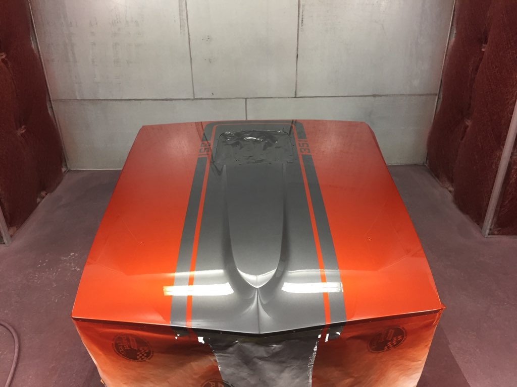

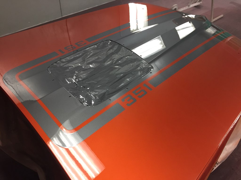

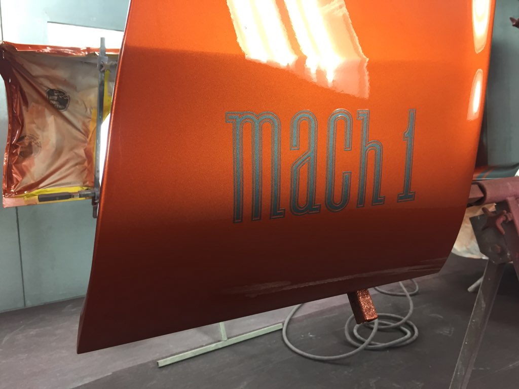

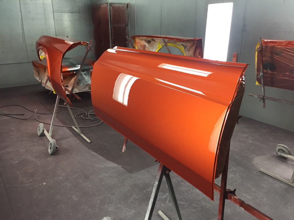

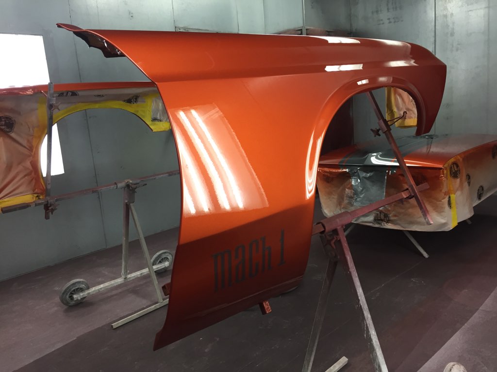

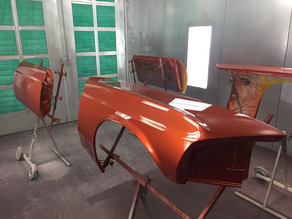

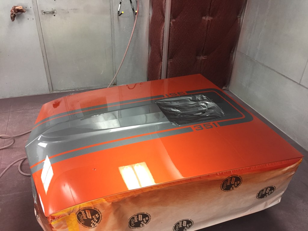

      I had another opening in the booth and made some time to get some more painting done. It feels good to have the big stuff painted. I still have a few rounds of smaller parts but there is light at the end of the tunnel.

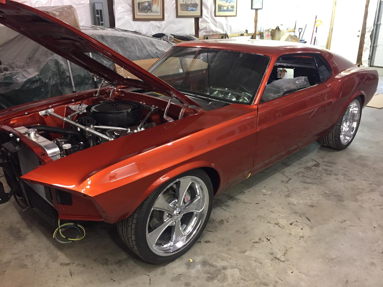

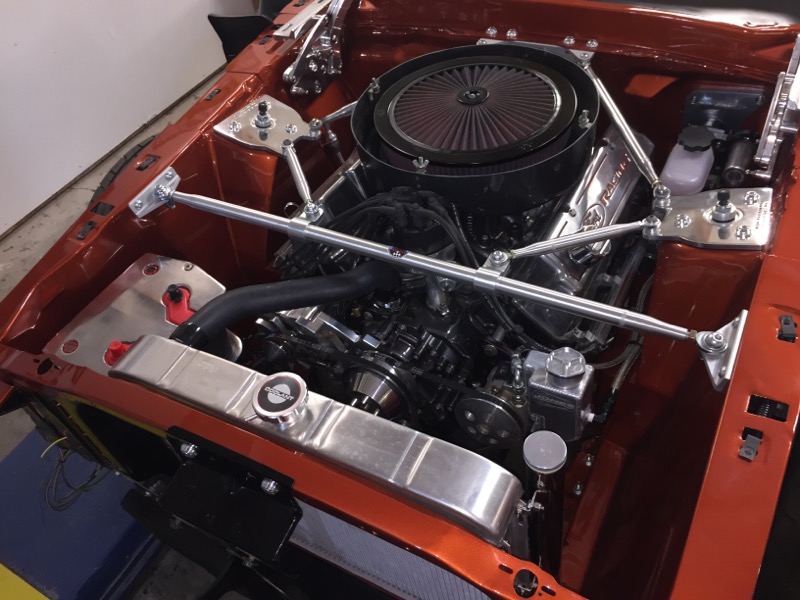

      It's been a busy summer like always but I'm still getting a fair amount done on the Mach 1. The wiring is about 90% done and I have got the car up and running. I wanted to add a little video I had but it's on my phone and I wasn't having any luck adding it here. It sure feels good to be this far and I really missed the sound! The engine bay is mostly squared away and really only have the shaker scoop to add.

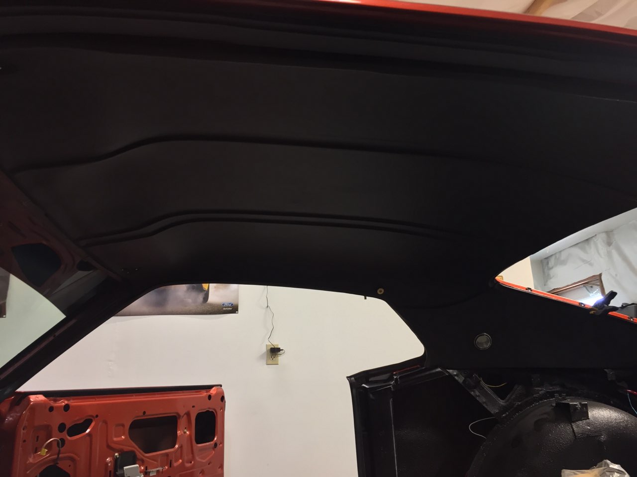

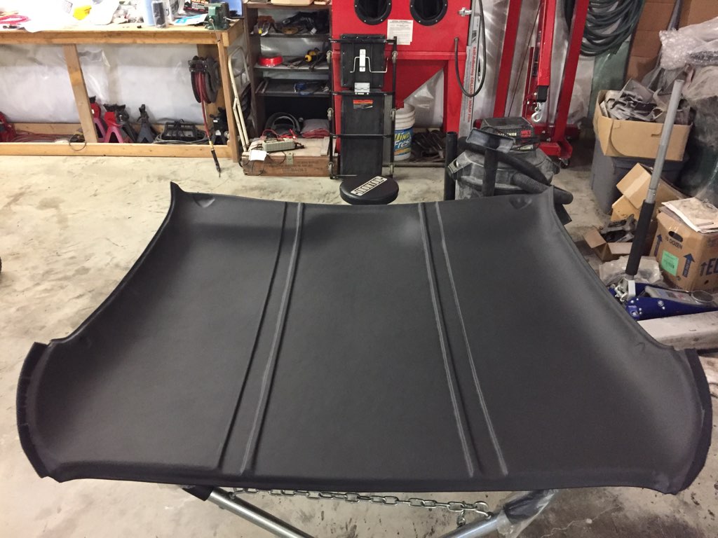

      I still have a lot to assemble and even paint yet but I have a small start on the interior. I fitted a Mustangs to fear one piece headliner in the car. It took a lot of trimming and test fitting until it was right. I then had a friend who has an interior shop wrap it in leather and we added a little design to it mimicking the mach 1 hood stripe on the car. I think it turned out pretty cool and it's better seen in person of course.

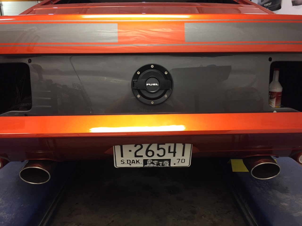

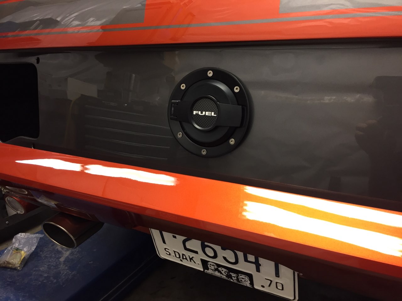

      The rear of the car is coming together nicely and I'm glad I took the time to make the challenger gas door work! I have to pull the rear axle out yet and do my final welding for the ride tech four link tabs. While I have that out I will freshen it up and also add new paint. I have a roush yates Nascar detroit locker installed and the high spring rates in those make a lot of noise so I may install a lighter one and not sure if I will stay with the 3.89 gears or go to 3.70's this time around.

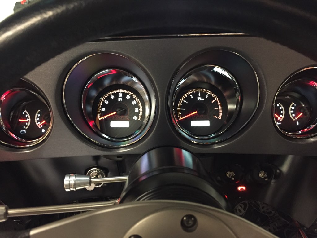

      The personalized Dakota Digital gauges are looking good and I really like how much brighter and easier they are to see. The metal wrap I had done on the bezels looks like it will tie in with the interior well.
