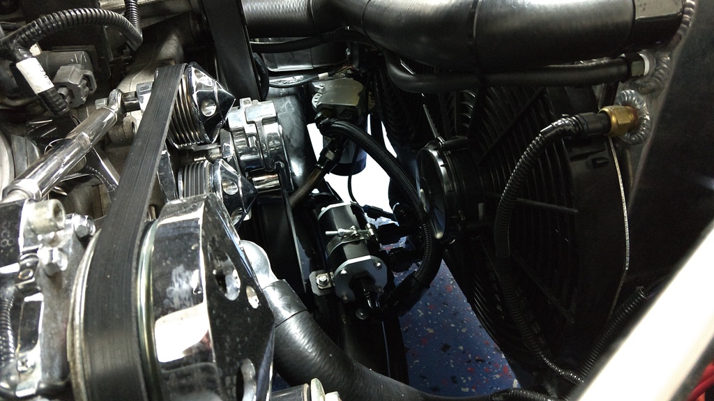

      I finally got around to installing the oil cooler a few weeks ago. I'm using the Canton 215* thermostat with a Fluidyne DB-30417 Oil Cooler. I'm right at 30 psi at idle and between 40 and 45 psi when the RPM's are from 1000 to 2000 which is pretty much exactly what it was before I installed the oil cooler.
      I had to modify the front nose bracket to get the cooler to fit. I also had to sacrifice one of the horns. I guess I could find another place for it but not motivated enough to do it yet.

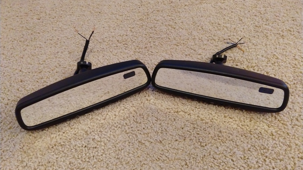

      Next up is a rear view mirror upgrade. I'm getting tired of having to constantly adjust my mirror because the bolt keeps coming loose. Getting rid of the chrome on the back of the mirror will also be nice. I went down to the local junk yard and scored a couple of Gentex GNTX-453 auto dim, homelink with compass mirrors so I won't be needing my garage door opener anymore either. I got both mirrors for $25 and they both appear to still work. I figure I'll 3d print a part to fill in for the original mirror bracket and this will also hold the mic for the android radio.

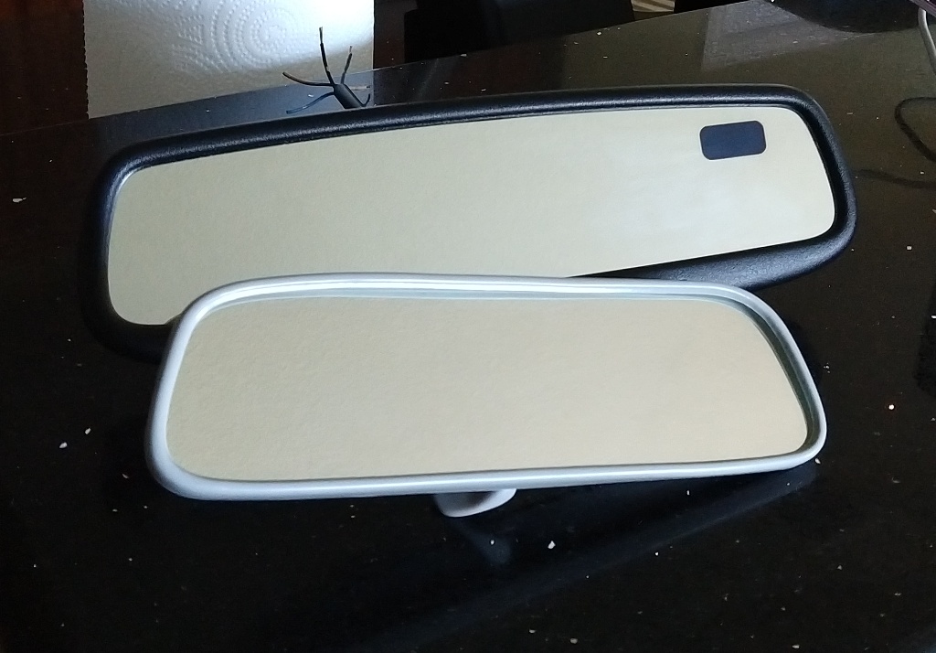

      I got the mirror installed. It works great, but if I had one thing to complain about it would be the size of the mirror is notably bigger than the original, so I kept it mounted high up on the windshield so as not to take up too much of the windshield real-estate.
      Here's a shot of the original versus the new.

      What cars did you pull them from? I've been looking on and off for one of those mirrors.
    9. #49
      Nov 2011
      Wylie, Texas
      302
      One of them came out of an Infiniti M35 and the other came out of an Infiniti as well but I don't recall what model or year it was. When I went to the junkyard I didn't know what vehicle would have the mirror I was looking for and the guy at the front desk was telling me it would take them hours to find the mirror given the size of their inventory of cars. So I asked him if I could just look on my own and I found an older model within about 15 minutes. I kept looking and found the two I got in under and hour. It really only takes a second to peer inside the car to see what kind of mirror it has and I think most junkyards will let you pick your own parts at no extra cost.

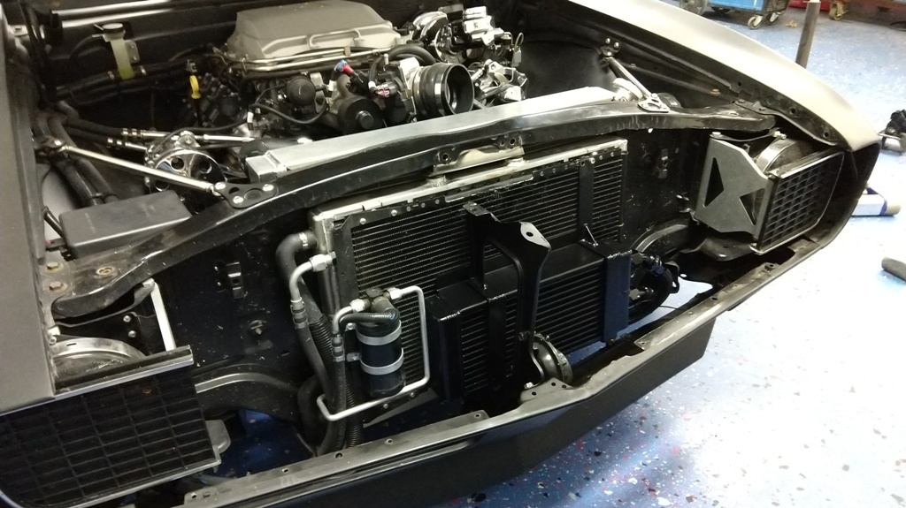

      quick question. I see you are running a C&R heat exchanger with the vintage air mounted to it. Did you have to modify your hood latch or brace at all in order to get them both to fit?
    11. #51
      Nov 2011
      Wylie, Texas
      302
      Quote Originally Posted by kcarter13 View Post
      Yes I did. The spring for the hood latch was poking the condenser so I had to trim it back. Refer to this thread for some pictures.
