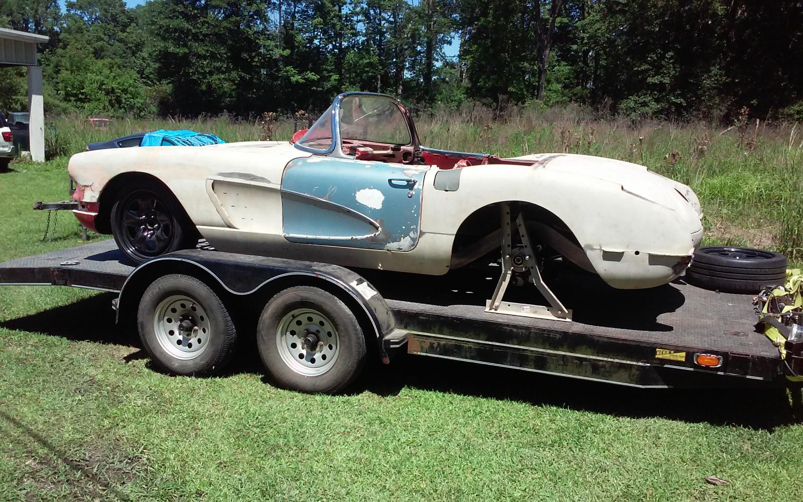

      finally got around to the pictures, the chassis photos are form Dreamers streetrod where I got the chassis the others are where I sit as of nowName:  vette 3-3.jpg

      That's going to be great when you finish. Lots of time, effort and money.
      Maryville, TN
      844
      Nice! I am really liking that generation of Corvette these days. Should be a cool project!

      Nice project, it's going to handle sweet with that under it.
