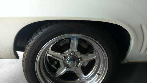

      275/40-17 rear and 245/45-17. Both are 26 inches.
      I'm on my phone, so the picture didn't upload. Just a second.

      When I bought the car it had 28" tall tires on it. Before I installed the lowering springs. They only rubbed on a bad dip or bump in the road. I think you could do it. I'm running the billet specialties Street lites 8" up front and 9-1/2 in the rear.

      I'm running 5" backspace up front and the tire just kisses the frame on the back inside for full lock to lock turns. In back I'm running 5-1/2" of back spacing and the inside upper tire just touches the inside wheel house above the frame on a deep driveway or if I have the trunk loaded up and hit a bump.
