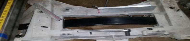

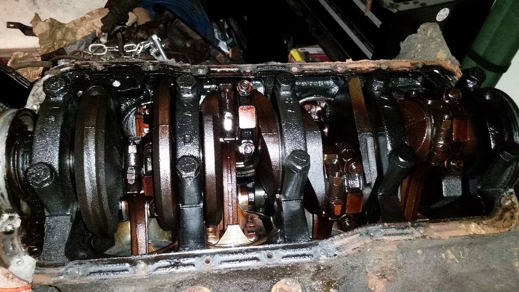

      I've decided to rebuild the original 351W while I have downtime on the frame and suspension. I had a heck of a time getting the intake off. I unbolted it and hit it with a rubber mallet a couple of times with no luck. Tried to pry it off, didn't budge. Tried lifting it off with the engine hoist...no dice. I soaked the edges in WD-40, Marvel Mystery and some gasket solvent, left the engine lifted by the intake and repeated the aforementioned methods the next day and still had an engine with an intake attached. I finally used a chisel in the pneumatic hammer and it came free in a matter of seconds. The oil didn't appear to have any metal in it, the cylinder walls look good; I should have the rest of engine dissembled for inspection this weekend.

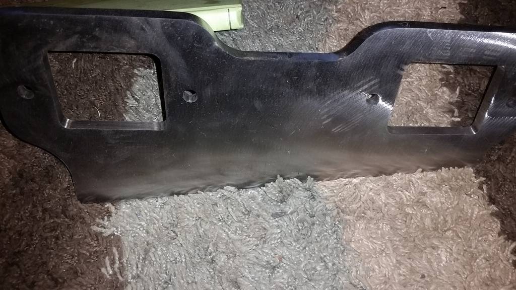

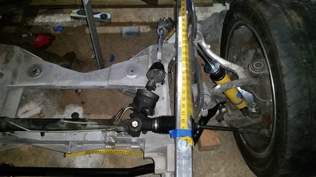

      Scored a C5 steering rack and finally unpackaged a swaybar thats been sitting in a corner for a couple of months.
      Mocking up the front suspension to determine the best way to mount the upper control arms.
      Mounting plates for the upper control arms

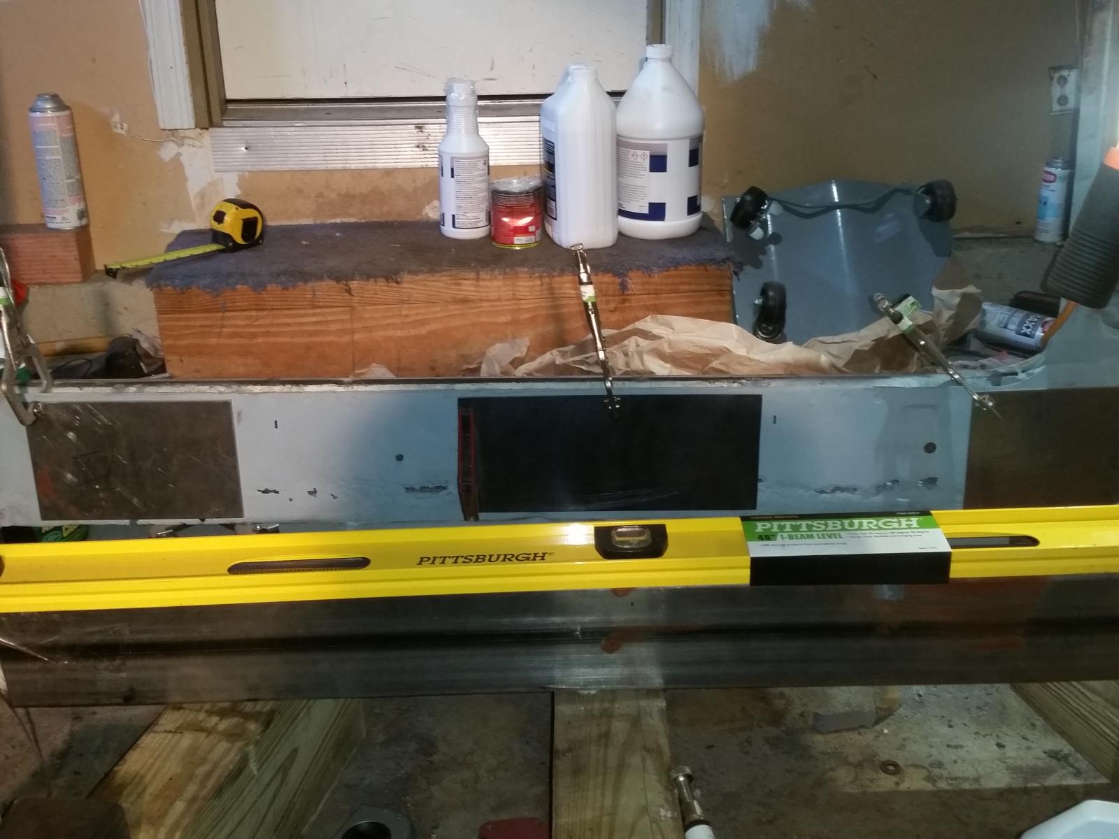

      Got the inner rockers ground down to bare metal and covered in weld through primer, getting ready to weld on plates for the frame outriggers to attach to. There are a few holes in the driver side inner rocker that will get patched later (if I don't cut a full length panel to cover or replace the entire inner rocker).
      I'm using the Eastwood weld-thru primer and have no experience with it, so I'll see how it goes.
      The inside of the rockers have been sandblasted to clean metal clean and sprayed with
      Eastwood internal frame coating. I'll be inspecting with a scope later on to check/verify full coverage.

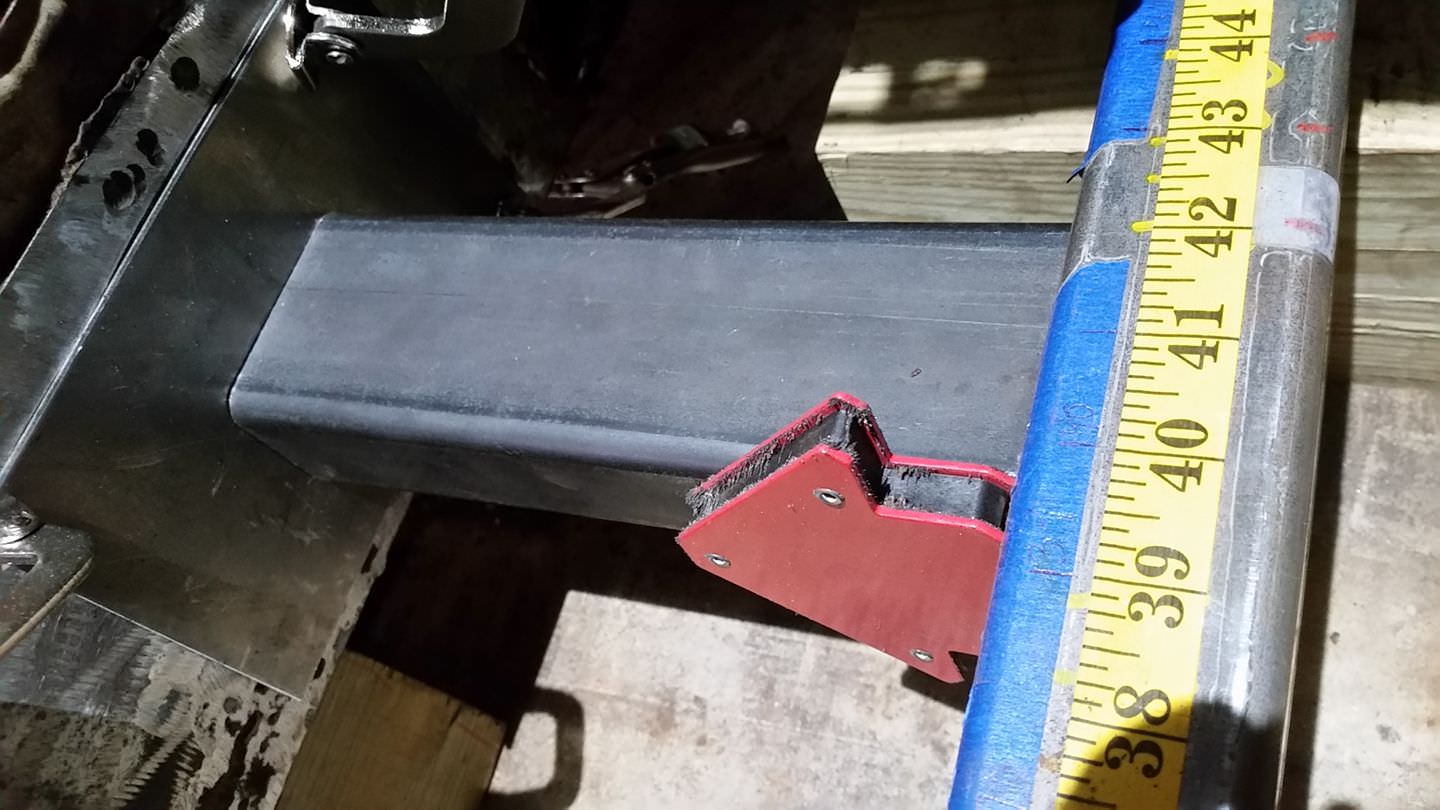

      No sooner did I get the inner rockers ground to bare metal and primed, I had to go away for work again. I'm back and at it once again.
      I'll be tack welding the mounting plates, outriggers, and frame rails together making sure everything is square and level. I'm hoping to have the front frame section all tacked in before my next trip in a couple of weeks, so I'll be ready to start on installing the back half when I return.
